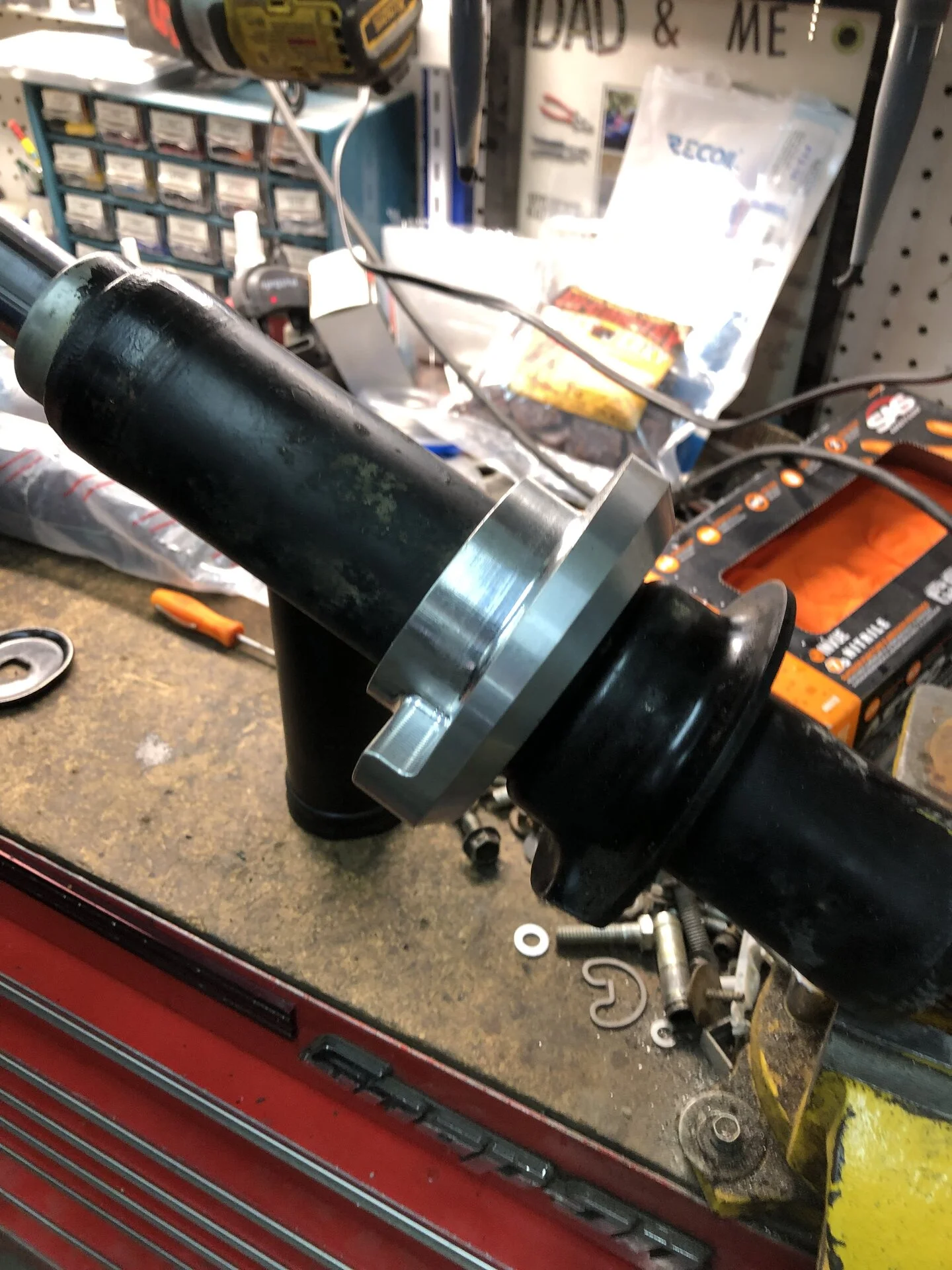

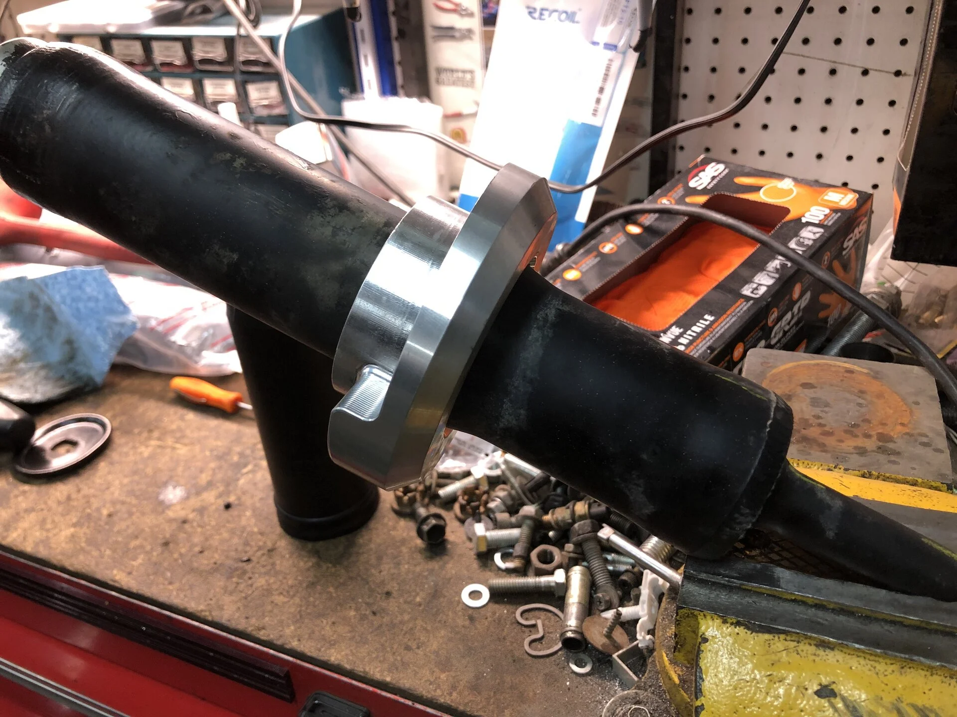

EDIT: we didn’t have any instructions, but we’re back in business! Watch the 4Runner install video on their site for much faster understanding 🤦🏻‍♂️
Well, I’m not sure the Westcott parts will work. The inner diameter of their part seems too small for the outer diameter of the shock…
…and it wasn’t easy to get the plastic dust/rock shield off of the shock to even slide it on this far :frown:

Any tips on not destroying the plastic dust shock body cover?
Their 4Runner video showed heating up and popping it right off. We had figured out the four pressed in tabs that hold it on and heated it also, but we were carefully reaching inside to press those tabs up with a long pry bar. If you can just heat and pop like their video, that’s the winner for sure.
We didn’t destroy ours. It still went back on cleanly, but I like their method.

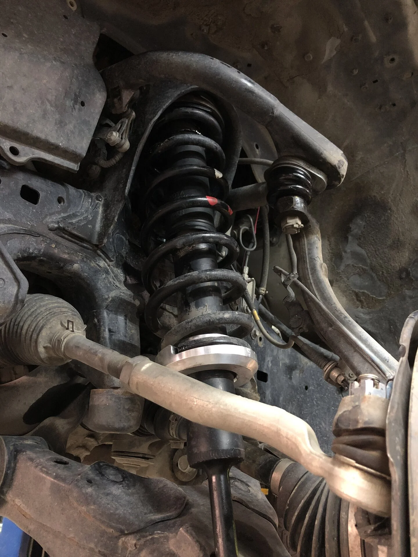

Check your UCA at full droop. Having that bottom seat spacer should allow you to position the spring (spin it), still seat it and avoid any contact!
Love that, you should see a pretty vast improvement in ride quality with all that preload!

The beauty of preloading is droop and ride quality. It’s allows for a full sensor lift and stock ride quality or better depending on your weight. Also I can go from low to High in 32 seconds. And high mode actually functions and doesn’t feel over sprung. Especially in comfort.
I think my UCA is well clear of the spring. Tundra LCA & SPC UCA for a Tundra.
Ah, your running SPC’s and tundra arms. That’s full droop? My stock arms touched the spring a few times with high speed impact on the down stoke.
That is all back together and hanging without the wheel on it. And it was placed in AHC low before lifting it on the lift, if that possibly makes a difference.
