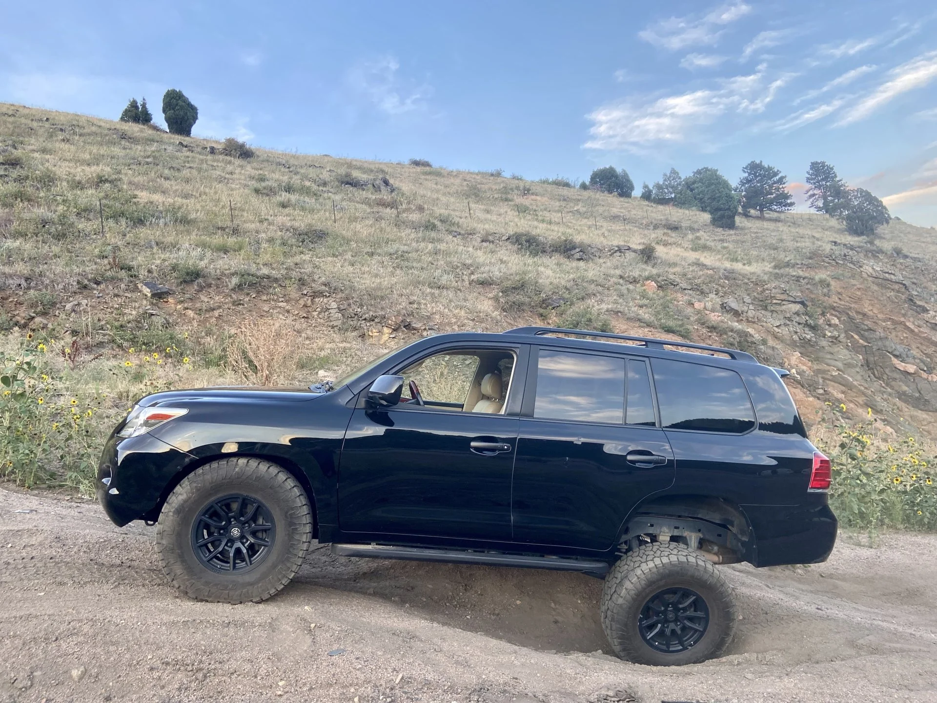

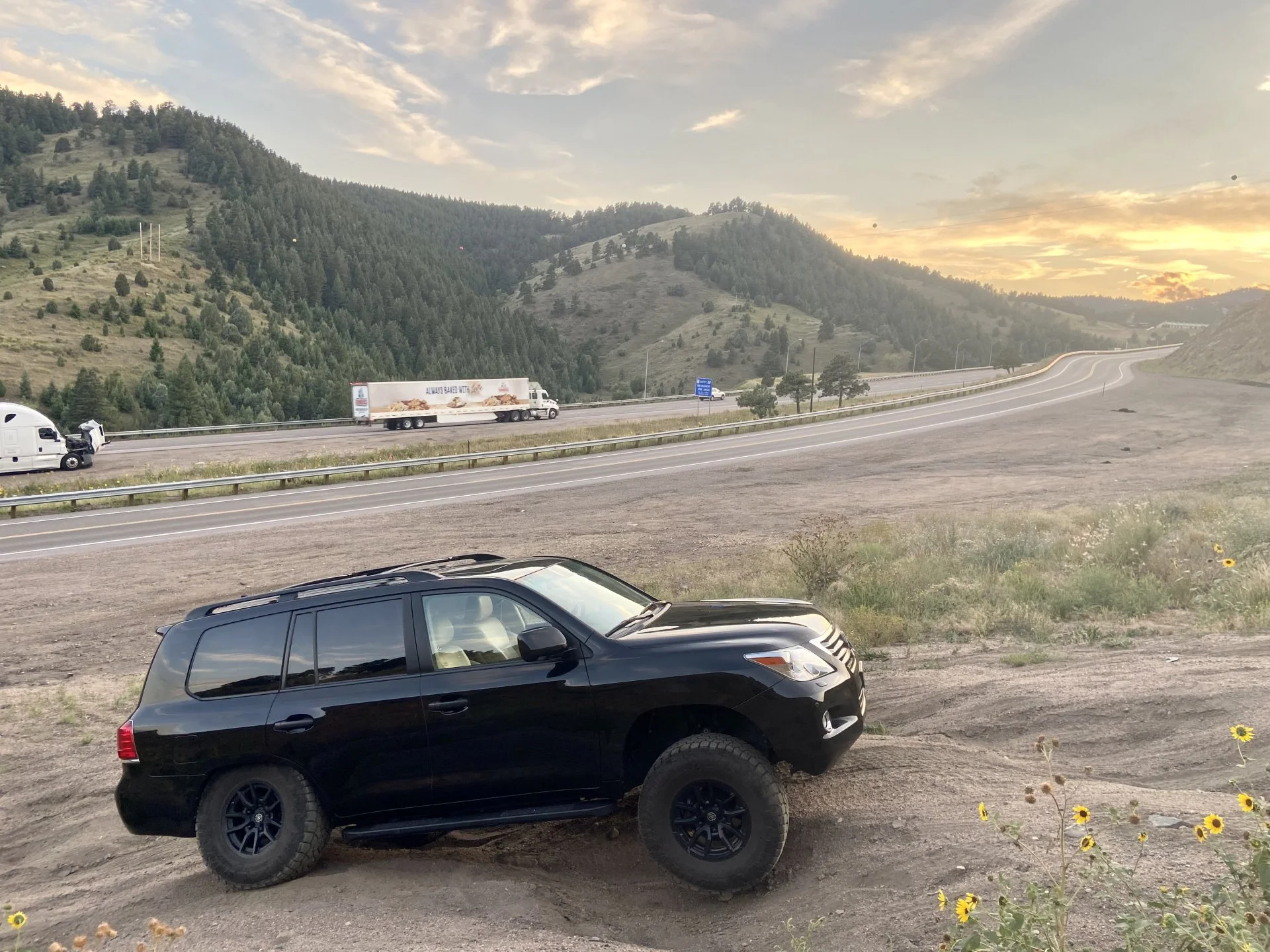

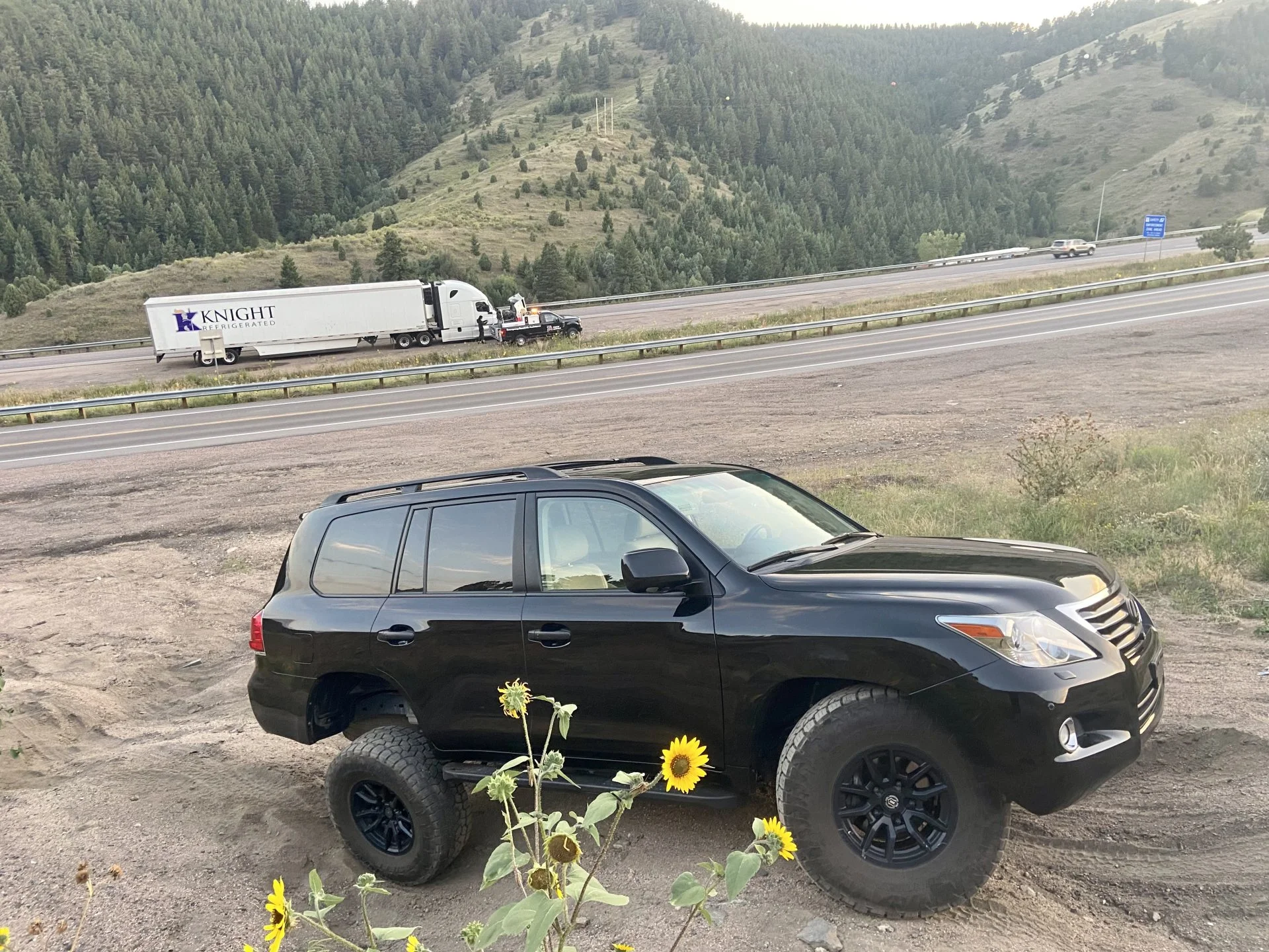

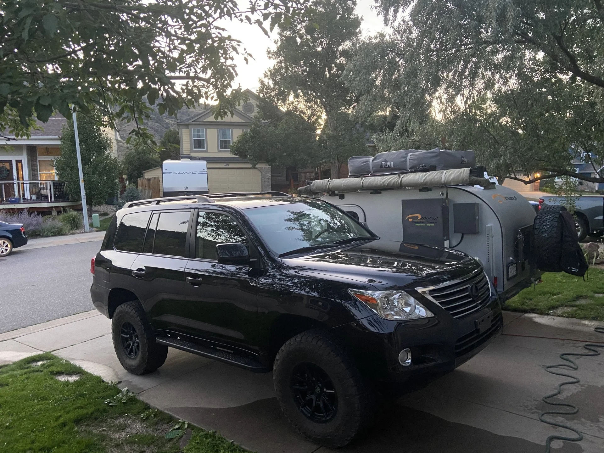

Stock Arms and AHC: roughly 11.3 inches of front travel and 12.5 inches in the back and a full 5l fluid flush. This thing drives better around town and flexes just as well as my old 2.5 king setup. Can’t wait to go play in the mountains this weekend.
I was all by my lonesome so I apologize for the “poser” shots with no one driving. But just wanted to check rubbing.

Cheat code unlocked. That rear axle is doing some obscene things. Well done!

Where is the NSFW tag? Damn.
I'll be updating those bumps with Timbrens, but honestly another .5 drop on the rear bump would keep the 35 off the inner fender. Plus it's a very acceptable amount of rubbing. Absolutely no binding, creaking or weird noises of any kind.
30mm of front spacers and 20mm rear spacers and raised that rear shock mount 2 inches. 0 compromise to the ride. Since I did a proper flush, the truck feels brand new, my wife even said something in the morning about "how great it drives now...what did you do."

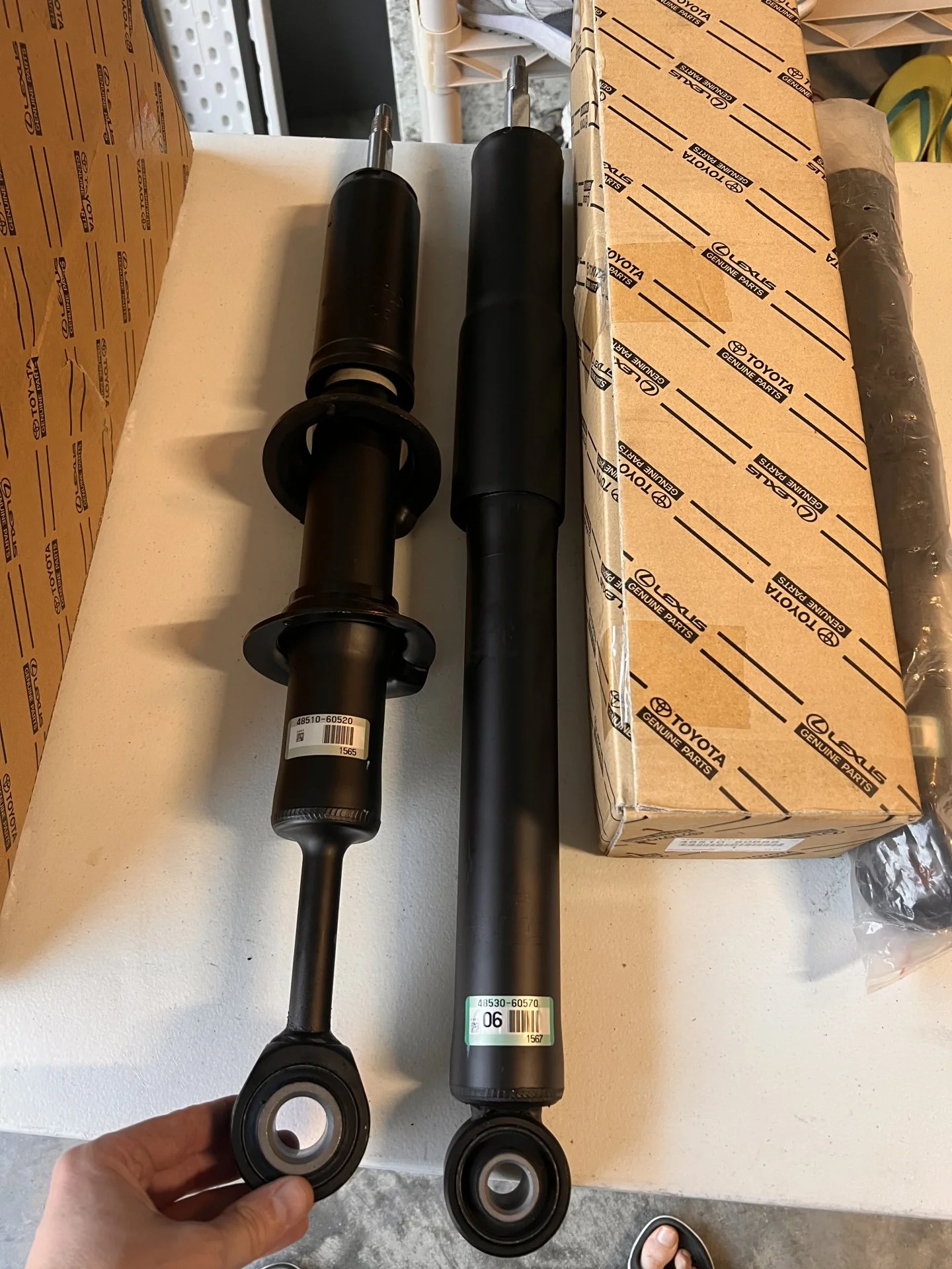

Does anyone happen to know off hand the stock rear shock length, compressed and extended?
19 3/8 compressed. 27 7/8 extended.
