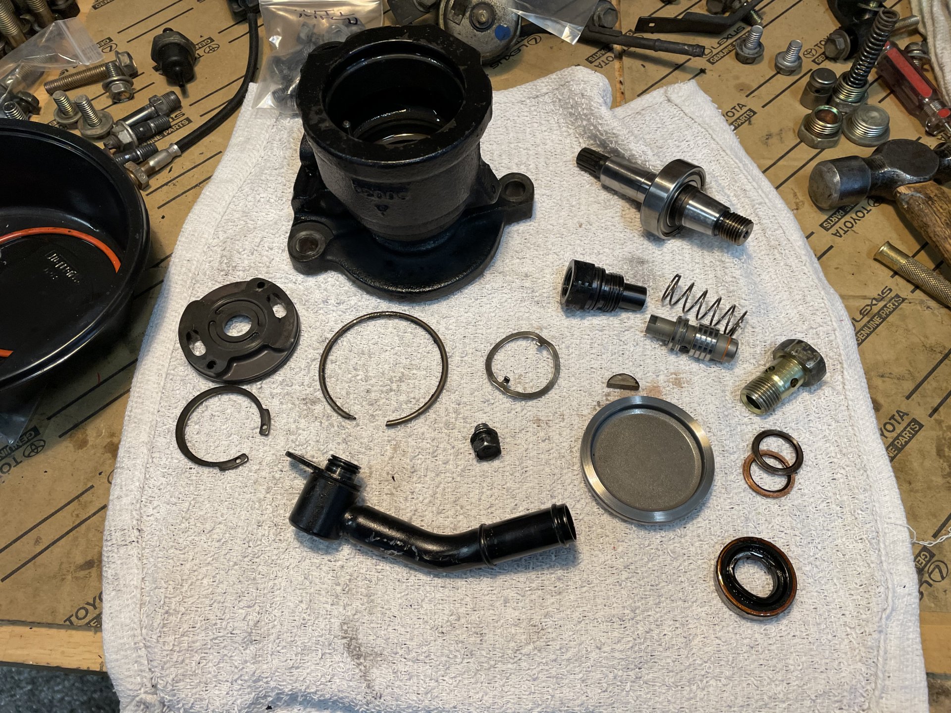

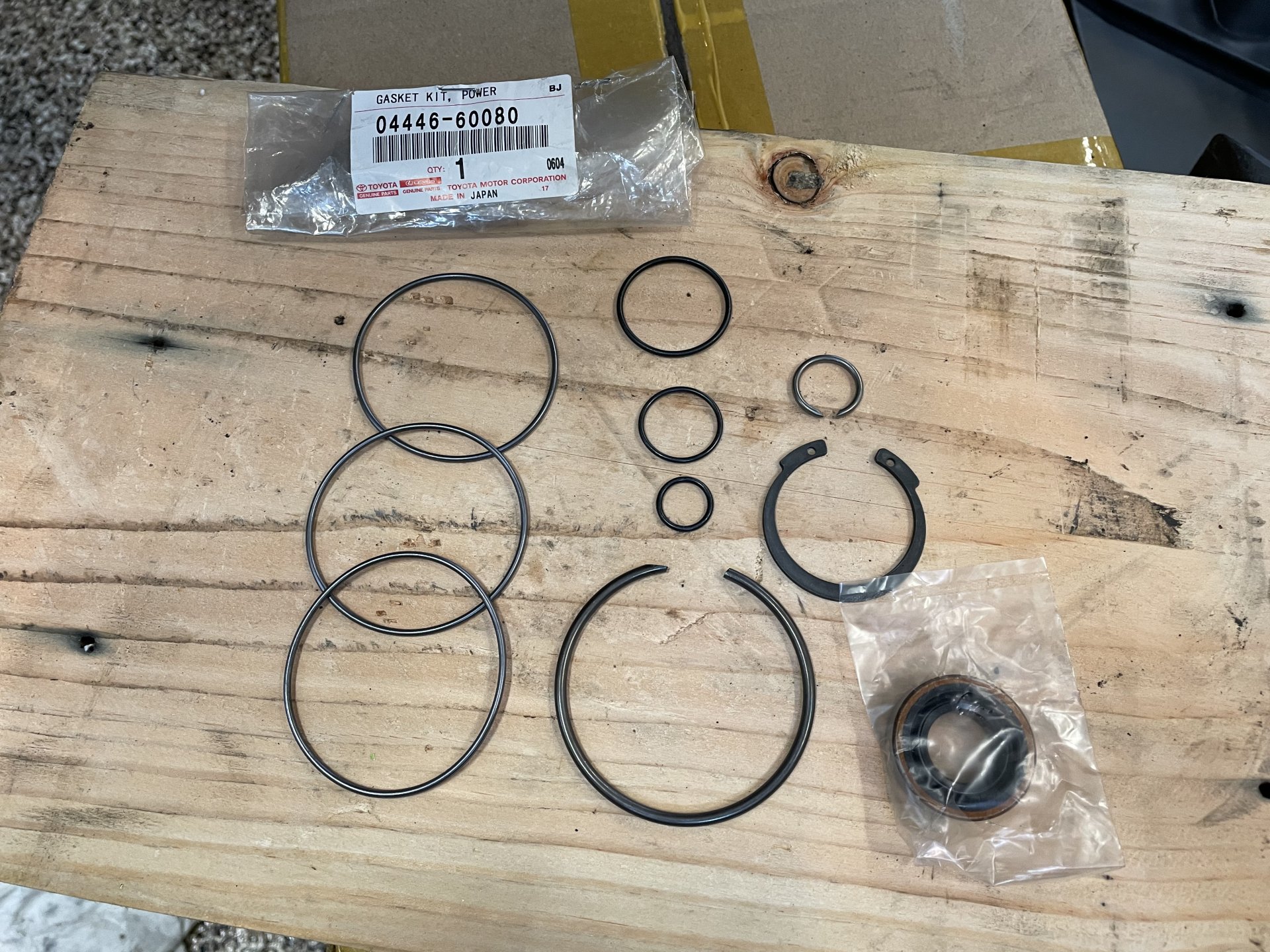

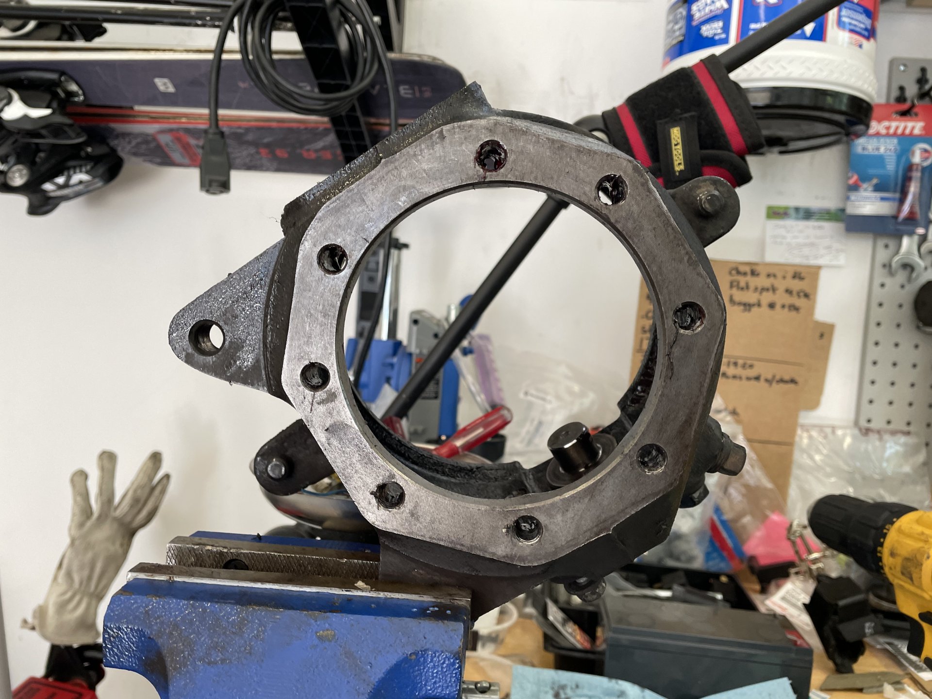

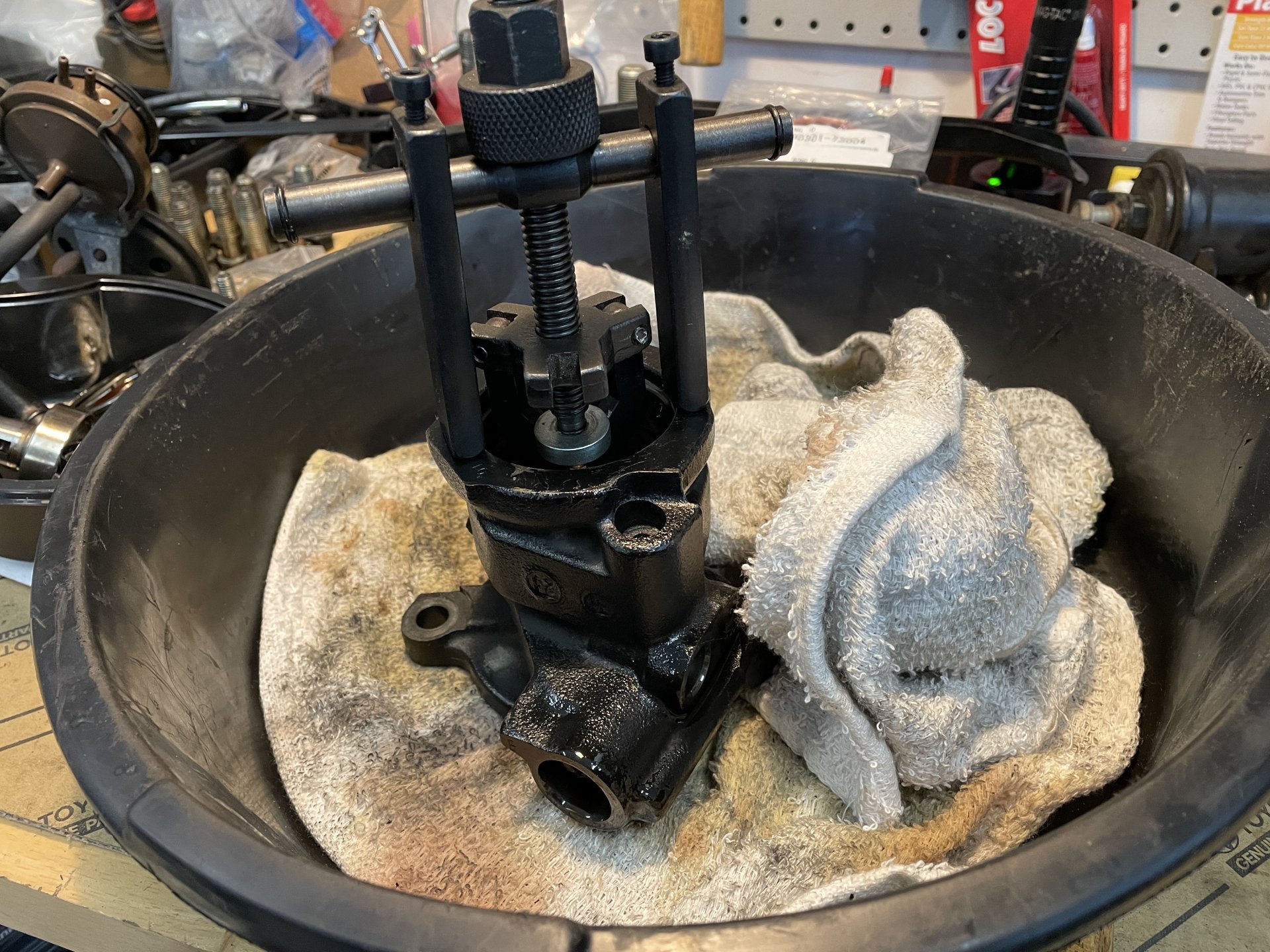

Had a couple free hours so I rebuilt the power steering pump.

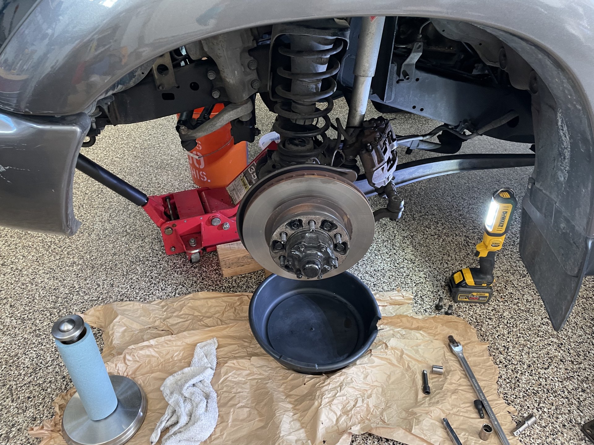

My vise broke and I am waiting on a replacement so I had to improvise. Worked great. I also used the same setup to torque the nut to 54ft-lbs.
New parts bag from Toyota.

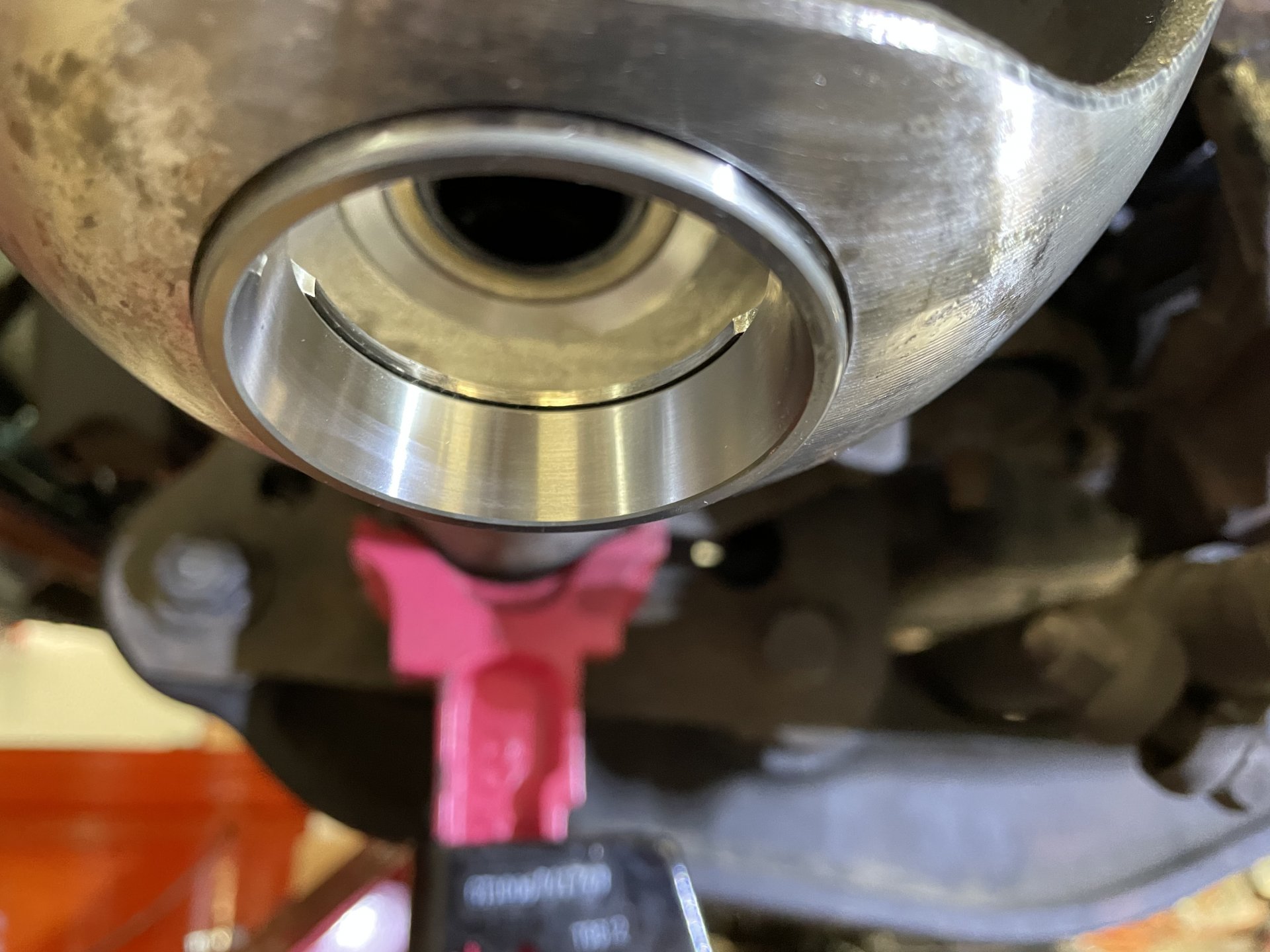

I have a pilot bearing puller that worked great to remove the last part of the assembly.

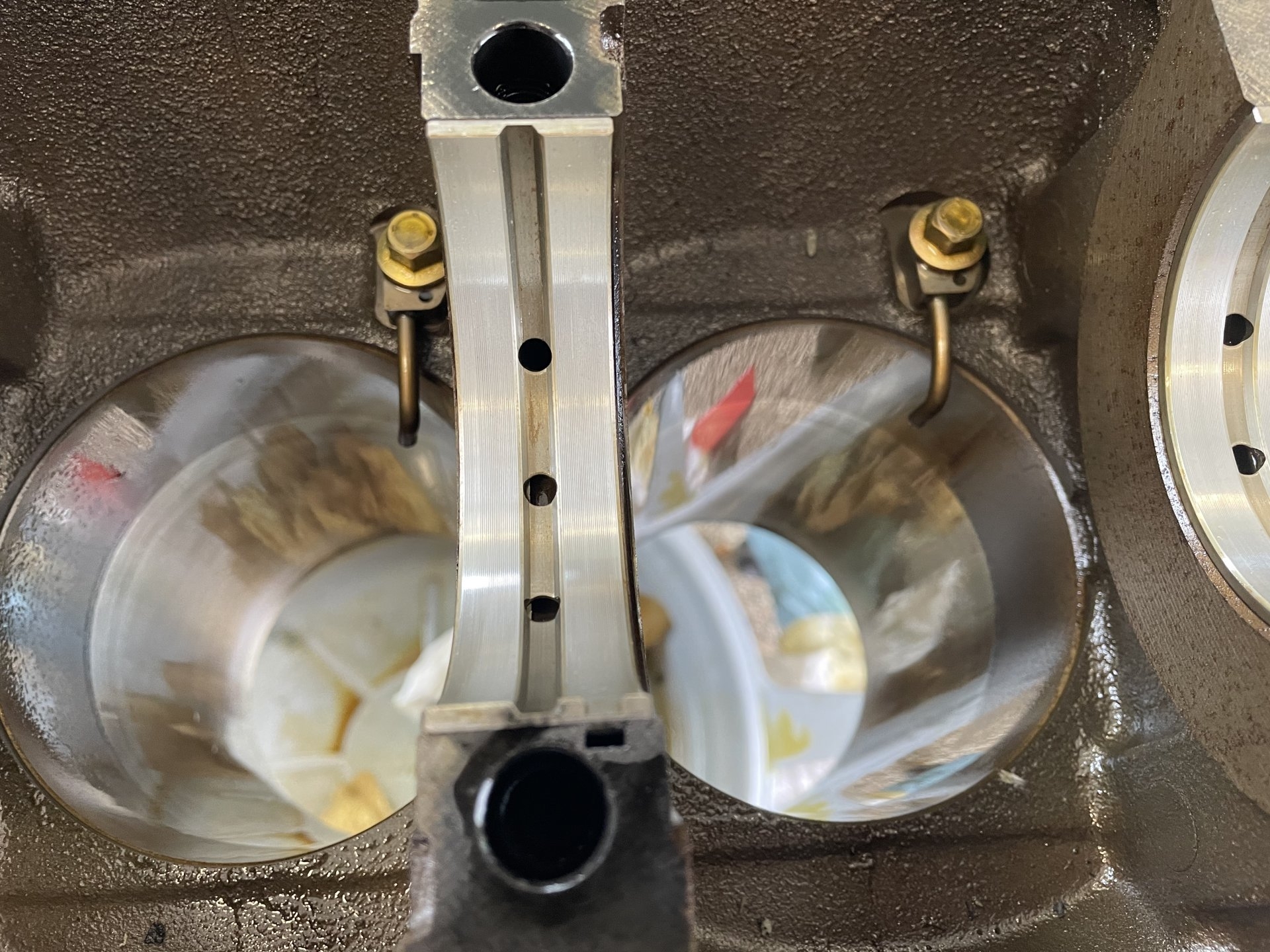

All parts cleaned and inspected.
Reassembled and a container of old wear parts.

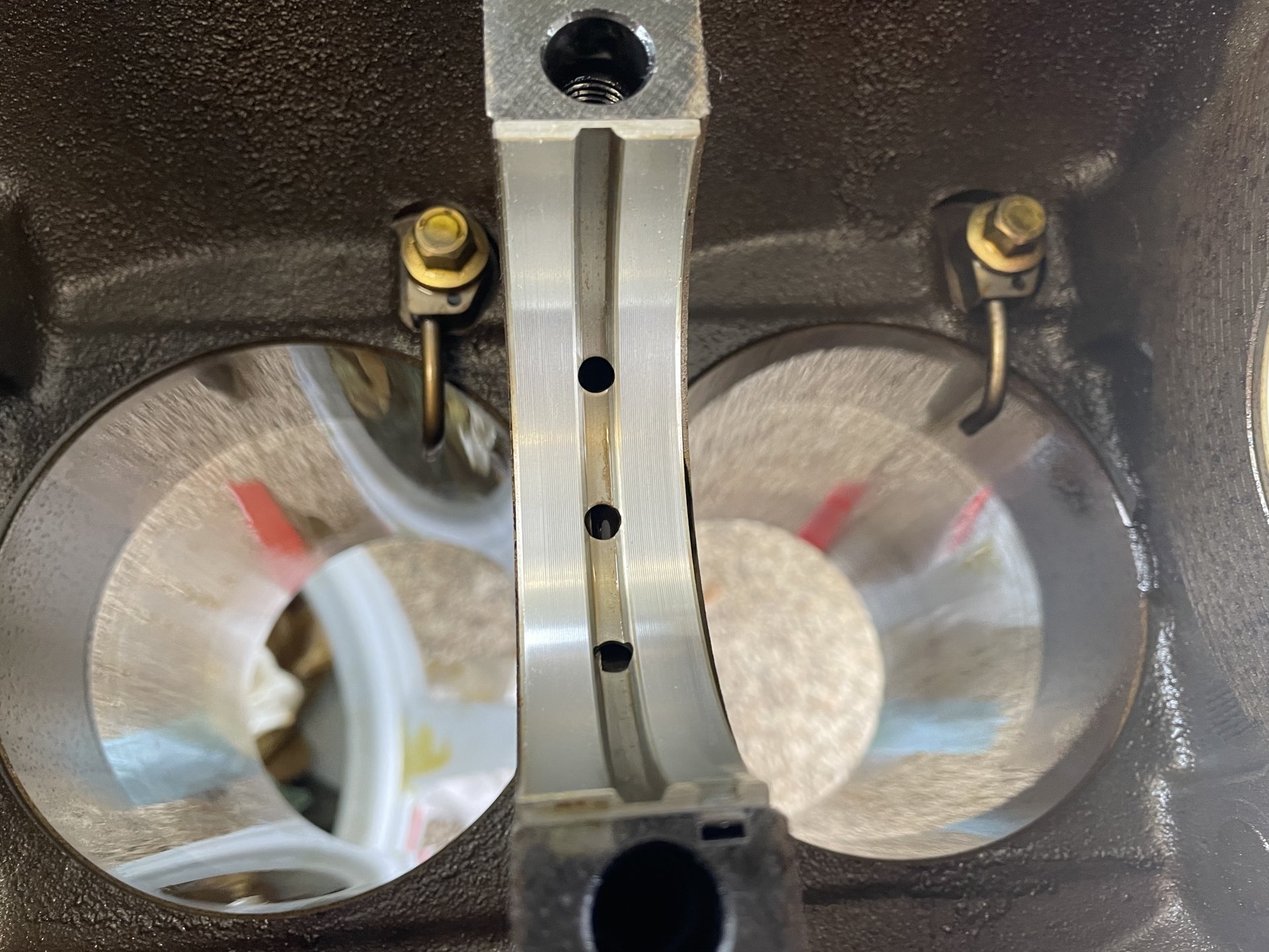

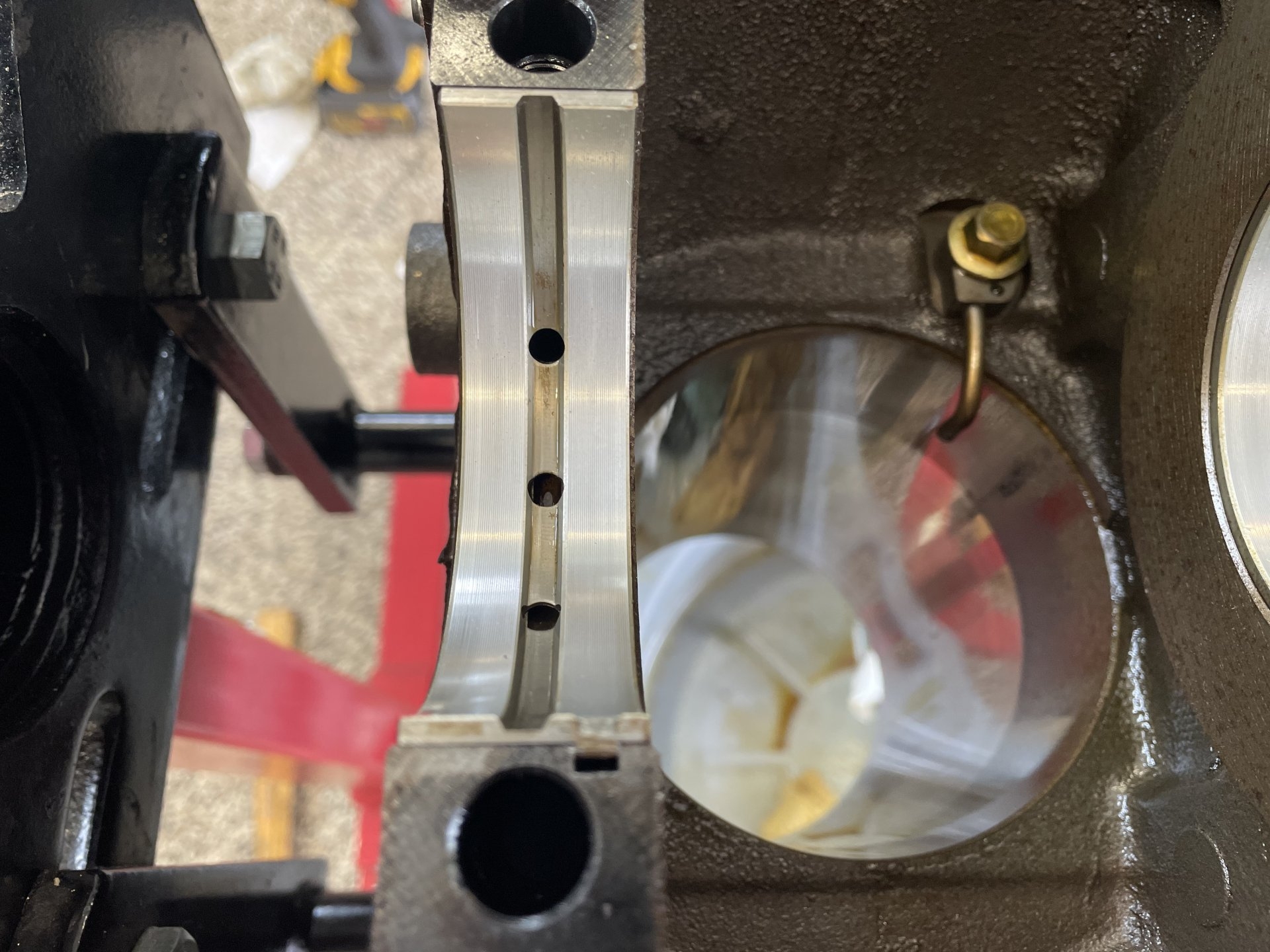

It really is amazing how it's barely worn. I think new rings and the engine will run another 200k.

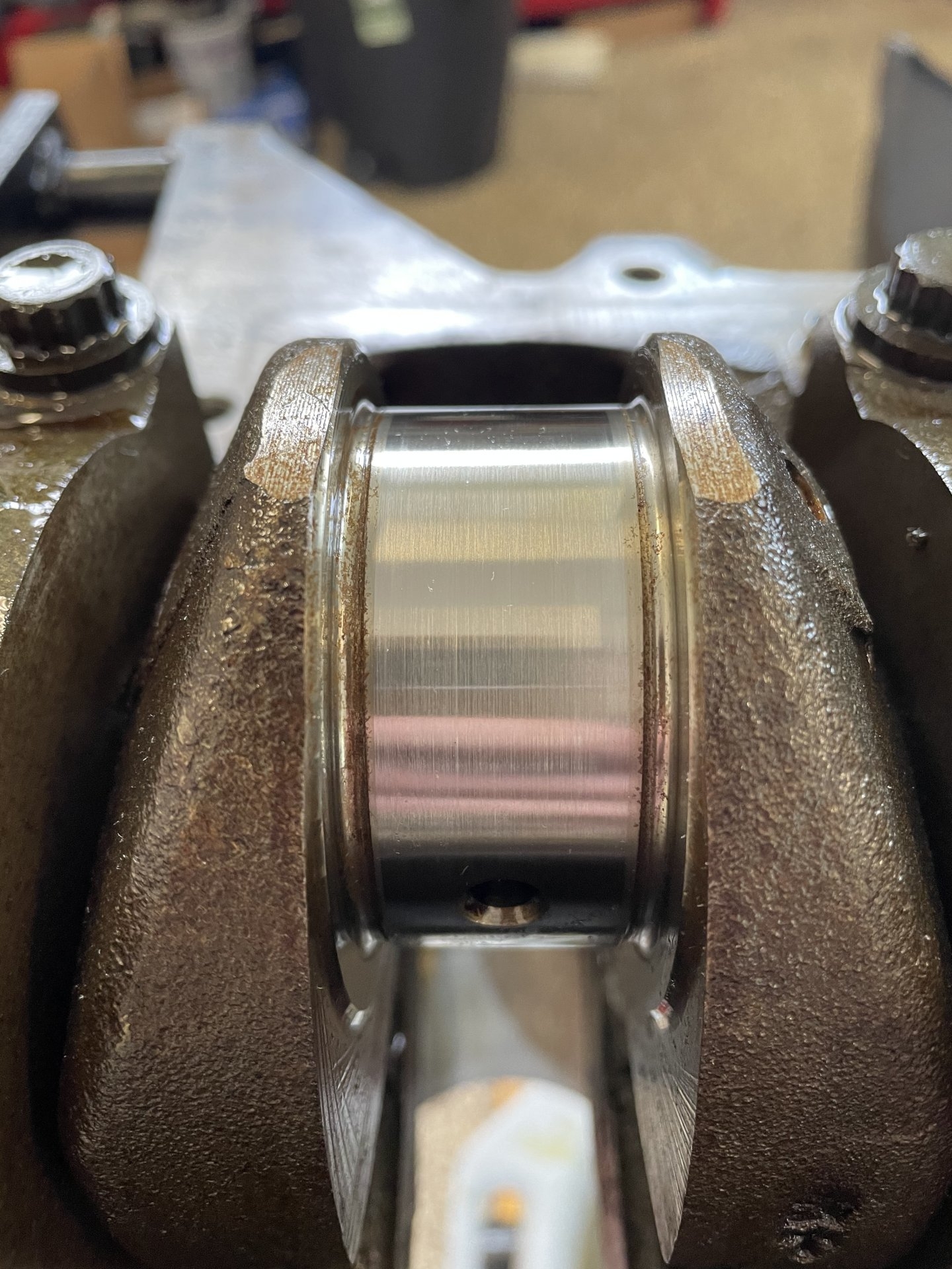

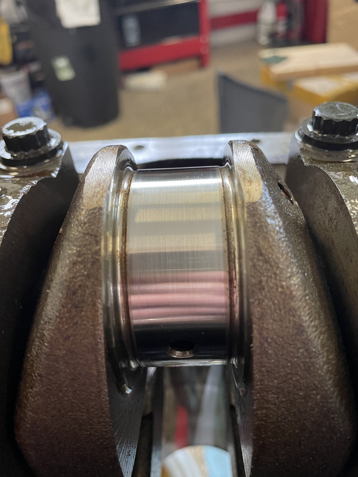

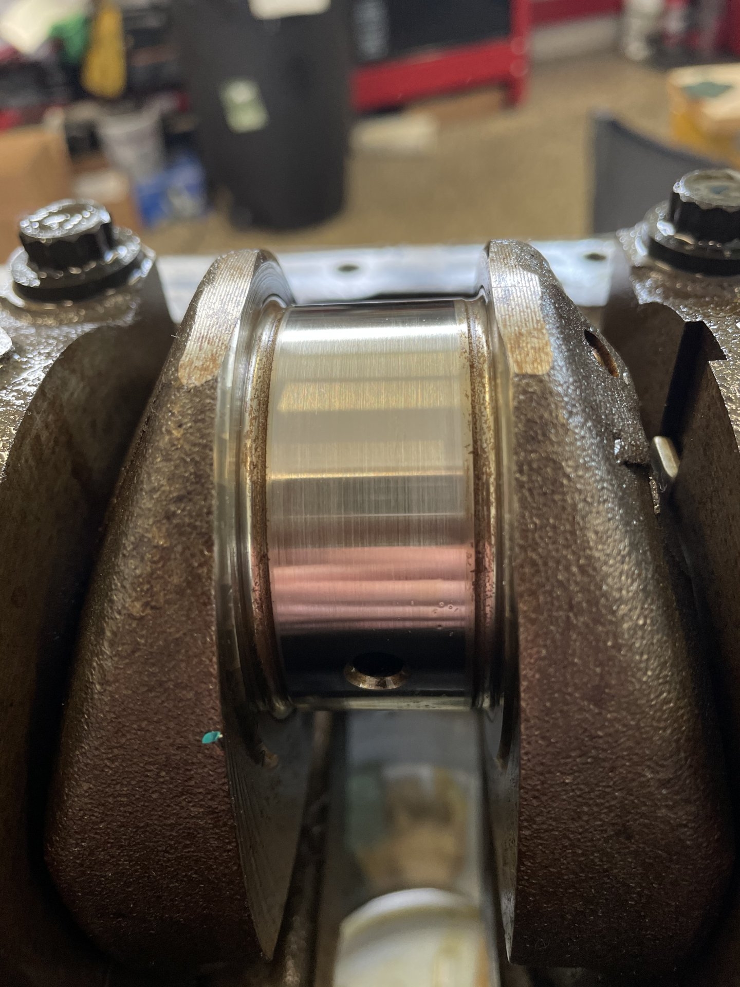

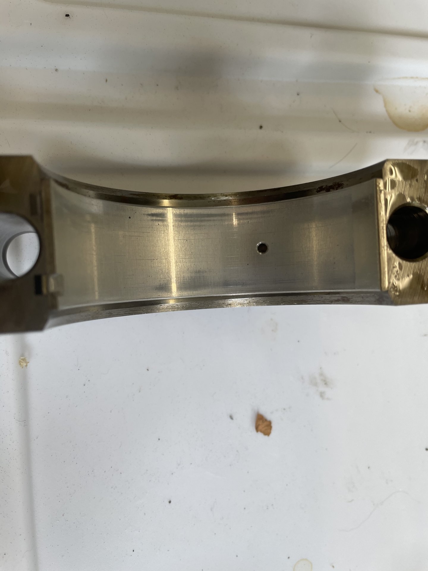

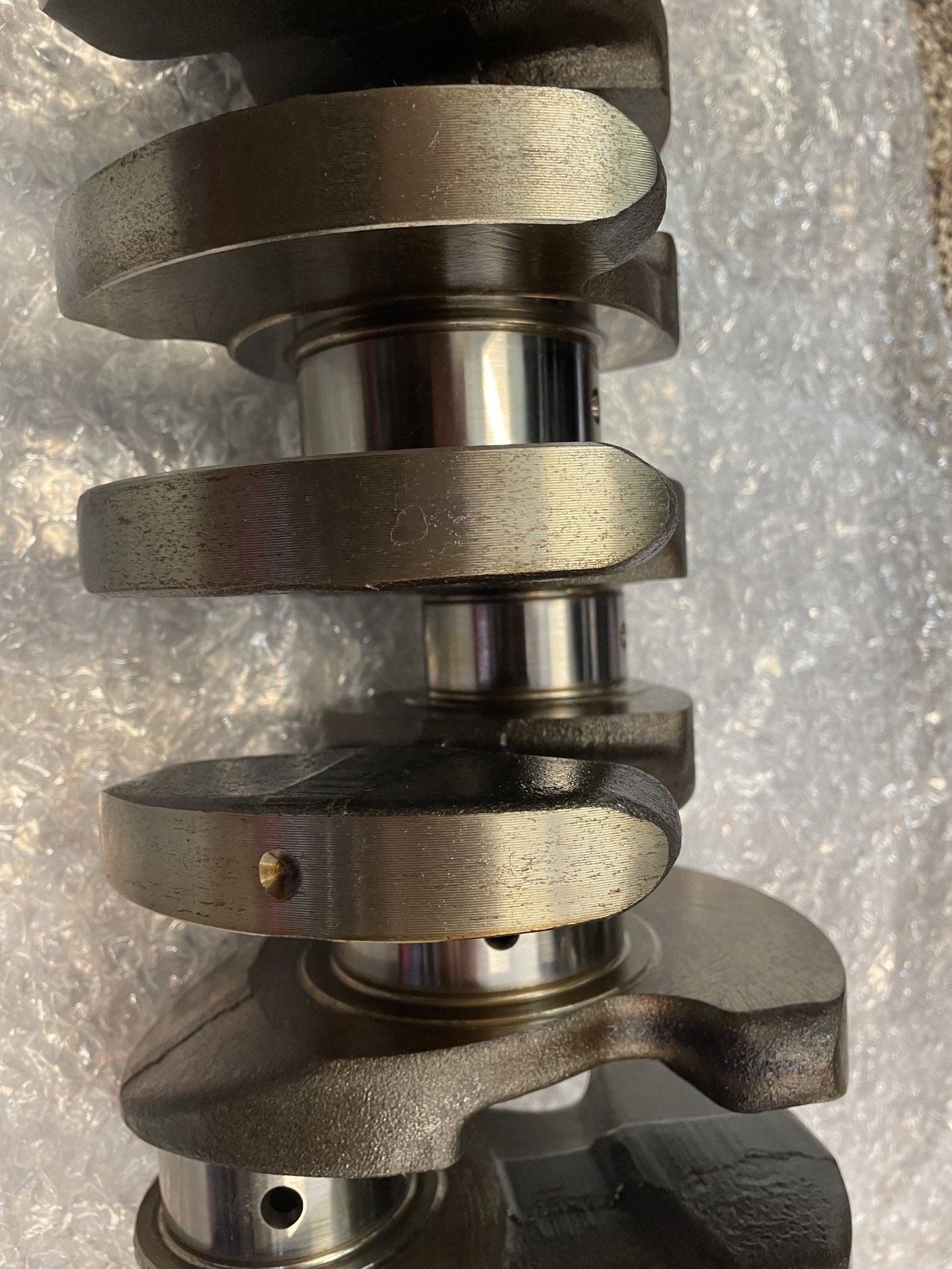

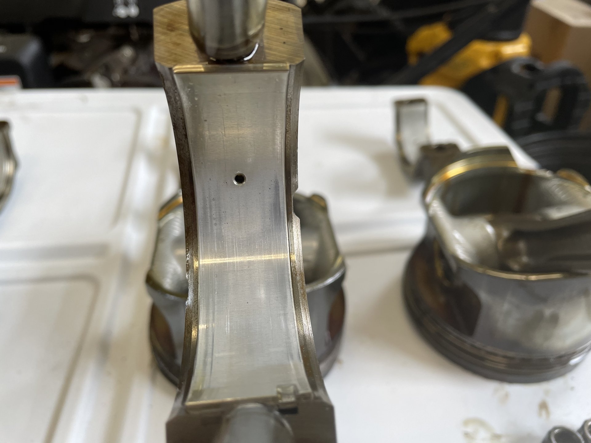

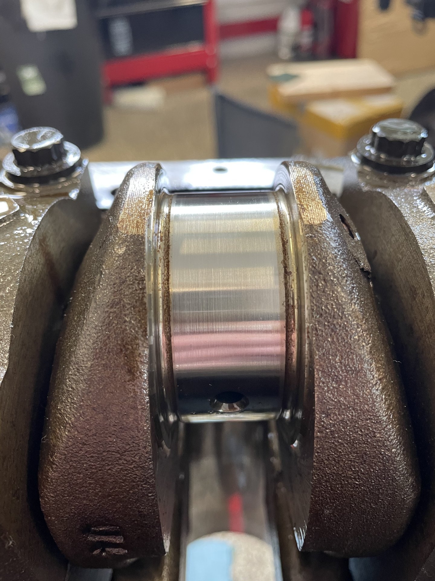

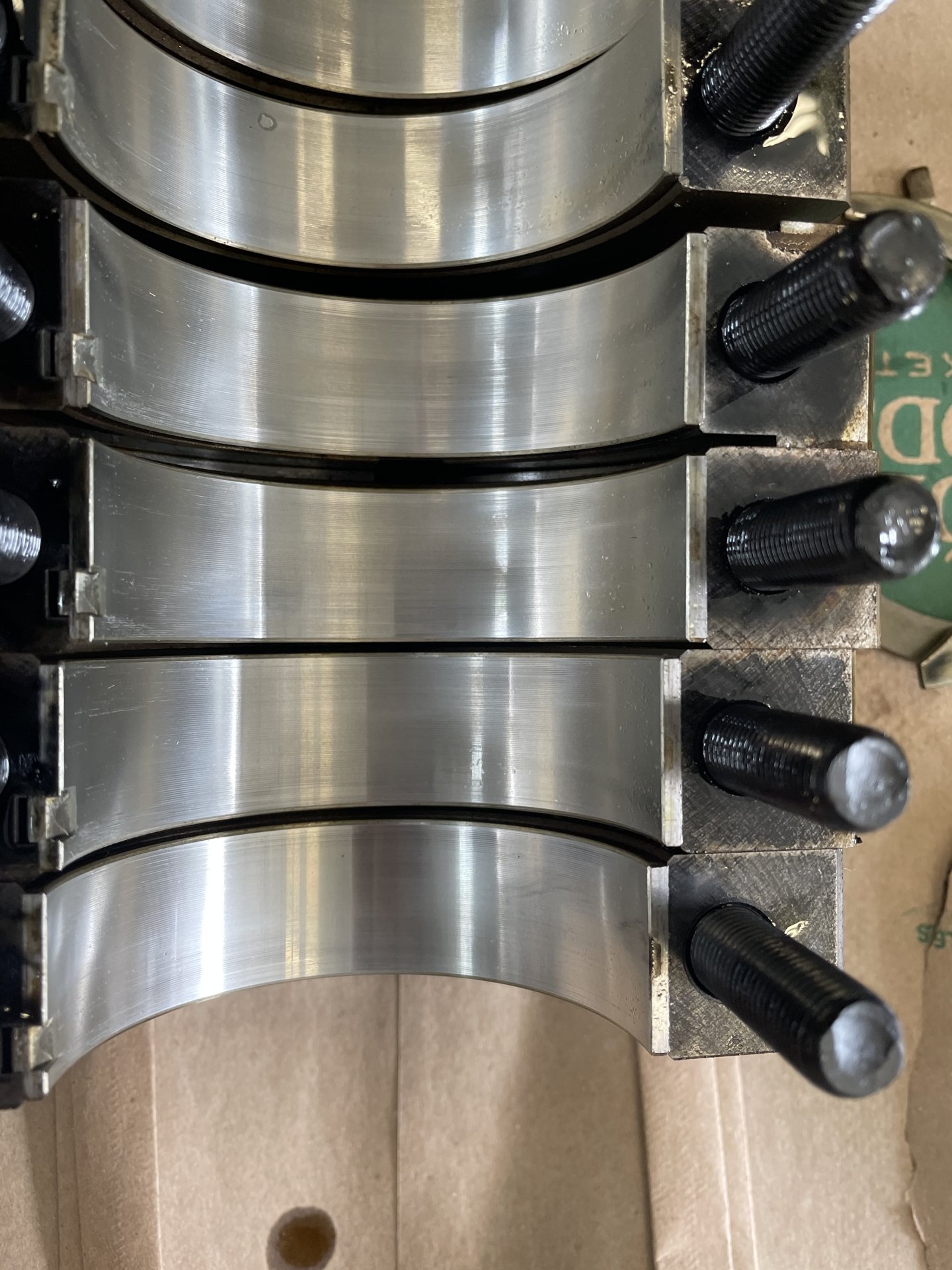

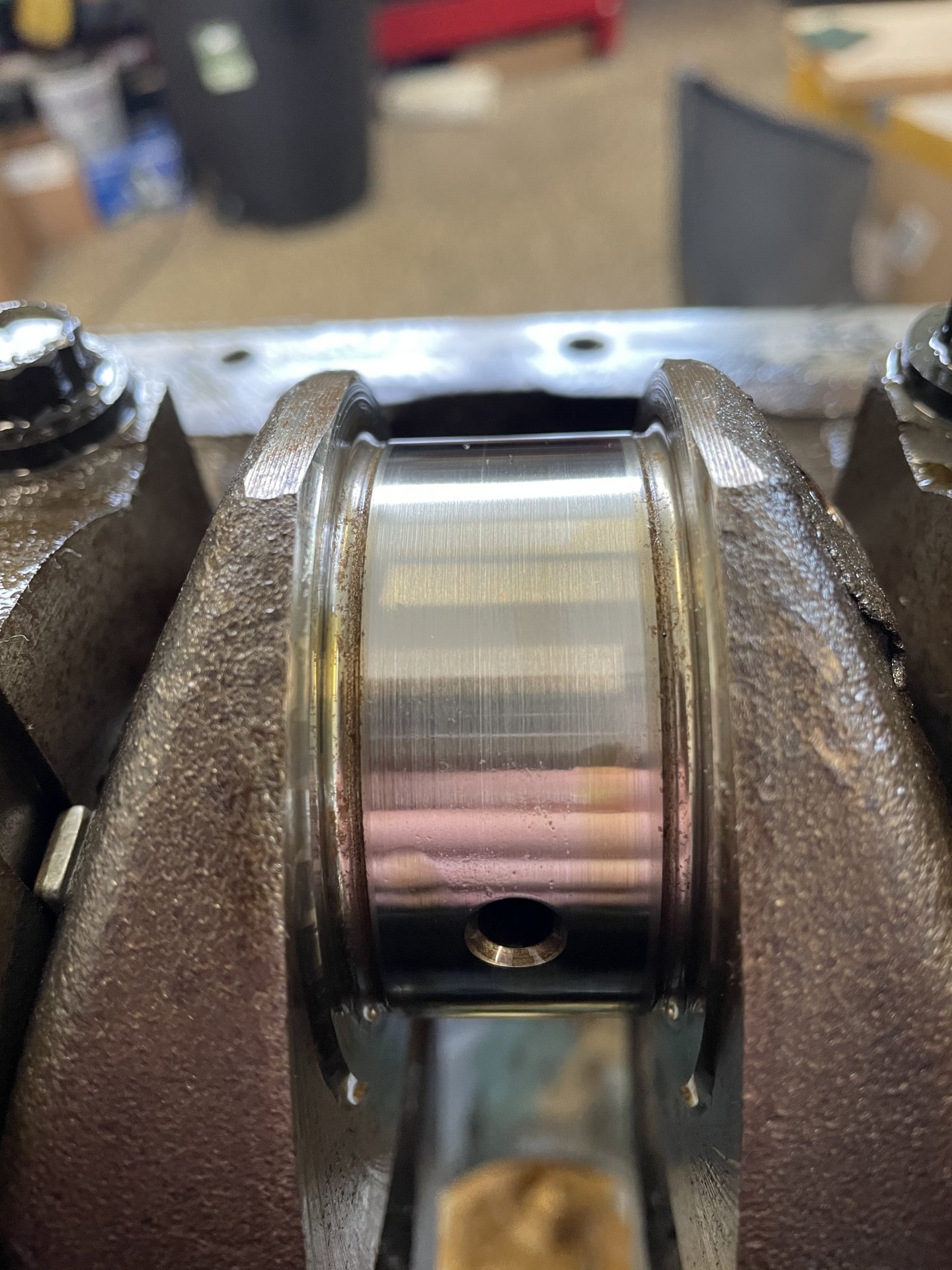

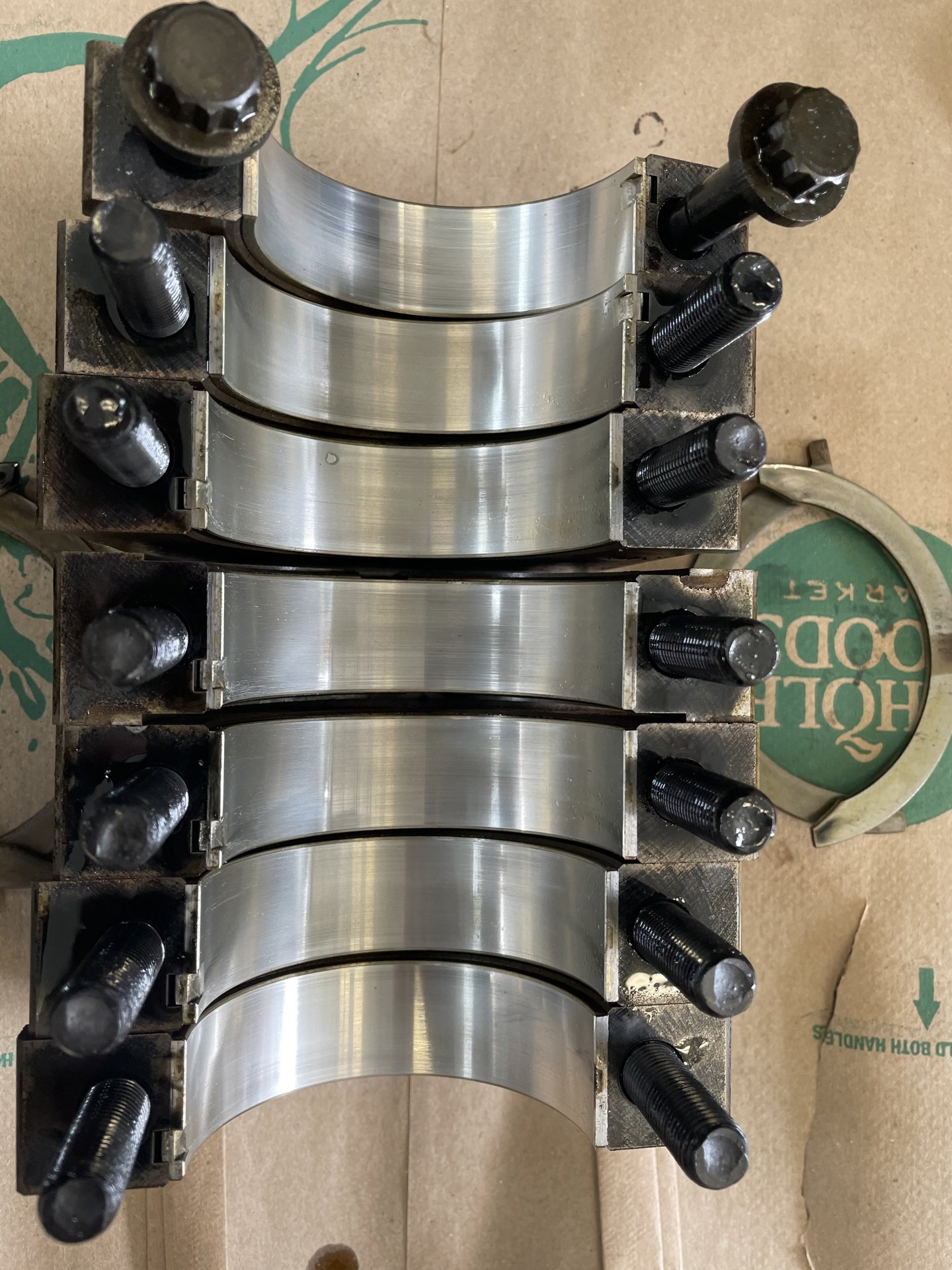

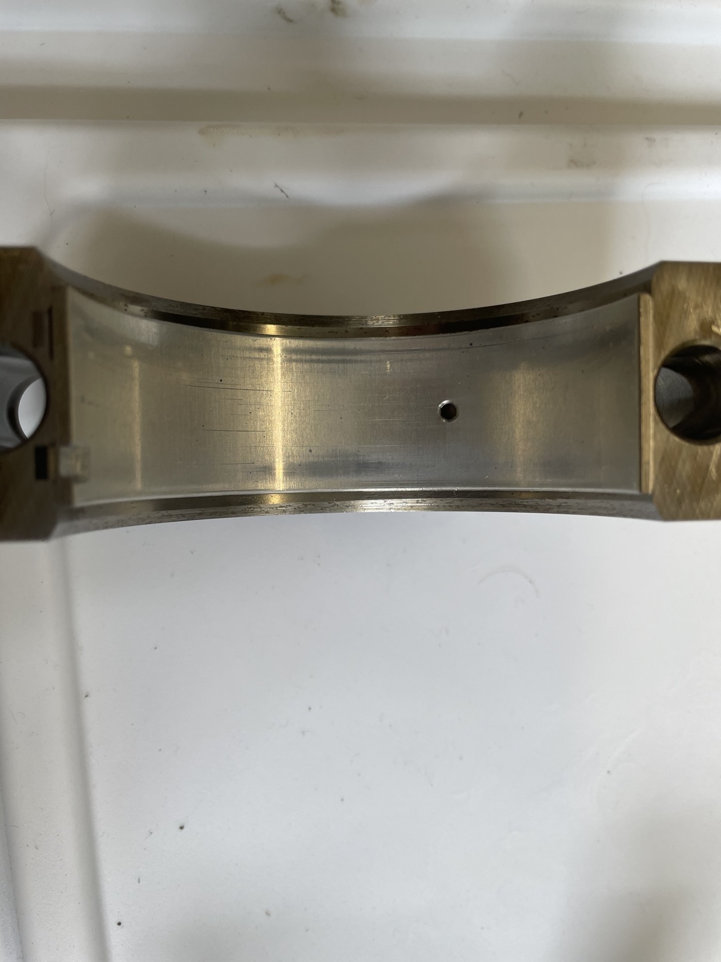

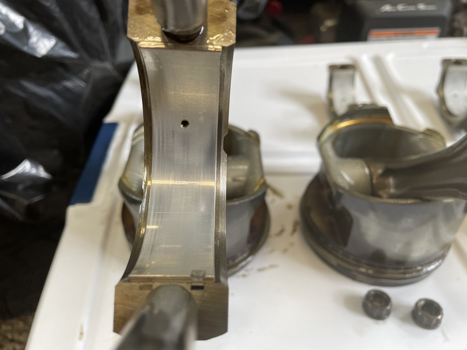

I will put the new motor into a different project. Let's inspect the bearings and crank then button it up with new parts. If you see anything please let me know.
