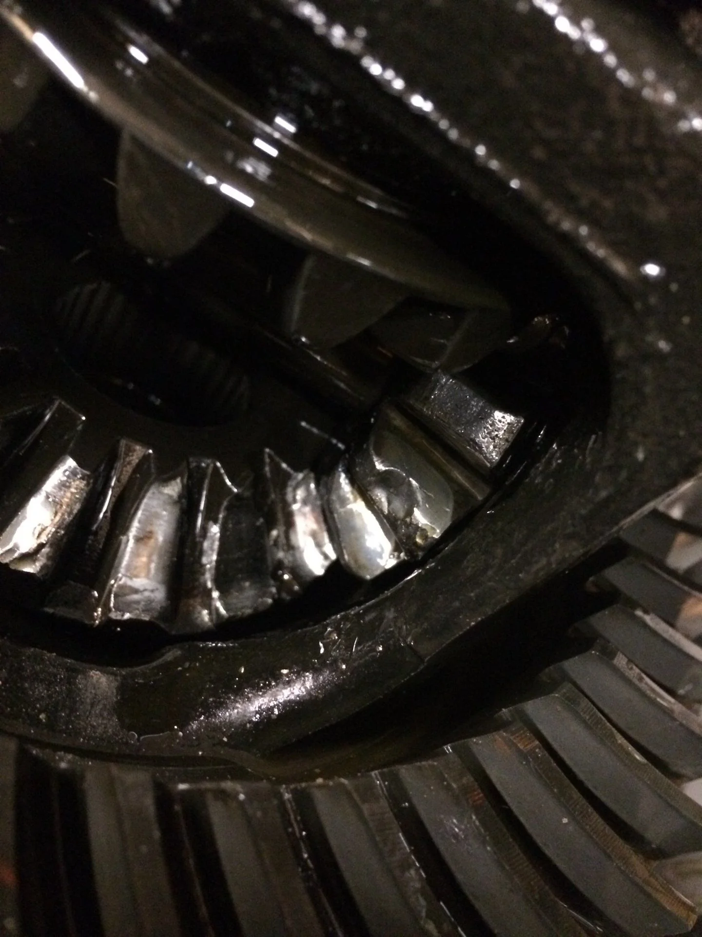

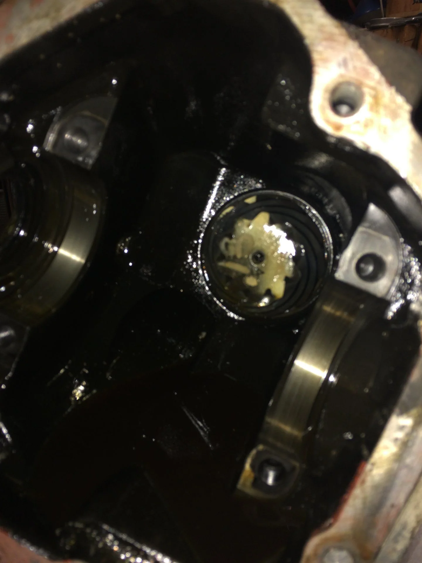

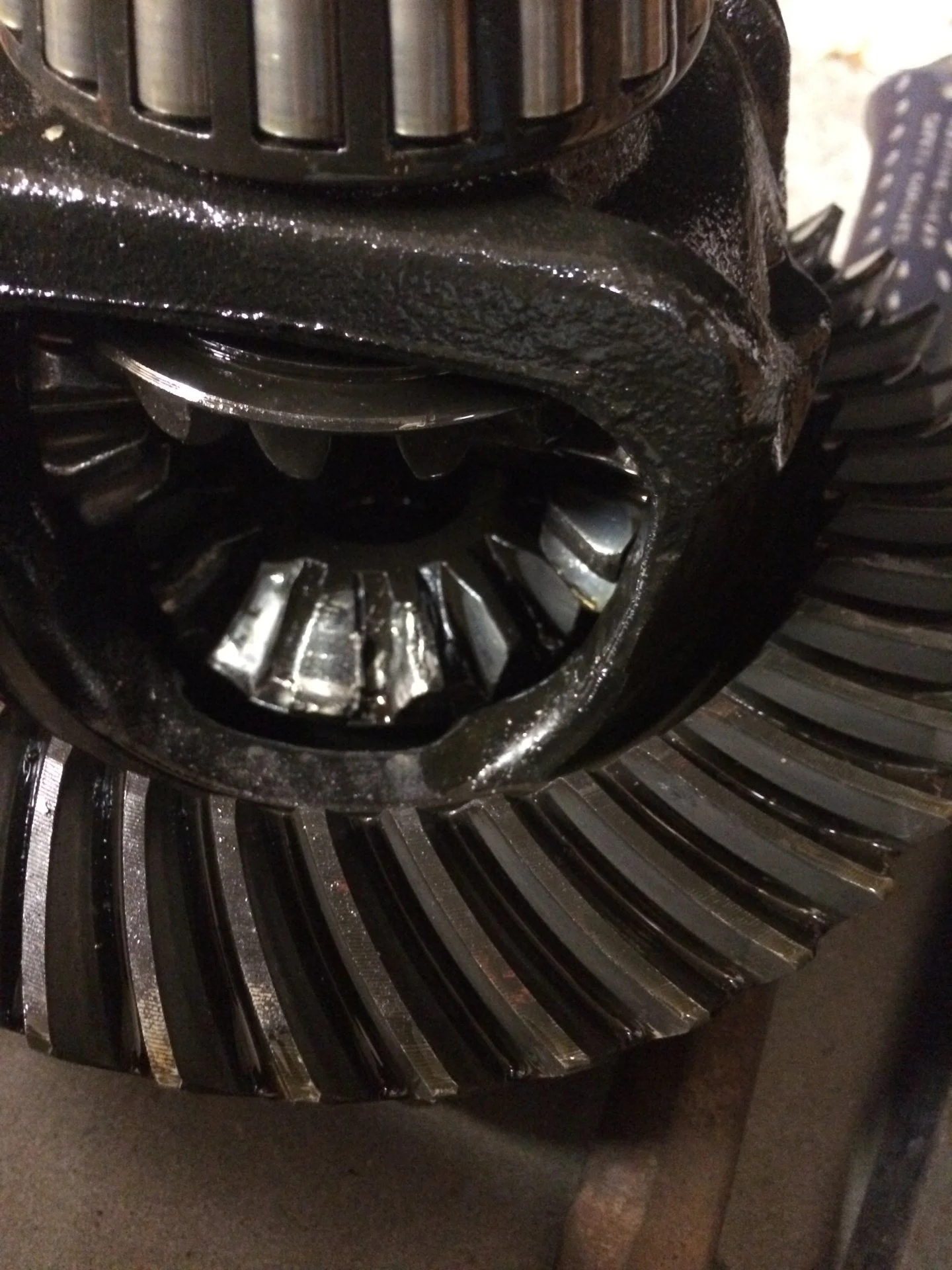

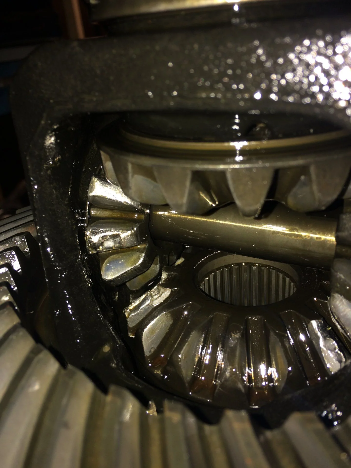

Not related to Logan's Run event planning (top notch by the way) but it shows the inside of Georgine's front third member. Ring and pinion fine, blew out on inner gear and thrashed on another one a little. I am guessing it'll buff out.
Fix the diff on the 100 and then fix the 80 for wheeling. 80 has all the solid we need.
How did you do that? Slipping/Slamming a wheel off a rock?
Poser Rock attempted mounting, brake, a lot of skinny pedal trying to gain a photographic angle, shotgun blast, and a lot of quiet people around me. Good times. Poser Rock was not effectively mounted. I; however, was effectively screwed. Still smiling though.
Was that from the brake & throttle together? That technique works but worries me. After hearing my CV pop in my old Jeep GC (first 4wd) the throttle + brake always makes me nervous.
Yikes, definatly something to be aware of.
Brake and throttle AND old man lack of response time. I allowed the truck to bounce on three wheels, allowing more pressure on the spider gears than should have been. It was a bone head move on my part. The fat lady didn’t want to perform and I wasn’t listening to her.
Was this on the 99? Get East coast to set you up with an arb in the front.
98/99 ticking time bombs if you wheel them. First thing I bought for mine was a TJM front.
