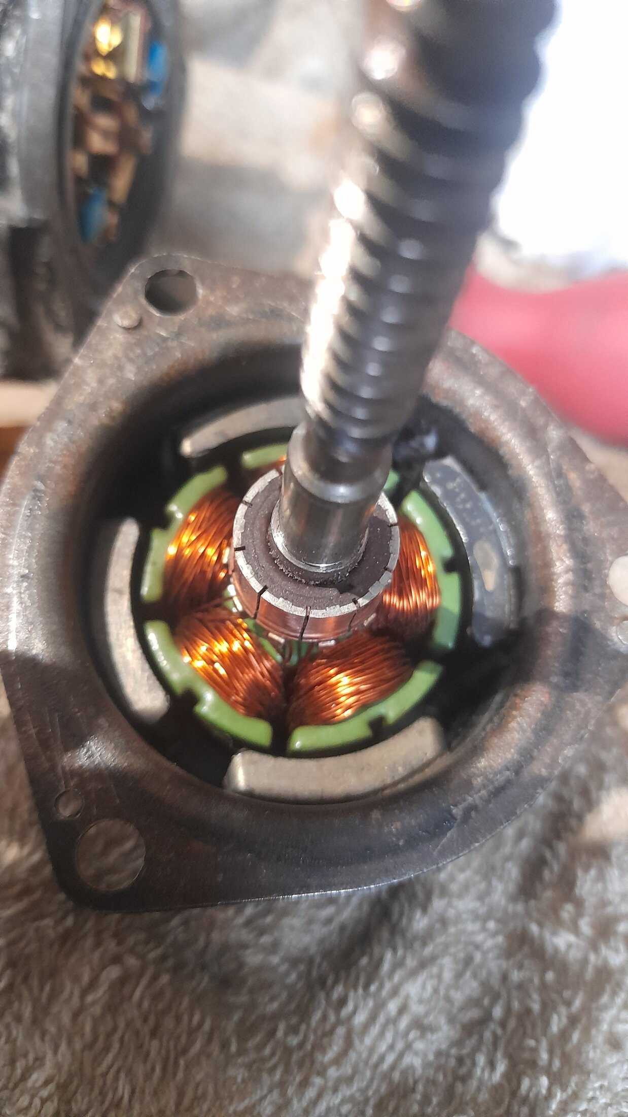

Fixing my (got stuck engaged) rear locker. Took all off, cleaned it out etc.
Was in good condition but two of the magnets were loose.
Reglued and in NSNS configuration but wondering if polarity makes a difference.
Can feel it trying to move the motor for 1/2 sec (either 9v or 12v) but appears to be binding. Switching + or - no difference. I don't have any gears in so its just the shaft with the electric cover on
Checked via calipers and magnets 'seem' to be in the right position etc.
Manually spinning the motor/shaft in the cover seems harder than I'd expect. Would have thought it would be a lot smoother.
Wondering if I need to grind down the magnets a little to see if gets it going. Maybe put some chalk on it to see where touching
Maybe the glue is too thick and is pushing the magnets to close to the armature? 🤷‍♂️
checked via calipers and 'seems' all the same (at least the two that I replaced , comparing them to the two existing ones)
That’s not a good way to check it. Put the shaft in the housing and the cap in place so the shaft is captured on both ends.
agreed but with motor and shaft in place with cover on (with 3 screws) I'm not getting any turning.
Methinks I'll take the 2 magnets off again and double check polarity. Right now NSNS is the orientation of the 4 in place but I DON'T know the polarity.
On the PDF file (Overhauling the Differential Actuators.pdf) it shows NNNN but I presume thats the polarity I need to reach
You should be able to rotate the some if the cover and gesrcsssembly aren’t installed.
will de-grease and try but seems 'stuck'. I'll check my magnets in morning and see if they are the problem
