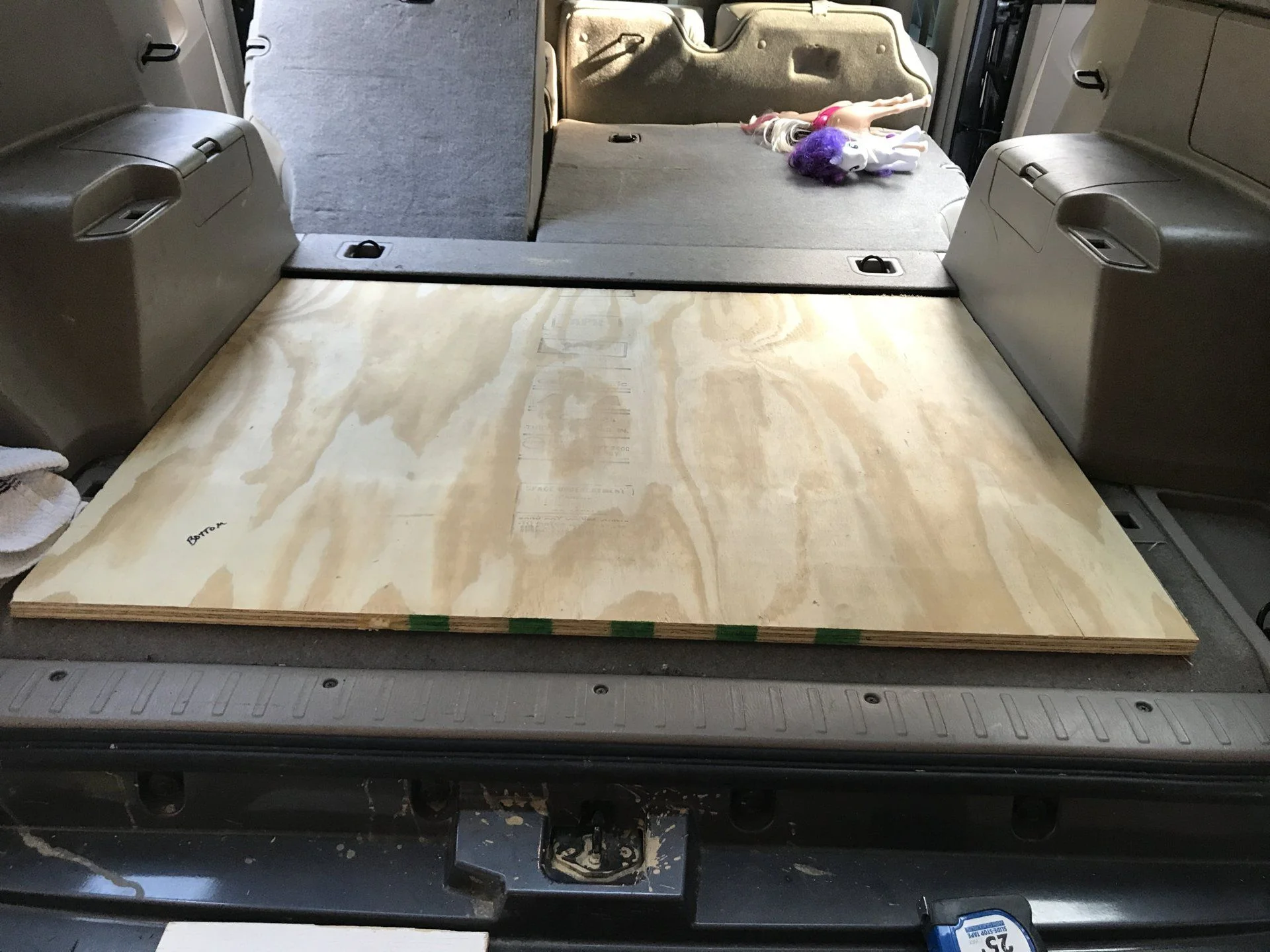

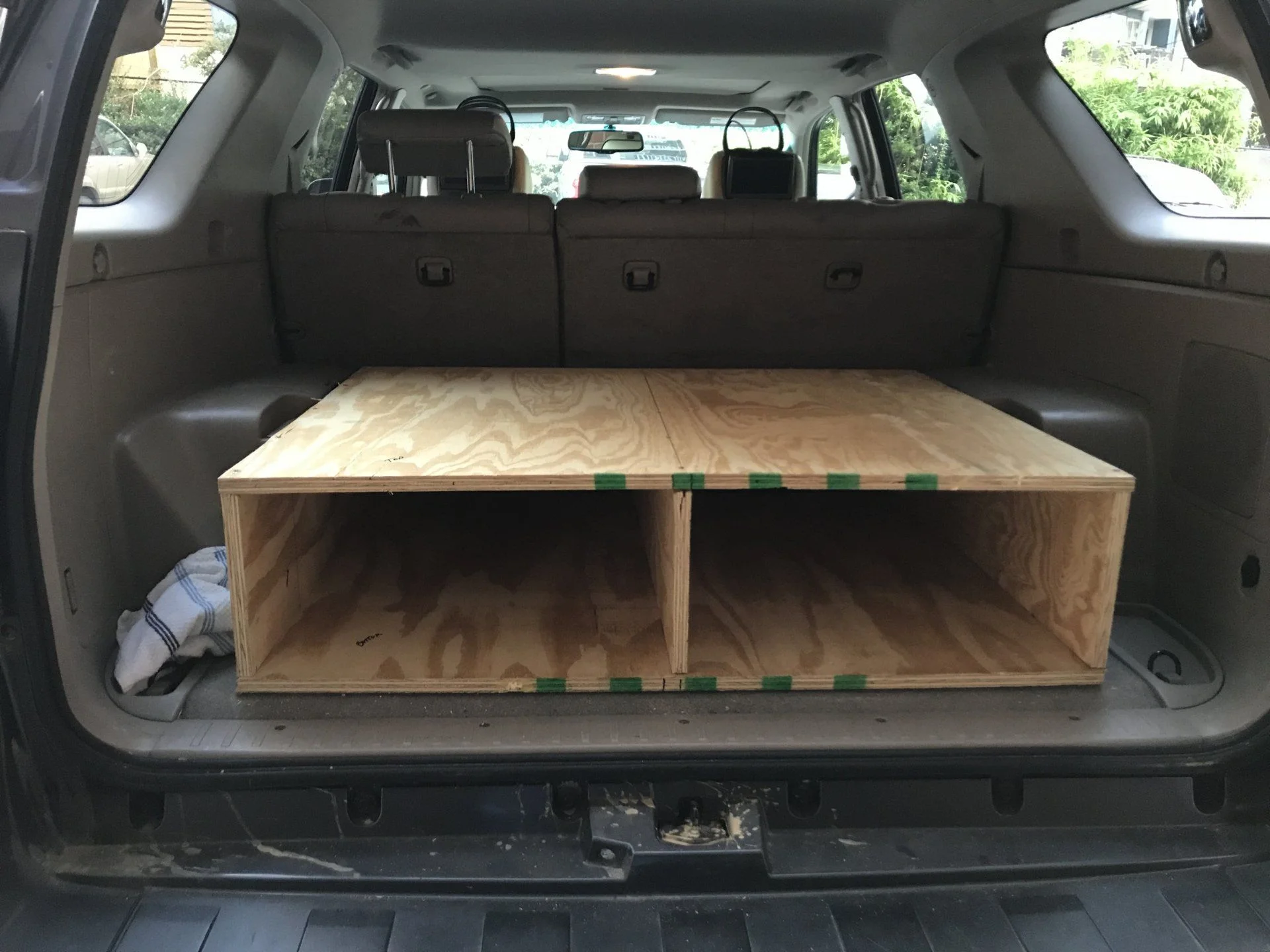

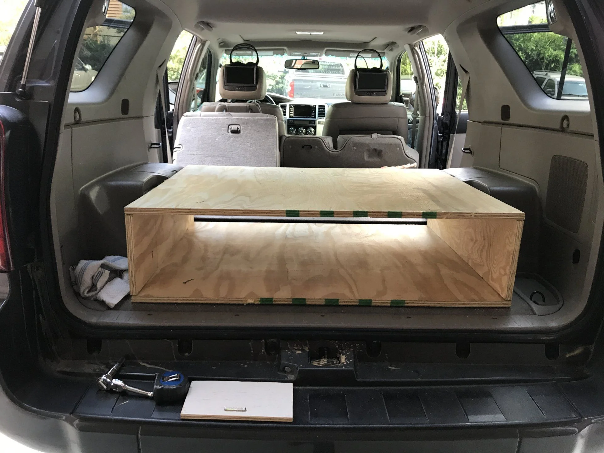

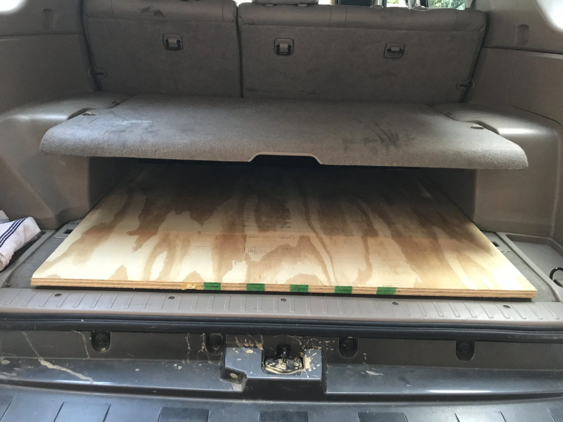

Well, let's just say I probably won't quit my day job anytime soon to be a carpenter but not terrible. Realized as I was trying to measure everything that I really didn't need the factory shelf/tray thing and it was just limiting my size of the box and drawer depth. So, I took it out. The main box is roughly the same height as the trim for the wheel well. I can still access the little storage areas on those as well. Thought about doing a larger top piece to fill in some space but decided against it due to my lack of carpentry skills and tools. So I finished the base box part today. Might still need a back piece and then I have to paint it/cover it with carpet, and build the drawers. That will be a challenge because none of the stuff came out as the same size I measured, which I attribute to my lack of skills. Anyway, we'll see how it goes. After I get the rest of the design figured out I need to make sure it's secure. (Maybe a tether or something.) Then figure out a secure mount for the tire on top of the box. I'd like to have some room on top with the tire for other stuff and maybe like a fridge or something at some point?

Don't know your plans, but a simple slide for the drawers, is a couple strips of small moldings tack to the bottom and some candle wax to help them slide

It's just like a strip of plastic? Or? I'm not really familiar with that method. I bought some slides when I was getting all the other stuff from home depot. Not sure what the kind was but they seem pretty sturdy. I was planning on putting some spare parts back there in the drawers (like CV axle and maybe tie rod?) and tools so I def want to make sure it can handle the weight. The drawers are deep too so I don't know how much they are going to weigh on their own.
Haven't had any time to work on the truck but I might get out there some this weekend. Do I need to put a piece on the back of the box? Didn't think about that in the original design since it's backed up against the seat. It seems pretty sturdy how it is but I plan to anchor the box down to the floor and then anchor the spare to it so.... Anybody out there a slightly more qualified carpenter than myself?

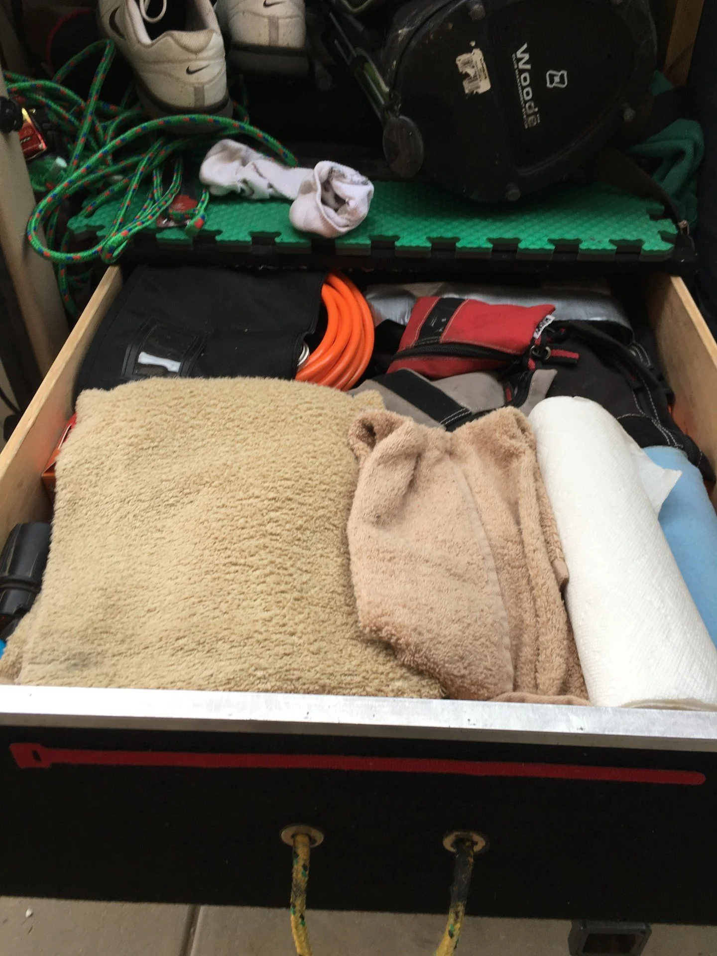

I have a lot of weight in there, only draw back is hills, the draw wants to slide out.
just a couple of wood strips.

The paddle latches are nice and true I don't think I ever locked them but you need to plan for them before you put the box together or you will have to get creative like I did for the latch to hold. And yes I would put a back piece to completely tie in the top remember you need to consider having this box and contents stay in place in the event of an accident or a roll over.

Having everything secure for a roll over or crash has already crossed my mind. I think I'm going to use some turnbuckles to secure the box to the existing tie downs in the back of the truck. There are 4 so it will be rock solid if I do that.

Definitely a solid approach using the turnbuckles to the existing latches. But consider adding tie-downs to the top or sides of your box so you can tie more stuff down to the box.

Yeah I plan on having tie down locations on the box itself and also I am going to build a mount for my spare tire to attach to the top of the box.

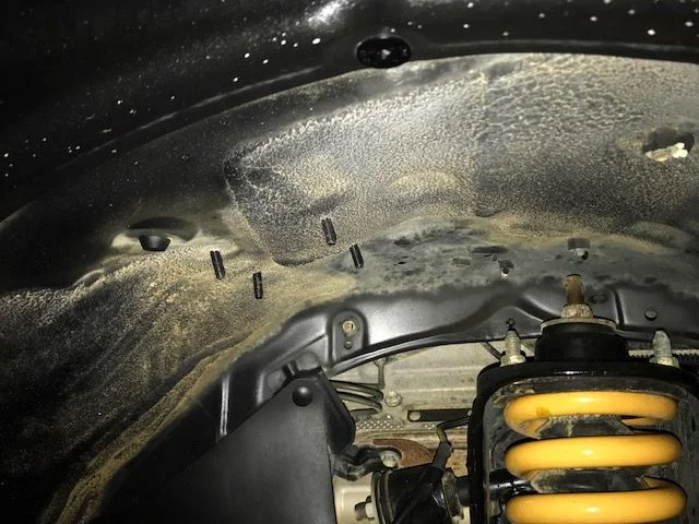

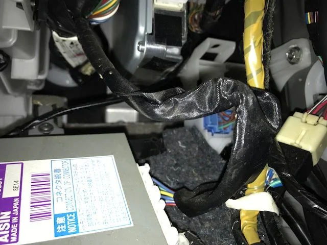

Found the pics from my ARB compressor install. Didn't use the plate to mount it because I didn't read that part of the directions somehow so it's just mounted straight to the apron/inner fender.
Hard to see in that last pic but I actually routed the harness through the factory wire harness grommet under there. It was a pain to do but I think worth it in the end for keeping everything sealed up.
