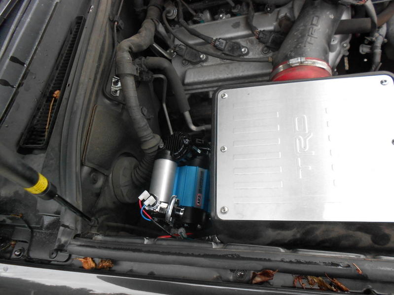

Thinking about mounting the air compressor similar to this (borrowed from the old google):
There is a huge empty spot behind the air cleaner. Also seems there are some pre-threaded holes there that I could possibly use to mount. I am not really crazy about drilling holes in the truck so fabbing up a bracket sounds a lot better to me. I'm thinking some rubber washers to help isolate vibration between the bracket and the inner fender should do the trick.
I've seen it installed there in the same spot on a FJ, same compressor too, seems like a great spot for it

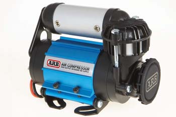

Yeah there is a ton of room right there behind the air box. That's not the actual compressor I'm looking at though. This is the one I'm thinking about getting. As you can see it mounts on the bottom so I am thinking I can modify the bracket or make a custom bracket to use existing threaded mounting holes.
http://www.southeastoverland.com/in...ct_id=313&virtuemart_category_id=99&Itemid=33
Edit: Found a better picture of that compressor mounted in that location:
From this guy's build thread over on T4R:
http://www.toyota-4runner.org/4th-gen-t4rs/115456-t4runner13-build.html
