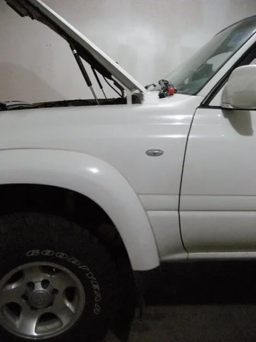

Here is TreerootCO's install of side Marker lights from Mot
attachment.php
In the same thread he discusses how to make the side turn signal blink

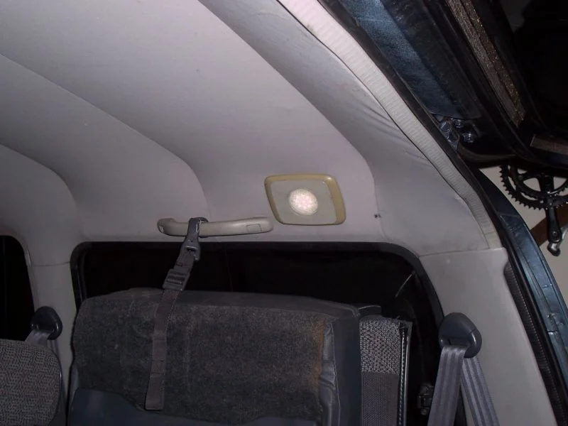

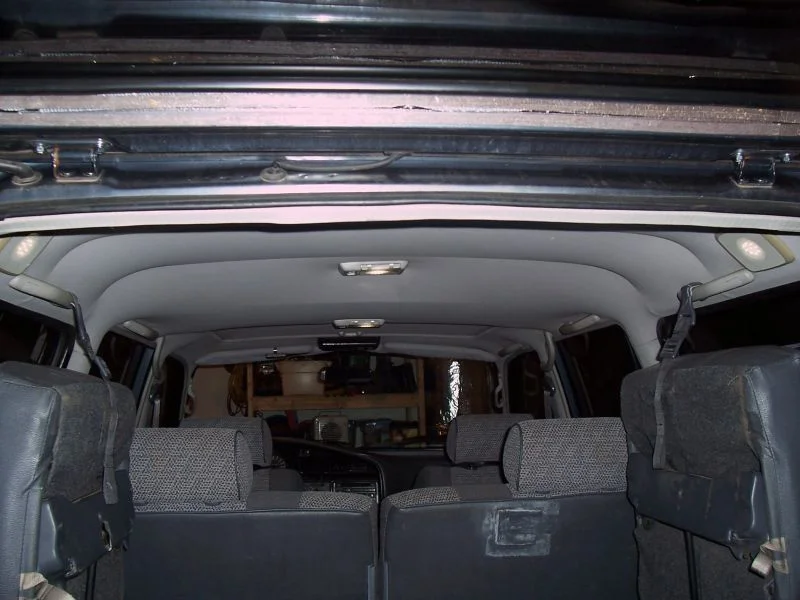

So the 'map' light will come on whenever any door is open, right? No way to override it to keep it dark if you want to sit with the door open (like to work on it)?
I guess adding another switch?
Cool idea, thanks for sharing.
I posted this modification again because I didn't want the link to the original post to become inactive as it sometimes does and wanted to edit the post and add another picture.
George
Correct you will have to add another switch to shut off the map light as it will be on all the time the door is open. This has not been a problem since I have LED's in all the lights and they don't draw much. Its a big improvement to have the front of the cab illuminated when the doors open. My wifes 98 RAV-4 has a map light that has a DOOR-ON-OFF switch assembly that looks like it will fit into the Cruiser but I have been too lazy to confirm this, if it will fit it would solve this problem with a OEM look.
George
it would be nice to have the map light work "correctly"... with the doors if wanted.

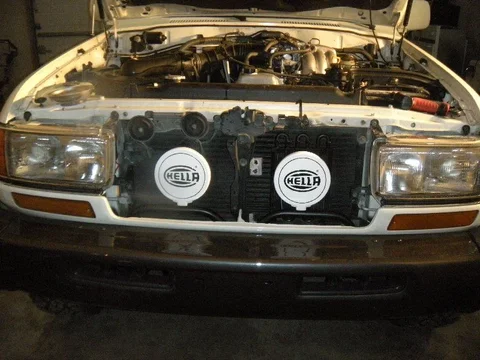

Custom Hella 50W fog light addition to a Bumpitoffroad bumper build. I paid $130 on E-bay (2000 Camry fog from Snappylights) and Mike added the pocket and modified stock mount for only $100 (2hr labor) extra. Will wire them for manual switching on the dash when I get time.

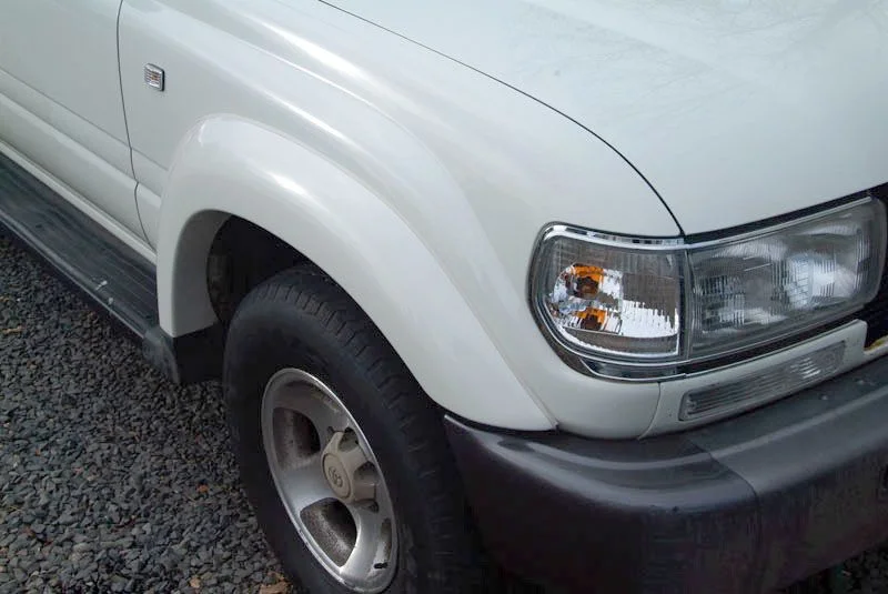

Toyota Yaris side marker signals......
do the lights affect cooling? seems they would block quite a bit of airflow
Have no issues at all, the lights are about 3" forward of anything, and all the plastic is cut out of the grille so its open.
