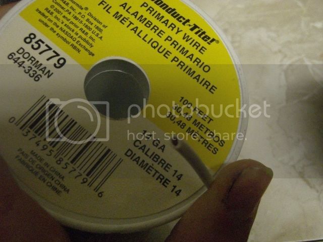

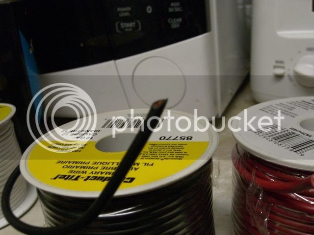

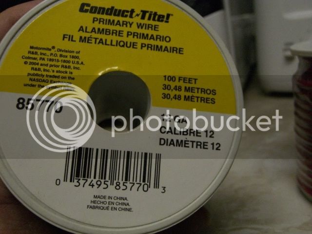

decided to go with 10 gauge power wire for the lights as i will use this for the aux harness as well as the headlamp harness
for the grounds i chose for now 12 gauge wire tho i may bump it up to 10 gauge after i get my prototypes done still undecided on that.
and for my "trigger" wire i decided to go with 14 gauge
