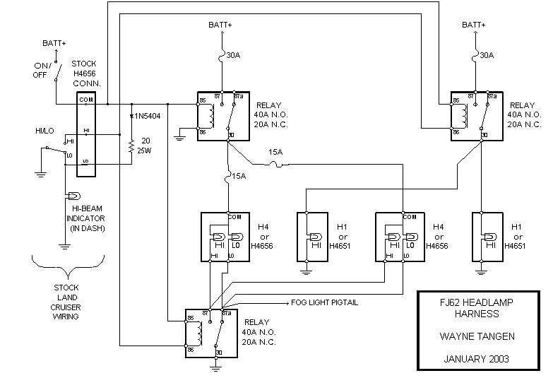

Before you go spending a lot of time on research, you may want to look at Wayne Tangen's info in the 3FE yahoo group files section. Wayne has supplied a nice set of drawings and instructions on how to make the harness for the FJ62. Modifying it for the FJ60 would just be two less relays and wires.
Wayne's prices from when he last purchased parts may be a little low now, but parts run about $50. (w/o wiring)
Pluss, I'd be interested in what your finished product looks like. I need to make one of these, but time and other commitments preclude my adding this to my list.
