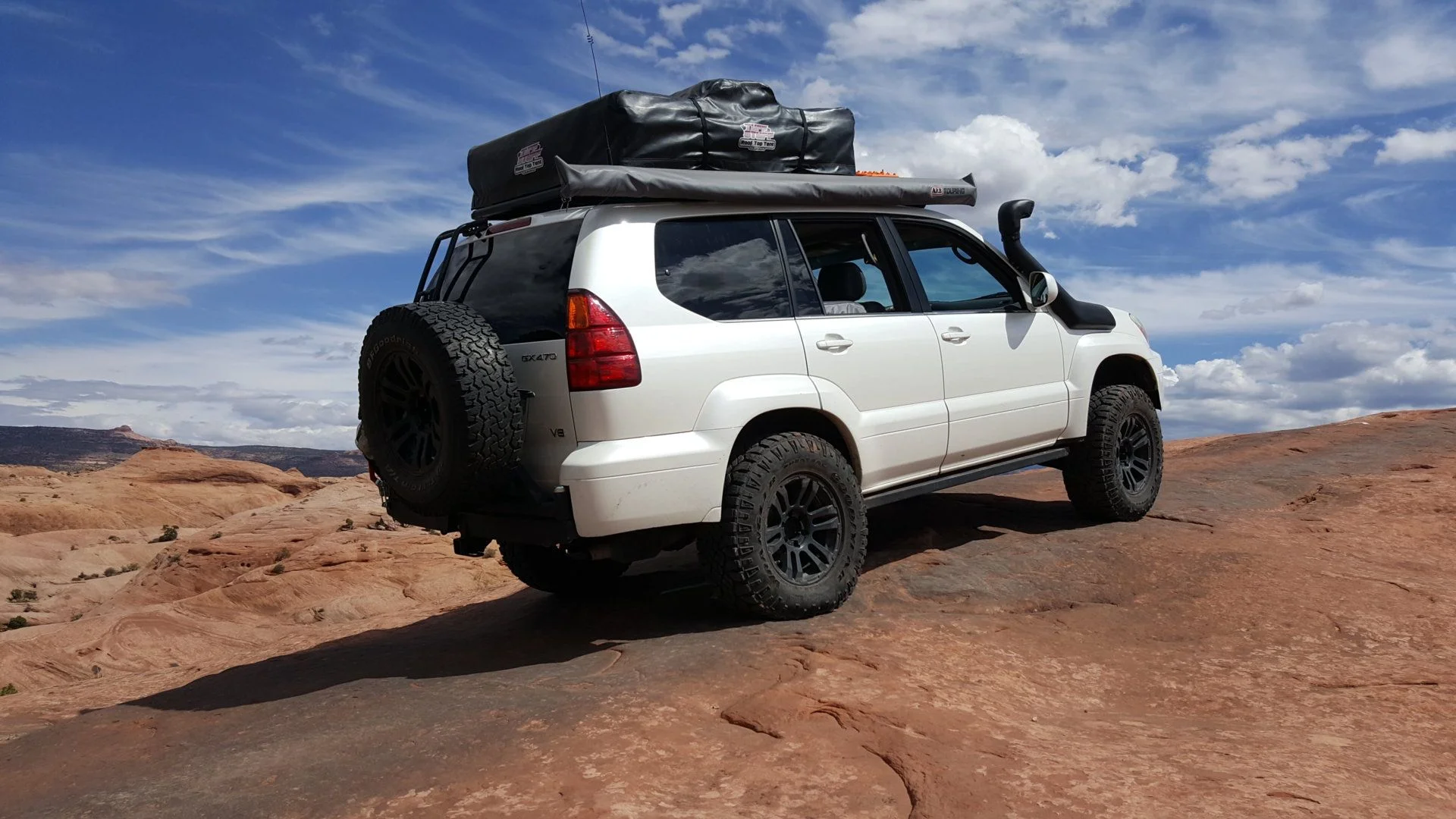

Cruiser Brothers, LLC customer Matt Branson put a HARROP/EATON ELOCKER in his 2004 GX 470 with the help of gear guru Ken "Zuk" Francisco of Toyota Gear Installs.

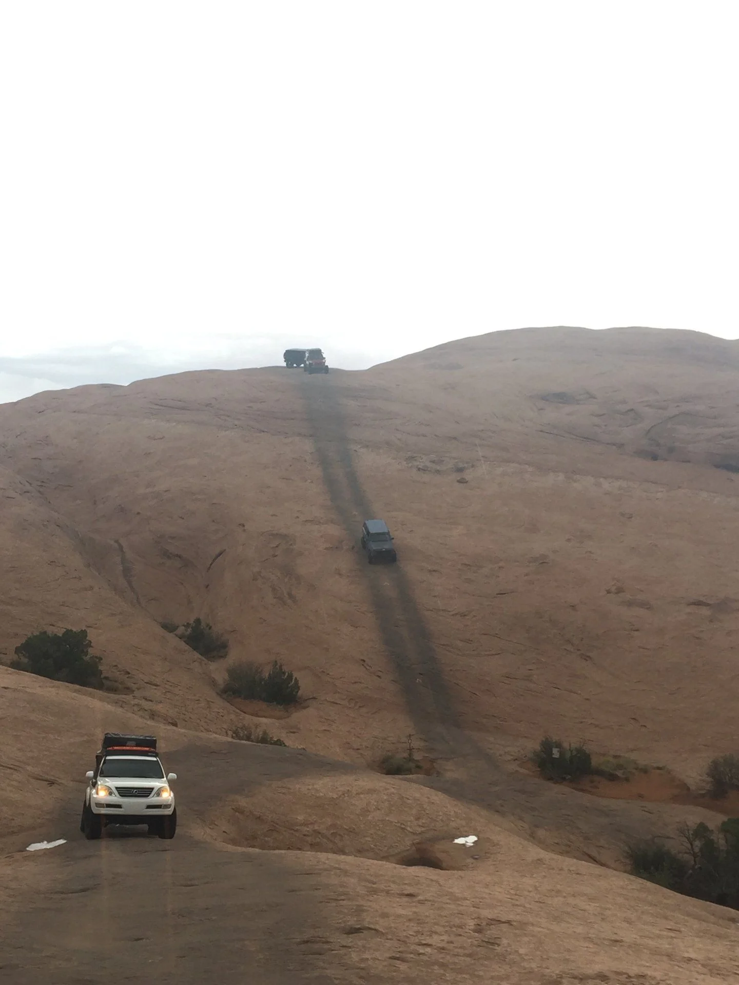

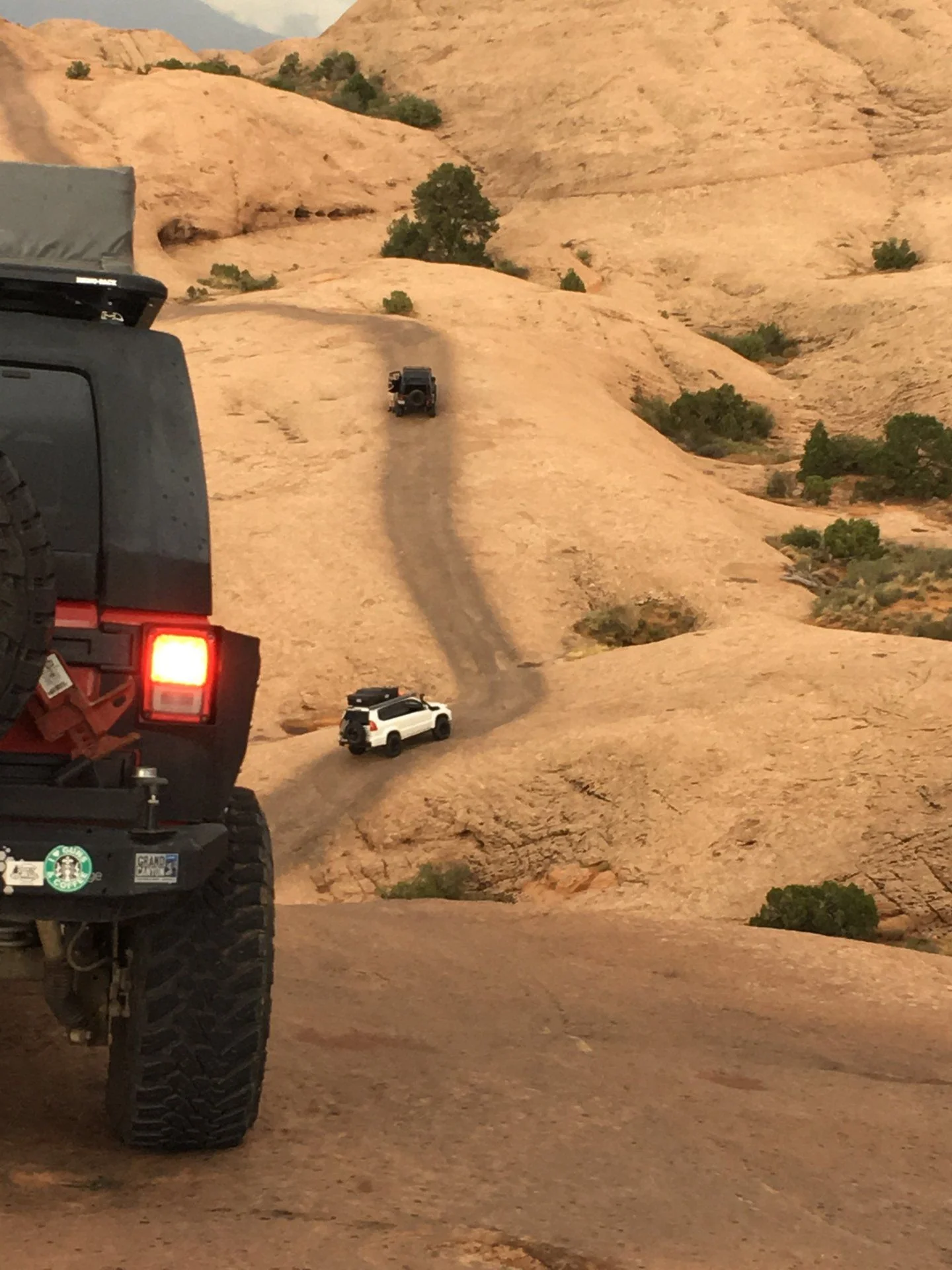

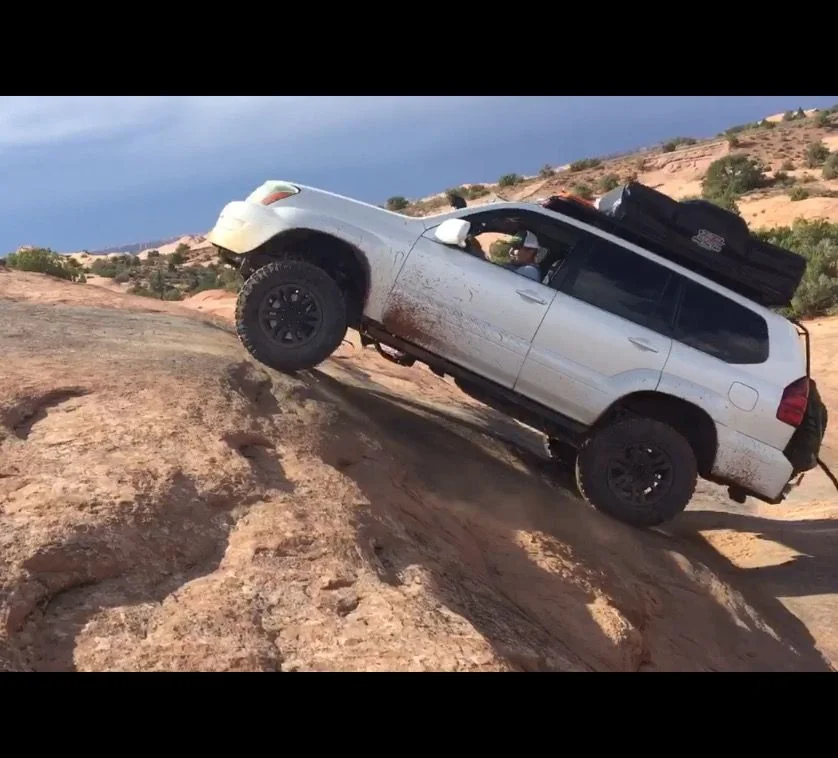

Here is his report: "The GX with the rear Elocker performed flawlessly in Moab! We did Hells Revenge, Fins and Things, Dome Plateau, Onion Creek, Poison Spider and part of Golden Spike. Can't wait to go back. I want to do the front and re-gear so we will talk soon! Thank you,"

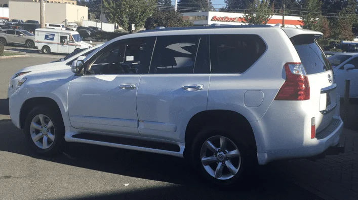

A personal note: On the way to Costco Wednesday, my wife and I stopped at Lexus/Seattle to show her what a 460 looked like (we had a 470 when new) and she decided we needed a new "house car."
Introducing "The Great White" - CPO 2013 with 40k miles and two years of warranty. First up is some brakes. The stockers are mushy pedaled, mediocre stopping at best.
Terrain Tamer HP slotted/drilled/beveled rotors plus composite pads will be installed, along with some of our ABLs - armored brake lines. This will be our long-distance event/trade show & tow truck so a Terrain Tamer suspension will be added to help the OEM receiver.
