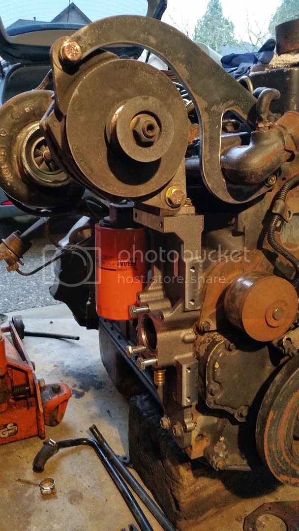

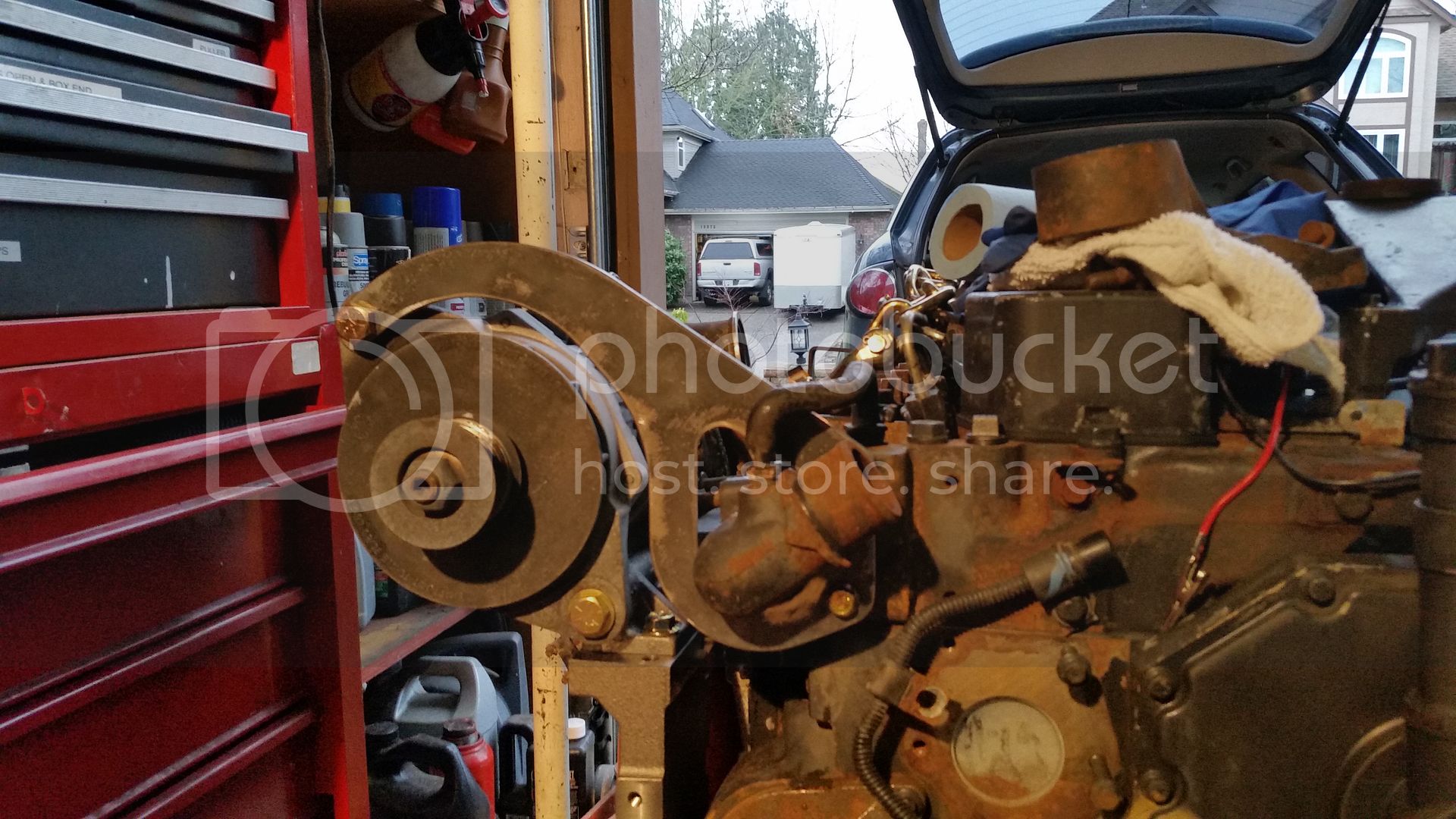

I was able to take a bit of time today and get the bolts I needed to get the accessory braket mounted.
Here are some mock up pictures.
I have not received my AC compressor or belt tensioner yet so this is as far as I have gotten.
Altrnator and braket are about 1.5" higher than the valve cover. Bit worried about this but will not know forsure till it's in the engine compartment. I have a bit of wiggle room with the braket and Alternator.

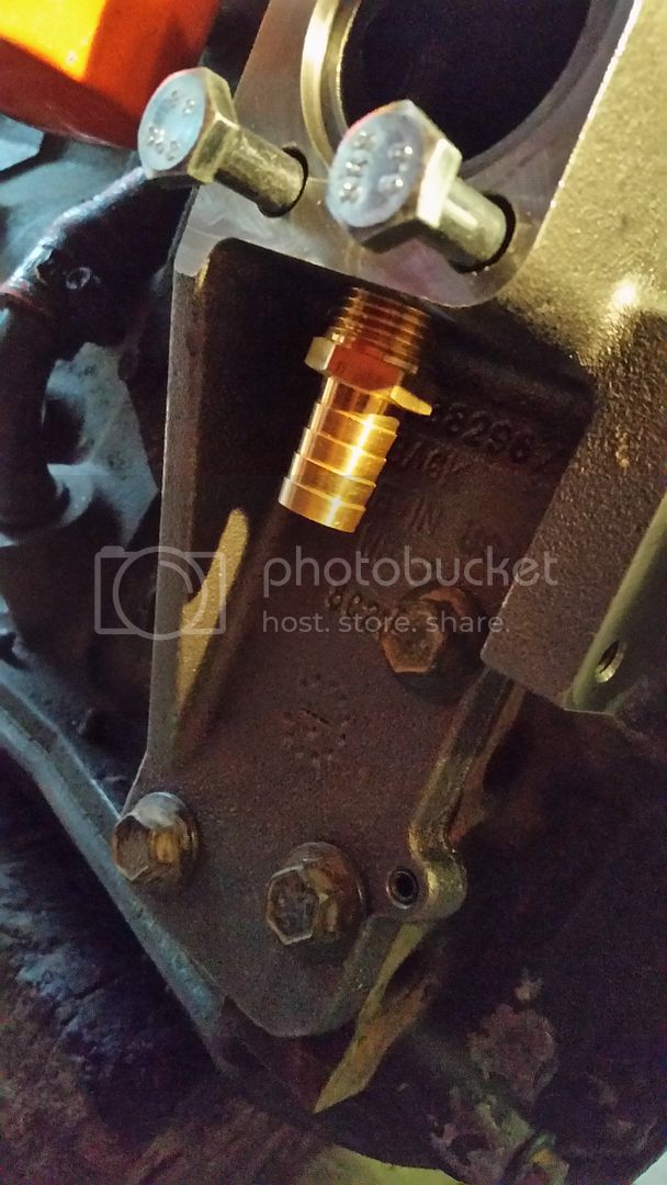

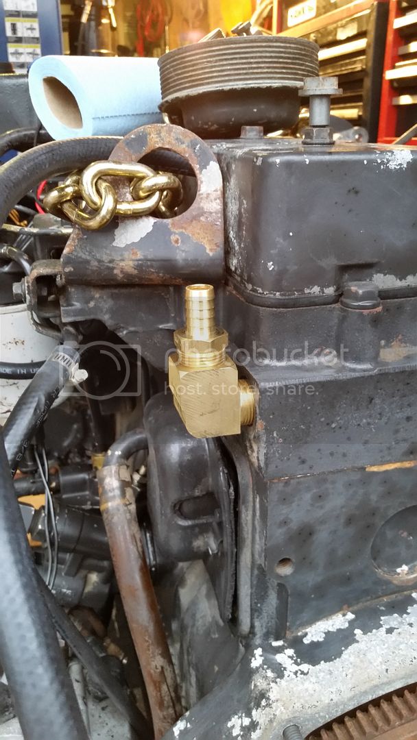

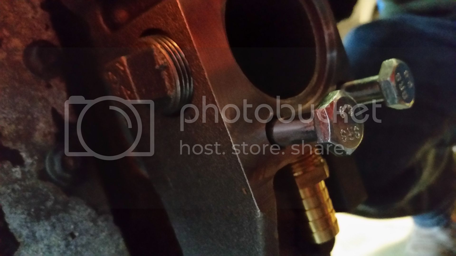

Heater pipe fittings are also mocked up for the most part. On the heater return I have it coming into the bottom of the accessory mount. There is a port to the rear but it's pointed straight at the oil filter. I'll see how this works and if it's not going to work I'll try the other one.
This is the stock hot side that I plugged.
New hot water outlet to heater core.

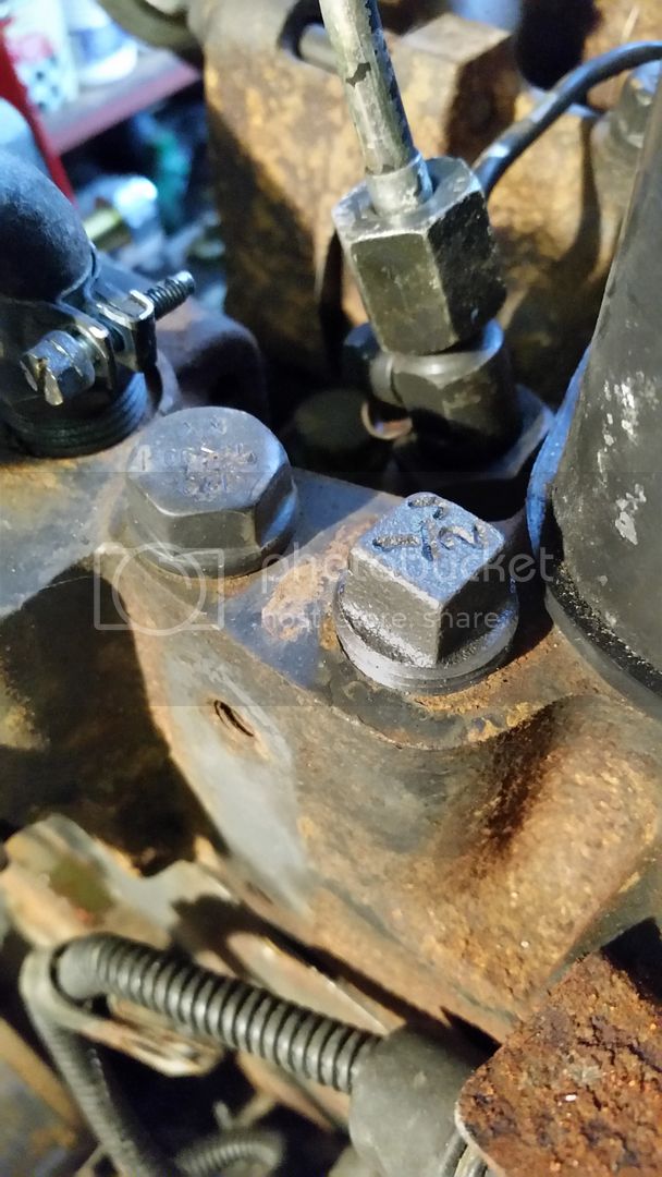

I plan to tap this for the engine temp sensor.
Looks good. My engine temp sensor is on the block under the thermostat housing. Any reason you want it at a difference location?
Intresting, I saw that plug. No real reason to be honest. My thought was the most heat will likely be at the back of the head.
I like it under the thermostat so I know exactly when it's going to open.
Thanks for the part numbers and pictures! I'm curious how much a new 22si alternator and AC compressor for that setup cost.
The most heat is definitely at the back of the head, but cooling is not typically an issue with these motors, so any spot will do.
A new 150 delco Remy 22si is about $150 on eBay. The AC compressor was $107 for a new Sanden from a sterling truck. It's got the hose connections in the right spot to avoid the oil filter and has the correct 8 rib clutch and pully offset.
I got my used 22si for $50 with the price 8 rib pully. This alternator is for mock up and trail spare since it's not got the tach pin or the 1-2 pins. It will still work just not ideal. So once I know all this will work I'll get a new high amp 22si.
FWIW, I have my electric sender unit (for dash gauge) up by the thermostat along with my electric fan control sending unit. I have my mechanical water temp sensor right in that port in the back of the head.
If the electric sender is for your gauge, what does the mechanical sender do/run?
I plan to run my factory guage and a small digital one that is more accurate. Once I know it's all solid I may remove the digital one.
I'd guess electric for factory gauge in dash and mechanical sender for a mechanical gauge for a more accurate temperature reading.
3 eyed has it right. Used a mechanical for more accurate numbers but still wanted the dash to work.
