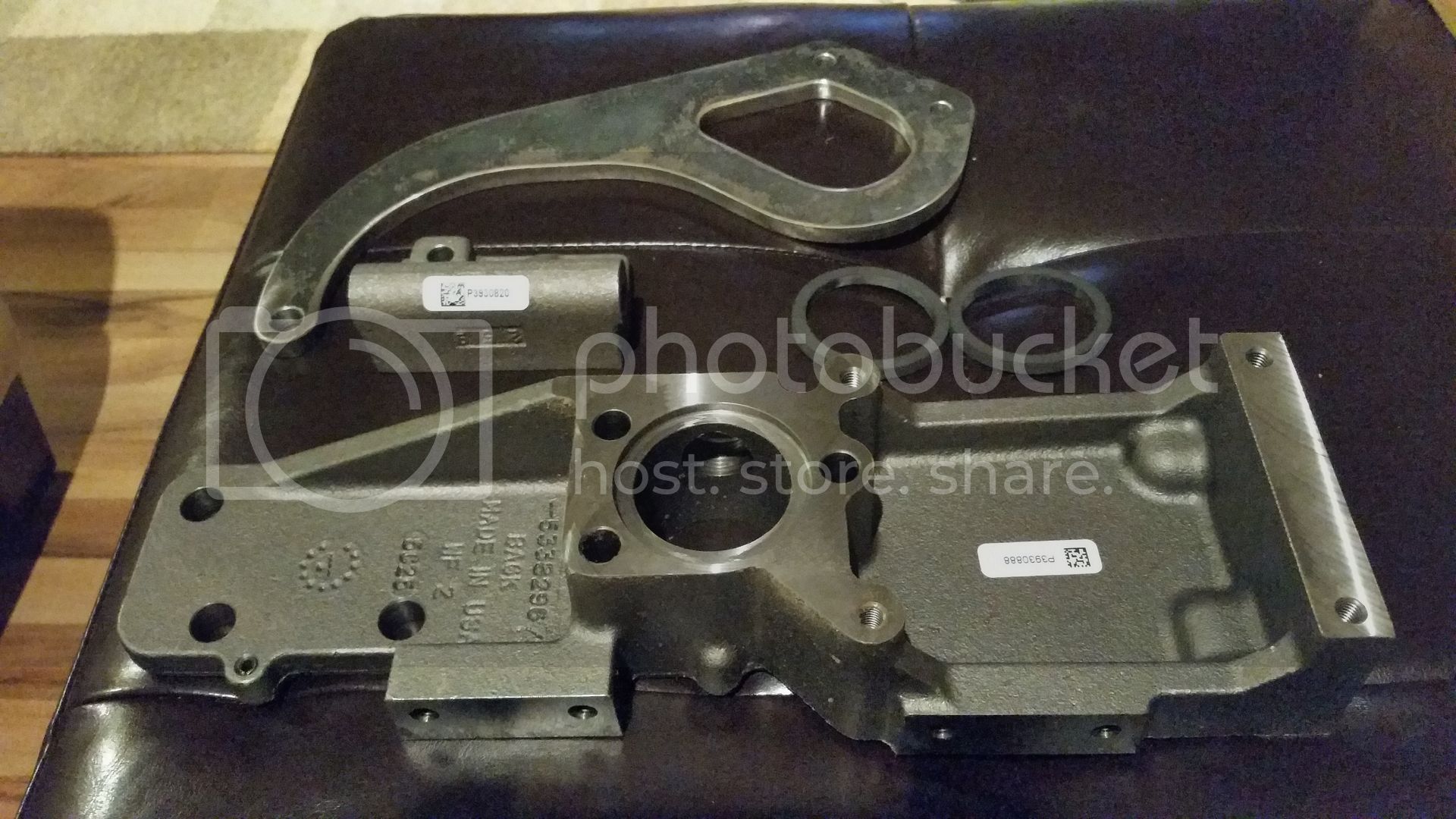

Here are the Cummins parts needed to move the AC compressor above the water inlet on the 6/4bt. It does not allow the re use of the Dodge alternator or AC compressor (good thing in my books) and instead uses a GM style 22si alternator that can be had cheap with up to 250amp outputs. For AC it uses a medium duty truck (sterling or ford) Sanden AC compressor.
The top curved braket I got off a guy on 4btswaps he makes them and they are high quality made out of 3/8". You can get one form Cummins but it does not allow the use on the Dodge water outlet.
Here is the link to the most detailed thread I have been able to find on the F800 mount. The thread starter is the one that makes the alternator braket.
High Mount AC

I will need to make a water inlet, it will be easy I just did not want to use the straight Cummins one as it's made for 2" hoses. I want to make mine to accept a hose that matches the Toyota rad.
I also have not got the belt tensioner braket it's essentially a 3/8" plate that I think I can make easily. If not it's cheap from Cummins.

I'm sure his uses the same water inlet gasket. The block if I remember right is machine for the gasket to slip into. It's a great way to seal it up.....and factory.
After looking at these mounts there will be no issues with it. It's so over built it's crazy, the one lower section is 15lbs alone.
My only worry going this way is the alternator and it's positioning. It's level with the valve cover in hight and sticks quite a bit out the side of the engine. Worried it's going to be into the battery box on that side. No way to know for sure till it's in the truck.
