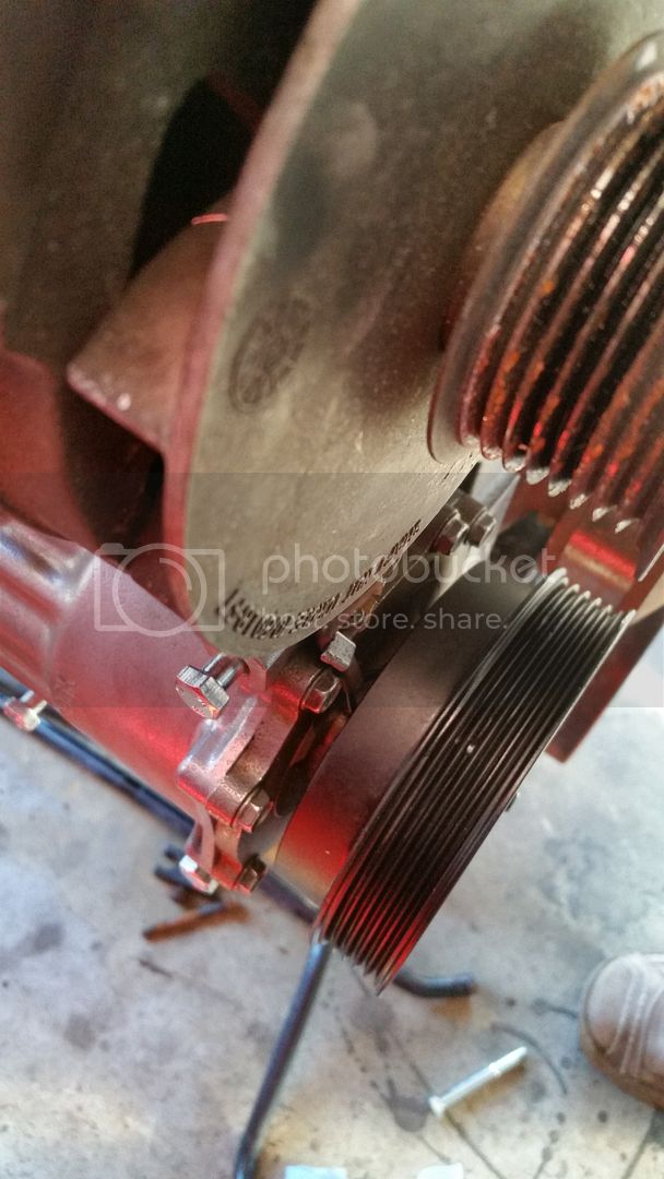

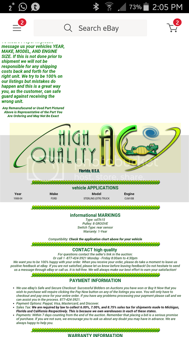

I also got my AC compressor........ Not impressed. Sold as 8 rib sanden compressor with the manifold I need for this application. It's for a sterling truck with a Cummins. What I got is the right body compressor with a 5 rib pully and the manifold facing the block. Basically who ever rebuilt this compressor did a s*** job, not rebuilt to OEM spec at all. I have sent the seller an message on eBay so we will see what they say.
Not enough ribs here.
That's not going to work......
All the details on what I thought I was getting here...

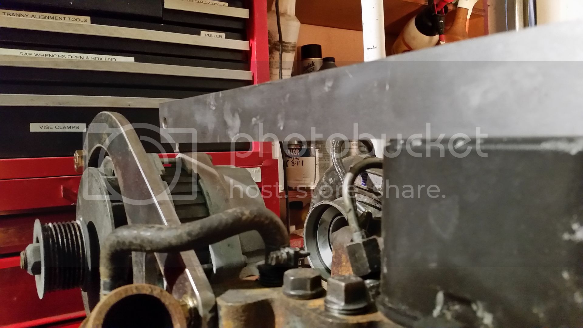

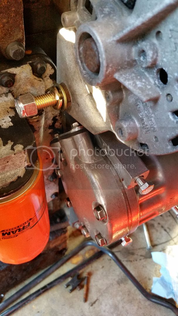

So I may have an issue with this accessory setup. My worry about the hight of the alternator braket looks to be justified. I need to do some more accurate measuring before I conform it. This alternator mount looks to stick about 1.5" taller than the valve cover right at the front of the engine. A local just got his swap done and took a few measurements and it appears I have about 1" before contacting the hood in this area.
I'm going to take come careful measurements and see what I can come up with. Thoughts right now are see if I can make the setup lower profile. Meaning make the alternator sit lower and the top braket looks like I can shave 3/4" off it. Well see what I come up with. If it's going to mean reinventing the wheel I'll cut my losses and go with the diesel adapter one.
Really not going to know what works 100% till I get it in the truck.
I'd more than likely be willing to purchase those brackets if it doesn't work out. Moving the AC compressor up would allow me to make a cleaner lower radiator hose and route the intercooler piping on that side.

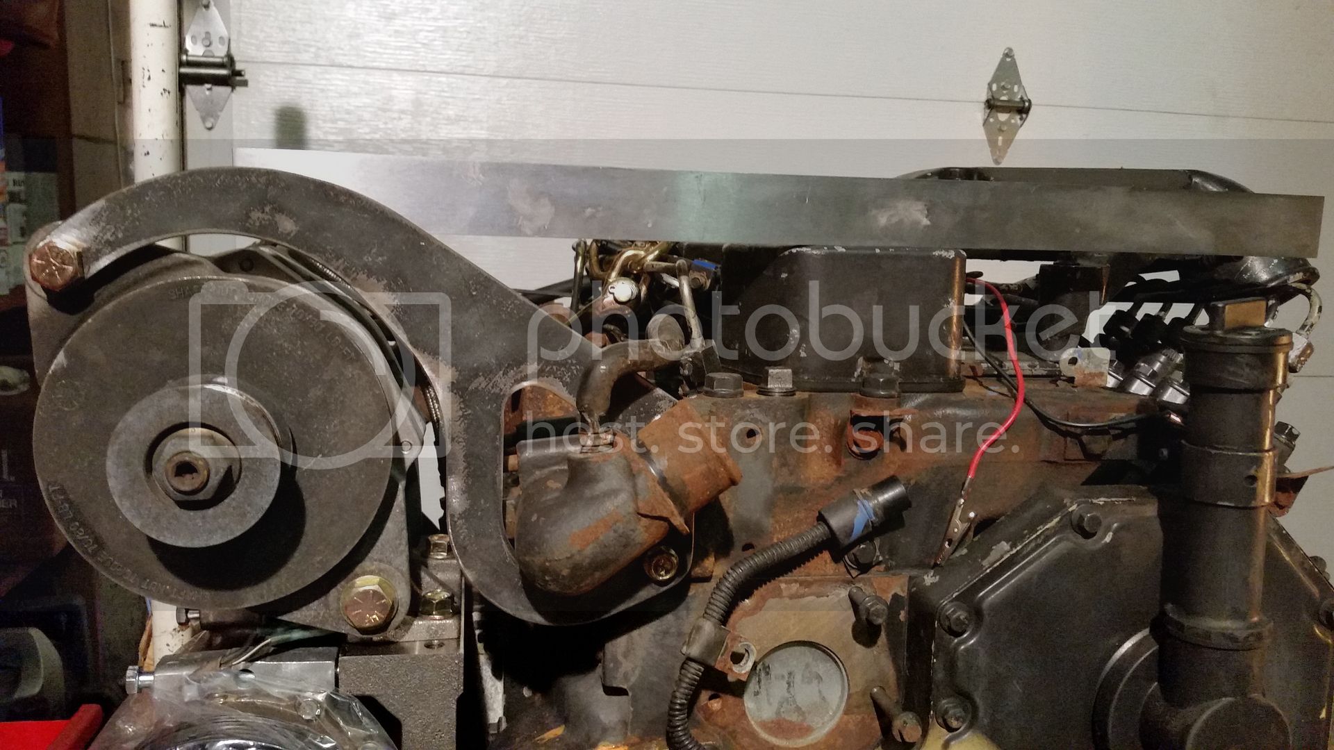

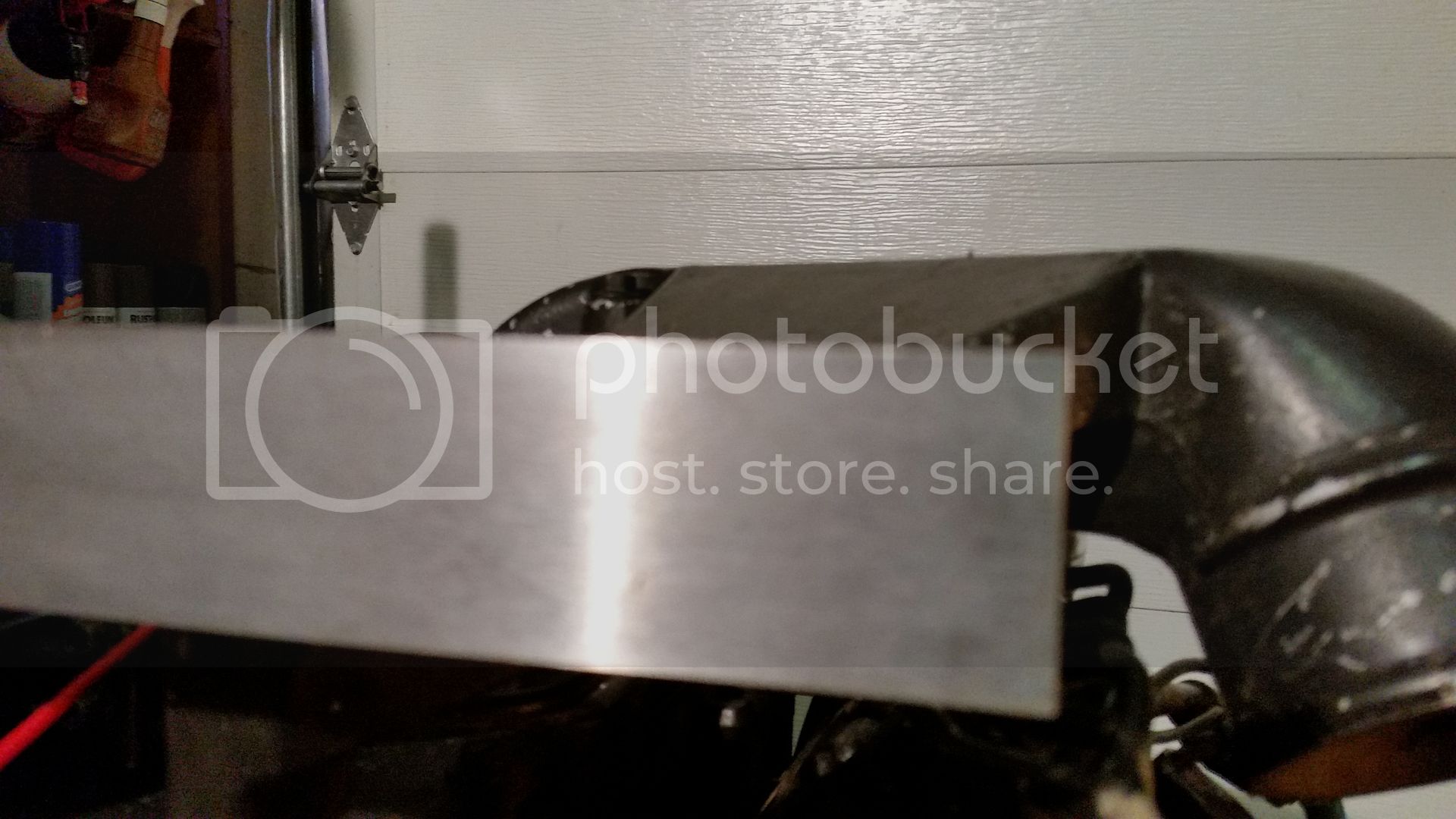

OK so got a few hours to work and measure some things on the 6bt. I started by laying a straightedge across the valve covers. The alternator sits just under 1" above the valve cover. The intake horn is about 2" higher than the valve cover but it's almost mid line of the engine where as the alternator braket is right at the front of the engine. I'm not going to change anything till I have the engine in the truck and can see exactly how it lines up. I am not married to an engine hight too so if I need to lower mine an extra 1/2" I should be able too. Last resort will be a 1" body lift...... But even saying body lift makes me sad.

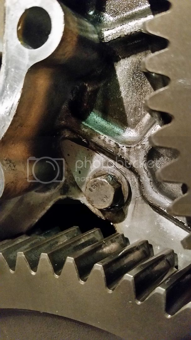

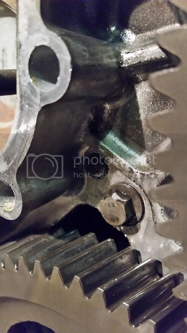

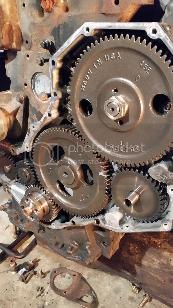

My goal today was to also see if the KDP (killer dowel pin) was in place. So I removed the crank pully and timing cover. It's never been off as the bolts where still painted to the cover. Dowel pin had not killed anything yet...... It was poking out about 1/16th of an inch. I tried to tap it back but it stopped about 1/8" in from the cover so left it.

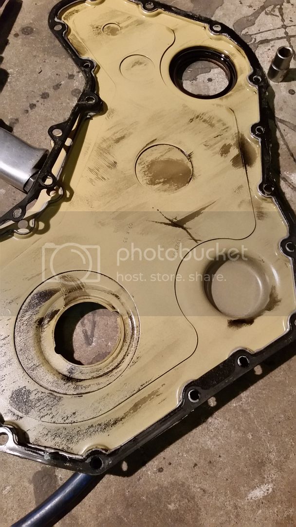

This engine is spotless inside the timing cover. There is zero sludge or even soot stain on anything in there. This pick is taken when the cover came off not wipping or anything.
Only slight oil build up was on the back of the cover and still very little. I have seen these come off of higher or not maintained engines and they are a bit of a mess. So I was happy to get some confirmation of the low millage and maintenance.

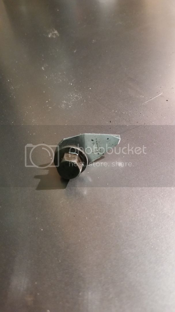

My 15min KDP tab I made this out of some 20gage sheet metal. Should work OK. I also retorqued all the timing housing bolts and used blue locktight.

Wow Jeremy that thing was SUPER clean inside the cover, you must have been smiling from ear to ear when you pulled it off!
Yeah big smile for sure. You just never know how far you can trust the word of some one selling something. He seemed honest but I still am glad to see confirmation of it. Hopefully it's clear sailing from here.
