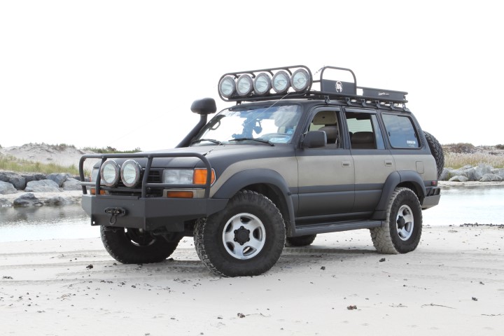

my old chevy FJ44 MAGNUM was the inspiration. When we had our son, i needed something with a backseat so i parted it out to get my 80.
Painted in my garage with PPG base coat and clear. Inside doors, hood and jams were done. Colors were: dune beige and white top; satin clear black hood black out, mirrors and moldings; gloss clear black window trim; Rustoleum graphite cleared wheels, grill and rear bumper trim.
All painted, sanded and buffed out in 8 straight weekends with my son. Priceless.

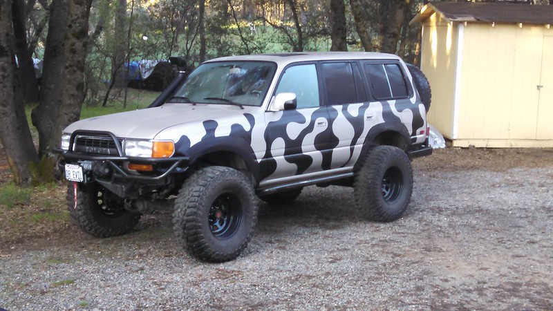

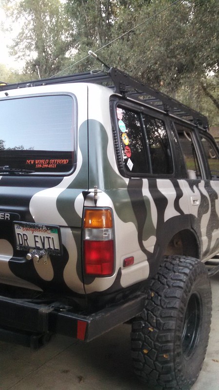

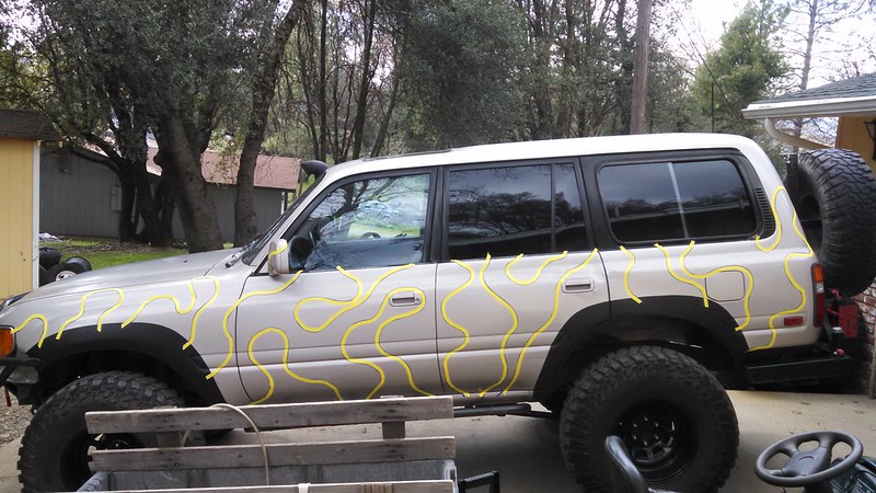

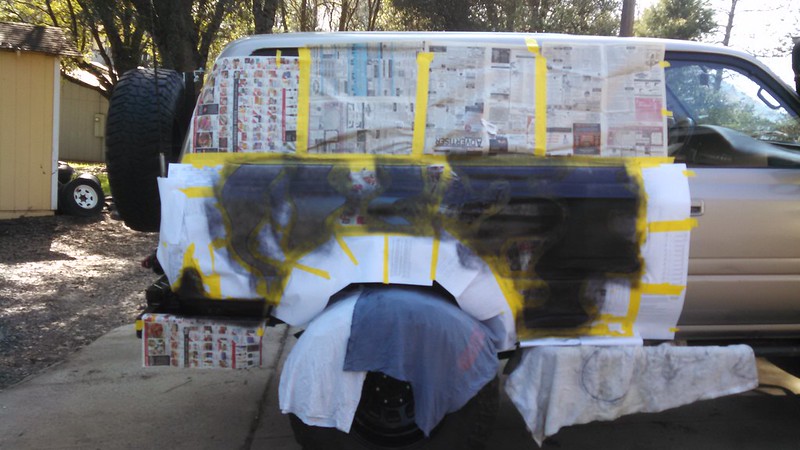

Just finishing up my rattle can job on my 97 40th. One less antique sage 40th in the world. All rustoleum primer and paint. I used the ultra flat from the camouflage colors they have. The base is olive drab. The grey is what looks like dark green in the camouflage colors. And ultra flat black. I used 2x orange and lime satin for my stencils. Got my stencils from amazon.
Used about 15 cans of primer. 5 cans at a time. light coats with days of dry time before wetsanding and repeating.
15 cans of olive drab
5 cans of grey
5 cans of black
1 can orange
1 can lime
2 cans raptor liner black for bumpers
2 cans u pol adhesion promotor
220 grit sand paper. Took off all clear coat
I resisted my urge to raptor line the whole thing. I think of this as a extra layer of metal protection that is easily reversed if I ever get the urge for a expensive paint job. I wanted something I can scratch up and not worry about. And something with my own artistic flare. My love of scuba diving & snorkeling is evident I think. Manta ray night dives 🤙😊🧜‍♂️
