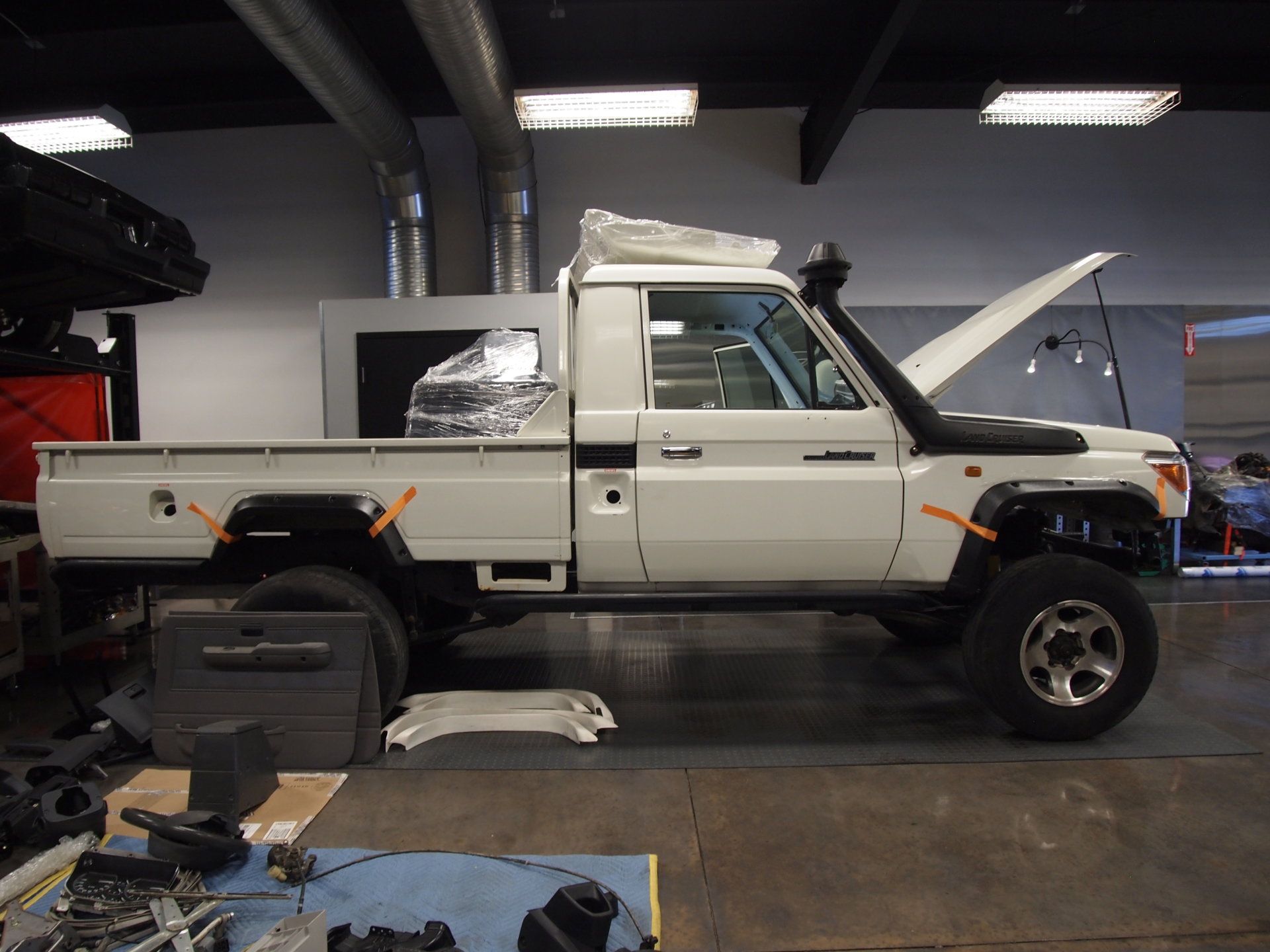

While we were messing around with interior bits and pieces, I decided to install the Kut Snake flares on the truck. I had planned on doing this truck differently from #1......it wasn't ever going to be a stock build(recreation?) so not staying as close to OEM as possible, while nearly impossible for me to accept, was how it would be done.
I'm still torn on the flares...I can't say I'm 100% in favor of them. I'm contemplating maybe doing them in a different color. Maybe doing them smooth instead of textured. Not sure. I might just wait to see how the truck comes together before worrying about them. I think once the proper wheels are on it, a proper bumper of some sort and the canopy with all it's cool stuff, they might just end up looking really cool.
The positive of these flares.....they required no cutting. Unlike #1 which had a large portion of the fender lip cut on the rear bed. Yikes.
Did a quick mockup....had to get the courage up to drill a new body. Hard to do when it's your truck...easy to do when it's a customer's truck. Ha.
The fit was outstanding on these flares....they really really fit tight.
The flares are extremely strong and sturdy. 5mm ABS. UV resistant. Tough as nails. Definitely not a cheap flare for looks....these will do well off road and are surprisingly flexible enough that I doubt they will shatter or crack.
