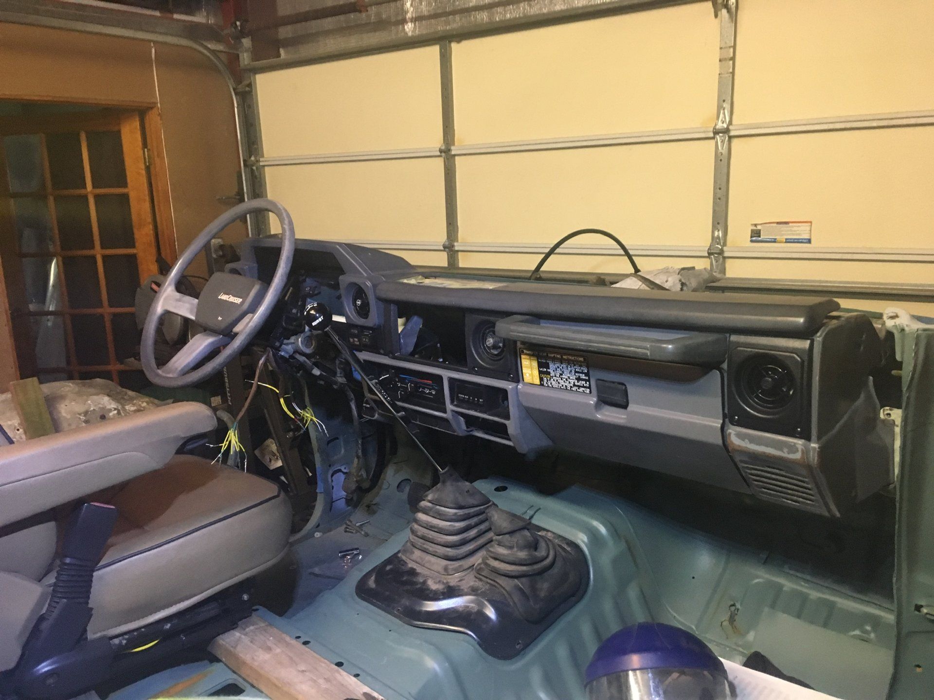

It’s a crappy photo but you can somewhat see the difference of the support beam on yours compared to my 75.
I’m glad you posted that photo as I found where a piece went that I couldn’t remember. It’s the brace that you have the red line drawn on that connects to the trans tunnel. I tore the interior out back in June and took zero photos or notes. I should have known better. Now I a life size model in a bunch of bins with no directions except a few RHD drawings in the FSM that don’t help much.
You are right that the old dash does kinda hold itself together. I was able to plop this thing in place after I had been piecing it together inside the house.
