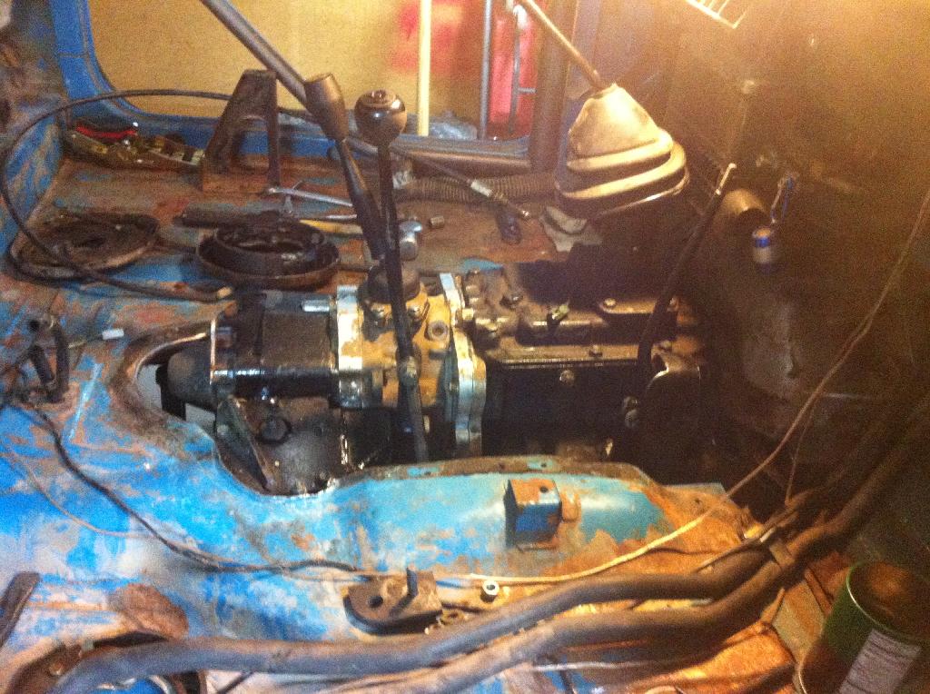

Toybox bolted up
tranny/toybox/transfercase and 4 sticks in the air
I still have a lot to do.

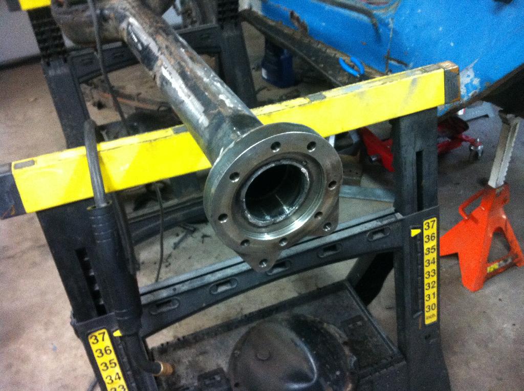

Full floater disk brake rear end :D
using flanges from LCwizard and a spare 40 axle housing I had laying around
You suck. Is the parking brake on the transfer case?

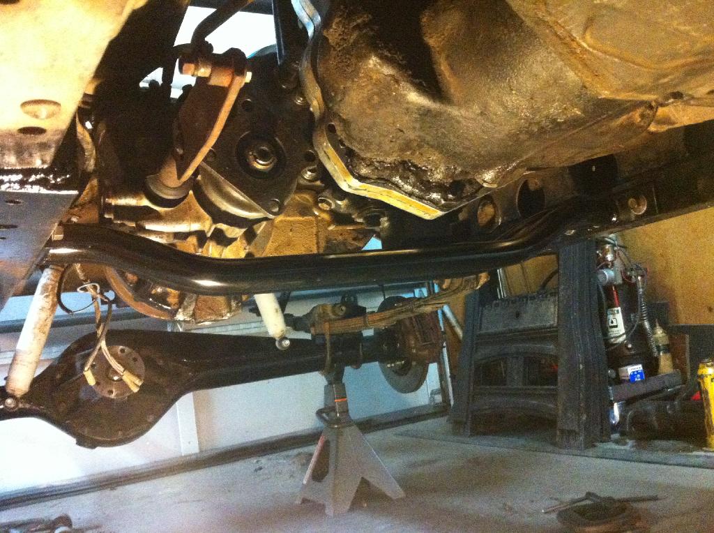

Got the crossmember built finally
and installed

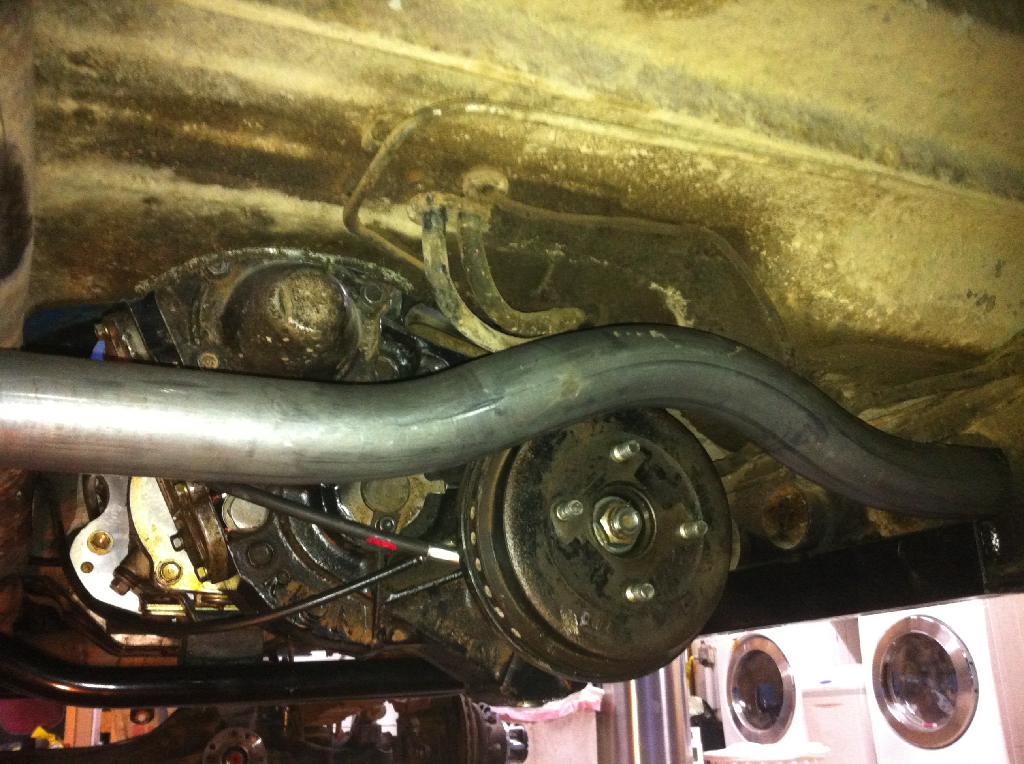

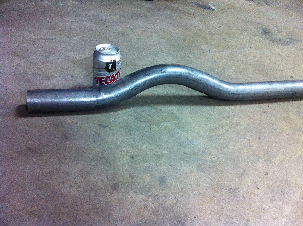

My torsional crossmember to replace the one that had to go to fit the toybox
I can't believe the beer is not open...............:cheers:
Nice work......boy you sure are getting your moneys worth on that tubing bender........:popcorn:.......:beer:.......Enjoying this third/fourth/ or maybe fifth rebuild.......
Mike
It will be 22", I was hoping for 24".

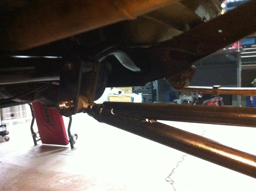

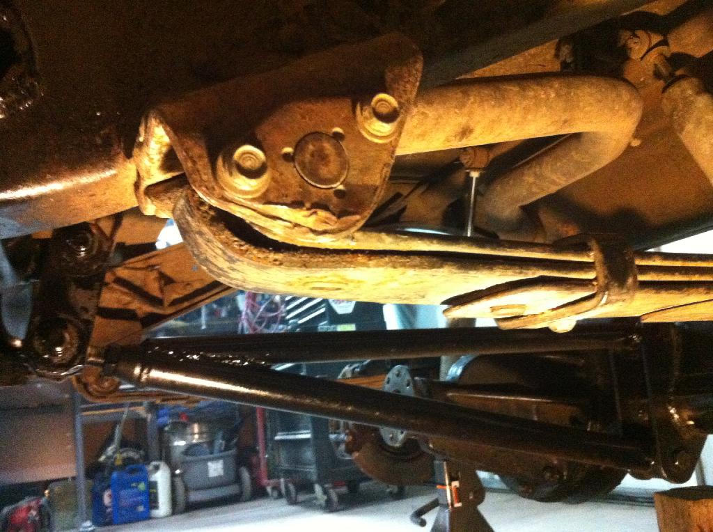

I got the anti wrap bar built and installed yesterday, it kicked my ass so no pictures until tomorrow.

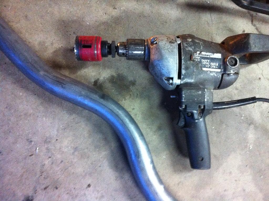

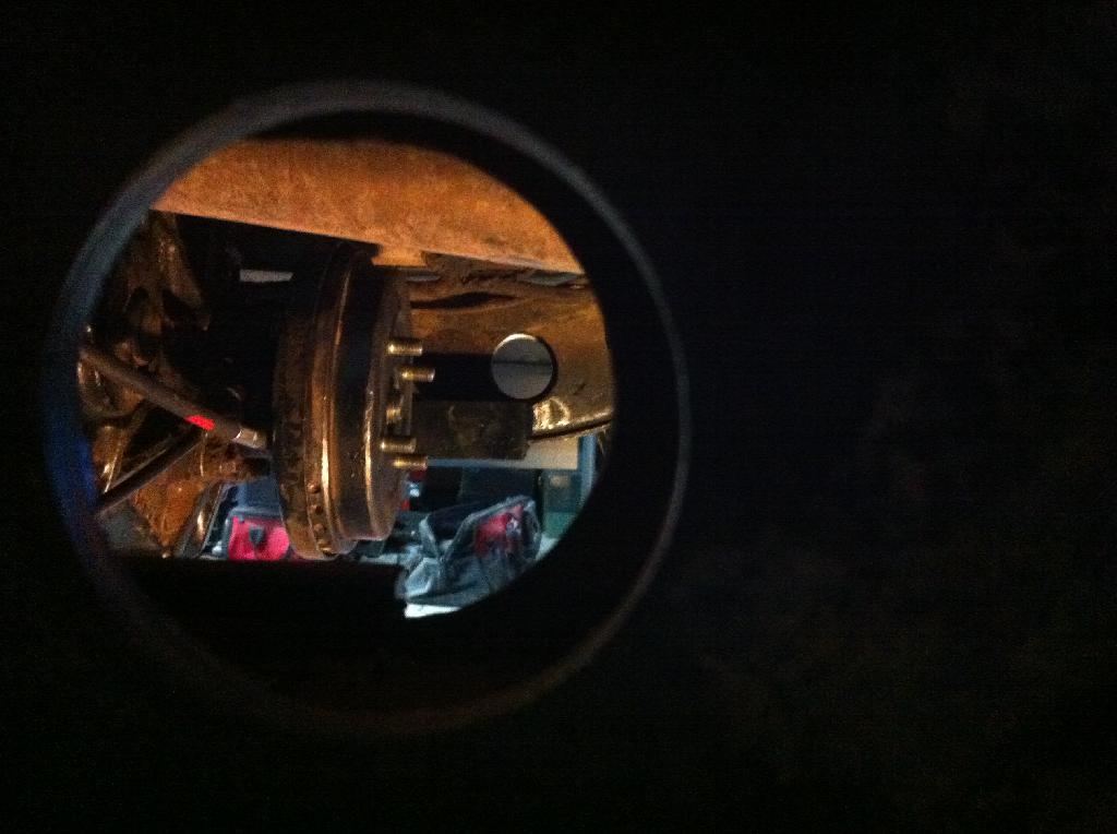

And the world through a 2" hole
