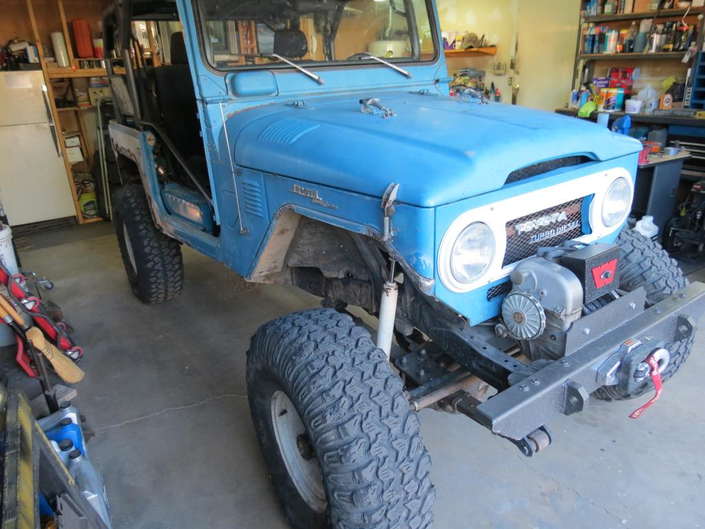

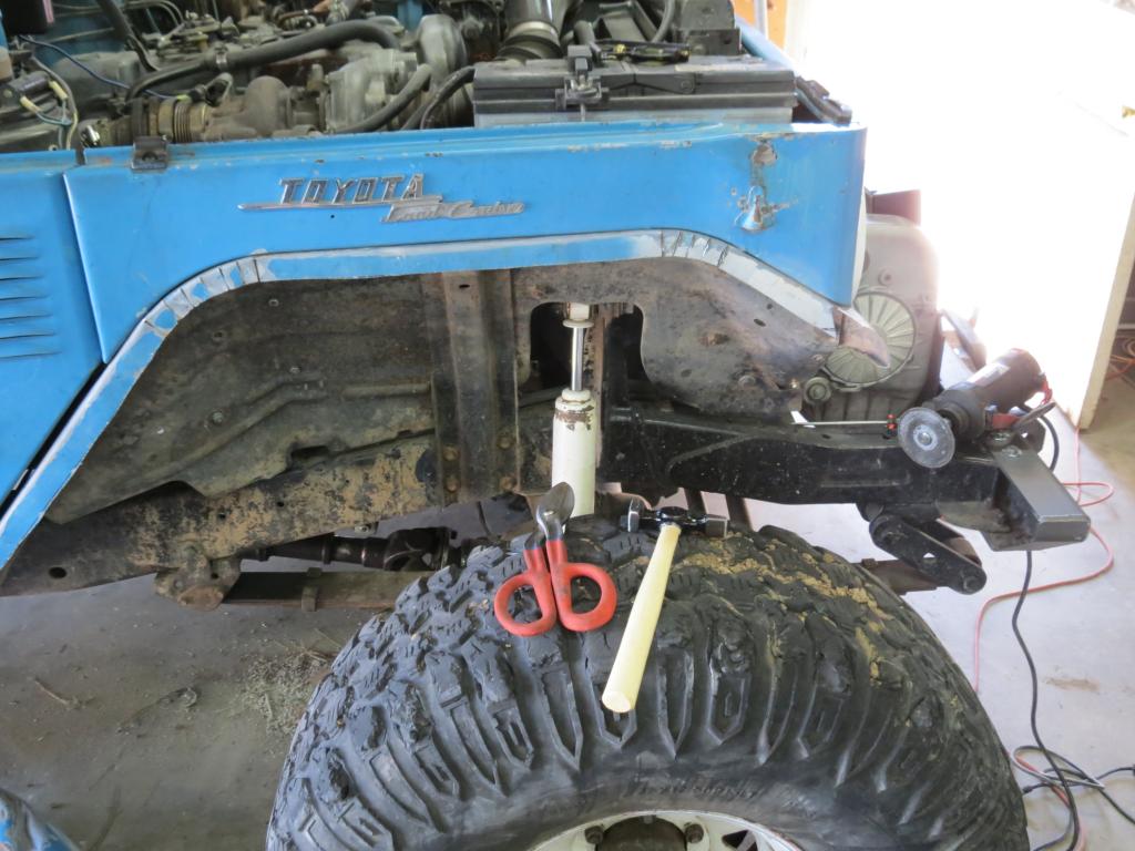

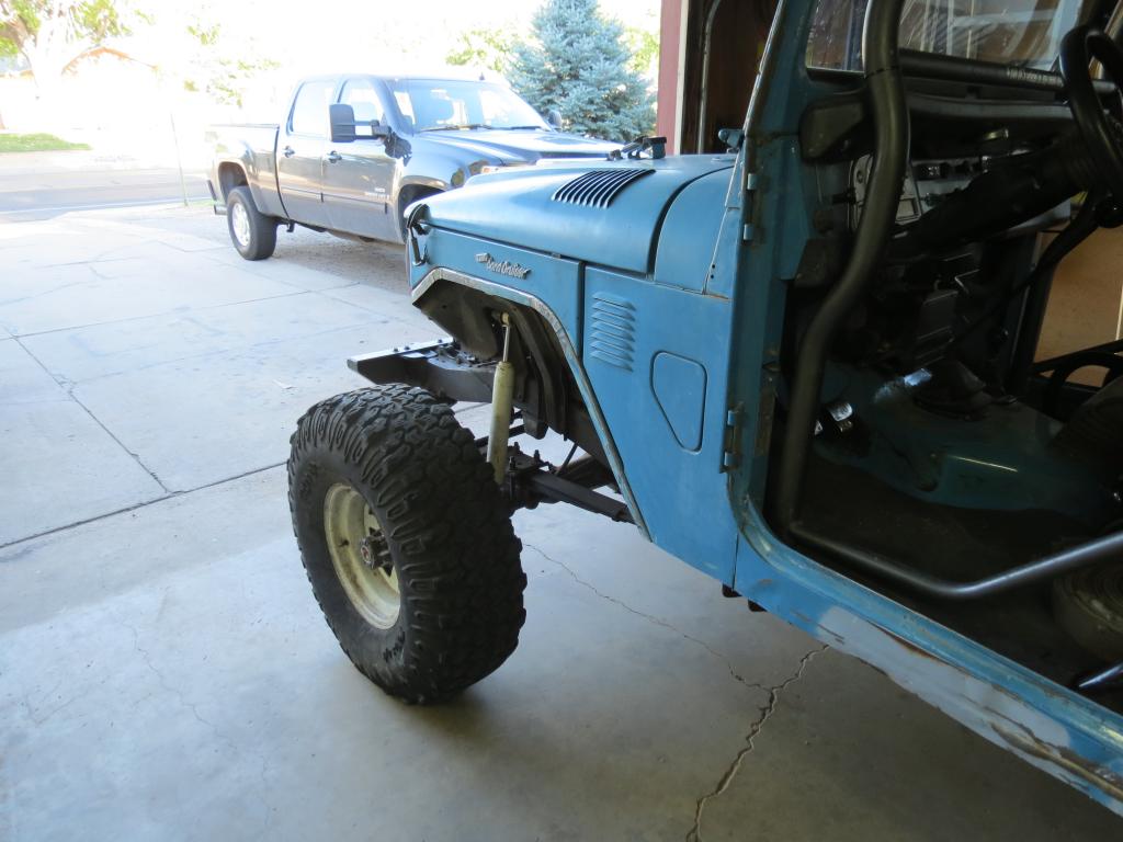

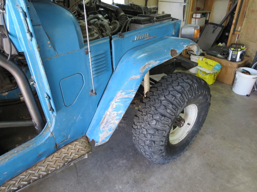

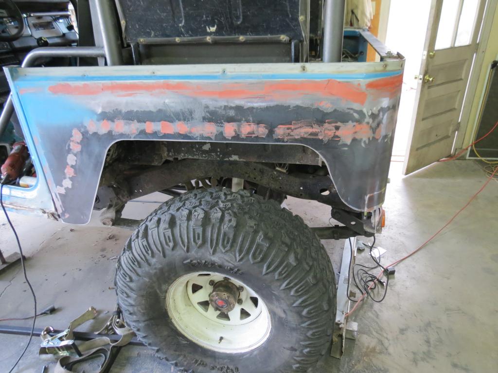

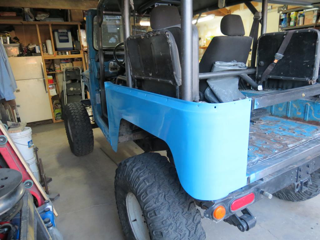

The fenders and running boards have been taking a beating from day one and after a particularly brutal day at Gordy's last weekend I decided to do something about it
Passenger fender and step after I straightened them
Drivers side
Six hours later they look like this
I cut and rolled the fenders to save the inner fender and prep for tube fenders and sliders
More to follow as I start the reassembly process.

As for fenders, I am making my own. 1. Because I am cheap and 2. because I couldn't find anything I liked that had an inner fender and 3. I need something that I can tie my bullbar into so that I don't have to build a stinger.
I have a 1.25 die so that's what they are going to be. I saw a heep with 1.25 tubing and I thought it looked good so I'm going for it.

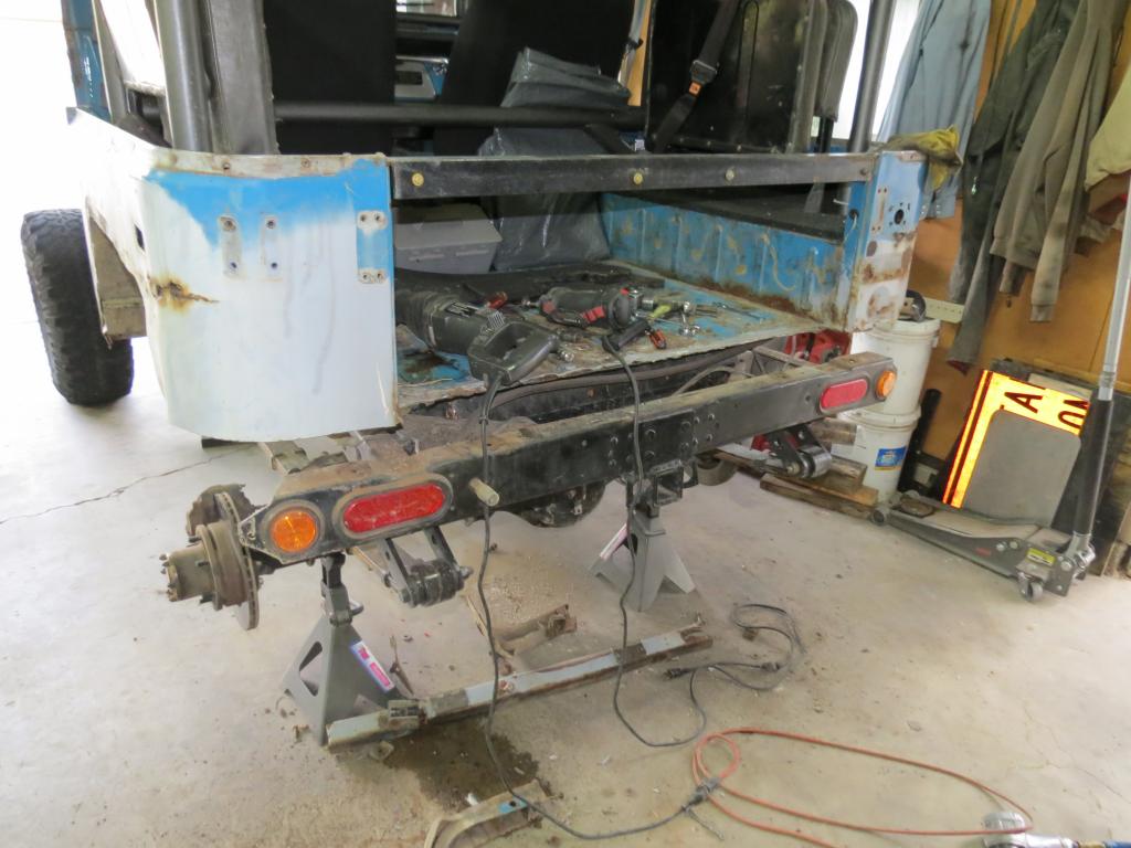

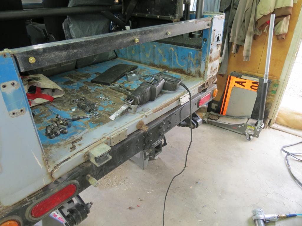

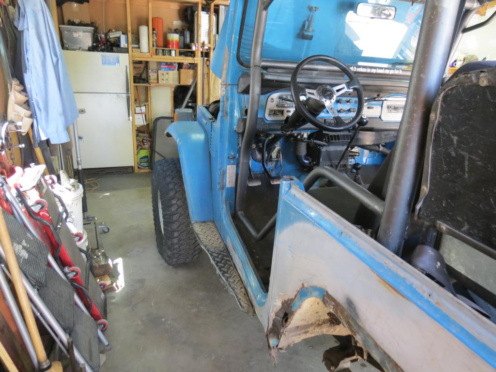

Oops, fell down a rabbit hole and the sawzall came back out
stay tuned as I try to dig my way out of this predicament.

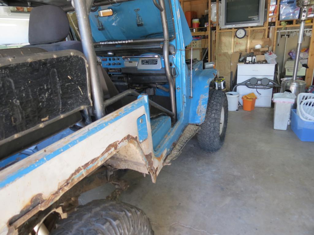

I didn't get to work on it last night... Had a company function.

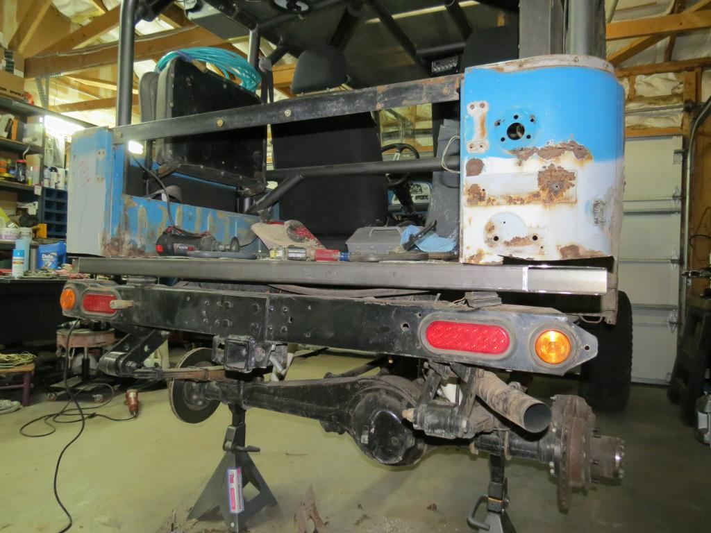

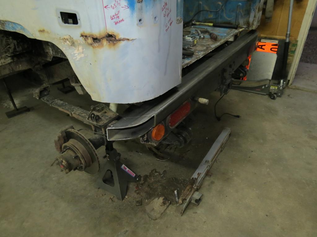

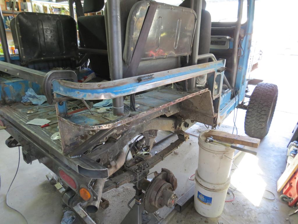

I did get the rear sill started tonight.

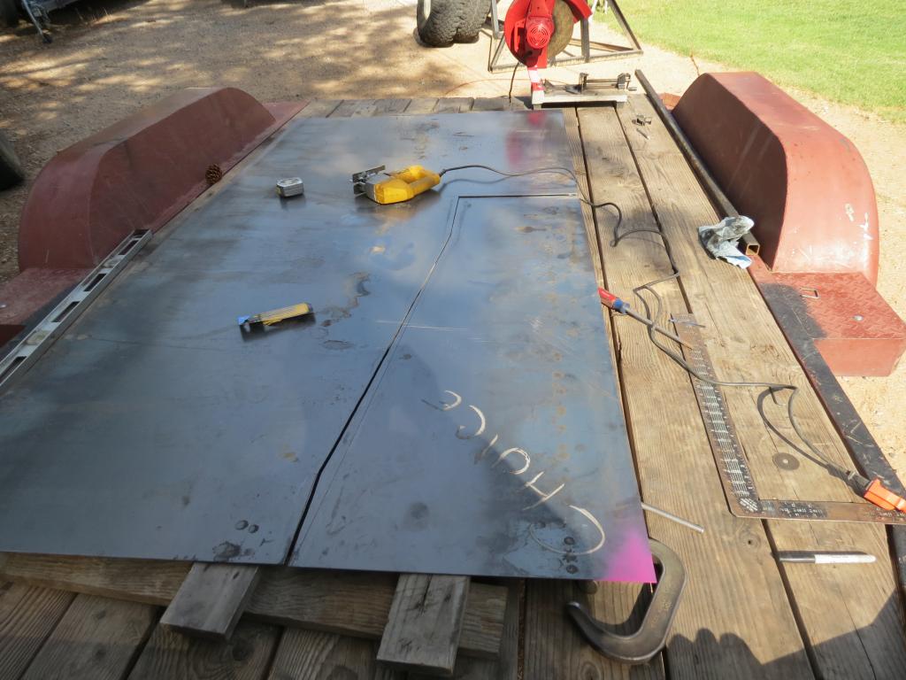

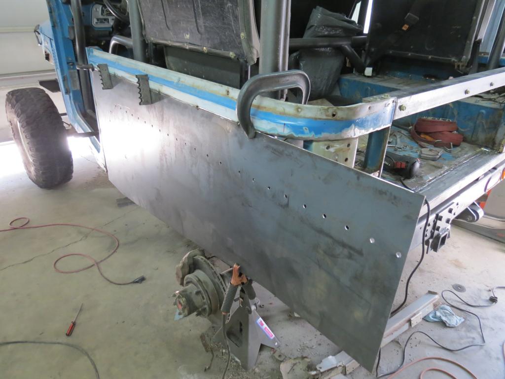

I need to weld in some captive nuts and box the ends, after that I will cut the rest of the panel out and start skinning it with 1/8" plate.
I bought 12 gauge instead of 1/8". that .020 is going to make all the difference between bending it smoothly or not :D
1/8" = .125 and 12 gauge = .104 or so

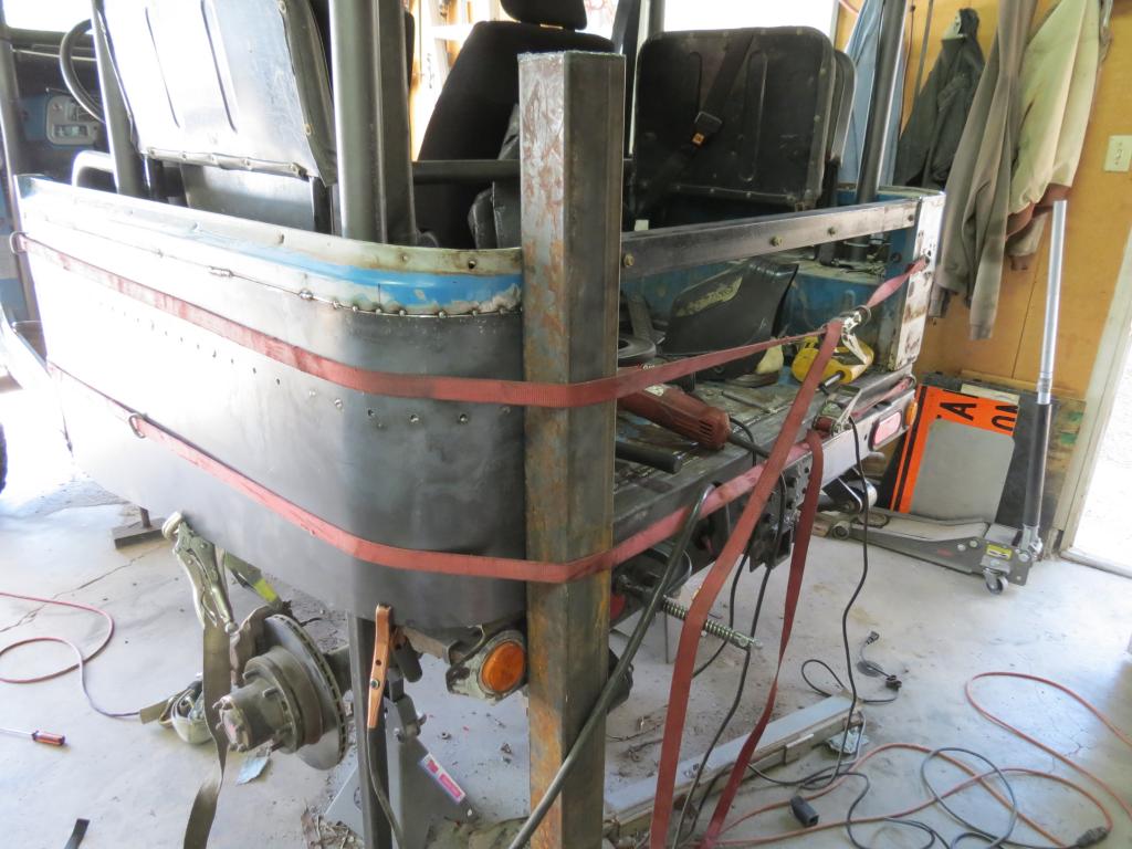

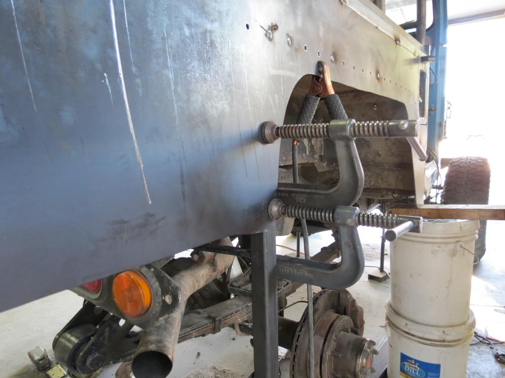

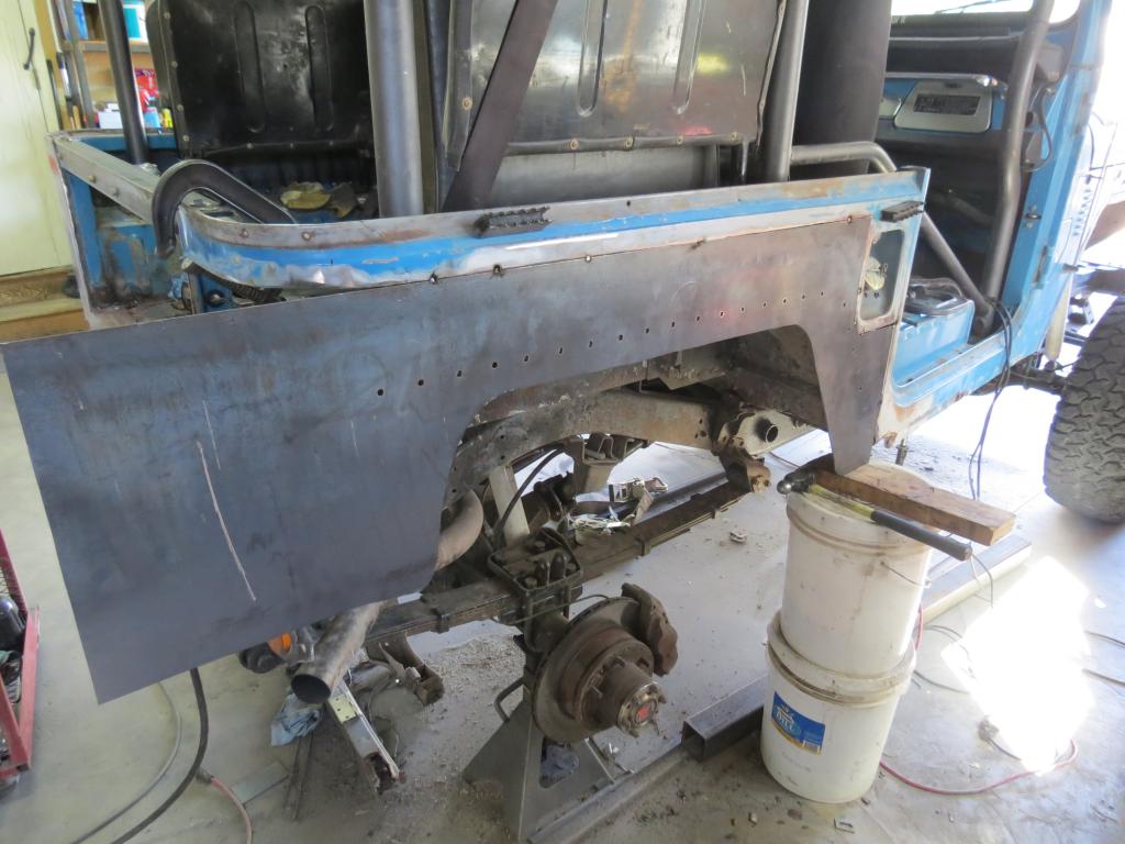

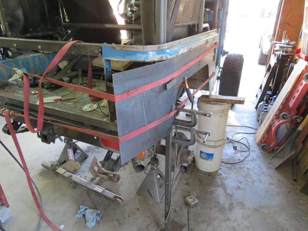

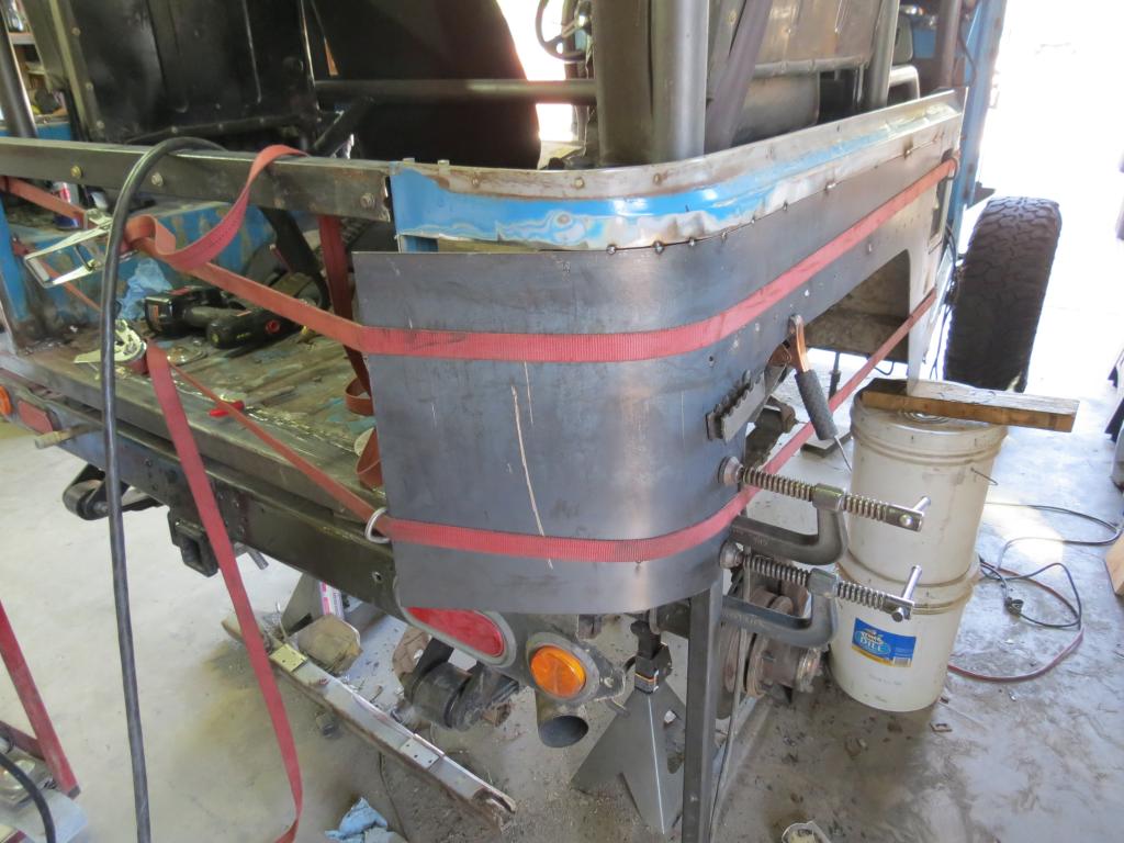

I got the drivers side done today.
Predrilled all the holes for the spot welds hung it back up
Then took a couple of straps and this piece of 3x3 tubing to form the bend
It came out pretty damn nice
hopefully I can get the passenger side done tomorrow or Monday

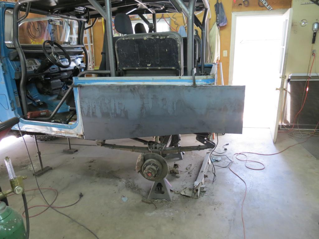

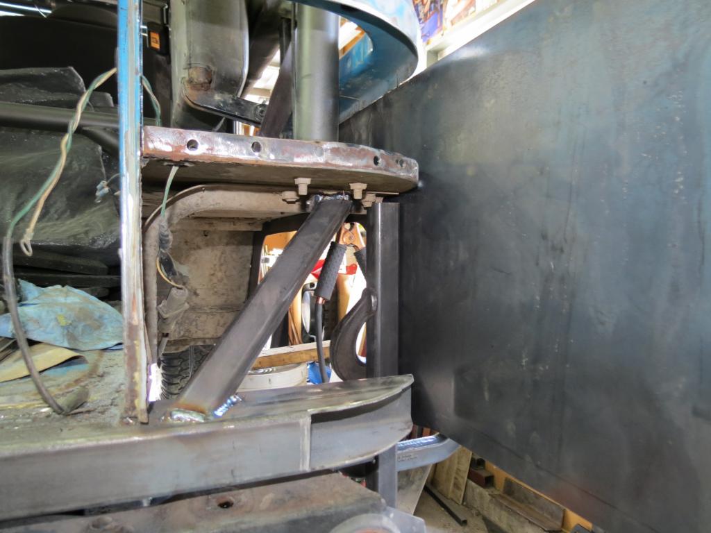

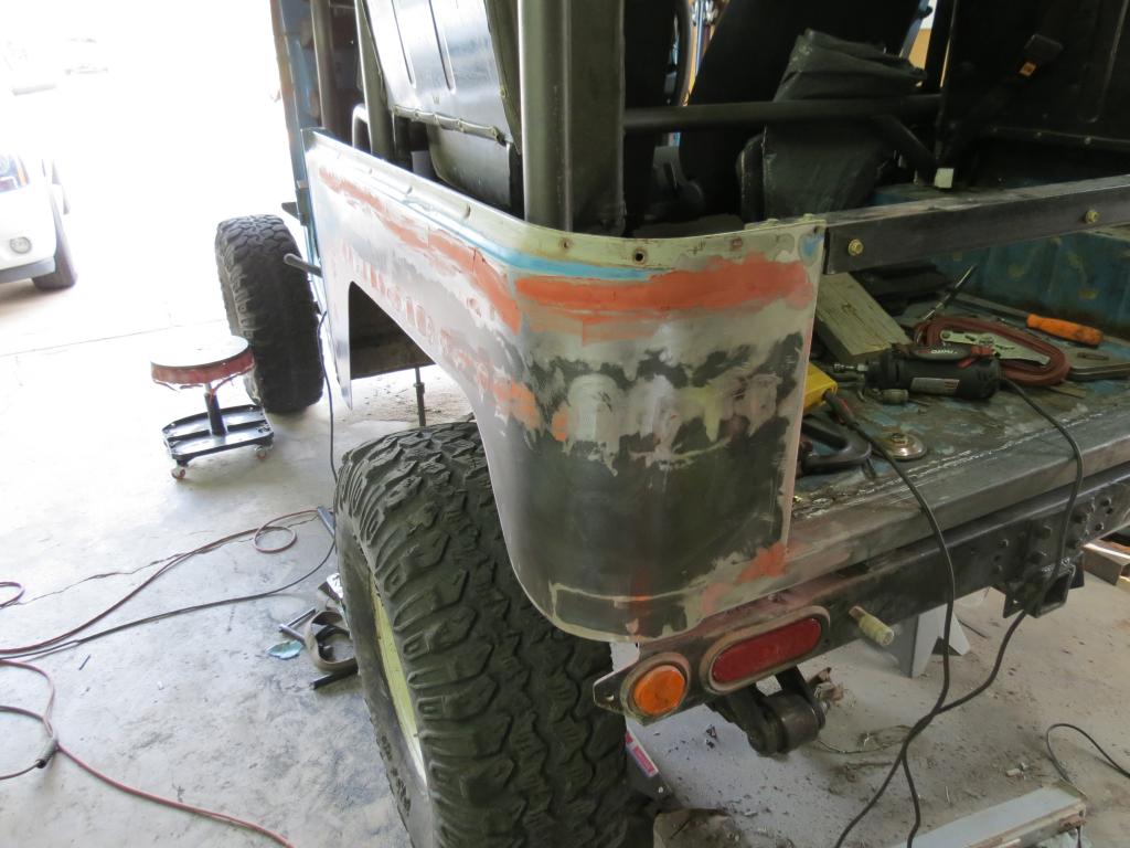

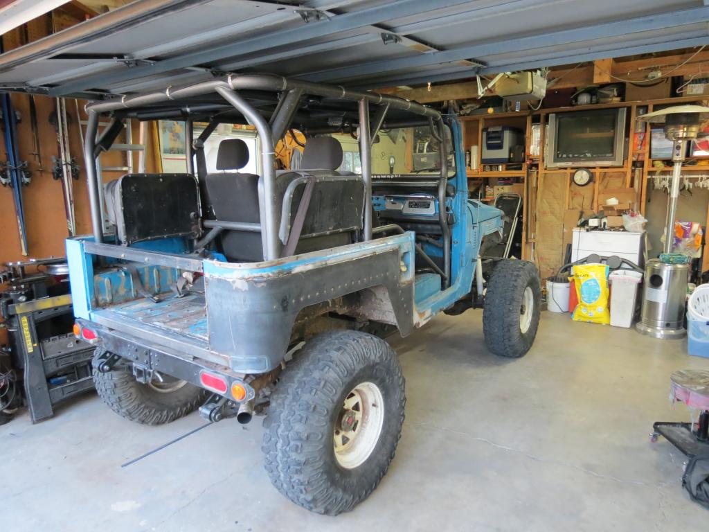

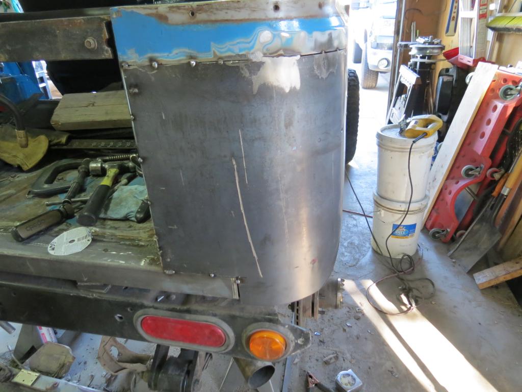

Passenger side is almost done
Tacked in
Brace to keep the bottom from bowing out
I might need to rethink my color choice. It matches really real in small quantities but not so much in a whole panel

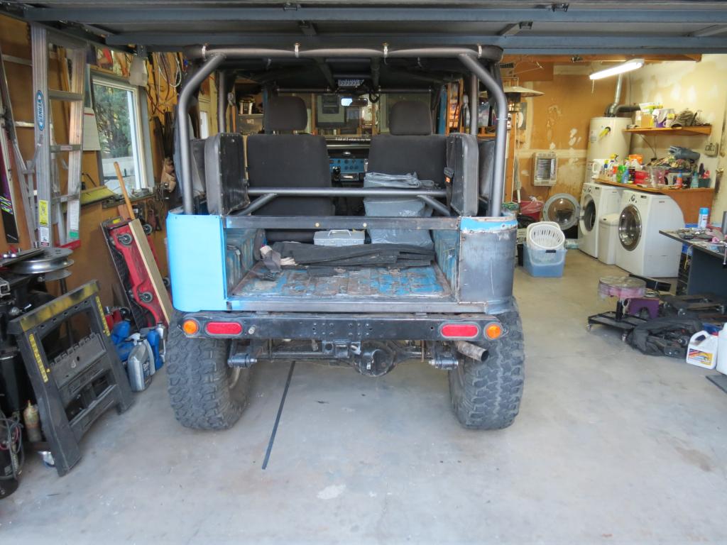

It was way more extensive than I planned and hardly 26 T quality but it will do for something that is bouncing around in the rocks.
It is the first thing I have ever done to it that increased its value, everything else has caused depreciation
