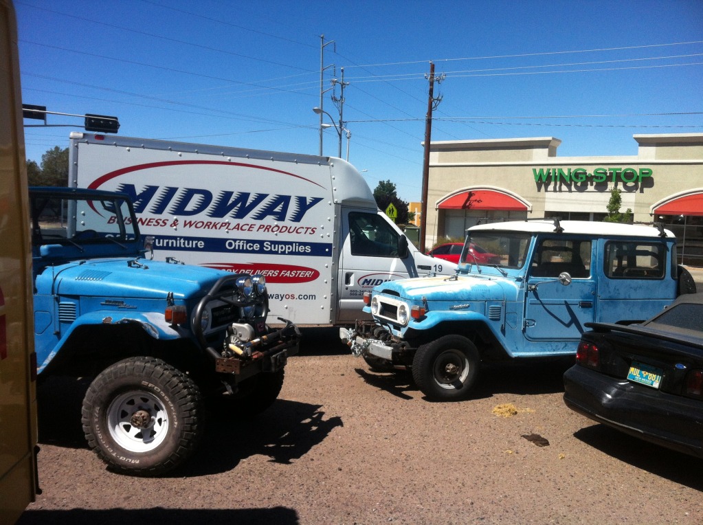

Look at how cute an FJ40 is when it is all stock, right down to the tire size.
This belongs to a guy in my neighborhood, it is a 1976 with PTO winch and dealer installed AC. He has this one and a '69, both of them were purchased new by his dad and have never been modded. He isn't selling them, I have tried.

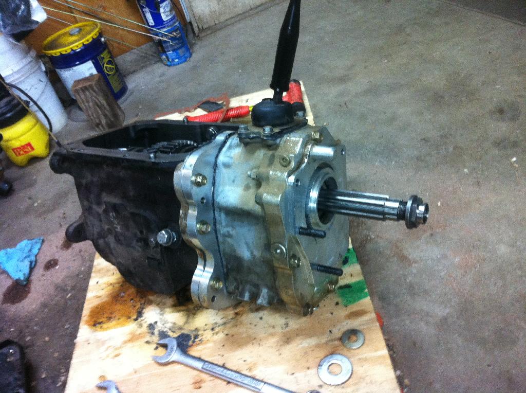

I recently picked up another project truck out of Farmington that I decided to part out to gain a few goodies off of it. It has longfields and Marlin highsteer but most importantly it has or should I say had a Marlin Toybox of the 4.7 variety
This coupled to my Orion and 4.10 gears will net an amazing 274:1 crawl ratio, with 5.29 gears it would be an absurdly stupid 353:1 ratio. I guess I will need to rethink my gearing when I go to 37's.
It goes into the garage on Sunday to start the next transformation which should include moving the rear axle back another 4"-6", shortening the front frame up a little, build a cradle for my new seats, add the highsteer and install said Toybox. I would like to have it out ready to wheel by spring.;)
