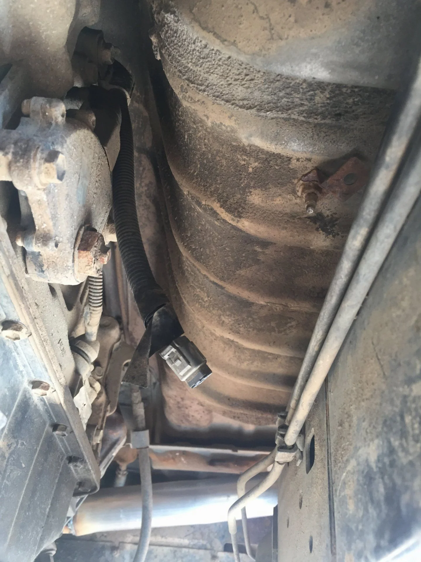

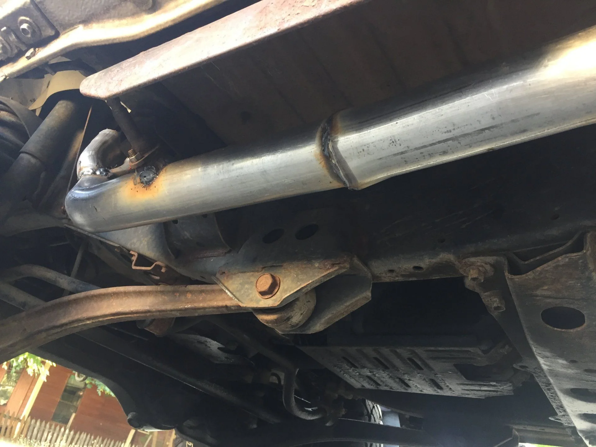

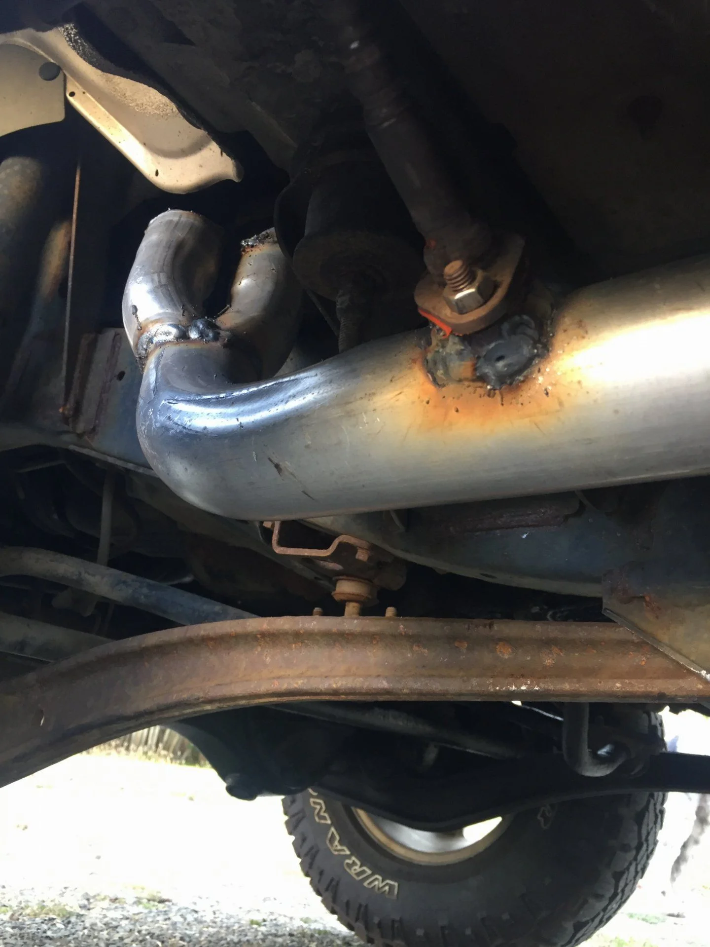

I crawled back under there to make sure I wasn't just missing the second oxygen sensor. Nope, nothing. Pretty sure I can see the wire dangling from where he disconnected it. When he removed the cats he replaced the gap with a single pipe instead of duals. Not sure why he wouldn't weld both bungs back in. Maybe the wiring wasn't long enough to reach the RH sensor...?
Since the Cruiser isn't my daily driver (I live in a town where nearly everything is walking distance) I'll finish the valve adjustment before I take it back in to the shop. And I think I'll order a new pair of Denso sensors/gaskets from Rock Auto to have him install in case he decides to go cheap on me. Photos below.

The OBD1 motors are somewhat controlled, run like two 3 cylinder motors, one O2 sensor is for the first 3 cylinders, the other the rear ones. To work correctly they both need to be there, and they need to be in the exhaust stream from the cylinders they control, so need to be upstream of the Y.
You need both o2s as stated, you also might have exhaust leak going on too
I'd have him do the whole darn thing over (correctly) AND find someone who actually weld while he's at it, because what I see on there now is shameful.
I recant my post, didn't realize the early 80 engines/obd1 were so different. And those welds suck, probably pinholes all over the place and will develop to bigger leaks.
Like others have said, that's a botched attempt @ best. Took it upon himself to leave out an O2 sensor AND welds like that? I'd get my money back & go elsewhere.
