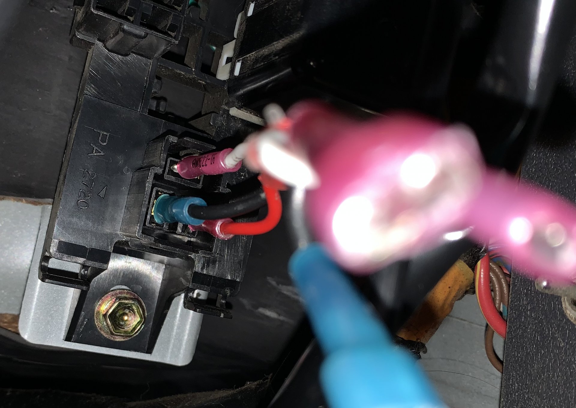

This worked for me for a 62. Not sure if this will help with an 80
I used this one in my '90 FJ62. I needed to make 3 individual connectors, like a mini harness, but I like that it has a small knob that I can turn to adjust the speed of the blinking. No need to wire in a bunch of heat-generating LED hyperflash resistors.
Amazon product ASIN B01EYGKRXK
These are the 3 jumper wires I made to connect to the adjustable flasher relay above.

do you have photos of your individual connectors making up your mini harness?
