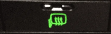

Do any of you know if the heated mirror switch on LX470s is supposed to be lighted? Mine is not and I can't remember if it ever was since i have had it...
On my 06 LX, yes:
