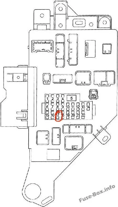

So I had already established that the fuse identified as #9 in the diagram I posted earlier had not blown therefore couldn't be the cause of my problem. But for giggles, I figured I'd pull it to see if the instrument cluster is affected. It is. By pulling the 15 amp fuse in the 4th slot of the middle bank, I no longer have several of my indicator lights at the bottom of the cluster, and the column of gear indicator lights is not working, and my gauges are all dead. So that fuse definitely involves the instrument cluster. However, I still have left turn, right turn, bright light indicators working, the door open indicator still works, and the airbag indicator works. So the instrument cluster definitely involves more than one fuse besides the one I've pulled. I'm just wondering if anyone knows what fuse those dimmable dash lights sit on?? Otherwise I just need to pull and pull until I find a bad one, and given the location of that fuse box, it just ain't fun.
Or, if you also know that all dimmable dash lights are on that same fuse with all the other dash lights, that'd be helpful too. At least then I'd know my problem isn't the fuse. But I really think it's a fuse...
Well, good news for me. It was indeed a fuse. I guess this is valuable information if no-one replied to my question. The circuit for the dash lights that are connected to the dimmer wheel to the left of the steering wheel is NOT on the fuse labeled GAUGE. Those lights are on the tail light circuit, labeled TAIL. Once I popped in a new fuse all was good.

Any chance you could post up a pic of the fuse/location?

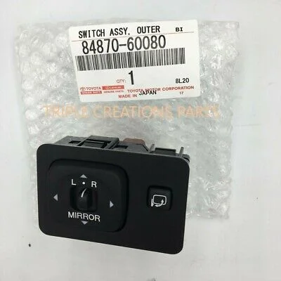

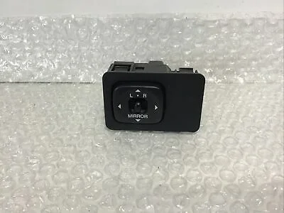

One thing that has always bothered me was that my side view mirror switch did not have a light. I was surprised to see on the list of bulbs that the side mirrors took a T4 bulb. I've had the vehicle since it was new and it's never been lit. So when I pulled those switches out to install the new bulbs, I saw that the switch had a bulb socket that was empty. So... I put a bulb in. And it worked! Hooray! Except the switch doesn't have a clear lens, no light shines through! So let me guess... The Lexus switch was the one that was lit? And I suppose if I pop the Lexus switch on there, it'll be nice and lit up? The part numbers are different for that switch between Toyota and Lexus. Here is the Toyota switch:
Here's the Lexus:
So besides the obvious heater button on the Lexus switch, can anyone confirm for me that the Lexus part has the clear lens and would be lit if I swap it?

Actually the additional button is the “mirror fold” button.
I can tell you that the Lexus button is lit (in a LX470) but I don’t know if they use the same connector on the rear, or if all of the wires in the connector from the Lexus are present in the LC.

Here's my bet. It's the same part. I want to dissect this switch a bit when I have some time. My suspicion based on other differences between the Lexus and the Land Cruiser is that the switch is the same but there's something in the housing that's not letting light pass through. On the Lexus version there's an opening for light to shine through. I want to see if I can get behind that switch cover with a flashlight and see if light comes through it. My bet is that there's a mod lurking back there. Or there's a purchase of the Lexus switch in my future when I break this one. Stay tuned...
Nah. I popped it out and had a look at it. The back of the switch has two small Phillips which I loosened, but those don't appear to hold the housing of the switch into the larger trim piece that meets the lower dash trim. The switch pops into the housing with three plastic tabs that click in place, and they do not appear to be designed with the intention of ever coming loose again. I could attempt at horsing the plastic a bit more, but that'd just end up snapping it. And from the looks of the front of it, it's a solid white imprint on the switch, not a clear lens that allows light through. And I don't think it's worth the money for the Lexus part, so I think I'll just leave it be. I've lived with it for 20 years...
Here is an auction that shows pix of the back:
I can see looking at the front that it's different. Seeing the up down left & right arrows in those photos, they're clearly lenses. On the Toyota part, they are white and not see-through. Definitely not the same part. But the back part of it is the same, where the bulb goes in the socket. And the electronics work in the Land Cruiser version, the bulb lights up. But the light has nowhere to go.
The Lexus part is on eBay for around $100 shipped. But on my list of things I want to spend $100 on for my Land Cruiser, lighting that switch ain't making the top 5.
Just another cheezy thing Toyota held back from Land Cruisers to create $10,000 of "value" for the Lexus package. That was the difference in retail price of the trucks in 2001 when I bought mine. The LC was $59K, the LX was $69K.
Speaking of which, I wonder if the LC side mirrors have the capability to fold if using a Lexus switch and maybe making some minor internal change in the mirror housing?
The mirror fold button is a separate wiring harness, the connector isn’t there in the LC.
