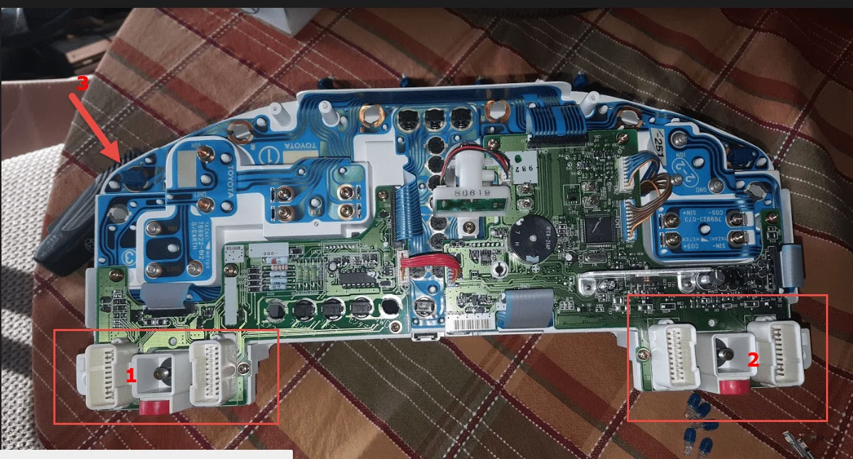

I'm having trouble getting everything to work. Right now, the whole instrumental panel is non-functional. I made sure to sit it in right and screwed just the 2 screws that hold the plugs in (1 & 2). I'm also just testing with one bulb (3) to see if it will come on. The intention is to get it to work, see it's orientation and then copy/do the same with the other 5 blue ones. The "Toshiba" is on the lower side. Three tests in, no luck.
Pretty much can't drive around. No speedometer, the gauges, nothing. Perhaps the fuses? I have to leave and work on this later on tonight when I get back home. Was looking forward to using the cruiser today but have to take time to workout this electrical stuff.
Think I might just put everything back as it was originally (in working configuration hopefully) and work my way through the replacements.
Any input, highly appreciated.

Try testing the polarity of the bulb/Toshiba socket to find the positive contact (9V battery and two leads works fine for this). Starting at your #3 arrow and working right, the positive contact should be top, top, right, right, bottom, bottom. I had the same problem with the non-functional panel at first. The plugs (1&2) had not gone in all the way on my first attempt. I lined them up more carefully on the second attempt and everything worked fine. I hope this helps.
Thanks for the feedback. I will need to test the polarity on my next attempt with the new LED bulbs. In the mean-time, I reverted everything to original (in an attempt to troubleshoot) and after multiple attempts over a couple of hours, it all came up... a ding followed by a lit instrumental panel. On one side of the panel I was able to seat the plug by hand by reaching in then screwing it owing to the longer cable connection. For this side, I was certain it was securely sat. On the other side (left side) it took multiple attempts to actually seat it right. RELIEF! at the end of the day.

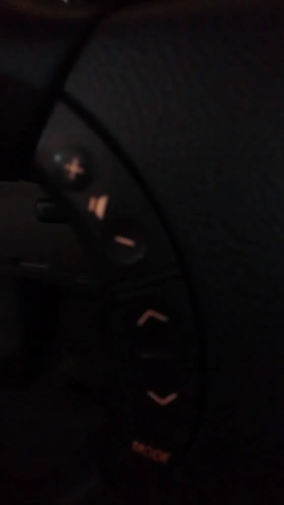

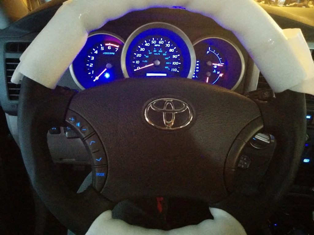

does anyone have audio controls on the steering wheel that light up? I've seen identical controls on 4 runners and others that have stock lights in, at least as far as I know they're stock. Mine aren't lighted- I want that.
My 2006 LX has faint green backlighting of the steering wheel controls.
It just dawned on me that my steering wheel controls were unplugged until I added the axxess control box and wired it up. SO.. mine worked for a bit and then didn't work for a few months while I was being lazy. Then I swapped head units again and installed the axxess, now they work fine. Although they're very faint.
Thanks jLB, you made me stop and think about it.

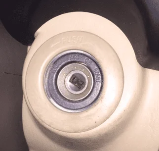

I read somwhere hat there is a light for the ignition
Anyone know how to replace the bulb if there was one.

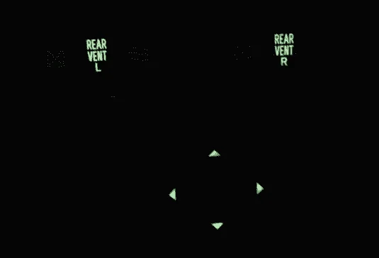

Also is any of the panel near the switches for the rear quarter Windows or power mirrors illuminated?

example of ignition switch lighting:
I believe on a LX470 the mirror controls and vent windows are lit, on a TLC it's just the vent windows:
