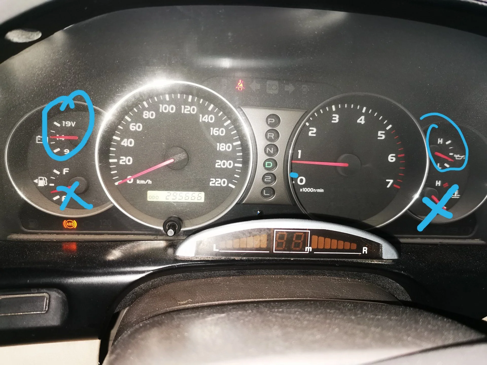

can anyone please tell where are the leds lights for my gxr 2003..? i ordered t5 from ebay but was surprised to see there were no bulbs inside the speedometer maybe it have leds? my oil gauge bulb and alternator gauge bulb are not working and for fuel and temprature also the bulbs are so fade..encircled gauge lights not working rest all so dim.. please help

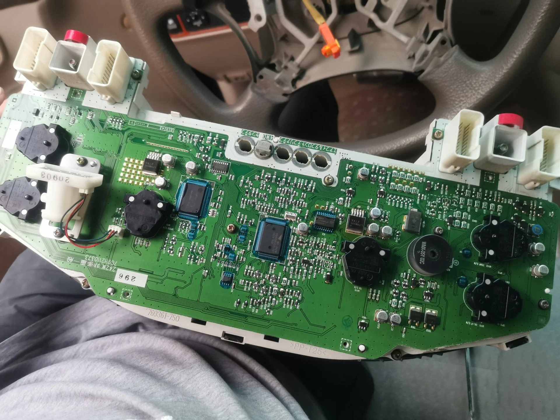

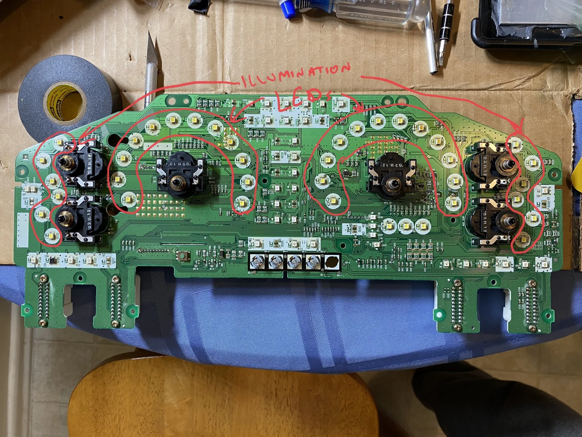

I had the same question and took a look inside my 03 LX. Possible I suppose, but not easy. The illumination is all LED already, so you’d have to remove and solder in a bunch of surface mount LEDs
Thanks so much for this pic! I have an 03 LX and was wondering what the lighting looked like. I hadn't felt like pulling it apart just yet.
I'm fairly certain I have a couple of LED's around the speedo and tach that are out. Those gauges are dimmer than the rest of the cluster.
I found a decent video on how to replace surface mount components. Now, do I really want to try this?

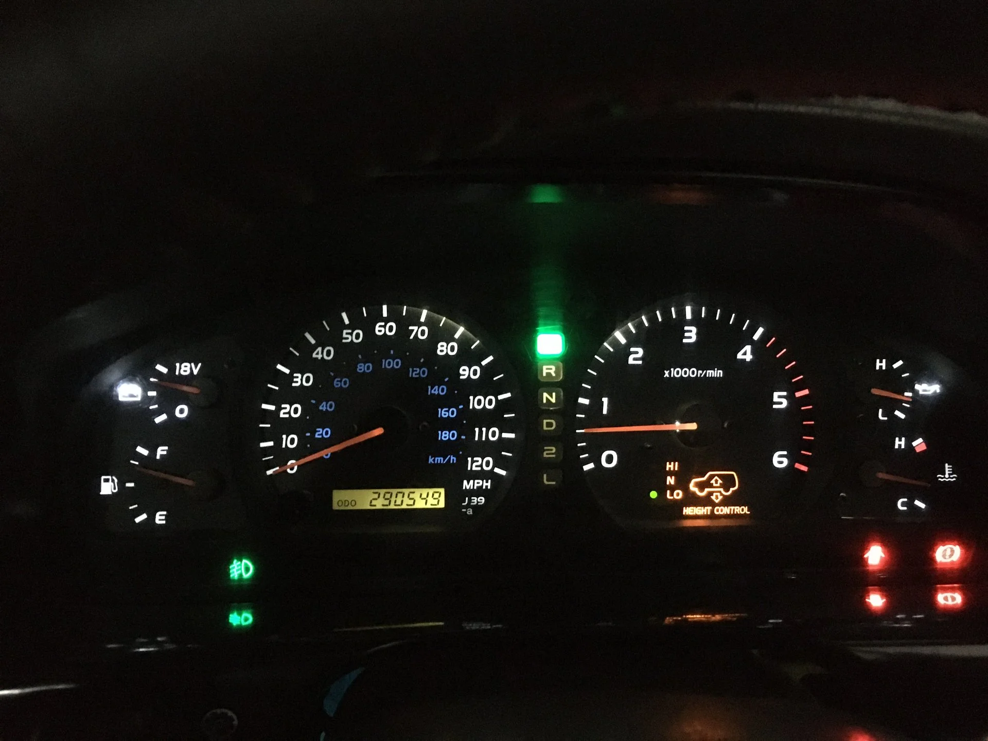

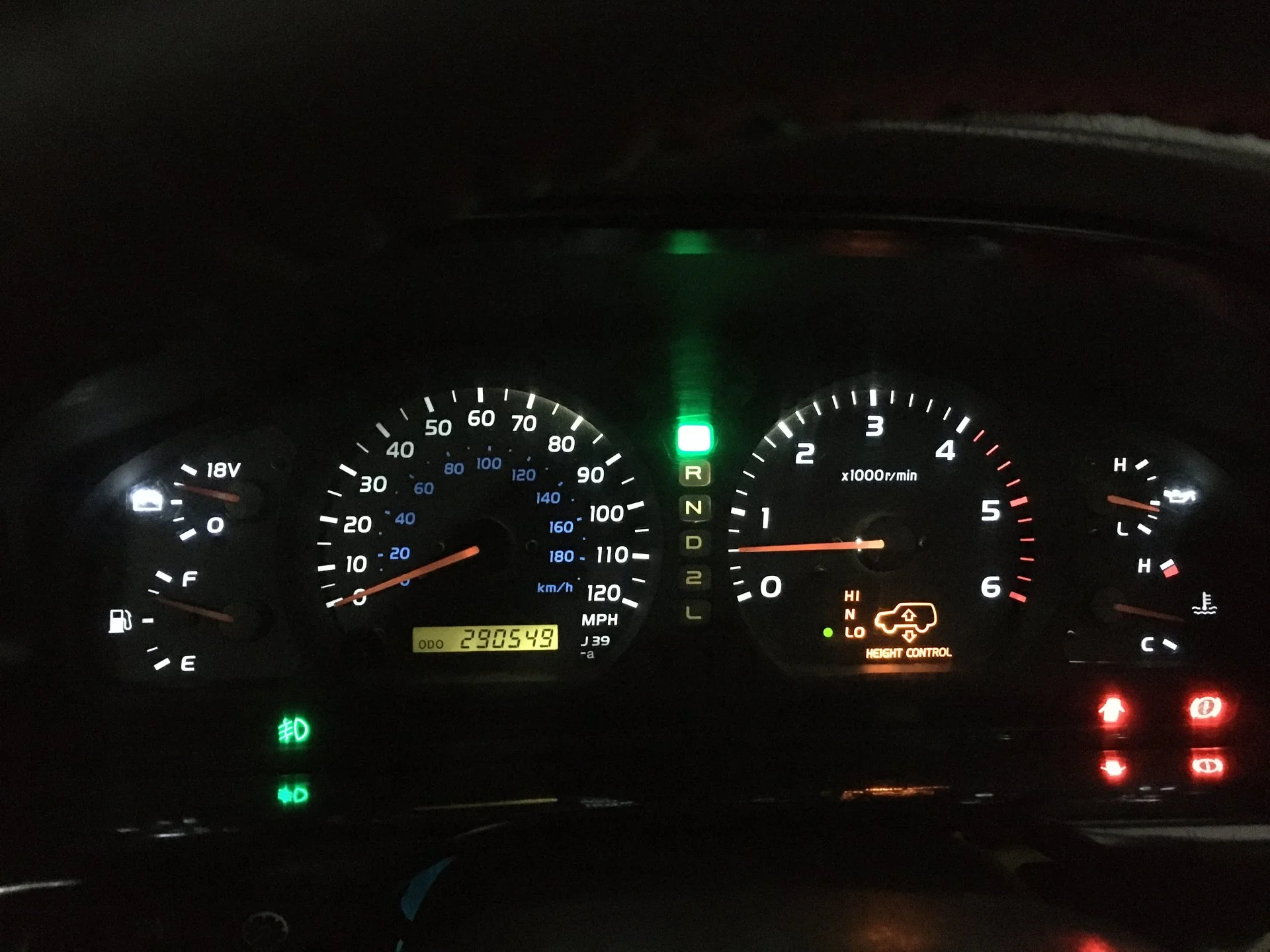

Hey as you guys can see needles are not bright enough
So what should I do for needles where can i get these from. And what is the method for replacing it?

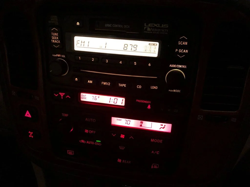

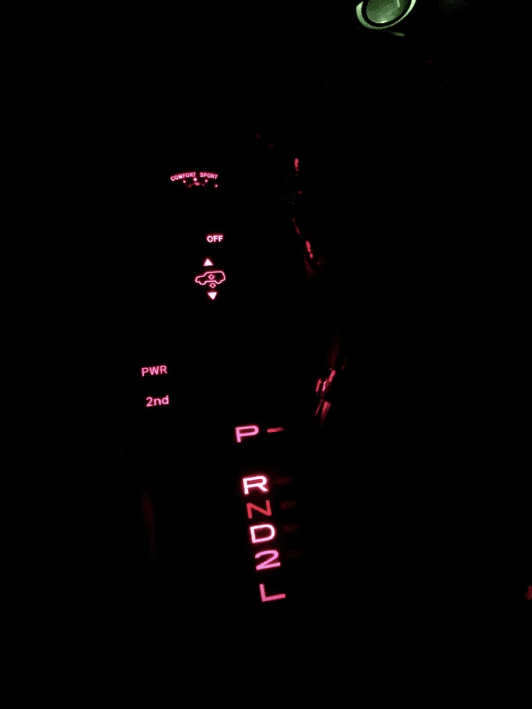

Thanks for the tips everyone. I went red for my buttons and also "de-greened" the OEM radio. I doesn't match the red, but way better than the factory color. I'll be dropping an aftermarket radio in at somepoint anyway. Dropped in red courtesy door lights in as well to not attract the bugs so bad when we go camping.
I'll post more about the radio tear down in another thread.

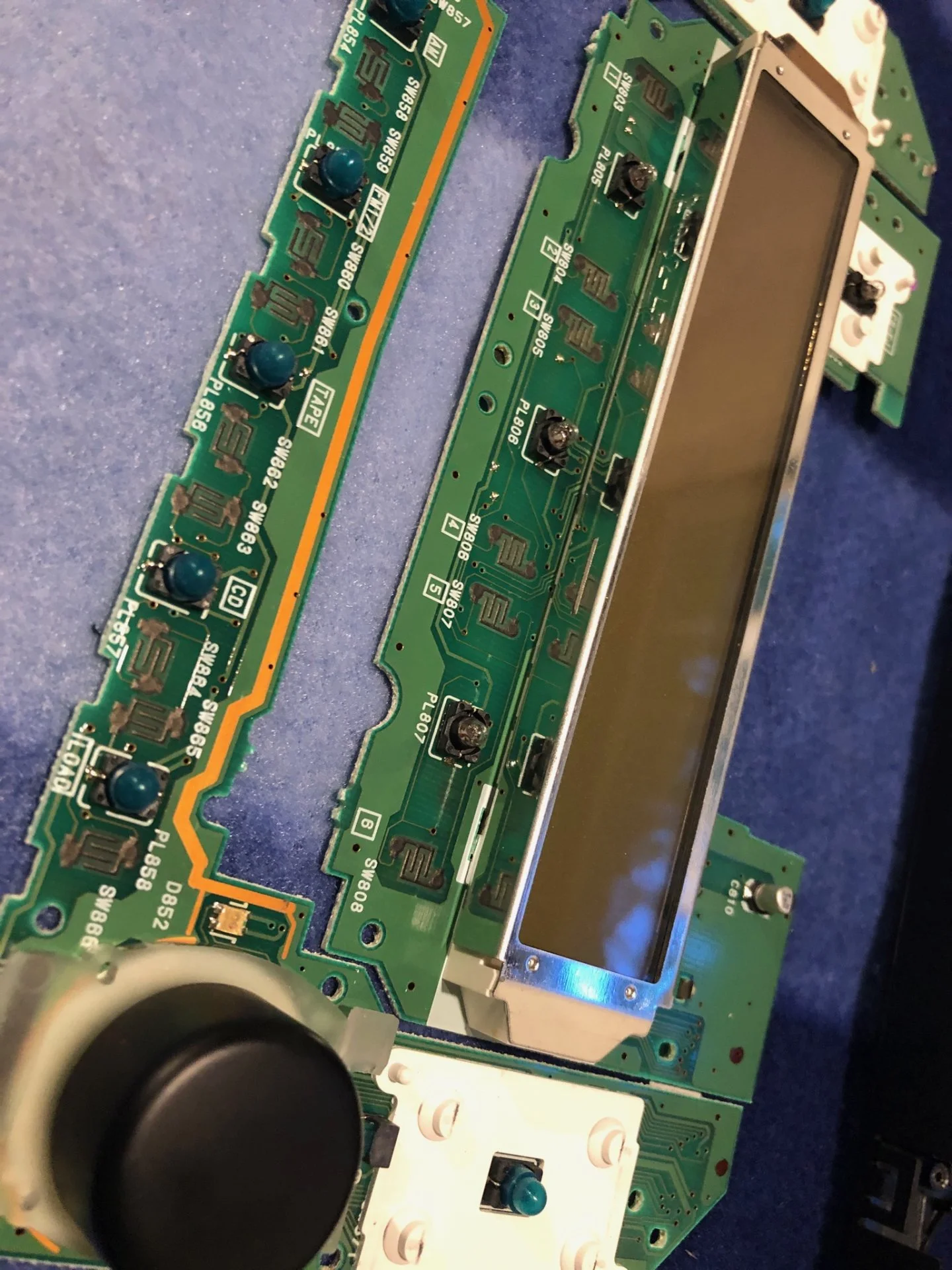

how did you remove the bulbs as shown , the cassete player / dvd buttons have which bulbs , are they easy to replace with LED bulbs or a pain ., can ypu share some pics of what to look for if one wants to change these factory stock bulbs

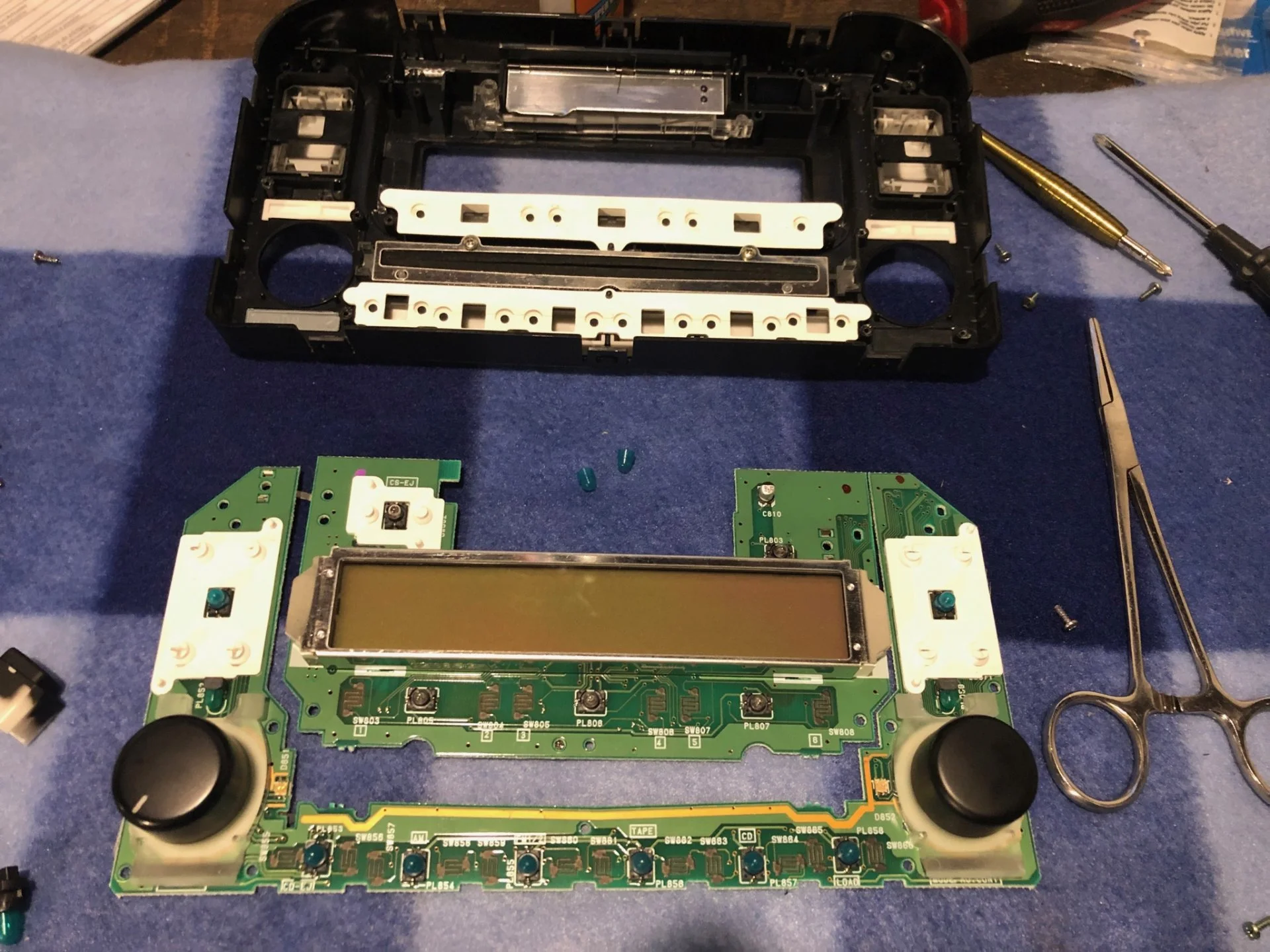

Here’s a couple pics of the radio pulled apart. You pull the little green condoms off the bulbs without removing the bulbs. Once the radio’s out of the car, it’s a couple clips and a couple screws. Be careful with the ribbon cable and a couple loose bits that sit behind the buttons. Hopefully that answers your question.
but these bulbs seem to be soldered on to the board - its to risky for me to pull them apart and re solder - what size bulbs are these t3 or t4 new wedge
The bulbs themselves do not get removed. There is a green rubber cover on each bulb that can be removed with the bulb on the board. They then glow orange-white as you can see in my first set of pictures. There aren't options to replace them entirely unless you do feel comfortable removing and soldering new ones on. I don't think they are a standard bulb such at T3 or T4 from what I can tell.

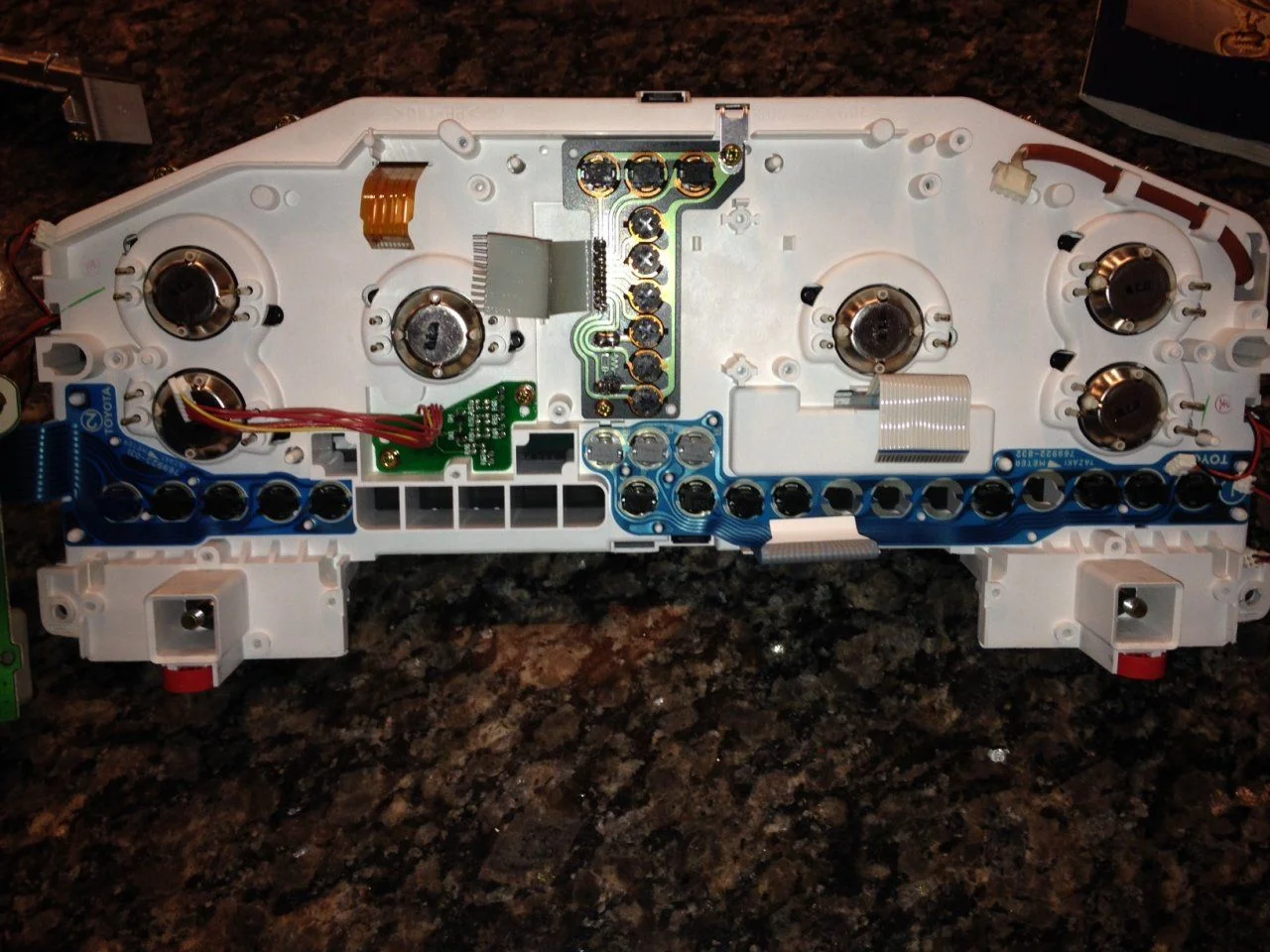

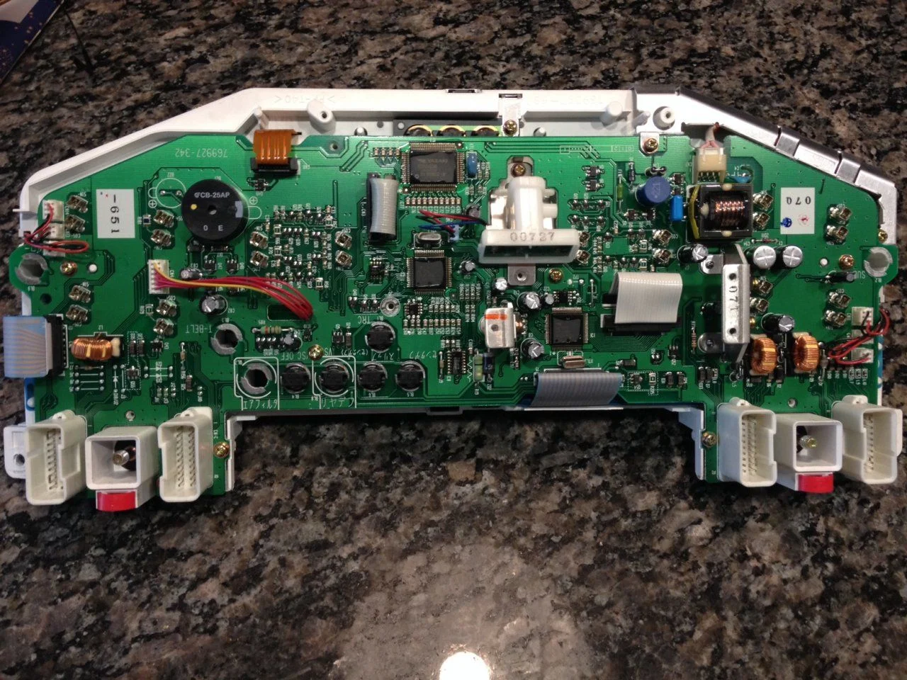

Thanks for the info... my '01 LX470 had a few bulbs out, and I wanted to swap them with LED's. After pulling the cluster, I found that it's a bit more diffiicult than the TLC cluster. You can access five of the # 74 bulbs below:View attachment 915703
This is a bit of a pain, but you have to unplug 8 connectors, 5 ribbons, and undo 15 screws to get to the transmission position bulbs. The connectors require a firm tug, but mark them first so you know where to reconnect them. The ribbons need to have the plastic locker pulled up before they can be pulled out (just like any circuit board). The screws are easy, of course. After disconnecting all of those, you need to pull up the circuit board because it's attached to a bunch of connector pins for all of the gauges.View attachment 915707
The you get to the rest of the bulbs. There are 6 T4's for the transmission position bulbs. There are another 19 Type 74 bulbs under here.
I didn't buy enough the first time around. To summarize the 2001 (and I hope it's the same for other years) LX470 instrument cluster requires:
  • 6 T4's
  • 24 Type 74's
As you can see, my ECT PWR and 2nd start lights are now working. Thanks for the help!View attachment 915712 View attachment 915713

You still happy with your red LED swap? I would love to give this a shot but am a tad hesitant just yet, want to go all in and convert to a single color if possible, my wife’s old 2003 CRV is all amber/red (ish) and I love it!
While fixing my climate control buttons I put in LEDs in all the switches and behind the instrument cluster. I did not change out blinkers, brights, shifter, but everything else is now a nice amber. Another LED thread has links to the website for "super bright LEDs". That was great and easy to order.
