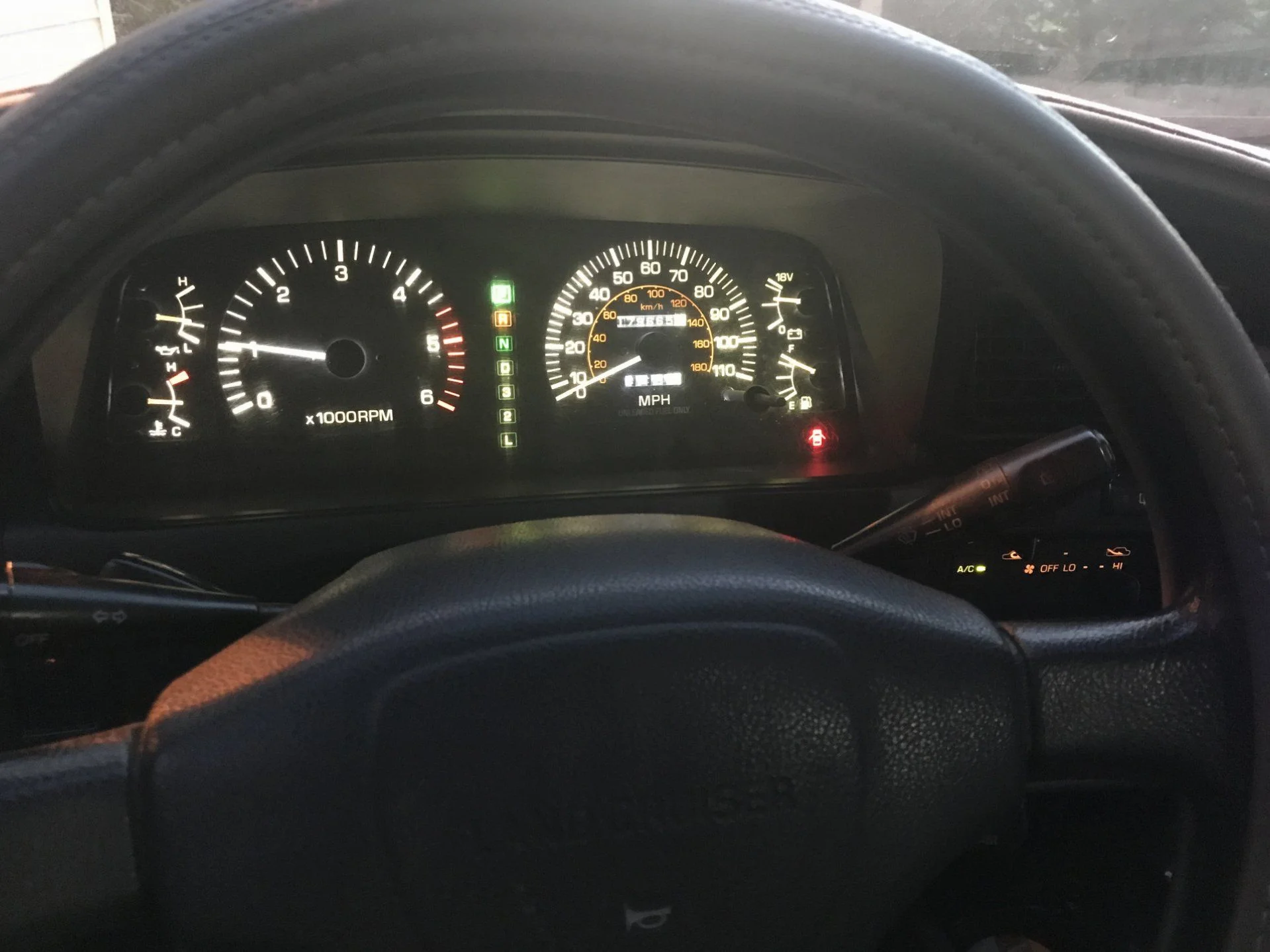

Installed white LED dash lights tonight. Looks a lot better, IMO.
How hard was this??
It was very easy. A screw driver and some time to take the dash apart. I got the bulbs off amazon. The cluster has 4 backlights. If you want the gear selector in the center to light up light, you have to take it out and add a different LED light in it.

I only replaced the back lights. 4 main backlights. And one backlight on the indicators (different bulb). I thought changing all the indicators would make them very bright for normal driving conditions. I did install a new gas light as mine was blown. It's the same bulb as the cluster backlights.
And yes they dim just fine.

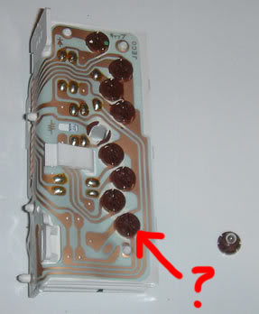

I got the 4 main back lights in - looks a lot better.
For the 'one backlight on the indicators (different bulb)' which one did you change? is it the lowest (lowest one in this parti in this image (image from another thread on similar topic and I think from a '91 so may not be identical) that you changed too?

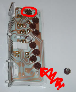

edit - never mind - I tried replacing the green bulb and that got it

Yeah it's the top light with the green bulb. Post some pics when you get it lit up
