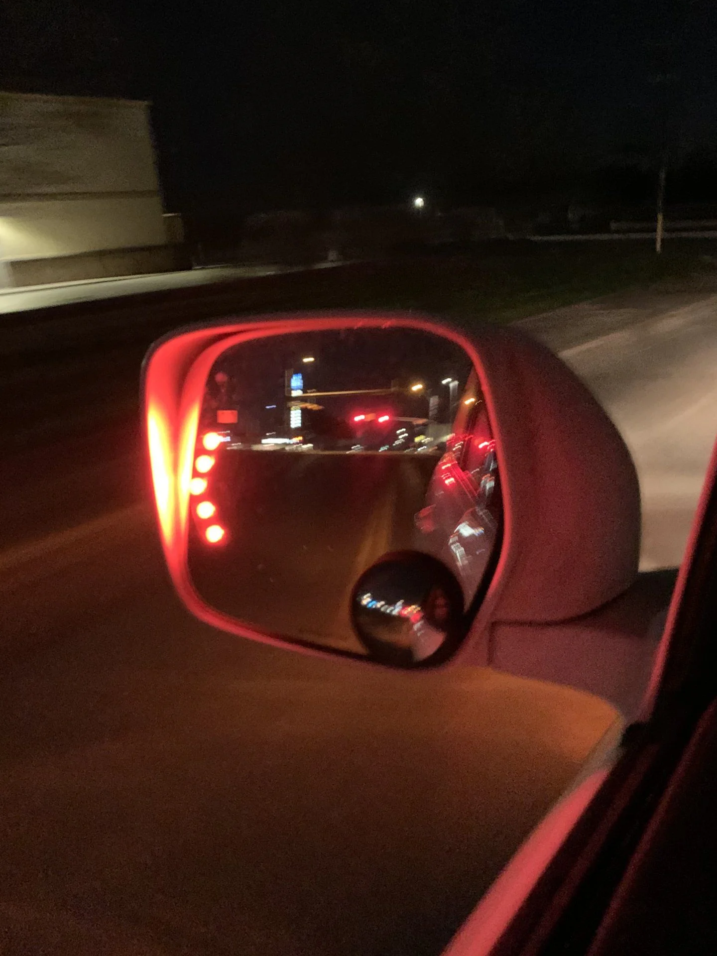

Is there a fuse for the led blinker for passenger side side-view mirror? Mine no longer flashes and I can’t seem to find a fuse for it.
Year = ‘04
This is the driver’s side
Has the passenger side ever worked? Did the PO possibly replace the passenger side with one without the lights? Can you see the 5 spots in the mirror where the lights are located?

Yes the passenger side used to work. And started working intermittently and has not worked this past year

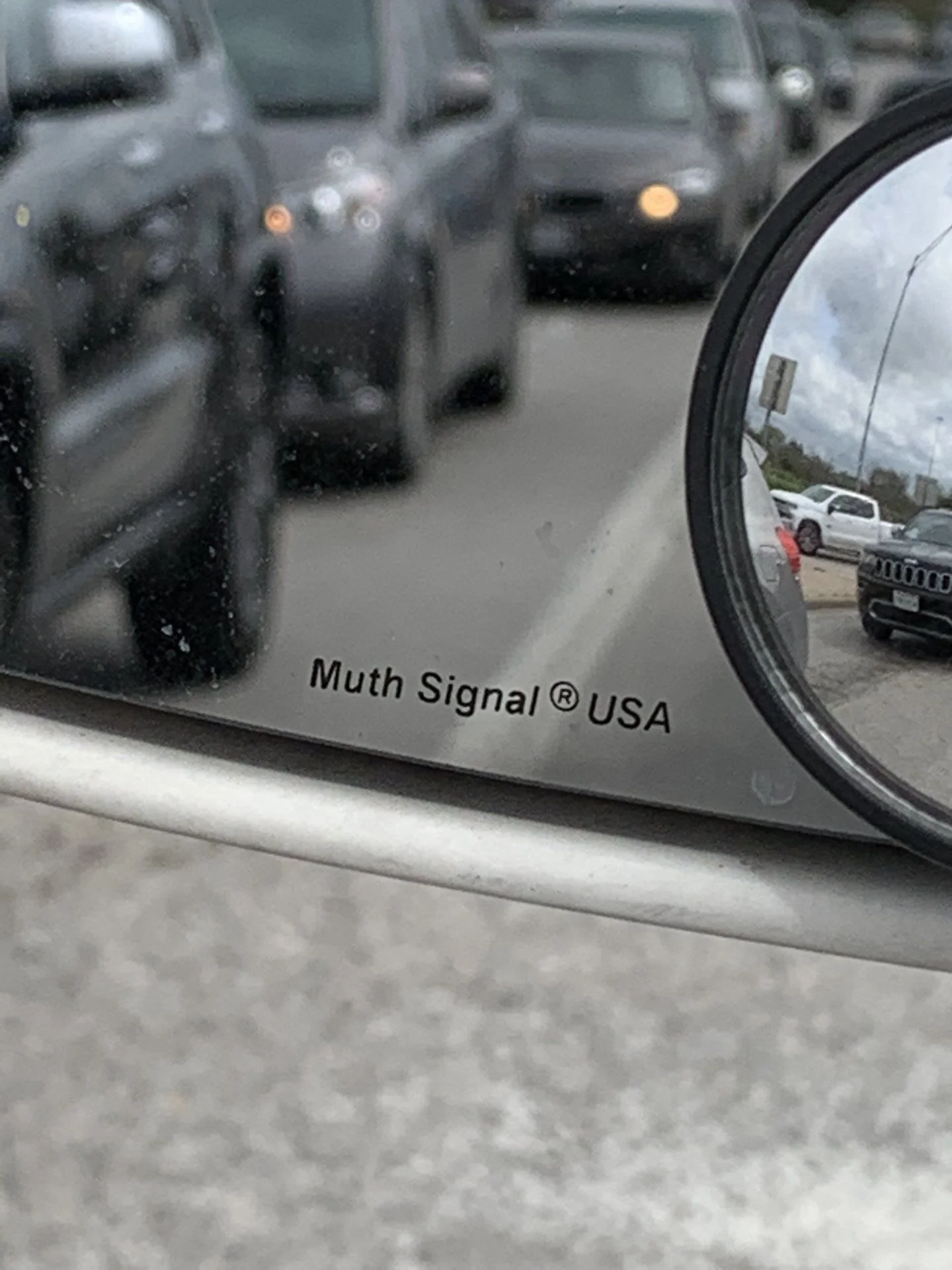

This is stamped at the bottom
If they are 'Made in America' then as I say 'Hats off to Muth' I'm not saying they are not made in America, but 'R USA' only means it's a Registered American company, LED's are supposed to last thousands of hours, thats why I used the phrase 'Cheap Chinese Knock offs'
Component parts can be sourced from all over the world in this global market, then the kit can be assembled in what ever country sells the kit.
For example, what more of an American company can you get than Harley Davidson, I can tell you, there are parts on a Harley and fitted by Harley that are made in China, I know, I have four Harley's.
Anyway, looks like just a replacment mirror is available from Muth, so no need to hunt for a fuse, just replace the mirror.
