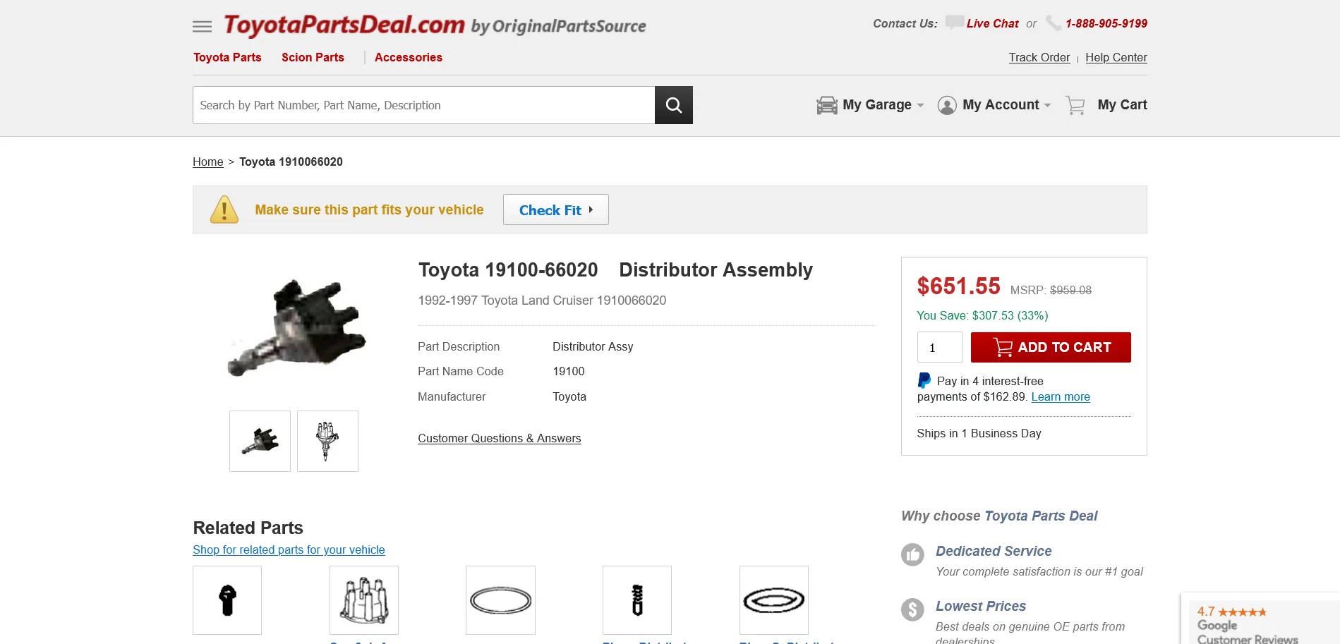

Screenshot 2023-11-01 at 15-24-08 19100-66020 Genuine Toyota Distributor Assembly.webp

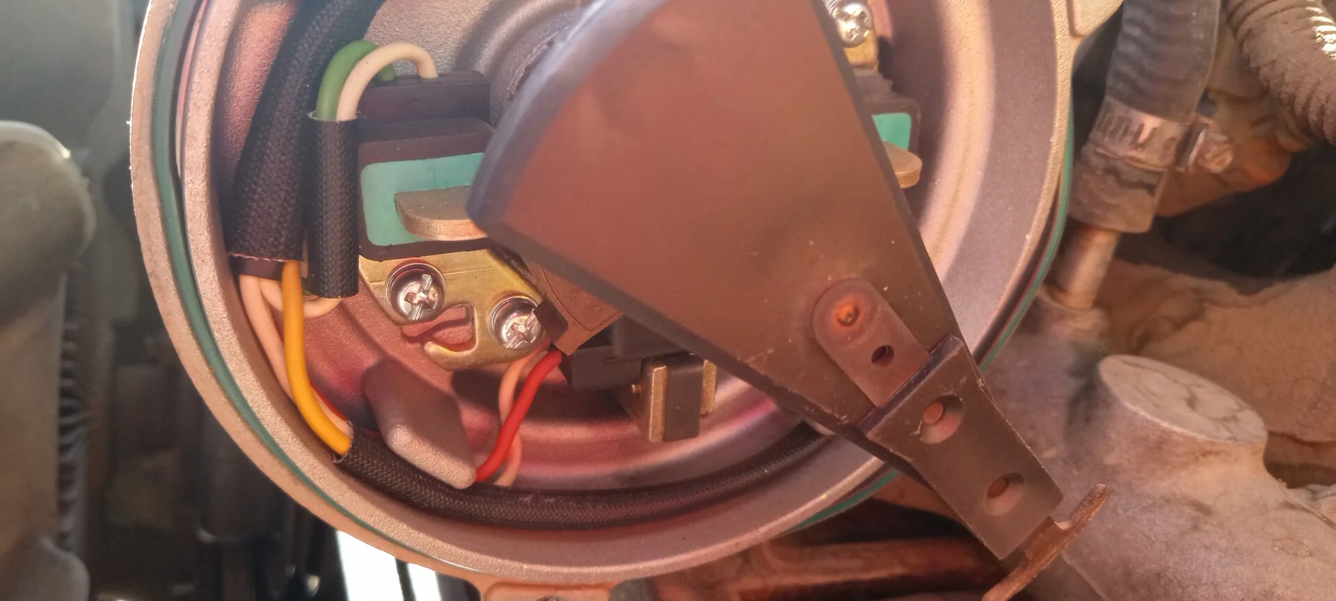

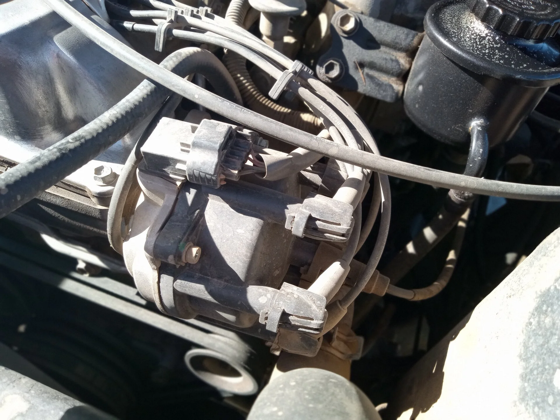

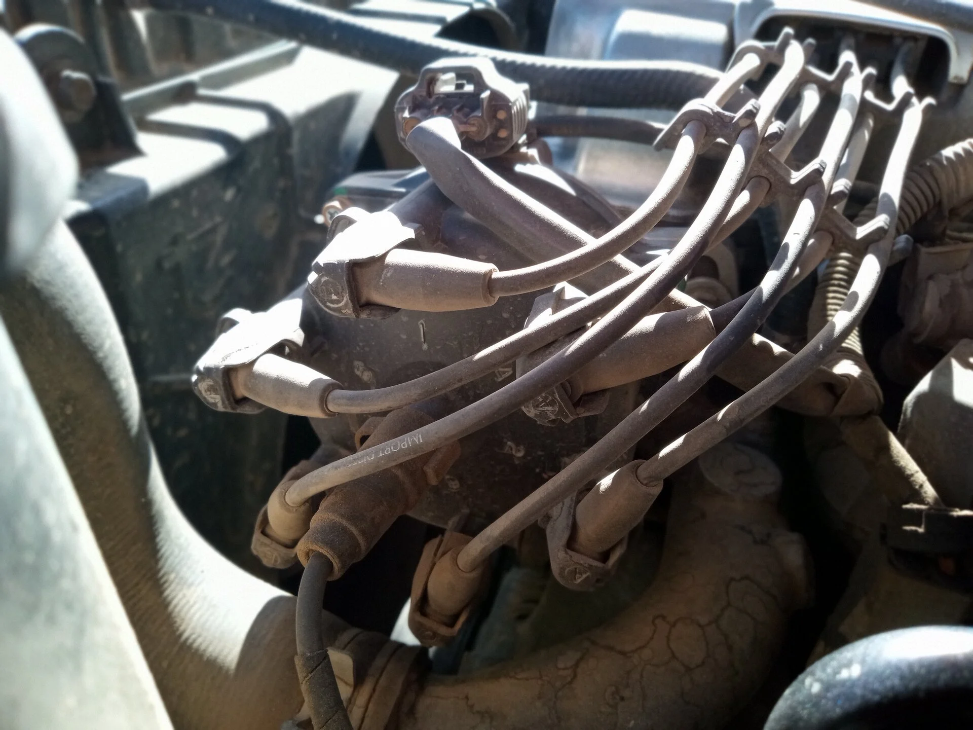

First 2 pics, exterior, unmolested since install in May 2020. Estimate about 13kmi since then.

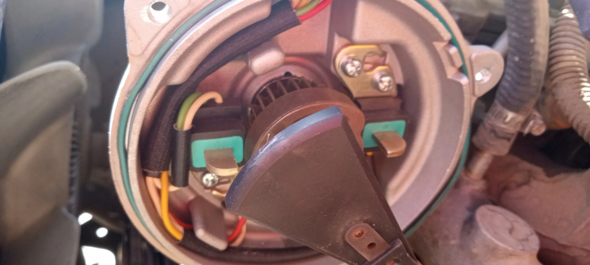

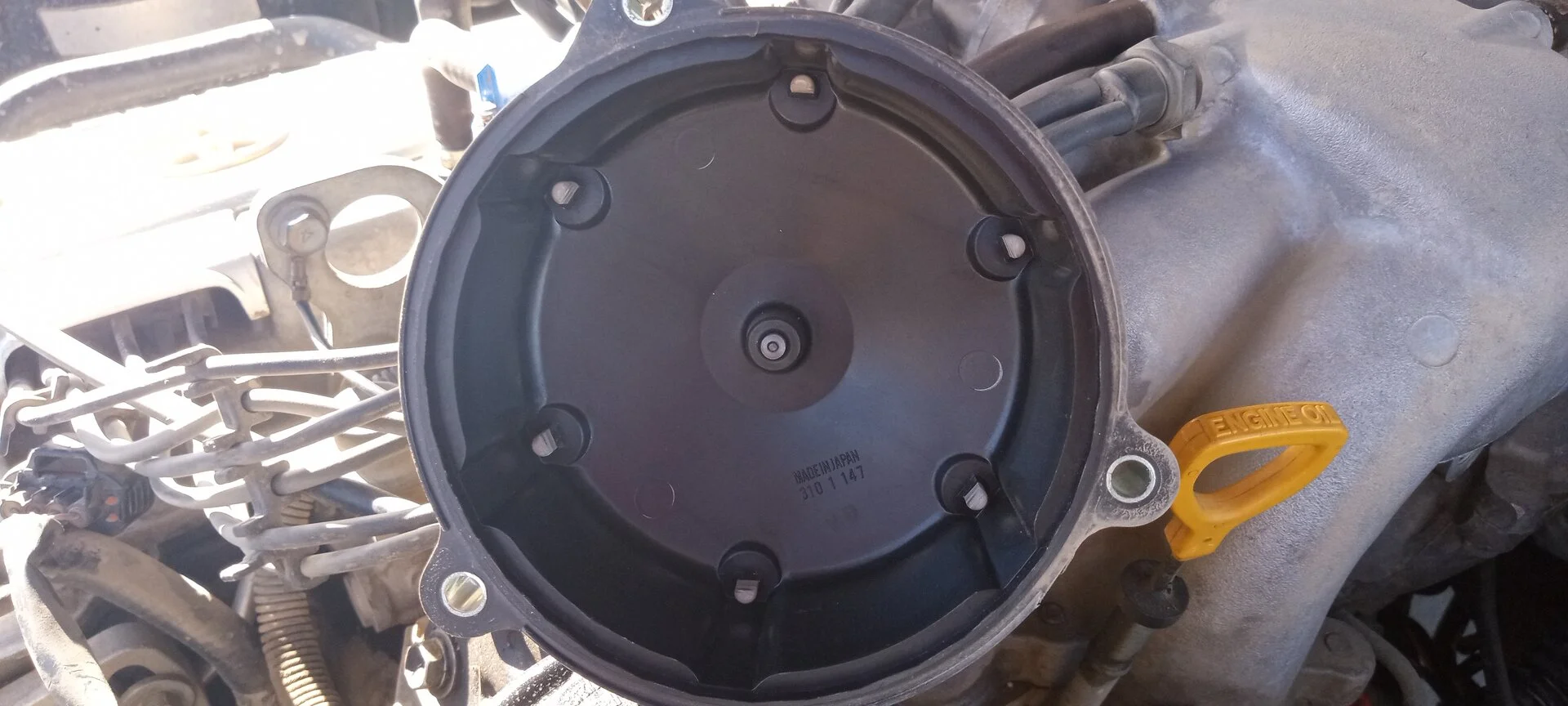

Underside of cap and interior:

@LandLocked93 : Inside of your aftermarket Dizzy looks very clean, is that a slight amount of oil/wetness at 6 O'clock?? Hard to tell if that's oil or a shadow. Either way, looks very good.
I saw that in the pic. It does look like oil. But alas it is only a shadow. (plus my current oil status is much darker than that anyway lol)
Something else I noticed in the pic of the underside of the cap, it says "Made in Japan". Amazon states the dizzy is of China origin. And that is the cap that came with the unit.
Interesting they outsourced the cap. lol
