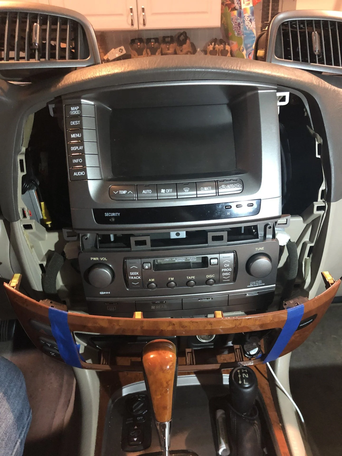

Also my dash is from an LX, so the bottom piece of the dash goes all the way across, doesn't split in the middle like that
My dash looks like this, all the picture i've seen they only provide the screen that goes down the middle, how would that work if my dash is a solid piece on the bottom from left to right like this? Sigh, when it comes to electronics i feel like i have special needs, i'm a mechanic but scared of death of electrical stuff. Someone hold my hand through this, i want to order one and just want to make sure i get the correct one. Being that the company is in China returns would be horribly inconvenient.
And can someone tell me why lexus still had a Casette player in a 2007 vehicle when casettes were extinct in 2002?
The Tesla screen should come with the vertical replacement side pieces. You can also order wood/plastic OEM pieces as well.
I have a 2004 LX that looked just like this. I highly recommend getting the new side trim as long as it’s the wood grain. I cut my wood trim down and would prefer the simpler drop in side vents.
