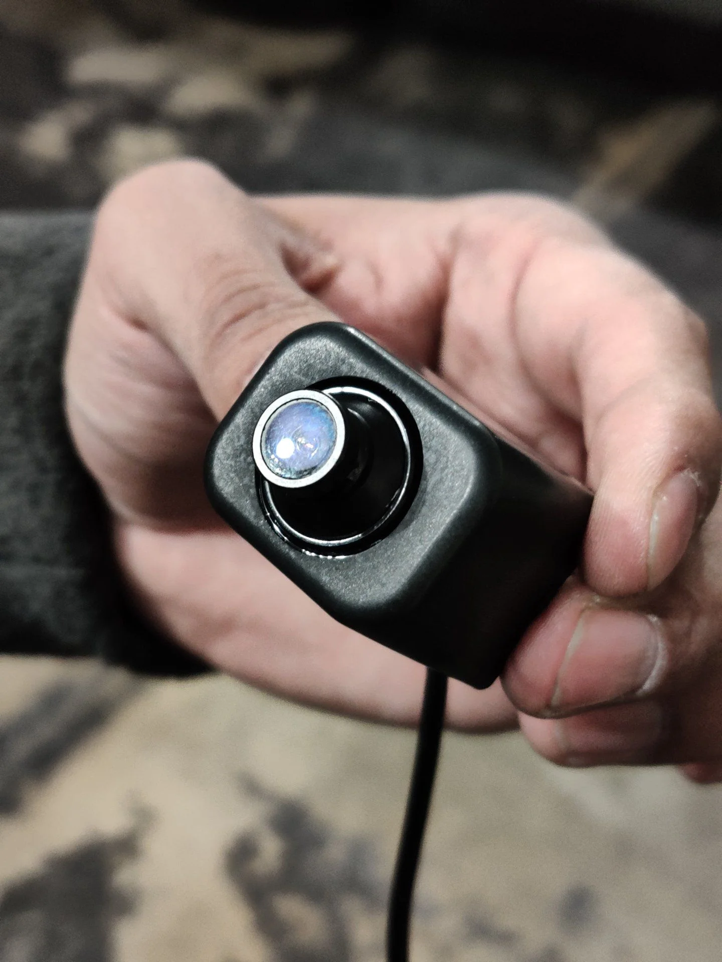

In my 2007 lx470 we also ended up installing a new rearview camera and running a wire down the length of the car to the back. However, we took apart the OEM camera/mount and fabricated it to house the new one.

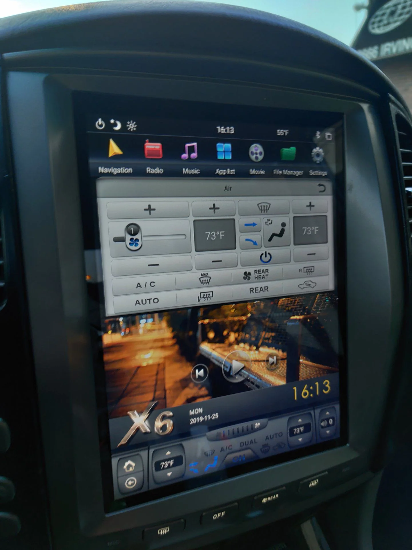

I'm having the weirdest issue today where the climate control screen is showing up in the top half the screen and the wallpaper and play button are in the bottom half
