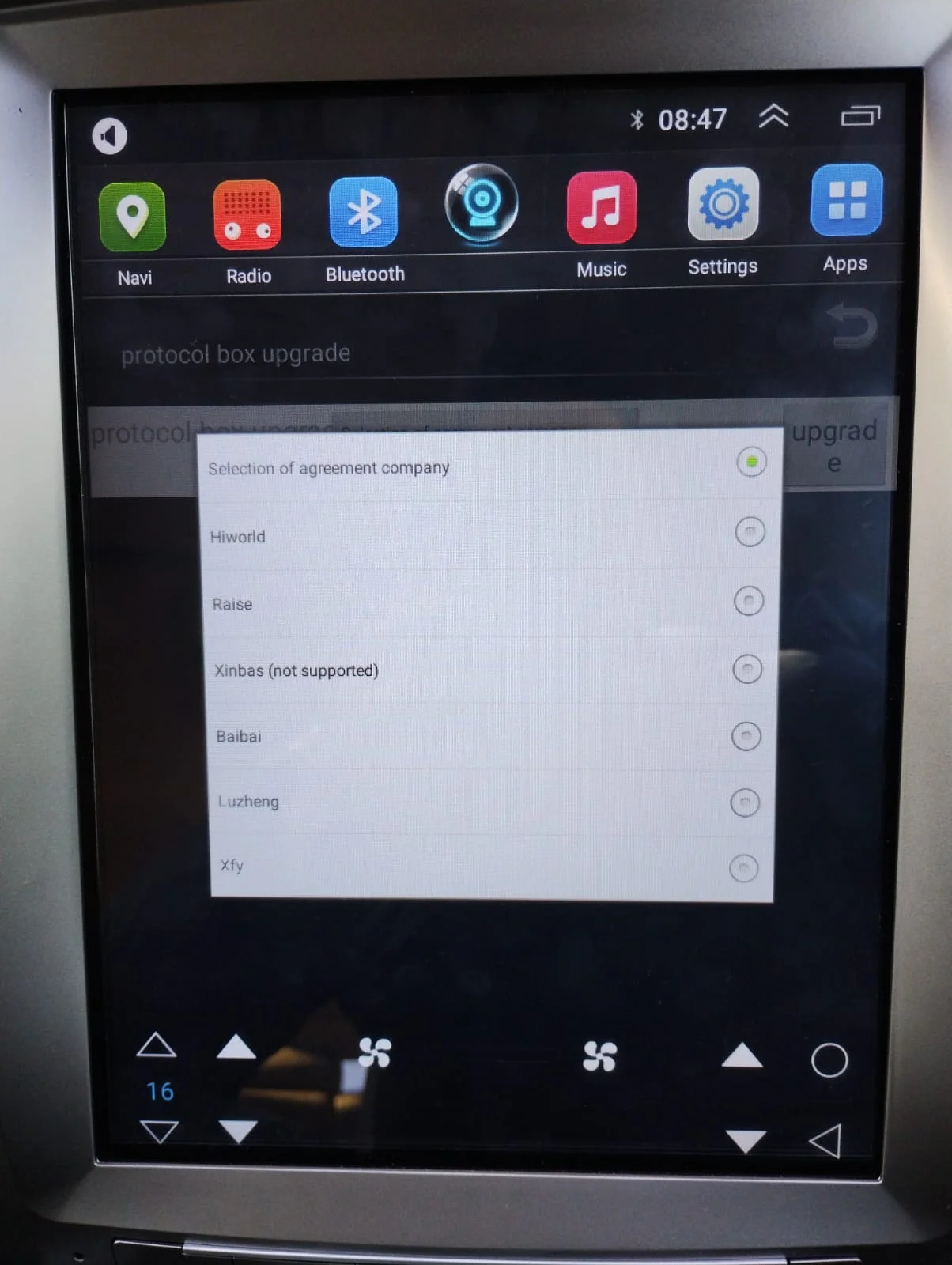

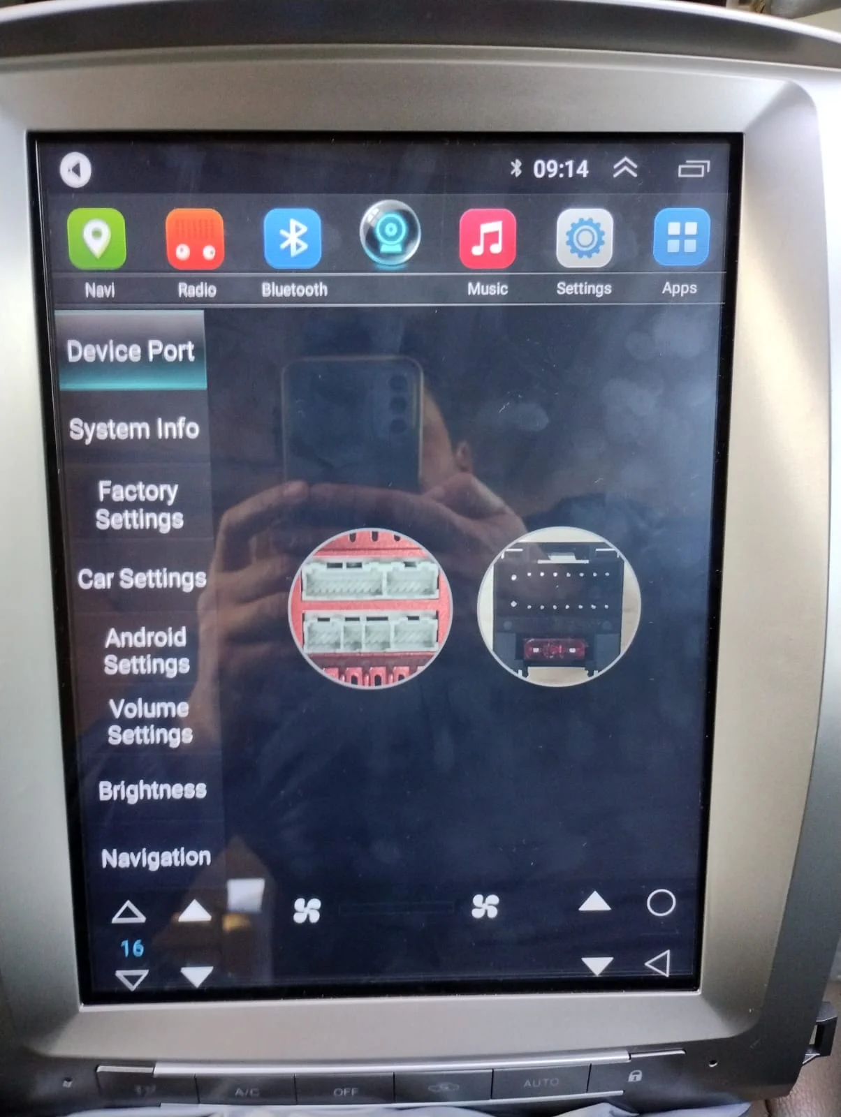

I did what Elle Ex told me in the settings and protocol and know I can see how the A/C was left before installing the tesla style screen but cannot control anything (attached are the images).

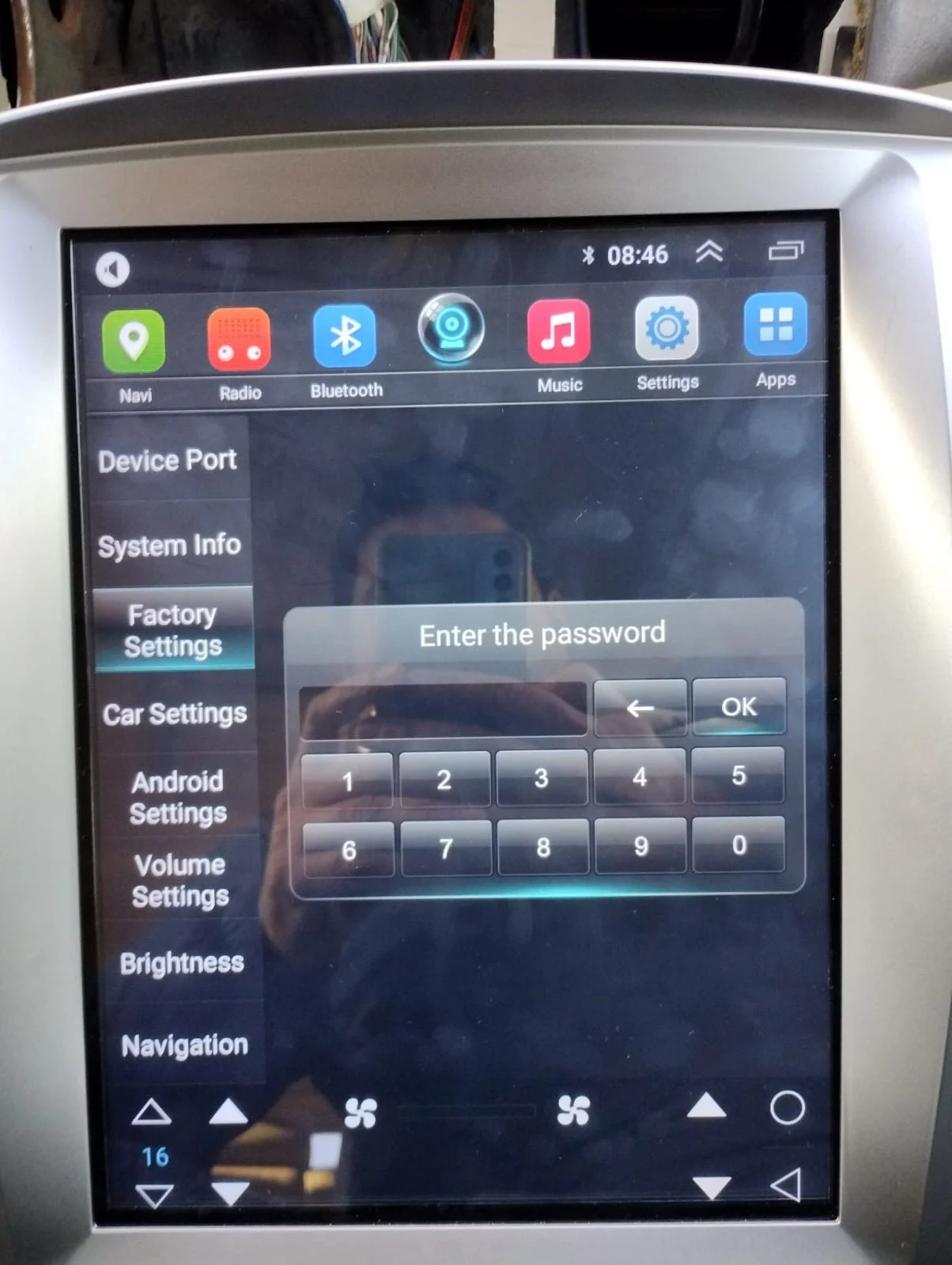

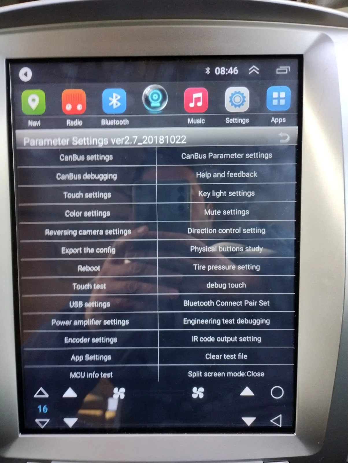

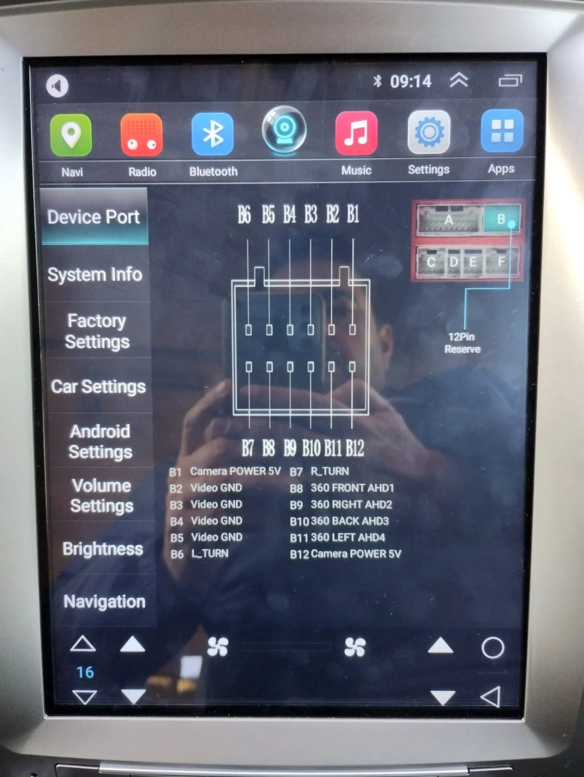

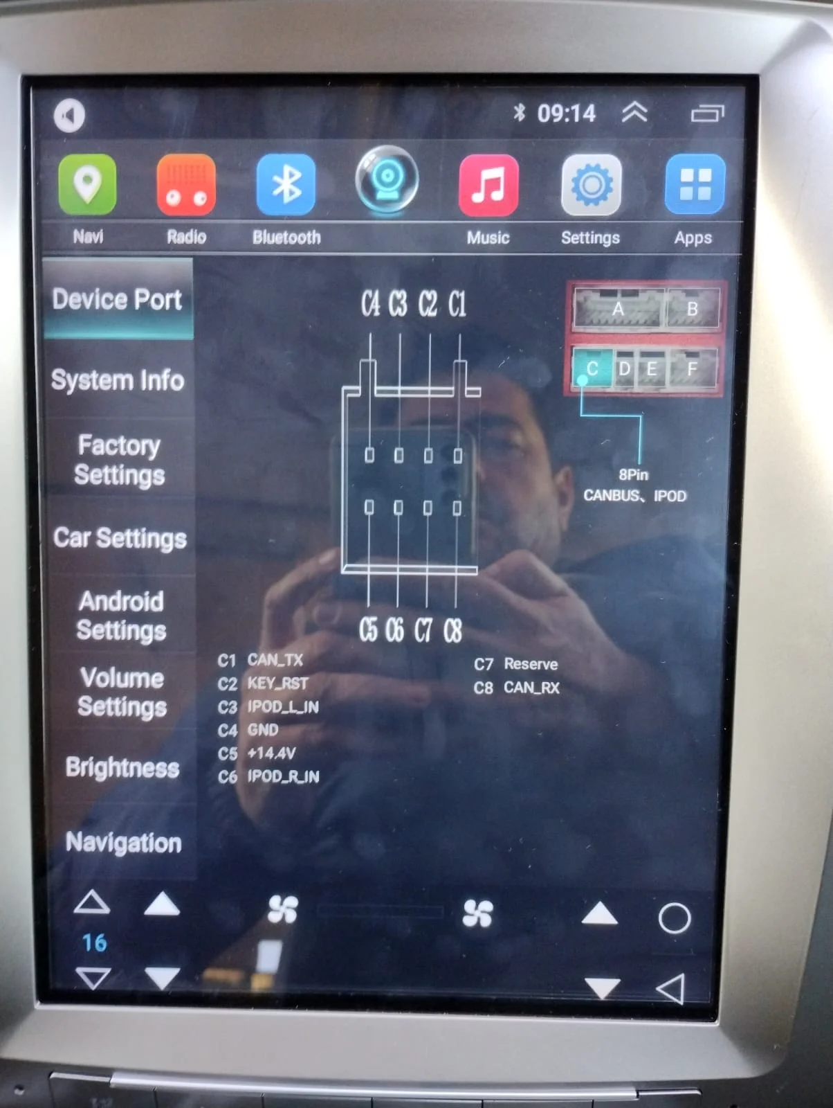

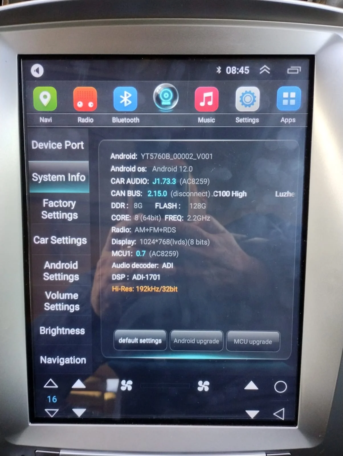

I have the same situation and I cannot find the setting that someone suggest modifying to BNR with AC, when I go into settigns, there are several settings folders: Android SEttings, Factory settings, auto settings, and I have reviewed all of them and I cannot find that parameter that I need to change
Hi, were you able tof ix your A/C issue?

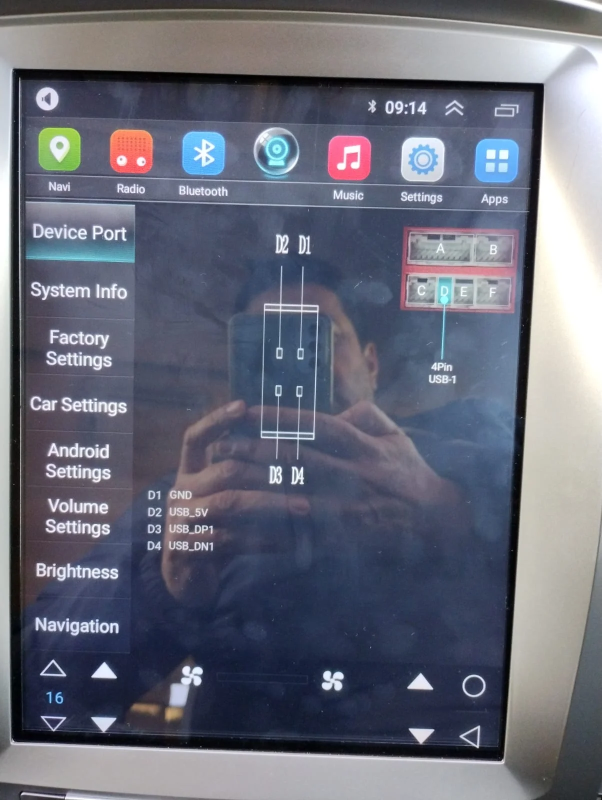

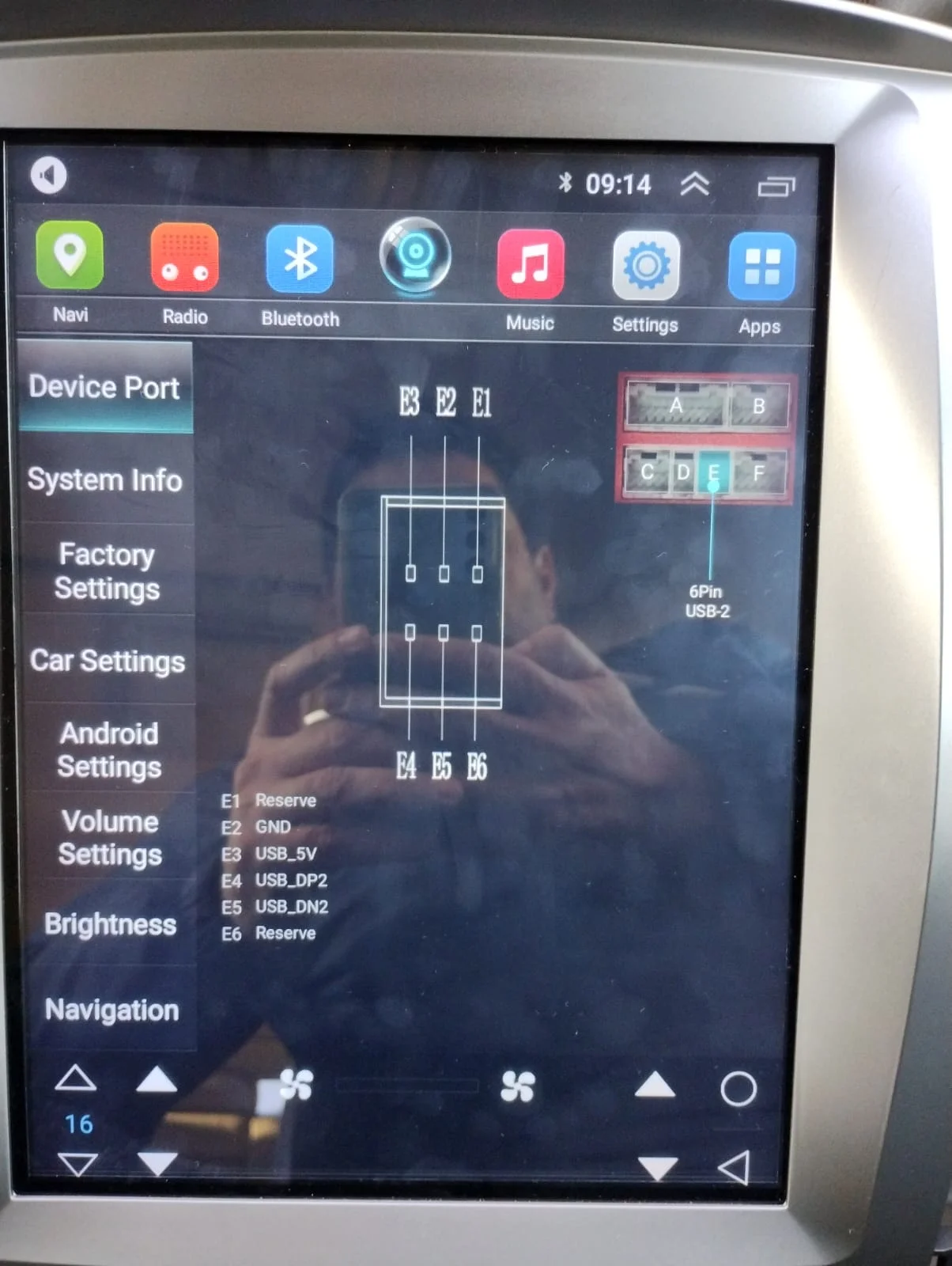

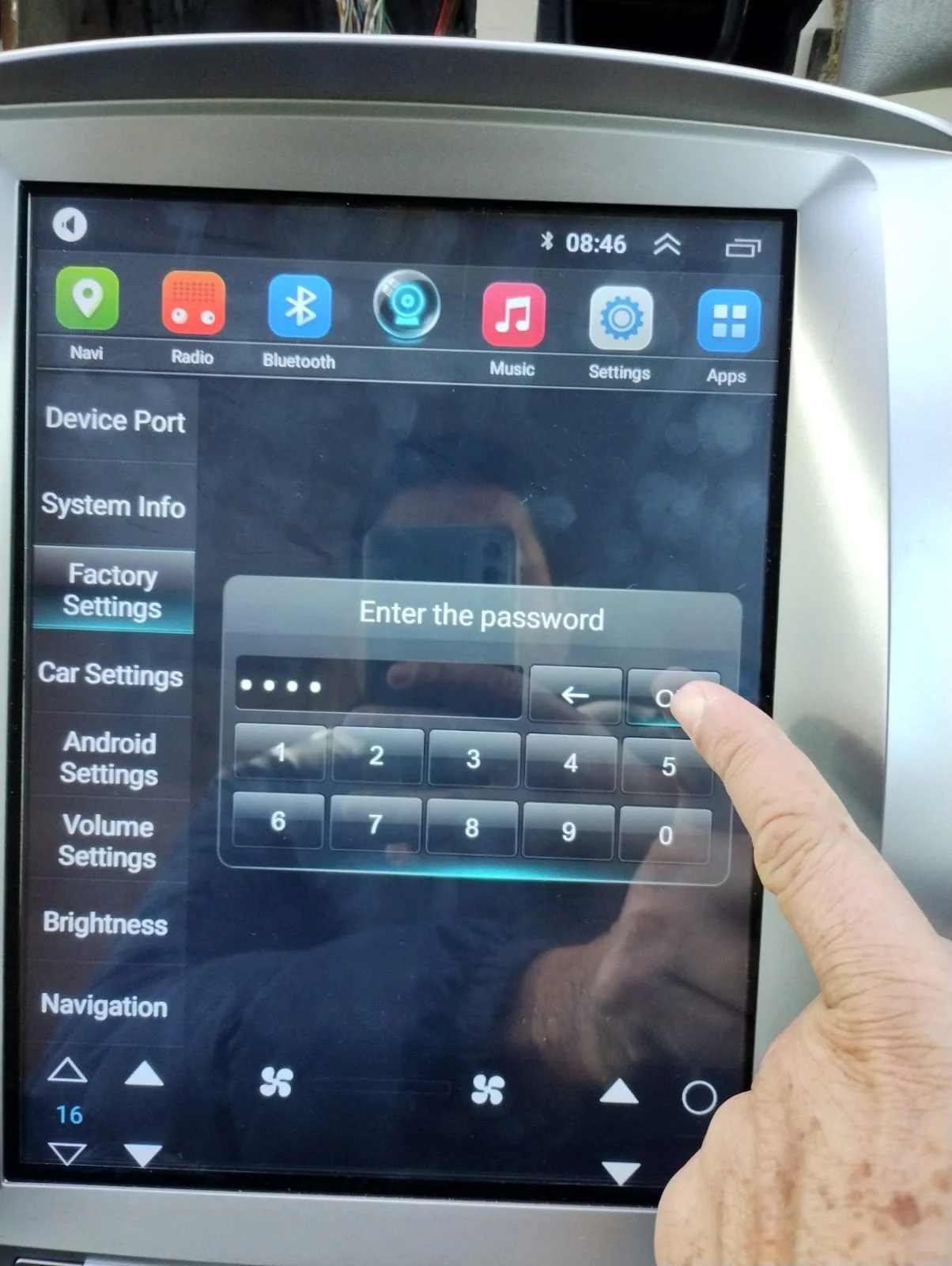

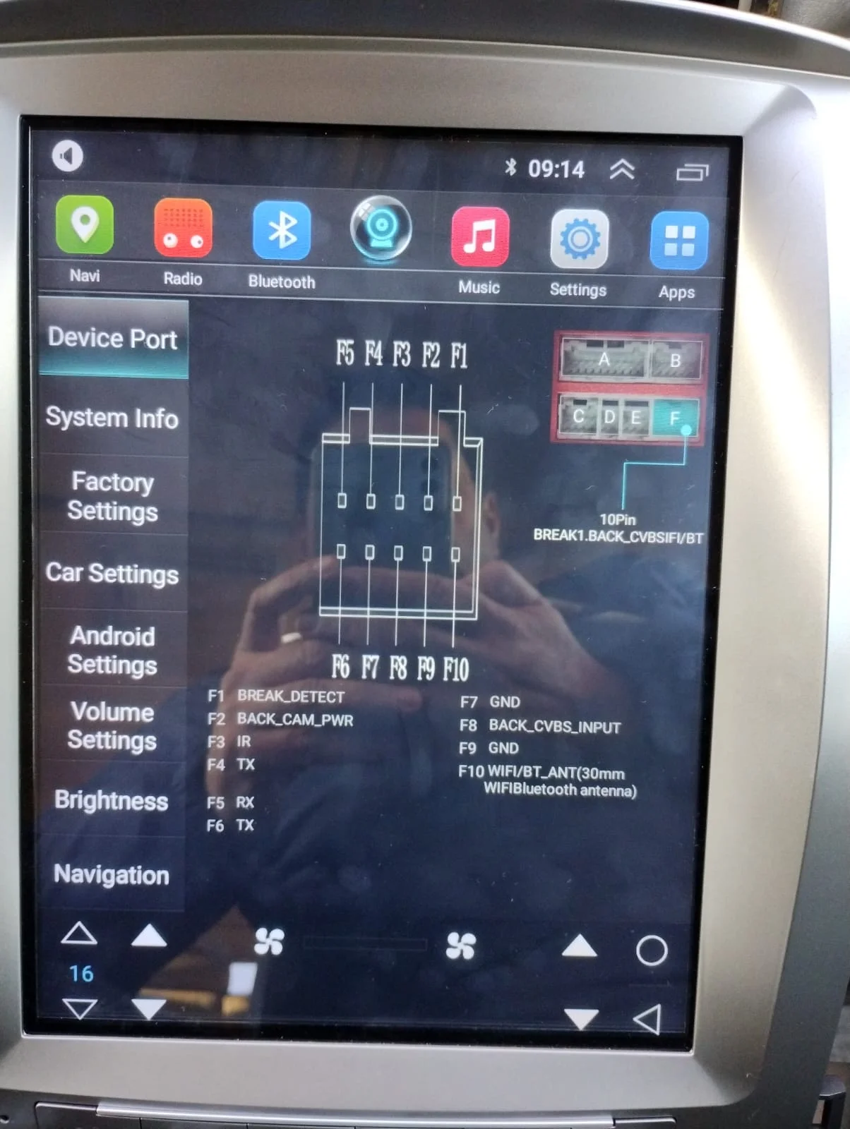

There should be one setting that's hidden behind a password
There is a password used to access "Factory settings" is 8888, accesignthat and reviewing all parameters I cannot find the one that I am looking for, let me get some pictures to share to see if someone recognizes those setting menus

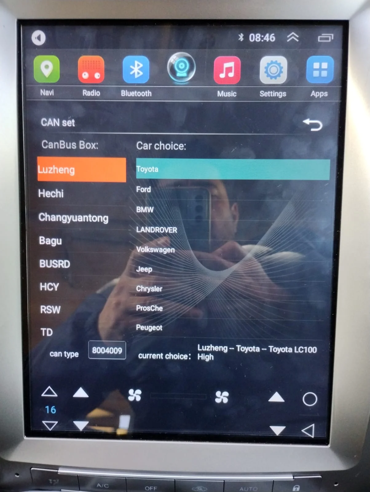

I resolved my non-working controls by setting protocol to “BNR with AC”. And tech set to “LC100 HI”
Hi,
Could you please let me know where do I need to change this:
I have not had any luck finding these parameters inm y settings

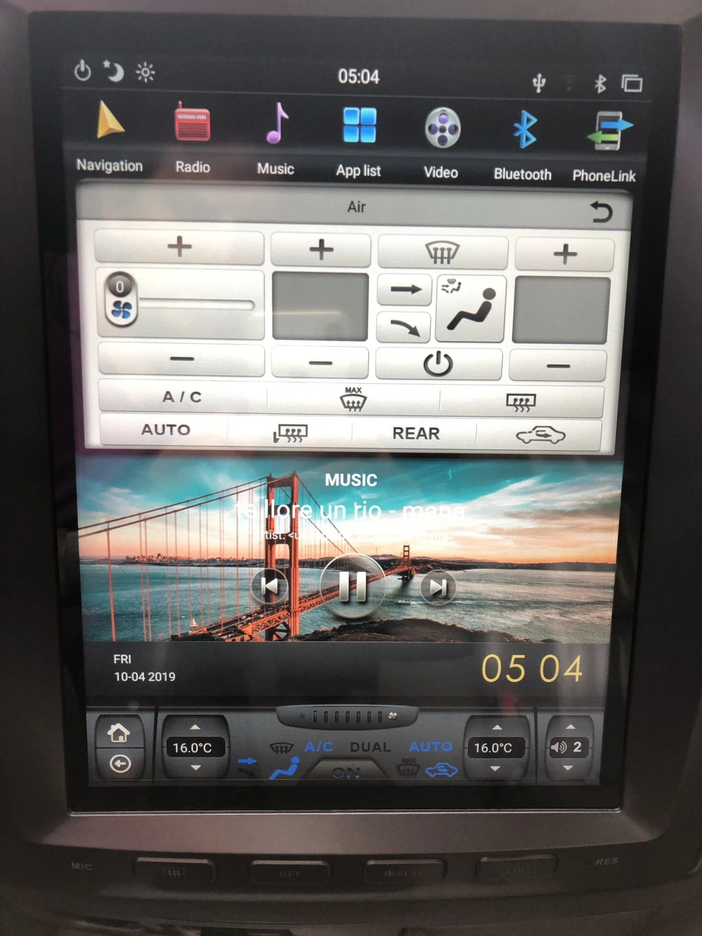

AFTER
2027406
The quad core units were the first batch to come out late last year. Part #s are ZF-1301S. These used Android 7.1 and (once the wiring issues were worked out) they worked pretty well. Overall the hardware and OS where described as a little clunky, but a definite improvement over the original touch screen radios and cassette decks.
The six core units (PX6) are the latest batch out as a release of this post and are pretty good. Part # for the LC version is ZF-1301X. These are not showing up on the ZhiFang website yet, but they have ZhiFang's name on them. They look to have the same cables as the original quad core units but have worked through most of the wiring issues. Interfaces are crisp and fast with the only general complaint is the amount of time it takes to start up once you turn your key on. This is typically around 20 seconds. AC controls work great and utilize existing Toyota circuit boards as part of your original radio.

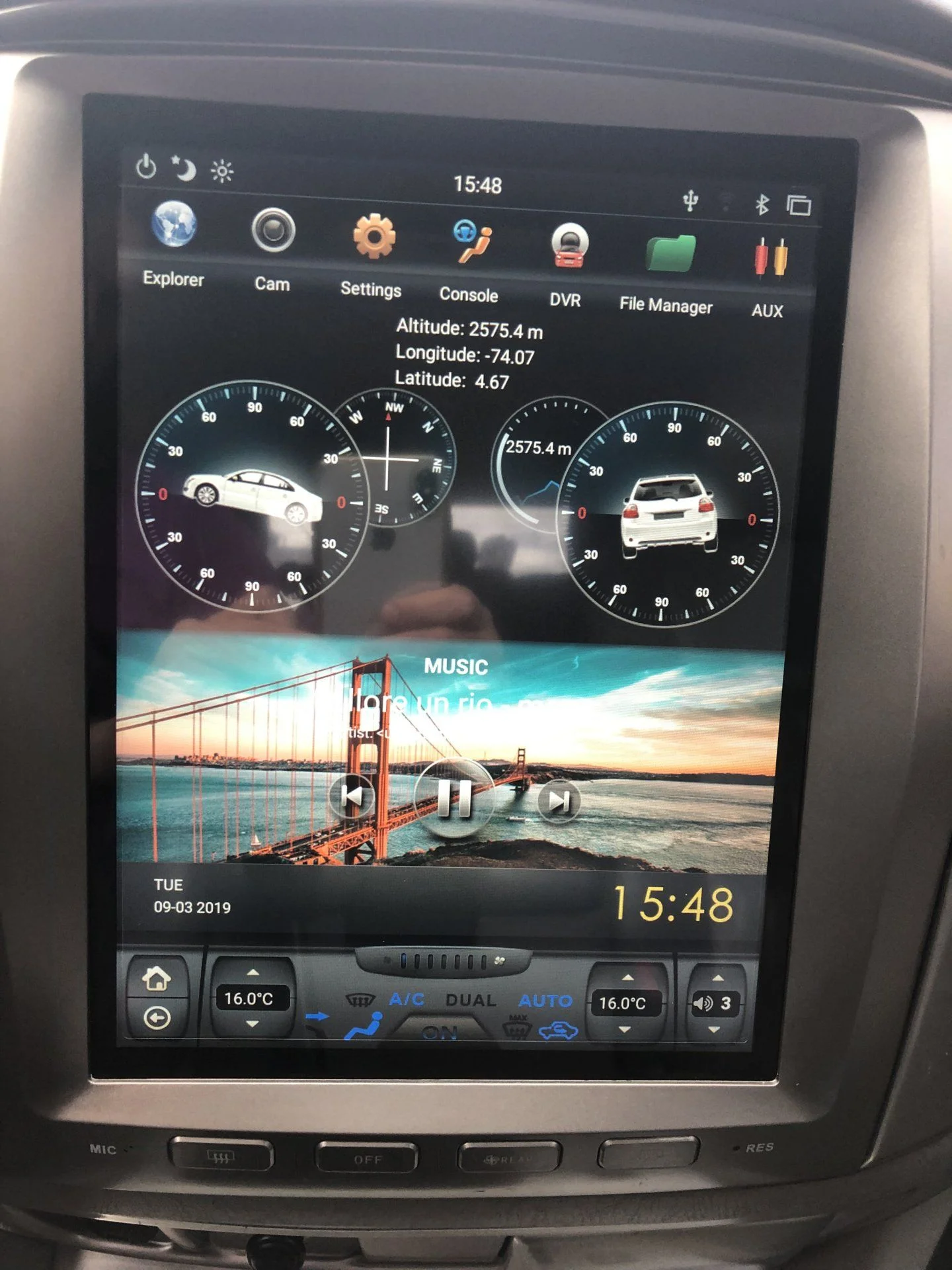

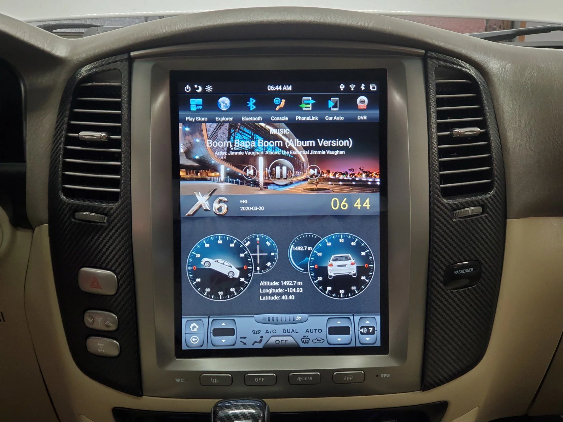

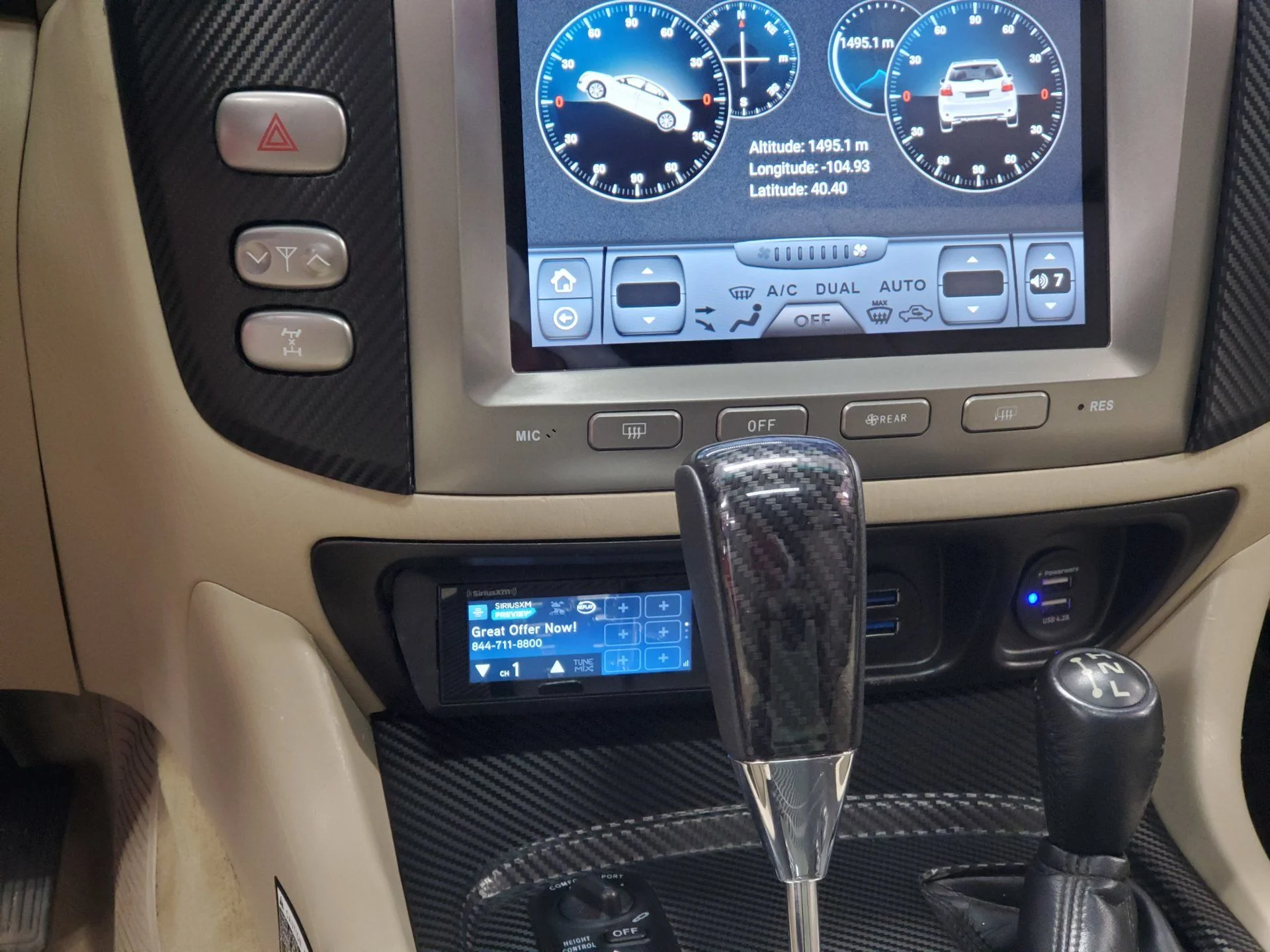

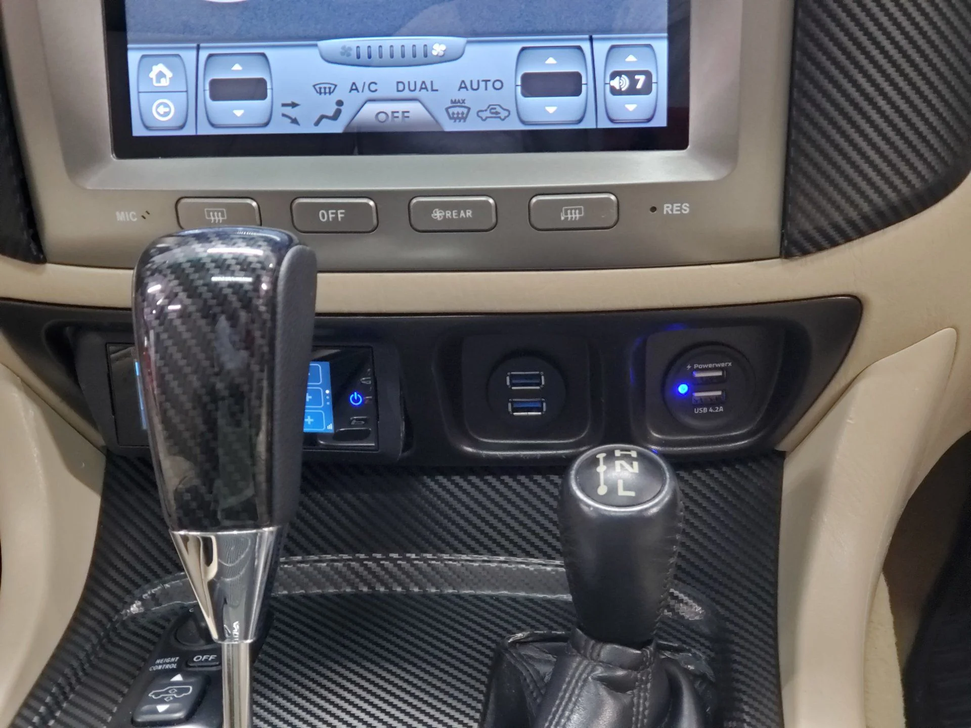

Here she is fully installed after 3+ days of fiddling with it (mainly Canbus settings). Overall, I’m pleased. It would look factory if the LEDs were green (project for another time). It’s not perfect, but I would say it is a plug-n-play solution for the 98-02 LX470 factory nav.
This looks perfect for us pre-03 nav guys
WTB did the harness need altering at all or was it genuinely plug and play? Does everything still work ok in the vehicle?
