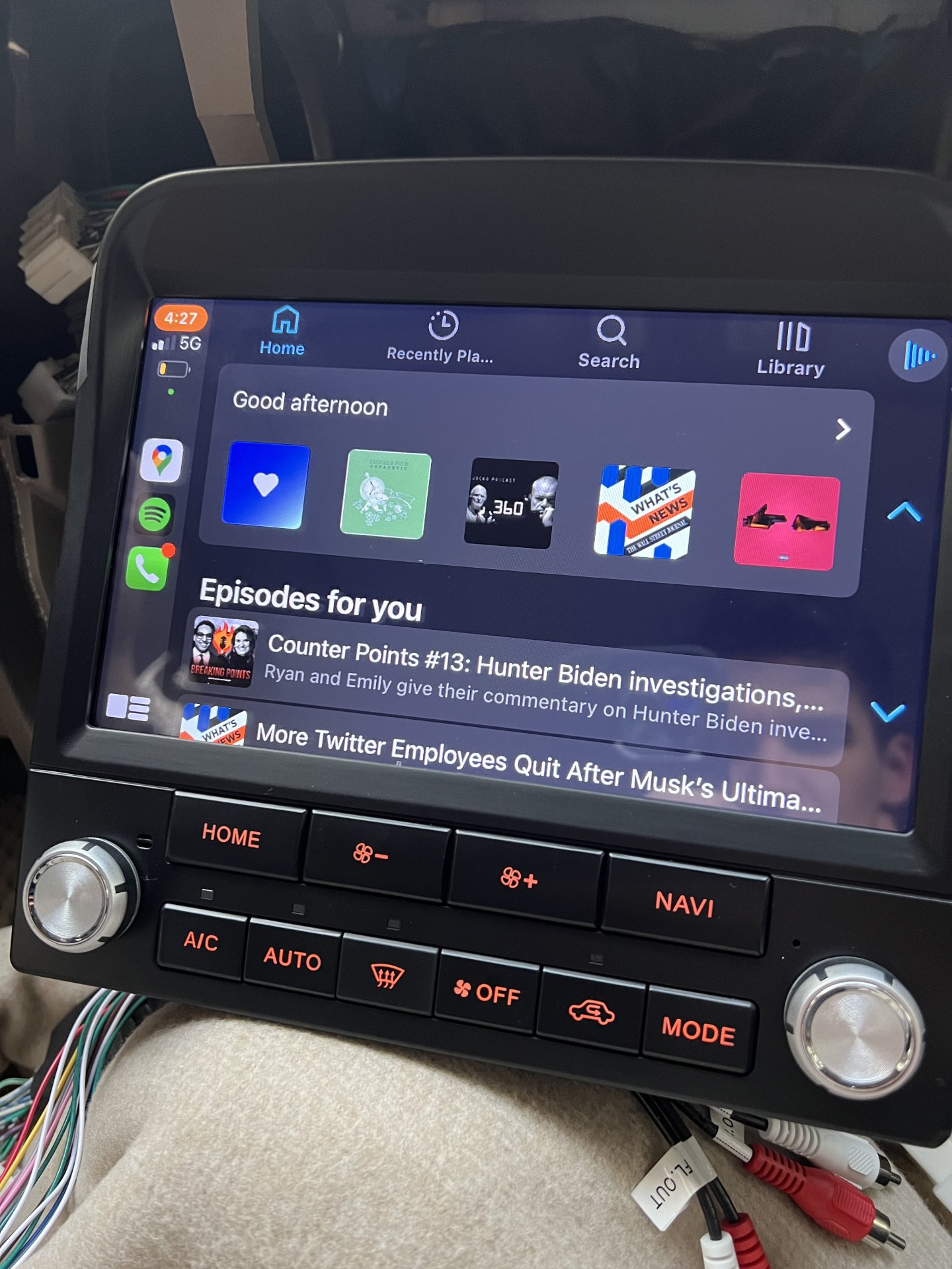

The alternate screen advertised for the pre-03 Nav has arrived! It arrived fully intact but with no directions as usual.
It looks great! The only drawback is that the silver knobs can’t be swapped out for black ones that match the stock aesthetic.
Hopefully I can make some time to install it and test it out this upcoming weekend.
This looks great - is it a plug and play for pre-03 nav (no wire cutting/splicing)? Mic built in or needs to be routed?
It is supposed to be plug and play, but I have yet to install to confirm. I will hopefully get around to it this weekend and report back.

Awesome, screen quality looks great. Any chance you have a photo of the backside of the unit handy?

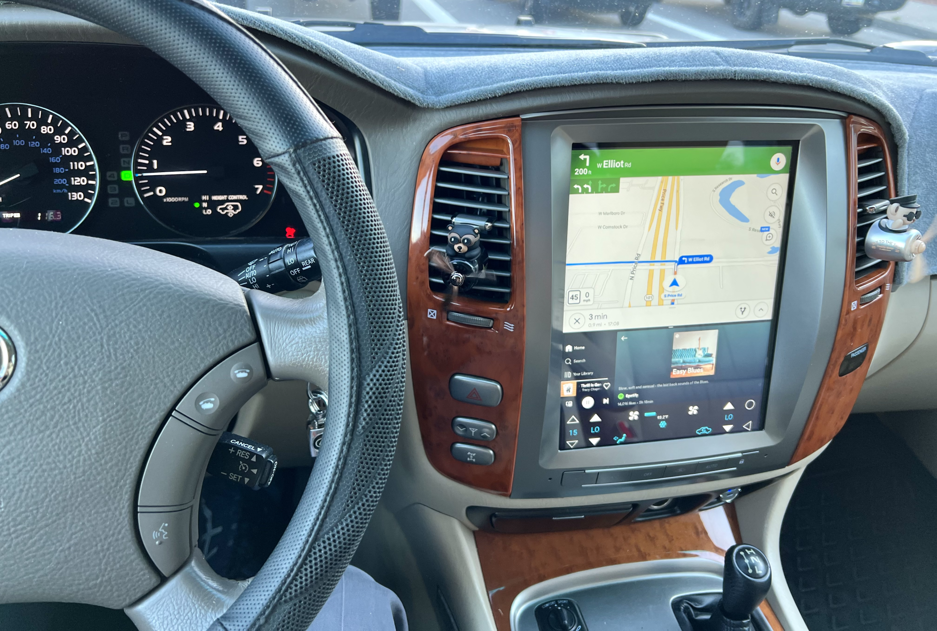

After 3 long months of waiting I finally have the 04 LC VX Limited from Japan and (after consulting my wife's co-worker who has done something similar in his JDM FHD Toyotas) I purchased an 8G/128 Android Tesla Style unit that is supposed to have the Canbus specific to RHD Landcruiser.
Been working at installing it over the last couple of days and have had moderate success. It powers up, can swipe the screens, open most things etc. The unit itself looks a little than others I have seen on this site and on YouTube and not sure if it is because it is a new model, seemingly built in September, but the back of the unit is a little more streamlined and there is nowhere to bolt the brackets on. The climate control ecu has to be bolted into the factory brackets and I have done that and it seems to fit. The clips on the unit line up with the holes in the dash and must just snap back so not too concerned about that yet.
I seem to be running into similar problems as others have had:
1) no sound from unit at all. Bluetooth and Wi-Fi connect. Phone can show and play podcasts/music through the usb but zero sound. I have unplugged the various RCA cables in each potential configuration to no success. Not sure if this is something related to the amp? Have others just bypassed the amp from the unit to the speakers?
2) the climate control hard buttons with bring up the AC and modes and the touch screen will kinda work as well but no fan or heat/cooling actually occurs.
3) backup Camera does not work, which I expected so I have an aftermarket one that I will try to install after I can get everything else figured out.
4) Cannot select the Landcruiser Icon from the unit and I was sent a zip file to install and all it seems to be is a bunch of photos/logos of vehicles so I don't know if that is really an issue (as in, is there anything coded into the vehicle photo that may affect settings or is it just a photo?) I will clarify that with the vendor.
I have been in touch with the vendor via WhatsApp and have been sent a couple of videos for the wiring, but it is in Chinese and don't understand what is being said. Plus, the video looks to be a guy recording with his cell, trying to navigate the wiring and talking to someone about what goes where so the quality is less than stellar, and he is moving the phone all over. I think I have all the wiring plugged in properly, as the connectors only have so many spots that will fit and there are a couple of leftovers, but they wouldn't fit any anyway.

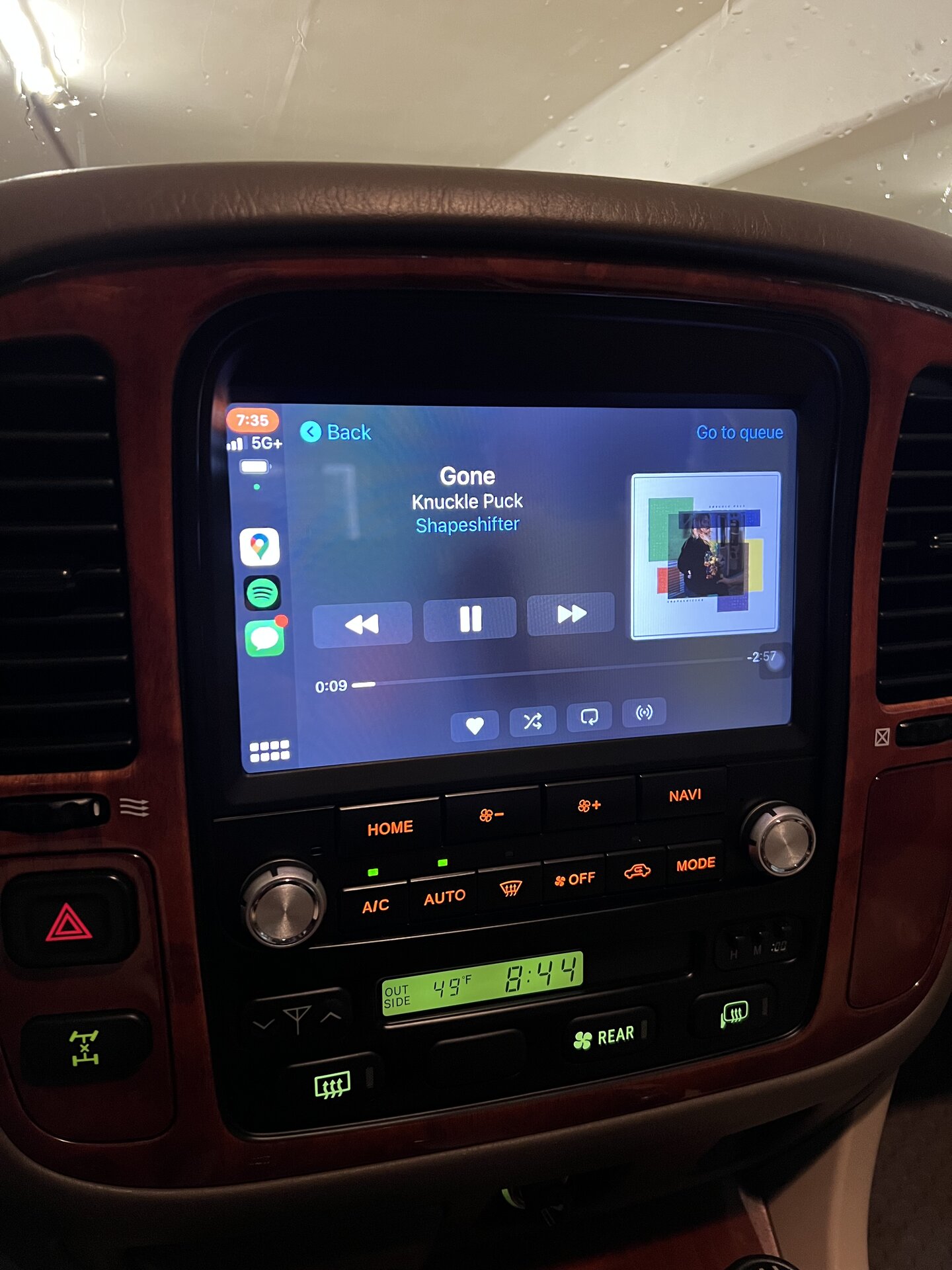

Here she is fully installed after 3+ days of fiddling with it (mainly Canbus settings). Overall, I’m pleased. It would look factory if the LEDs were green (project for another time). It’s not perfect, but I would say it is a plug-n-play solution for the 98-02 LX470 factory nav.
Looks great! Hope you enjoy it. By chance did they send you any documentation on the canbus settings you had to change? Also, is the rest of your stereo factory? As in, ML amp and speakers?
They did not send any documentation. I am still working with them over WhatsApp to get the Home and Nav buttons to work. I will post the correct settings once I figure them out. The PO replaced the factory ML speakers but left the amp, which is now clipping because of the higher resistance aftermarket speakers. I will be replacing the AMP with a JL Audio 8 Channel that will hopefully fit under the passenger seat.
