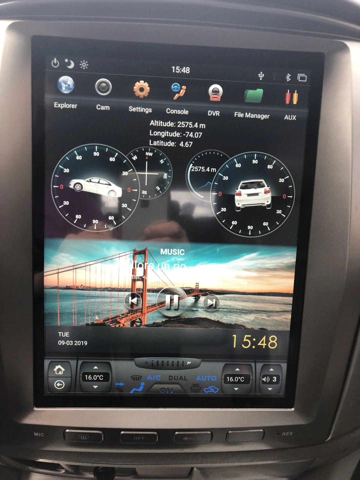

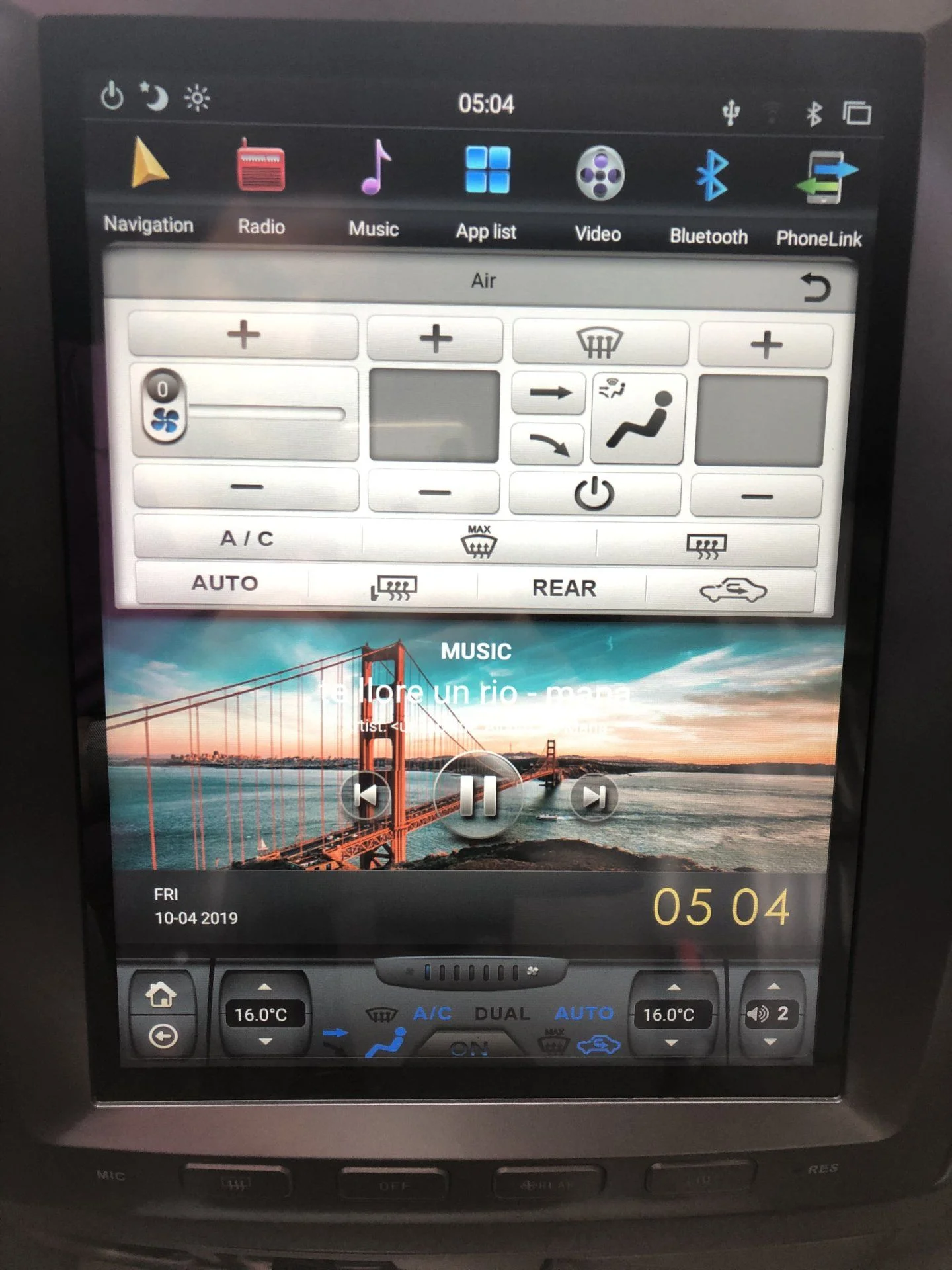

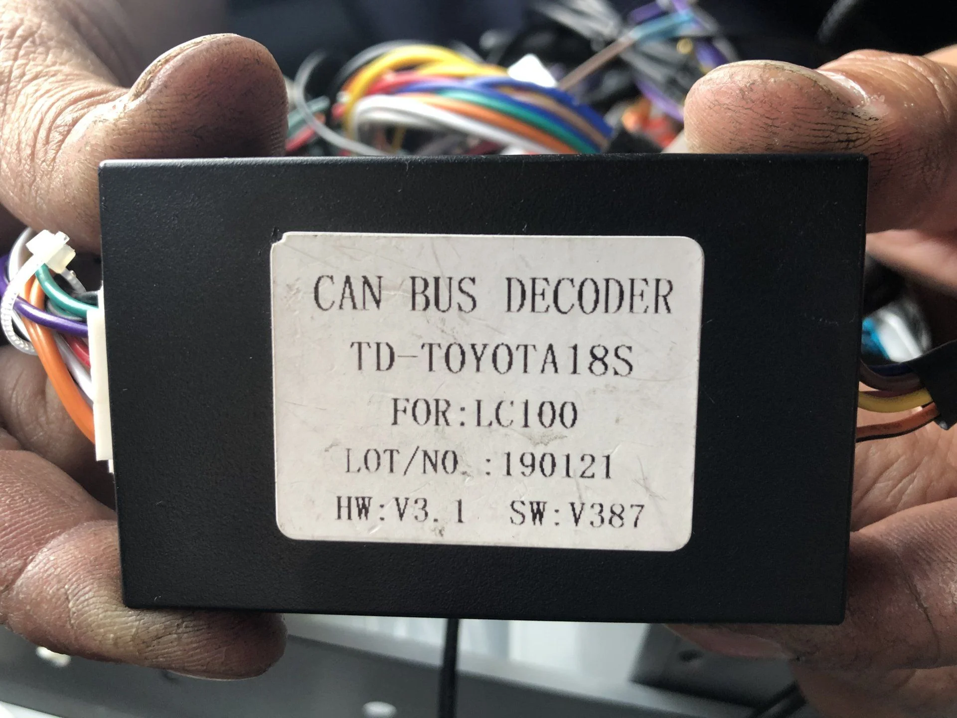

I am trying to install the screen in a 2006 Land Cruiser but after installing everything and connecting all, I have sound and everything but the A/C controls don’t seem to work. Can anyone please help me with this situation?
Attached are the pictures of the installation, the canbus, the screen reference and how the A/C controls look.
Thank You for your help!

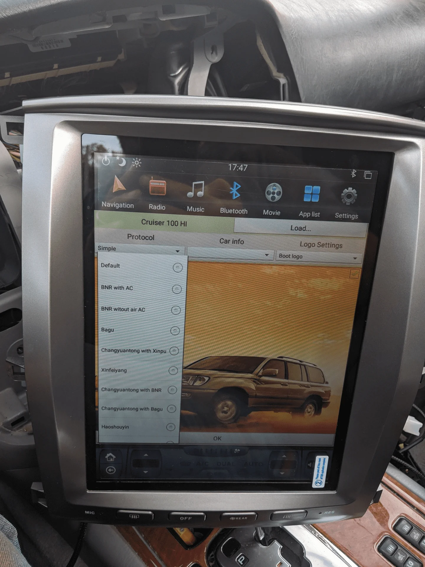

Have you gone into the settings to check the car type? @21jacob21 had a similar issue with the install in his 2004 LC and ended up fixing the problem by going into the settings and choosing the "BNR with A/C" protocol after @Wetwillie suggested it.
Thanks @Elle Ex for the information! Can you or @21jacob21 or @Wetwillie tell me where can I change the car type and the protocol? I don’t seem to find the settings to change them.
Thank You!
Thank You!
Look for an option in the Settings menu that is protected by a PIN (I don't recall what the label says and it's too late to go outside to check right now). Try using 8861, and if that doesn't work, 8879. You should be able to find the settings you're looking for in there.

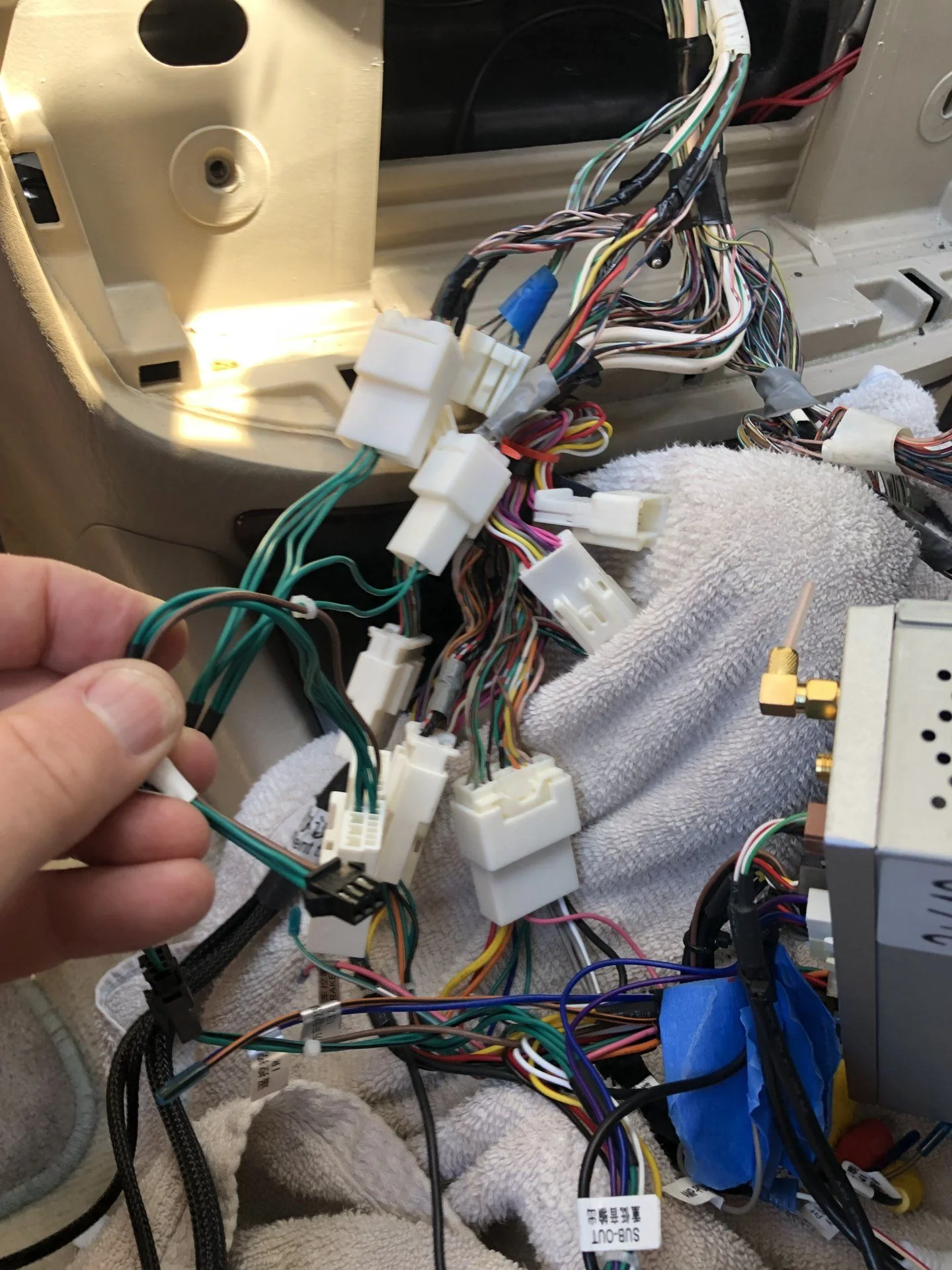

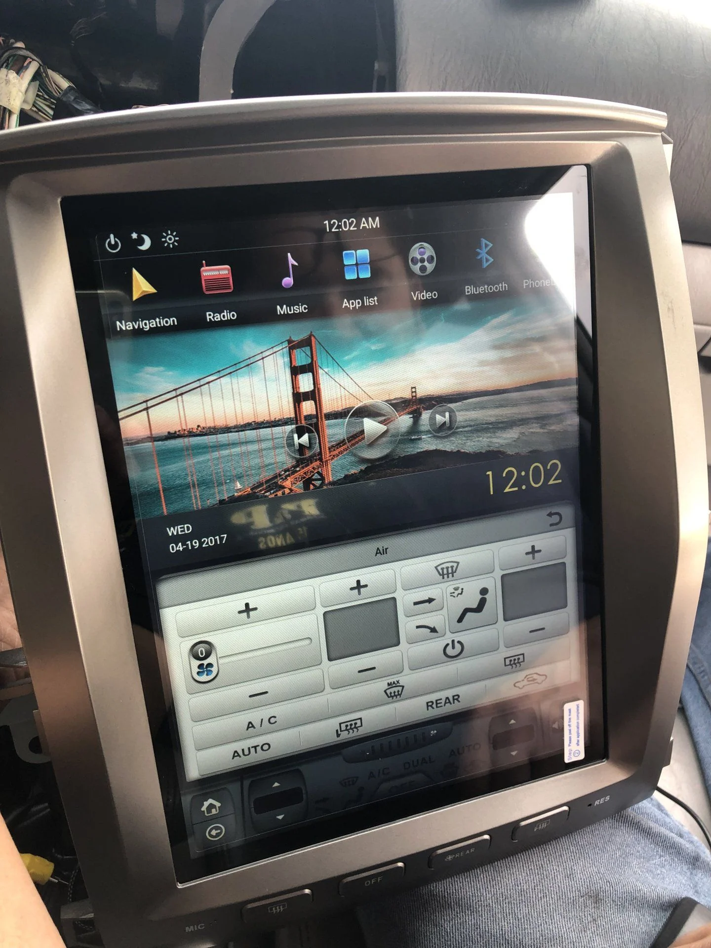

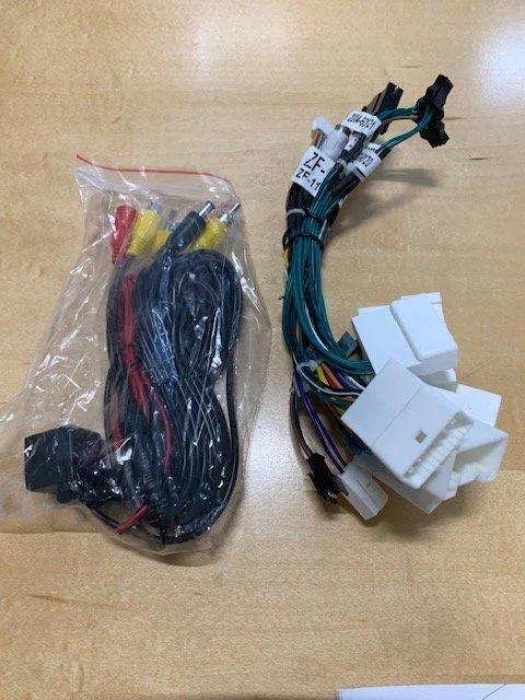

The green harness in this pic is what fixed the CC for me. The vendor gave me the wrong cable originally and sent me the green harness which fixed my issue.
Hello Elle Ex and Wetwillie,
I did what Elle Ex told me in the settings and protocol and know I can see how the A/C was left before installing the tesla style screen but cannot control anything (attached are the images).
Wetwillie you think what I need is the green premium harness? Does it have to be sent from China or is there someone in the USA who has it?
Thank You Ellie Ex and Wetwillie for your help!
