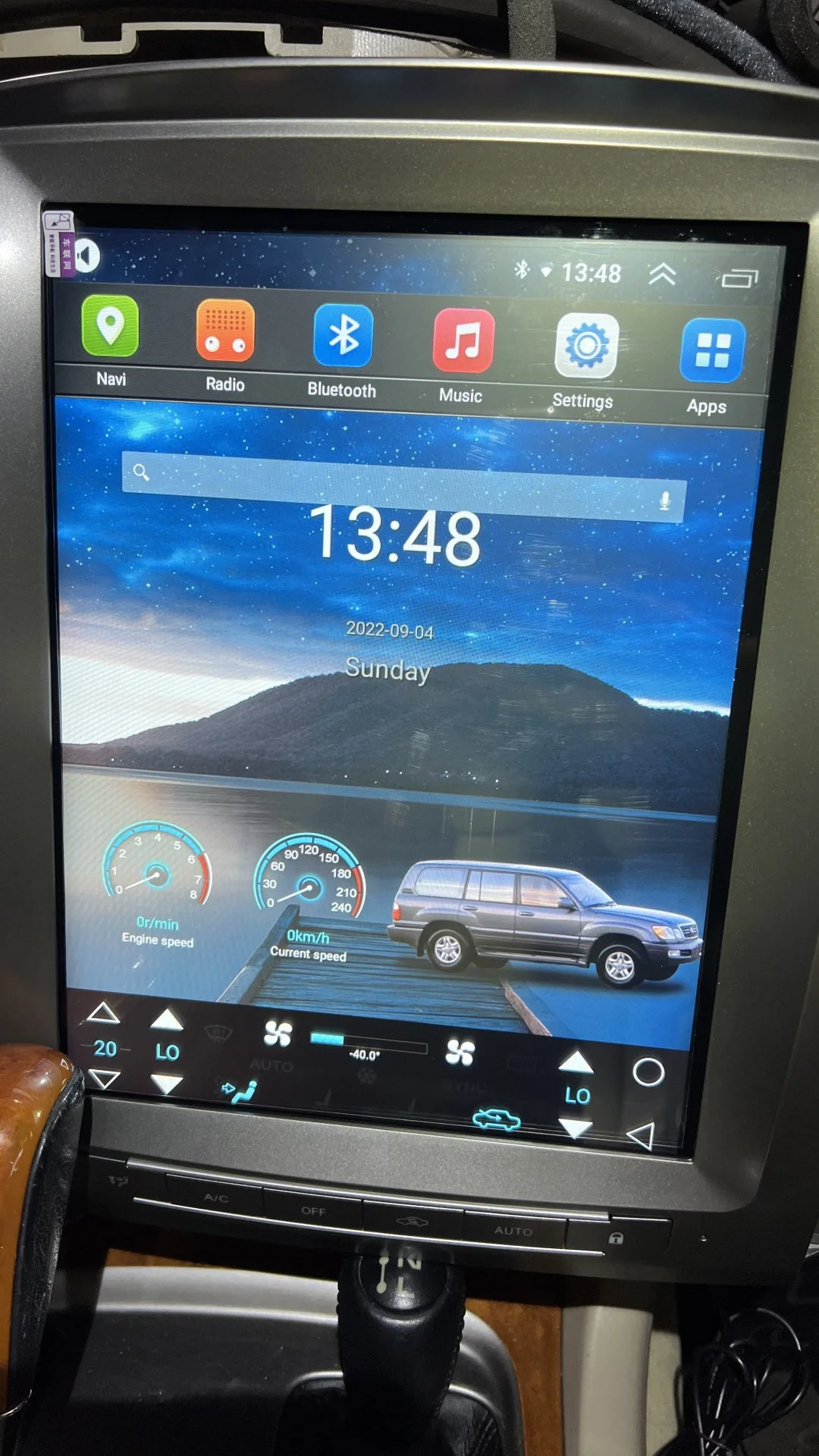

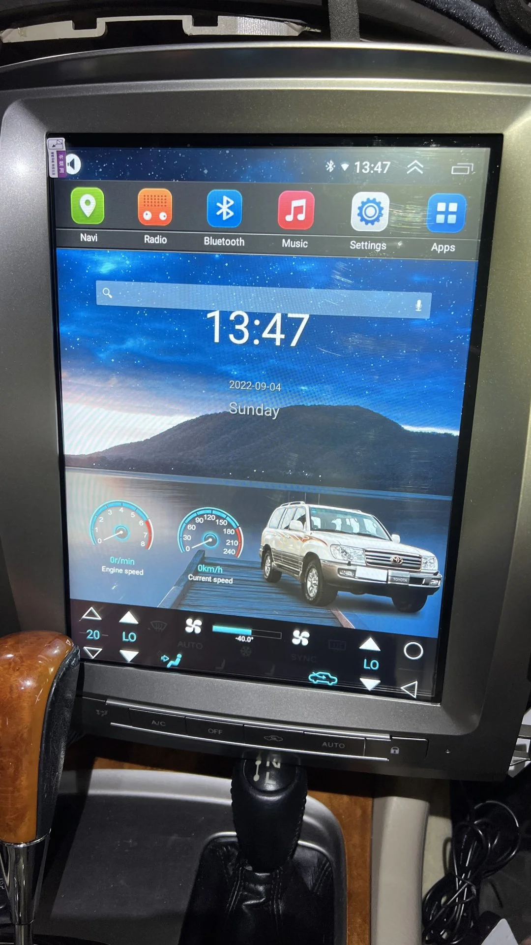

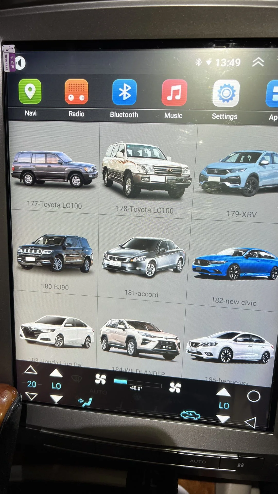

Hello, has anyone been able to get an Android 11 head unit with AC controls working on an LX470 or LC100? I can’t get the AC working on my 2007 LX470. There are two LC100s on the car selection list, but neither allows the AC to be functional. Seems the “high AC” wiring bundle instead of the “Low Medium AC” wiring bundle has to be used to be able to connect to the factory vertical plug on the side. Wiring and UI both look very different than the PX6 Android 9 unit videos I’ve seen. Any help will be greatly appreciated.
I have a px6 unit and no experiance with the Android 11 unit so I just taking a shot in the dark. I think your CAN BUS setting needs to be changed. Does the CAN BUS setting change when you select between the 2 car images?
No the canbus setting/info does not change when selecting between the two cars. There doesn’t seem to be a way to “change” the canbus setting. It’s just an info display?
