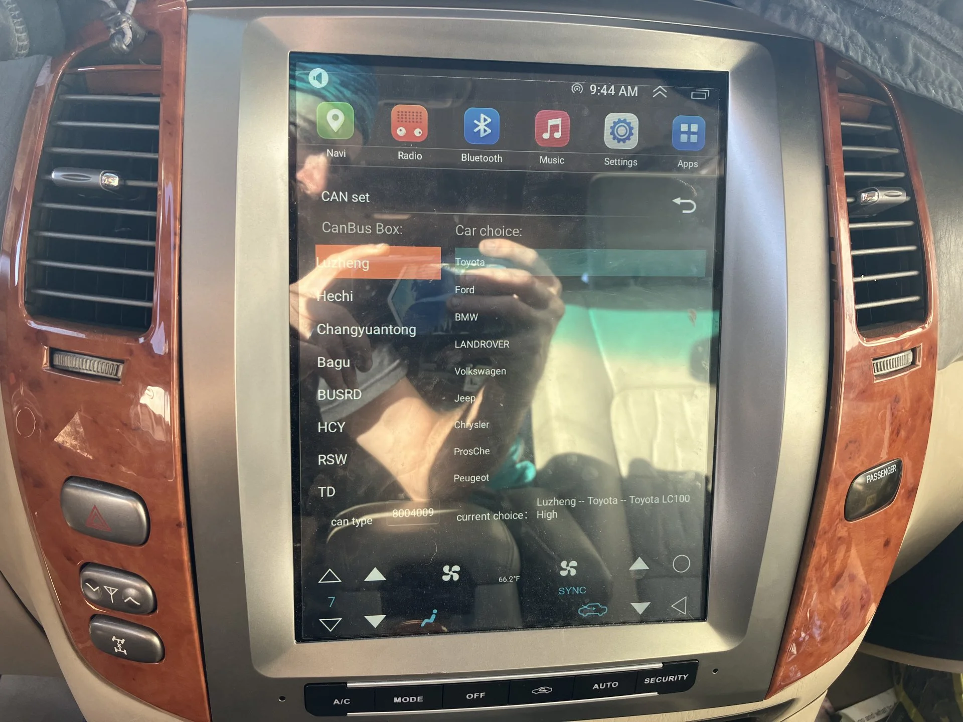

Let us know how your Android 11 install goes when you get it. I still can’t get the AC on mine working. Password is 8888 to get into Factory Settings in Settings to select car for canbus.

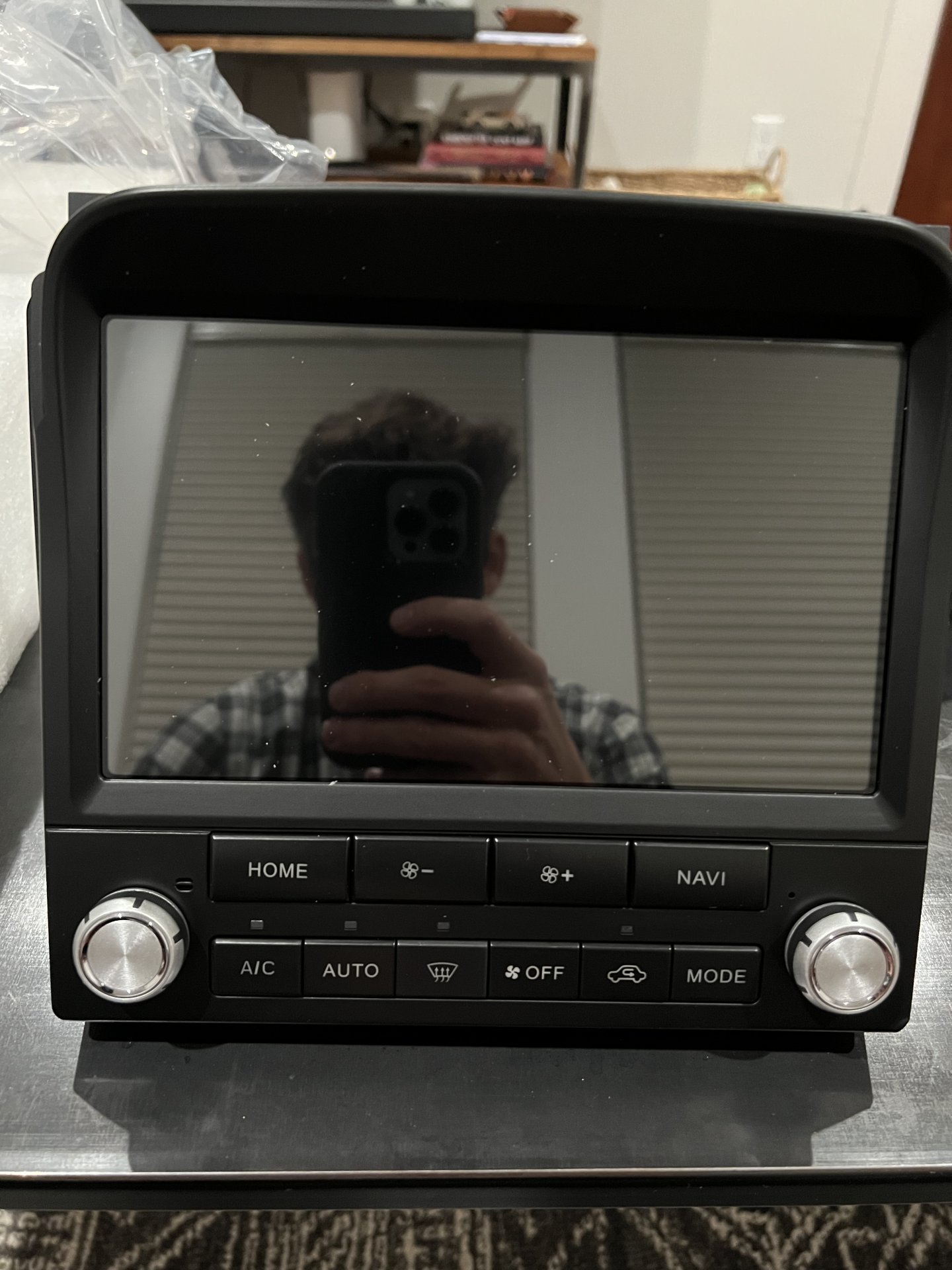

The alternate screen advertised for the pre-03 Nav has arrived! It arrived fully intact but with no directions as usual.
It looks great! The only drawback is that the silver knobs can’t be swapped out for black ones that match the stock aesthetic.

That looks fantastic! Can't wait to see what the software looks like

Is the volume button on the left side?

My seller worked with me via video chat and concluded that there was something wrong with the Canbus that came with the Android 11 unit. So they sent another one with all the wiring harnesses again. I was able to get this one working right away - AC and all. I have to sort out the radio - it worked fine before crammed everything back in, but on first drive, I couldn't find stations and signals were very weak. I wonder whether the antenna wire came unplugged as I was struggling to put it all back in. The only other issue is the passenger side airbag warning light. I only have it lit up on the dash but not on the button on the right panel. I know someone had provided a fix (two additional wires) on one of the previous pages, but honestly I didn't quite understand what he meant. Are we talking about the AC Hi harness, which has a plug into the main AC control and two little plugs for the modules on the side panels? use two additional wires to connect two pins (2 and 3) from the passenger side little plug on the Tesla harness to 2 of the pins on the main AC Hi plug on the Tesla harness?
