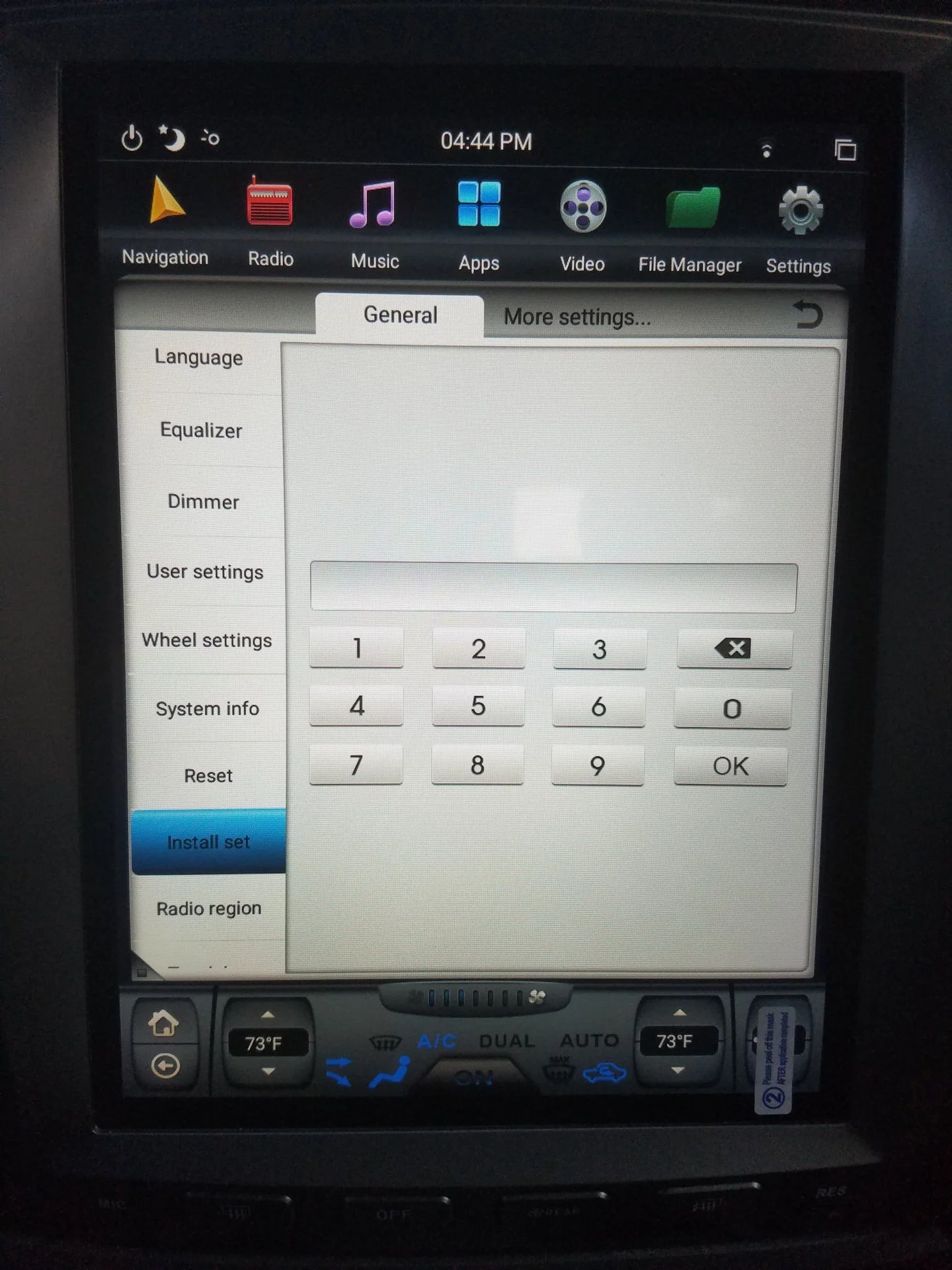

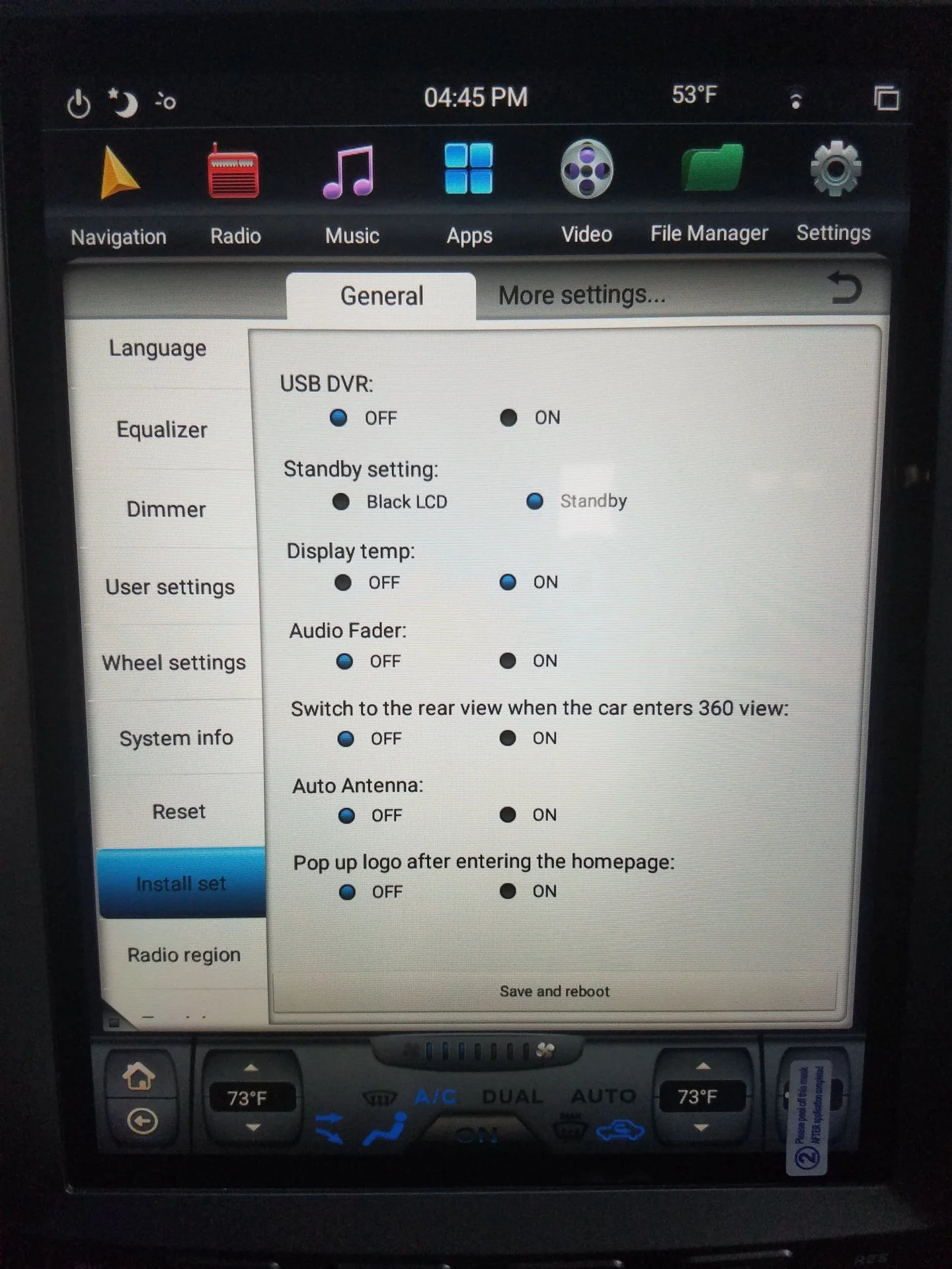

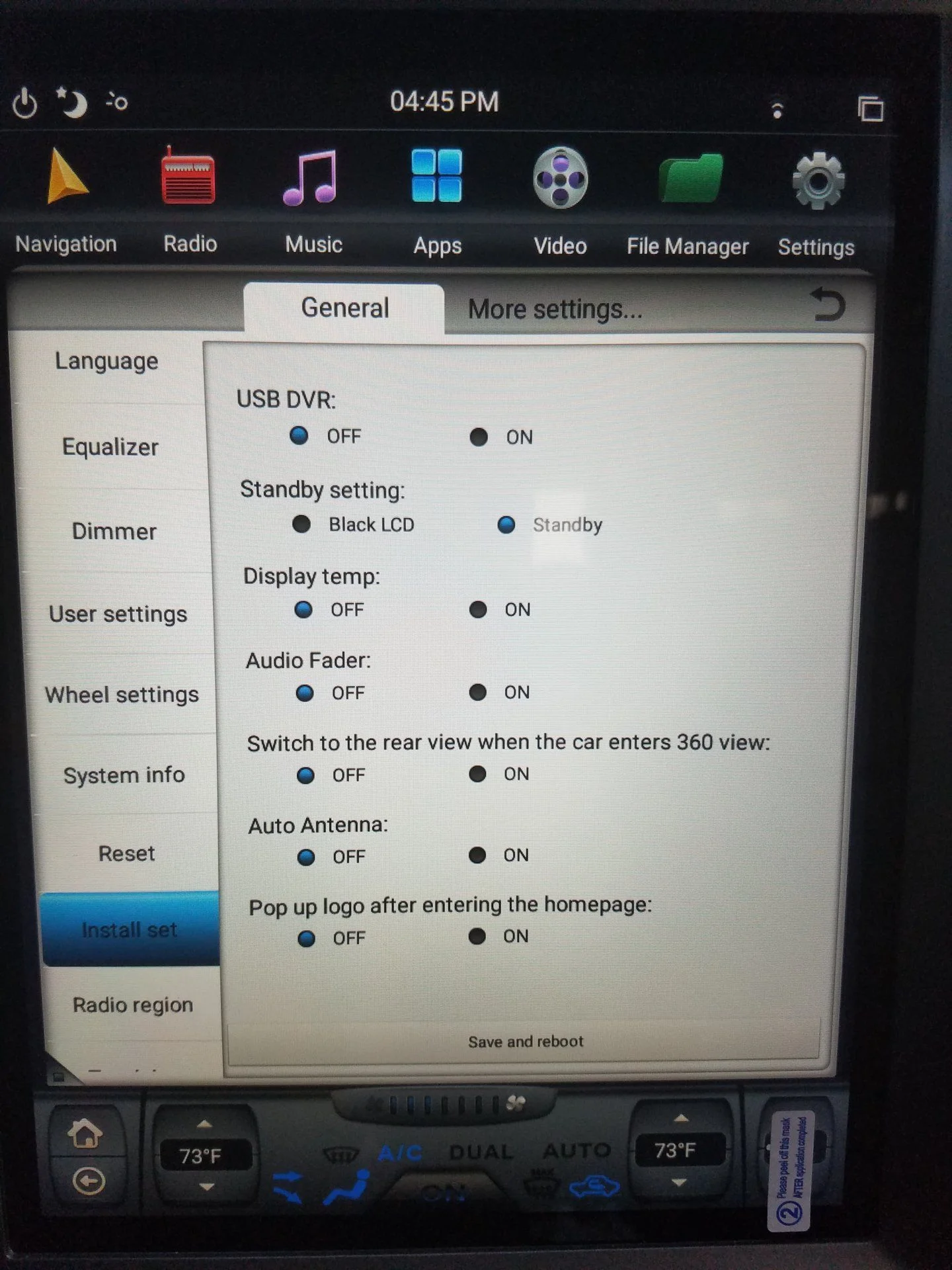

To show the Temperature go to Install Set. Use 8861 to access the General settings. Scroll down and turn ON the Display Temp.
Save and Reboot. If you don't do that it will go away next time you turn it back on.
