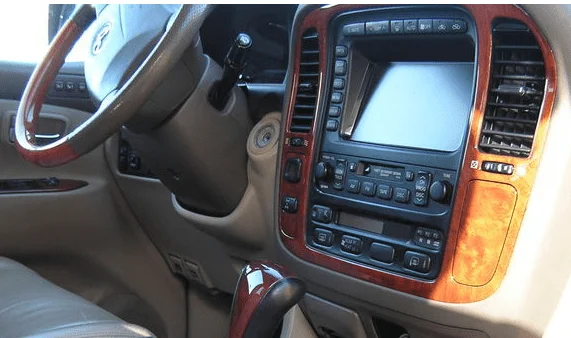

Amazing thread regarding the tesla style unit, thanks for a lot of good insight. I have gone through this thread and some others but couldn't really get a clear understanding if someone has tried to install this on the older than 2003 models?
I'm new to this forum and i own a Land Cruiser 100 2001 (50th anniversary edition). I'm once in a while hearing an extremely annoying buzzing sound that seems to be coming from the stock nav unit, and i'm wondering if i should go for a tesla style upgrade at some point as i believe it might be even cheaper than trying to find a new / used stock unit.
I found a pic from google on how my dash looks like.

Looks like your model is not compatible.
I have a 2002 Lexus LX 470. The system looks exactly like @Finnish dude picture above. I was told by Rhino that they couldn't supply a compatible system. I was told by Phoenix that they could. I sent both of them pictures. So @rrc swb link above concerns me a little. Neither vendor gave me any technical details. I would have liked to talk to someone technical but that didn't happen. Phoenix seemed considerably more expensive and they would not price match Rhino. I never ended up ordering anything and am still evaluating. I really hope I find a solution though.

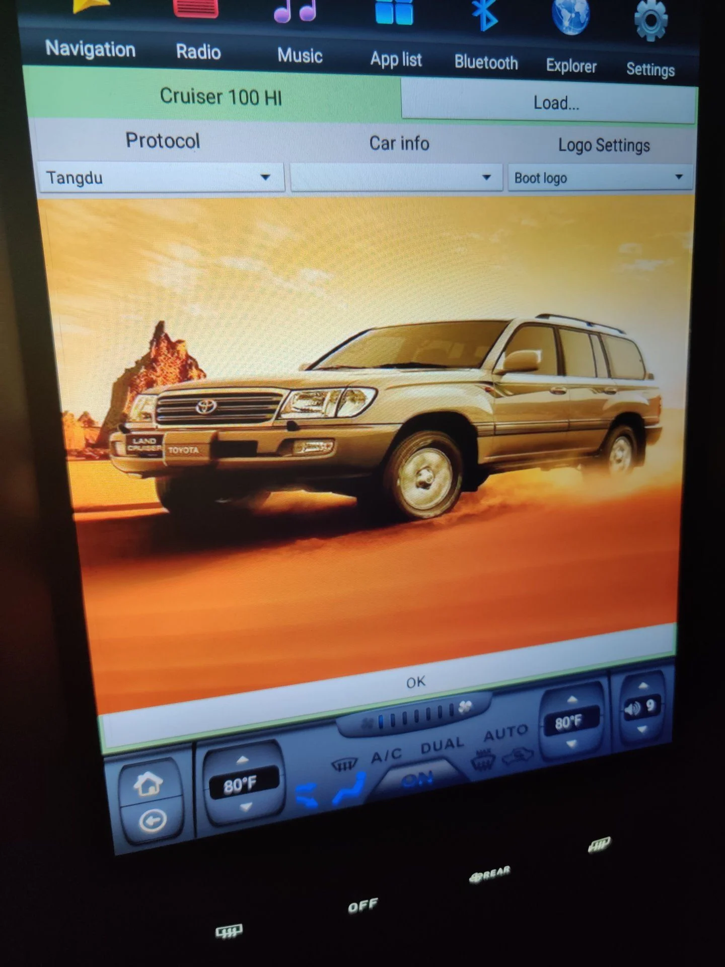

Thanks, this fixed my issue where i had AC working then messed with the settings trying to change boot logo and then lost ac functionality. Switching back to this corrected.
For an 05' lx470 with auto AC
car type = cruiser 100 hi
protocol = tangdu
