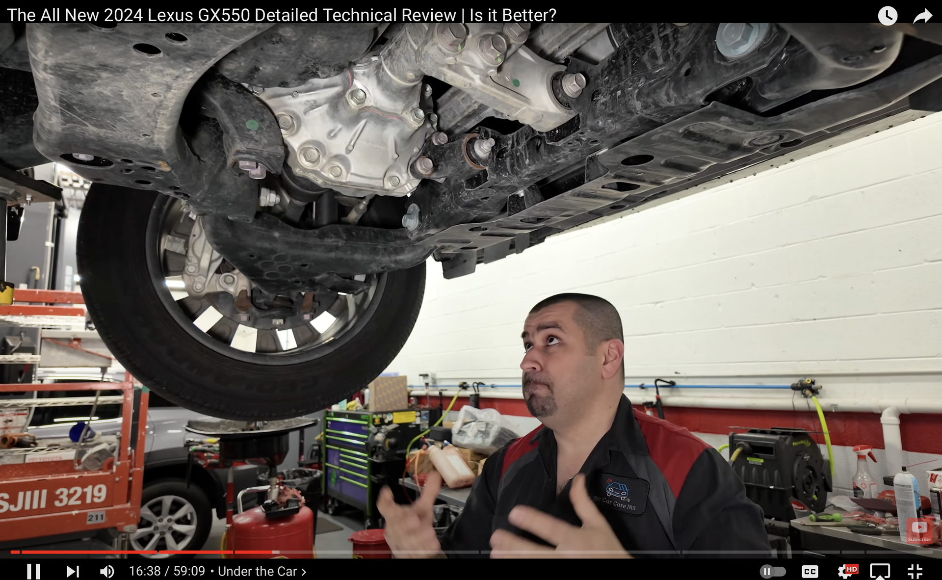

Undercarriage pics (with and without front skid plates) that show the front diff setup and pictures of OEM skid plate options (fronts and gas tank).
Full disclosure, pulling skids won’t be happening at this event. I'll have future opportunities.

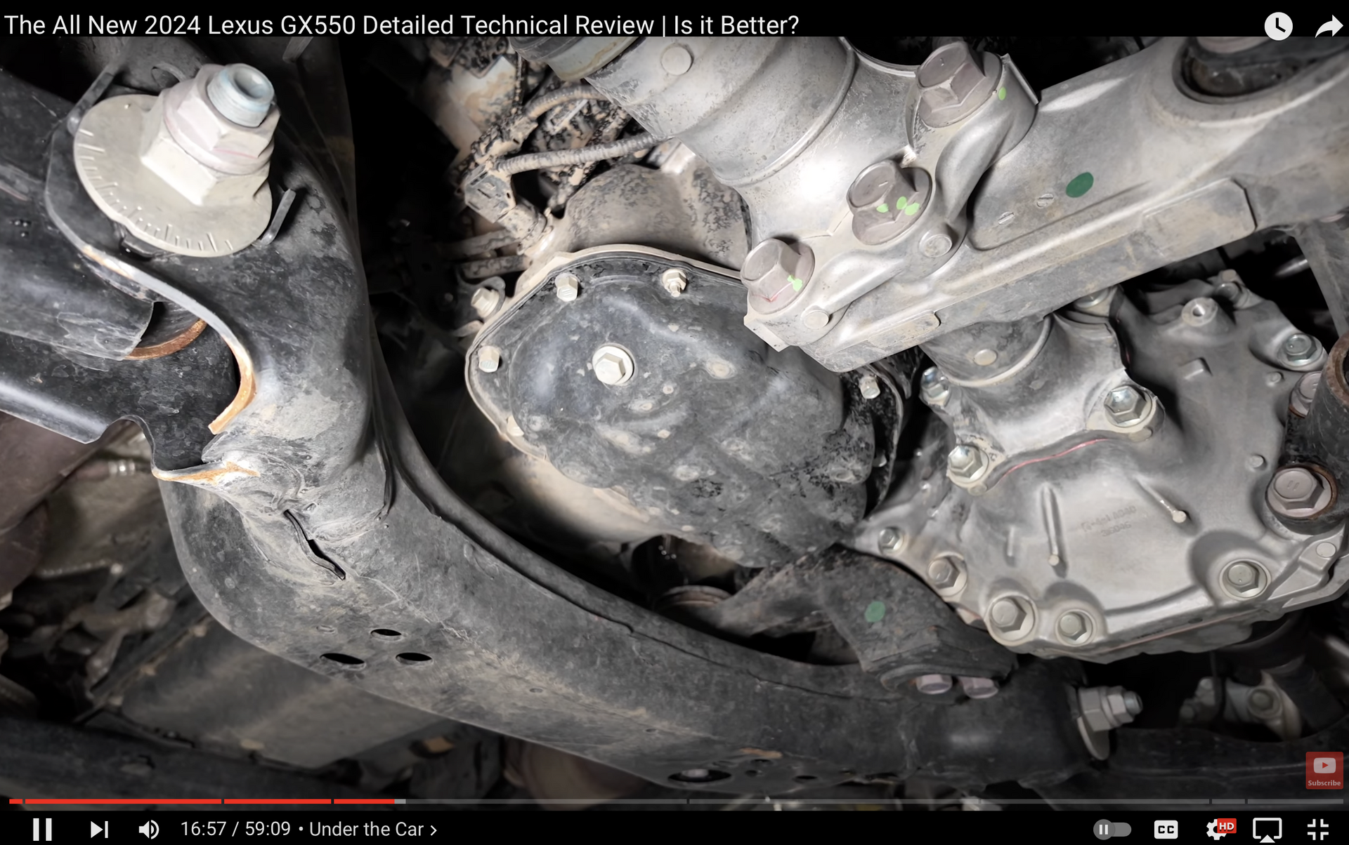

Some GREAT in-depth technical analysis here...
Great news - The front differential mounting looks to be much improved over the 120/150. It now looks more robust IMHO.
Very informative. They seem to have done a very good job of tucking parts up and out of the way of rock strikes. I recall that the 200 improved upon the 100 in this same way.

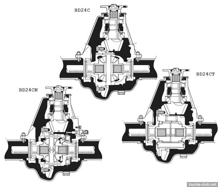

Can you source your statement that the LC300 gets a bigger diff than the GX550?
I thought that the LC300 had the BD24 in all variants (which is the same as the GX550 except for some global variant of the GX550 which gets the even smaller BD21).
Random purported image of LC300 rear diff options.

for starters the LC 300 with front locker gets 4 pinion vs 2 pinion ( without front locker - which is also applicable to 550 since it has no front locker option)
and
Ring Gear Size of LC300
front = 8.9
rear = 9.7
Ring Gear size of GX 550 with the twin 6
front = 8.7
rear = 9.5
Ring Gear size of LC250/Over seas GX with 2.4 option
front = 8.07
rear = 8.19
