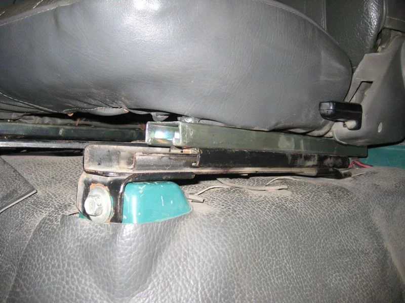

I did mine with some C-channel between the slider and and seat. Gives another 2-3" back which makes a world of difference (I am 6'2"). Also makes the seat maybe an inch higher, but that does not bother me and in fact helps the leg room. Here is a photo:
Did you mount the seat to the strut and then slid it on the slider or were you able to completely assemble it on a bench and then mount it in all in one piece? Thanks!
