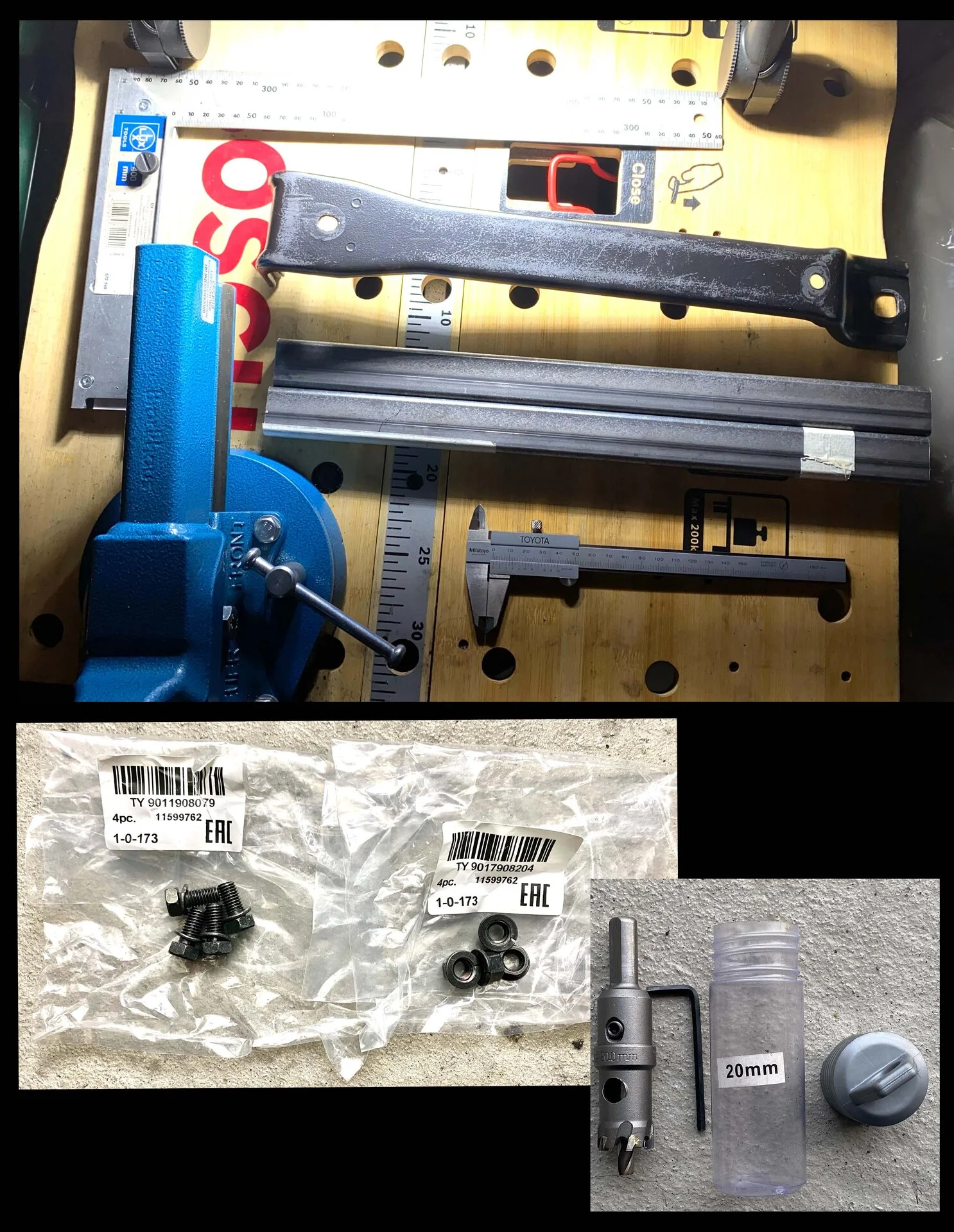

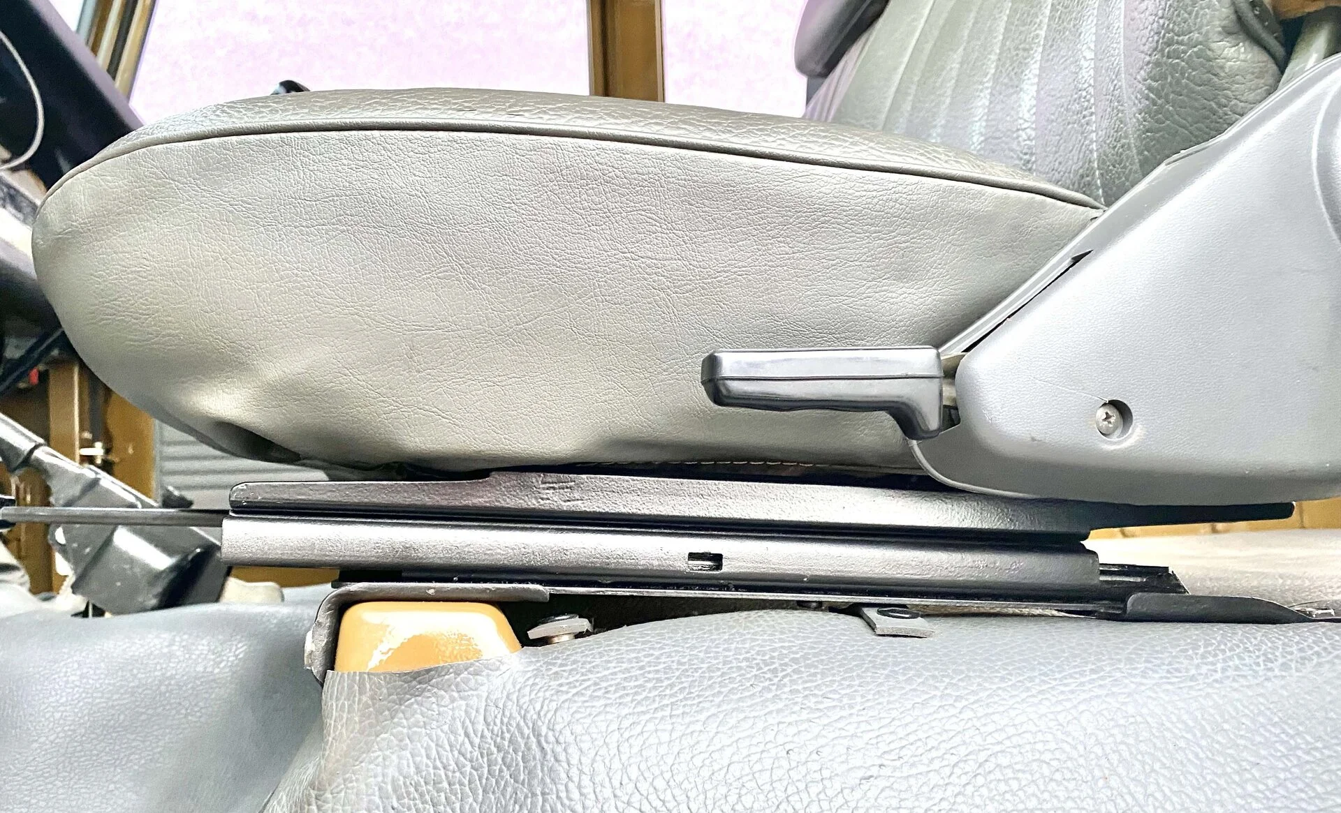

Did you mount the seat to the strut and then slid it on the slider or were you able to completely assemble it on a bench and then mount it in all in one piece? Thanks!
1. Cut and mount the strut to the seat.
2. Mount the stock slider to the strut.
3. Re-install the whole assembly by bolting the bottom of the slider back to its original position on the tub.
It's easy to do - the strut is just a middleman between the slider and seat, it lets the seat bolt on farther back on the slider to begin with.

Yes, I just used unistrut (c-channel). Way easier than making custom brackets, for the late-style seat mounts. They raise your seat height by 1" or so, which actually helps with pedal height for tall people like me. Plus allows you to move the seat back several inches further.

Did you just run long bolts to hit the holes in the strut?
No need for long bolts - the stock rail mount bolts fit fine in the strut channel and bolt the strut to the tub. Then you just bolt the seat rail to the top of the strut, further back, using the captive nuts made for the unistrut.
