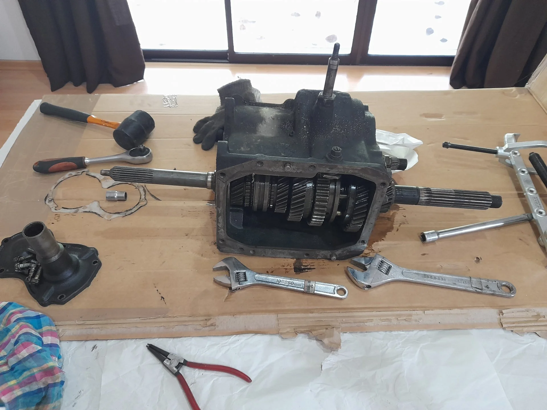

Transmission strip-down 4
I read up on how to dismantle an H55F. There are videos on YT, but almost invariably these skip the difficult parts and show you the no-brainer stuff. The best thread I found, by far, was on IH8MUD of course. The author of this thread made his own puller tool and did a really nice job of dismantling the transmission with no press (though I was far less keen on his hammer-and-drift method of reassembly).

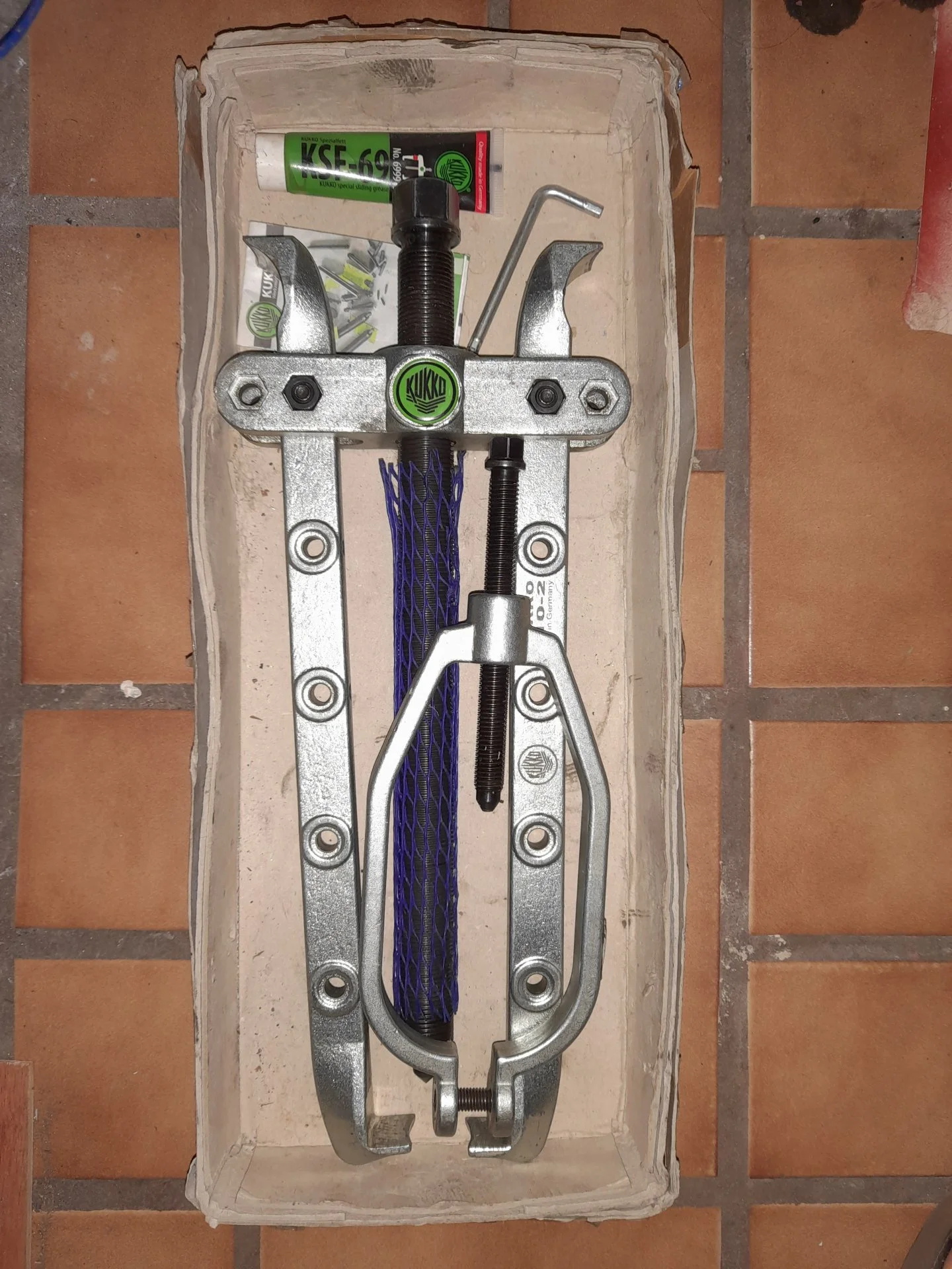

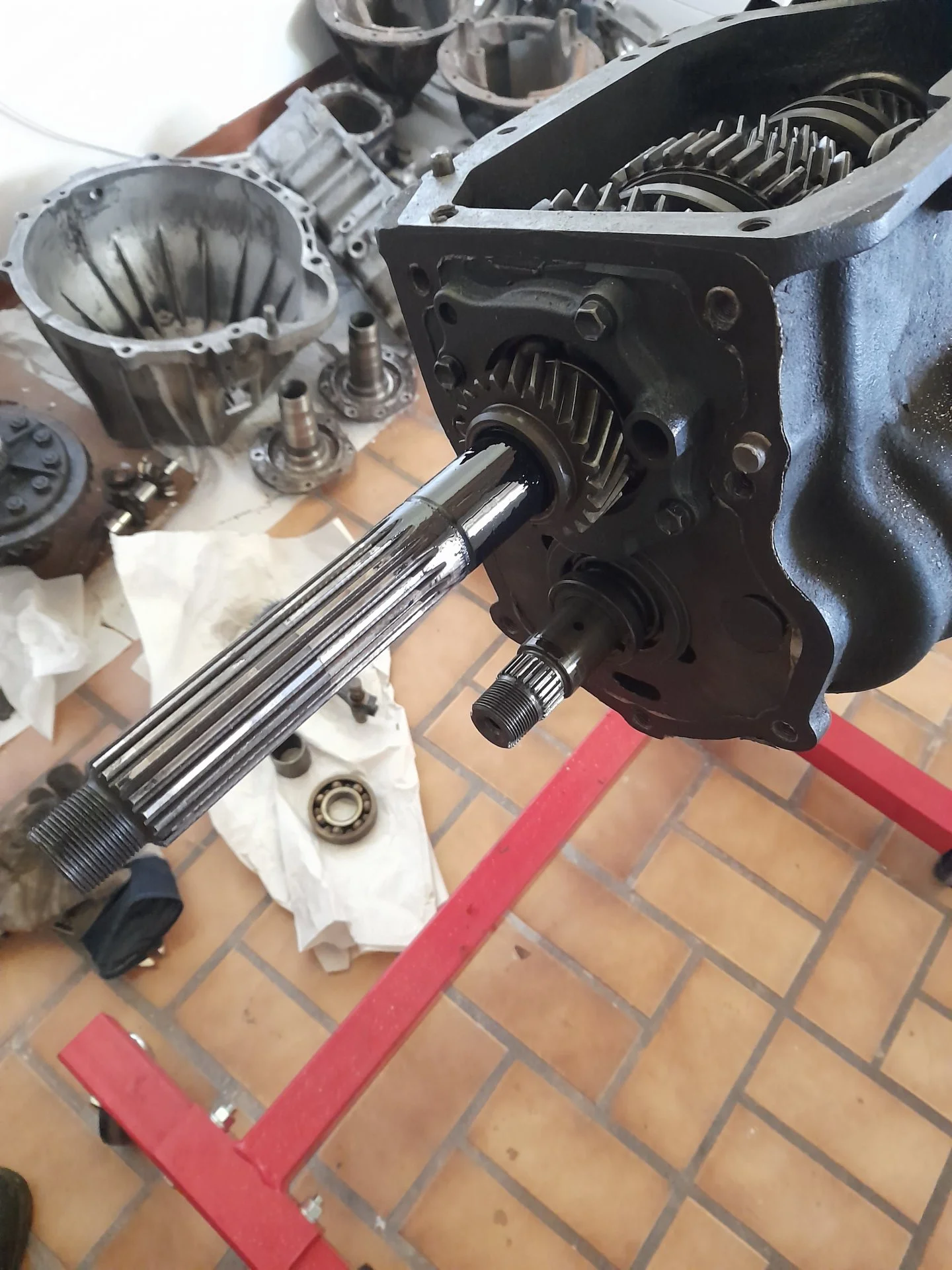

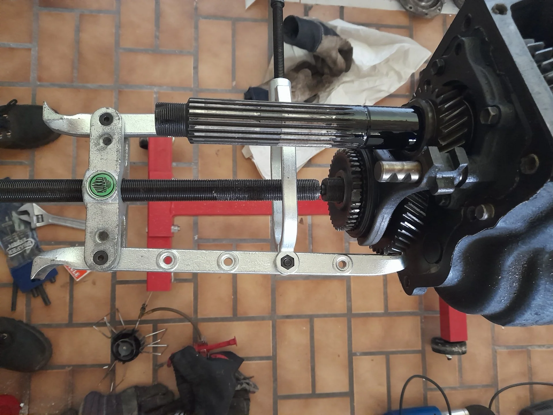

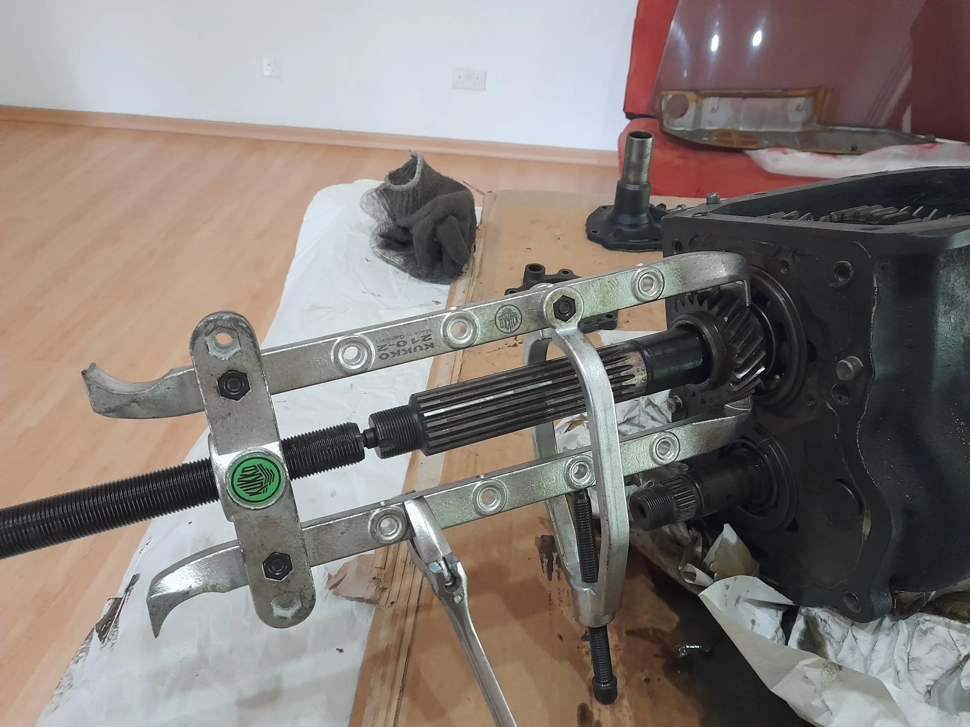

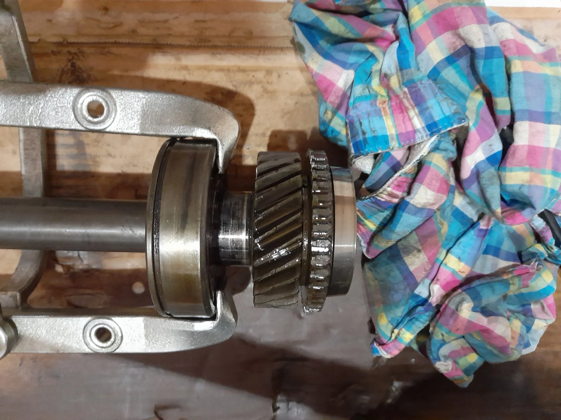

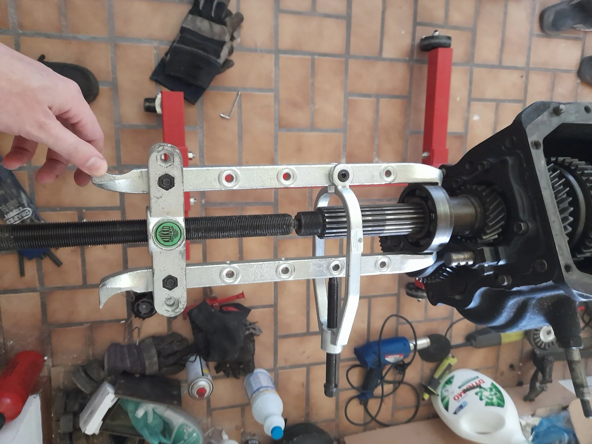

I got lucky on eBay and managed to pick up cheaply this very nice puller, a Kukko AR210-2, apparently good for an 8 tonne pull and a very high quality German-made tool. My initial plan Is to use it where I can, then make some thinner arms with pawls on to draw out the really tricky bearings. The Kukko has reversible arms with standard, right-angled tips on one end, and curved, sharp claws on the other to grab awkward shapes and grooves.

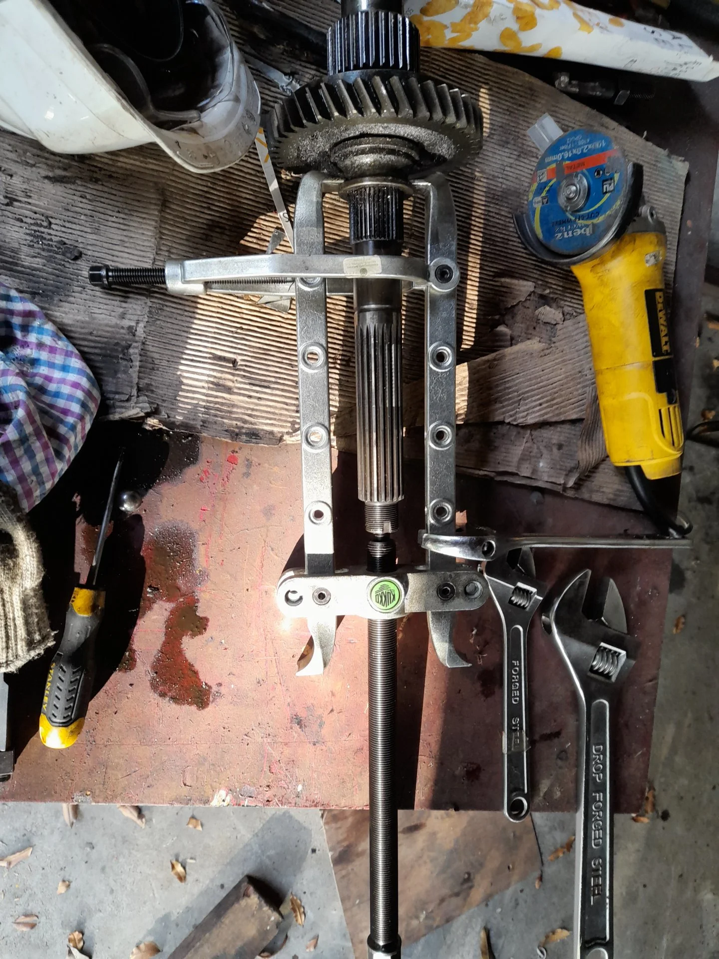

It easily pulls off the output shaft rear bearing...
...and the counter fifth gear/syncro ring/spline piece/shift sleeve/shift fork and shaft assembly.

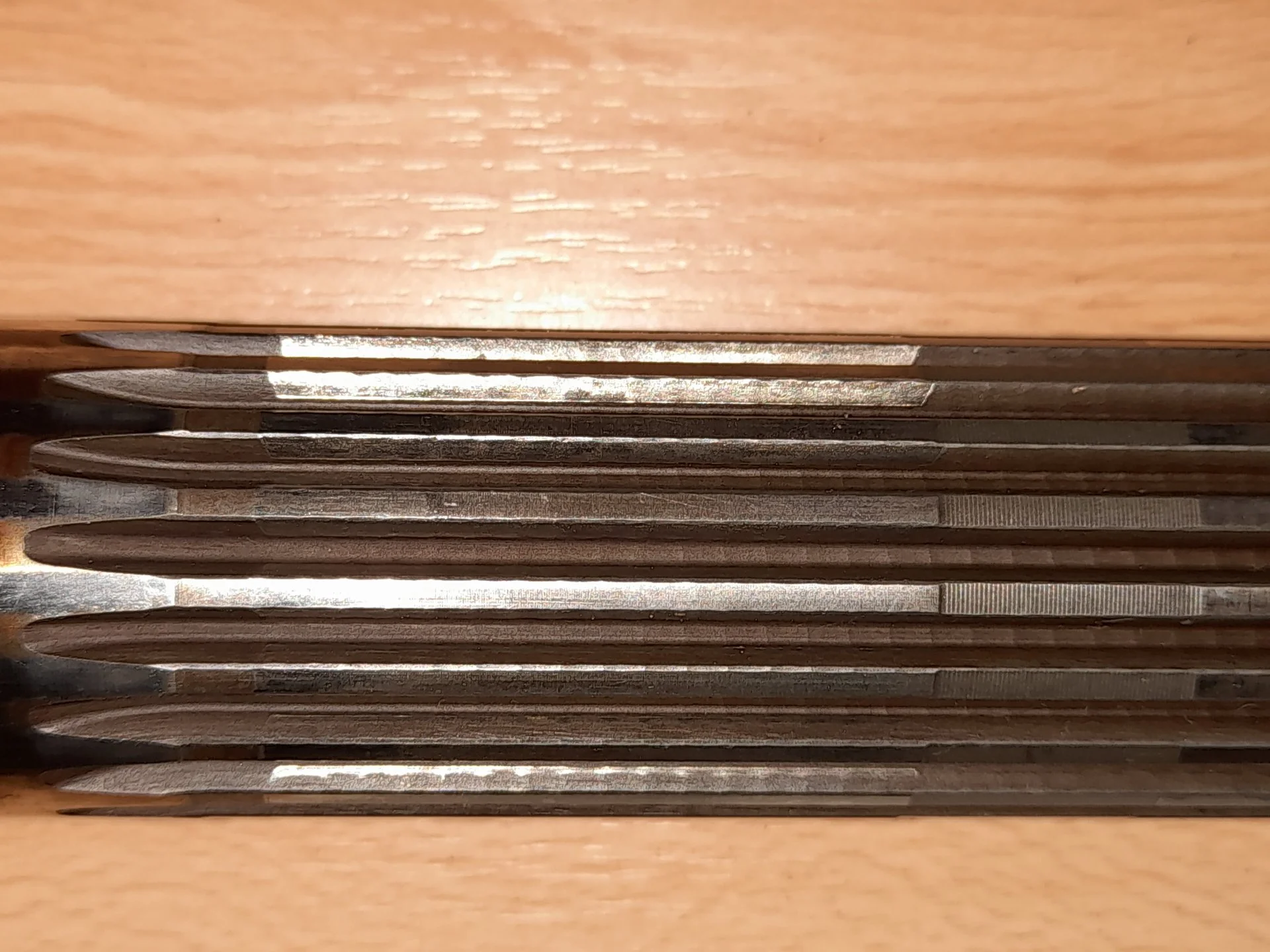

Output shaft splines look pretty good, counter fifth needle bearing journal on the countershaft is dark and feels glazed, but does not look to be damaged.

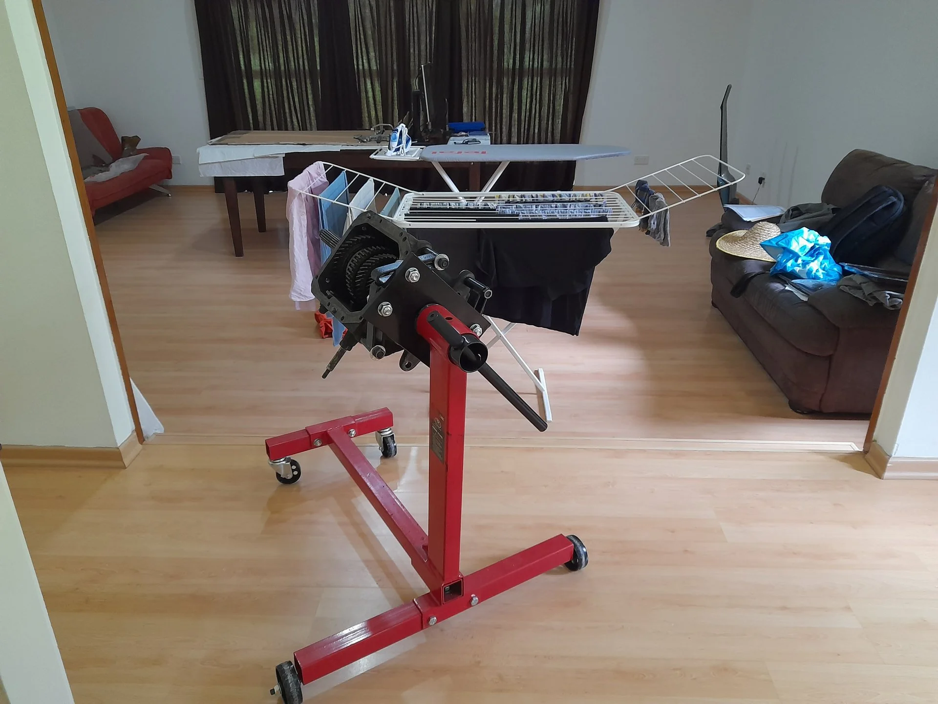

For the next steps, I need access to both sides of the transmission, so it's off for a short drive into the living room.

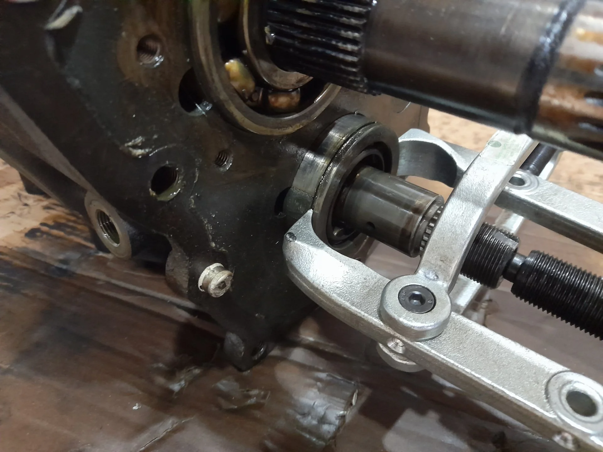

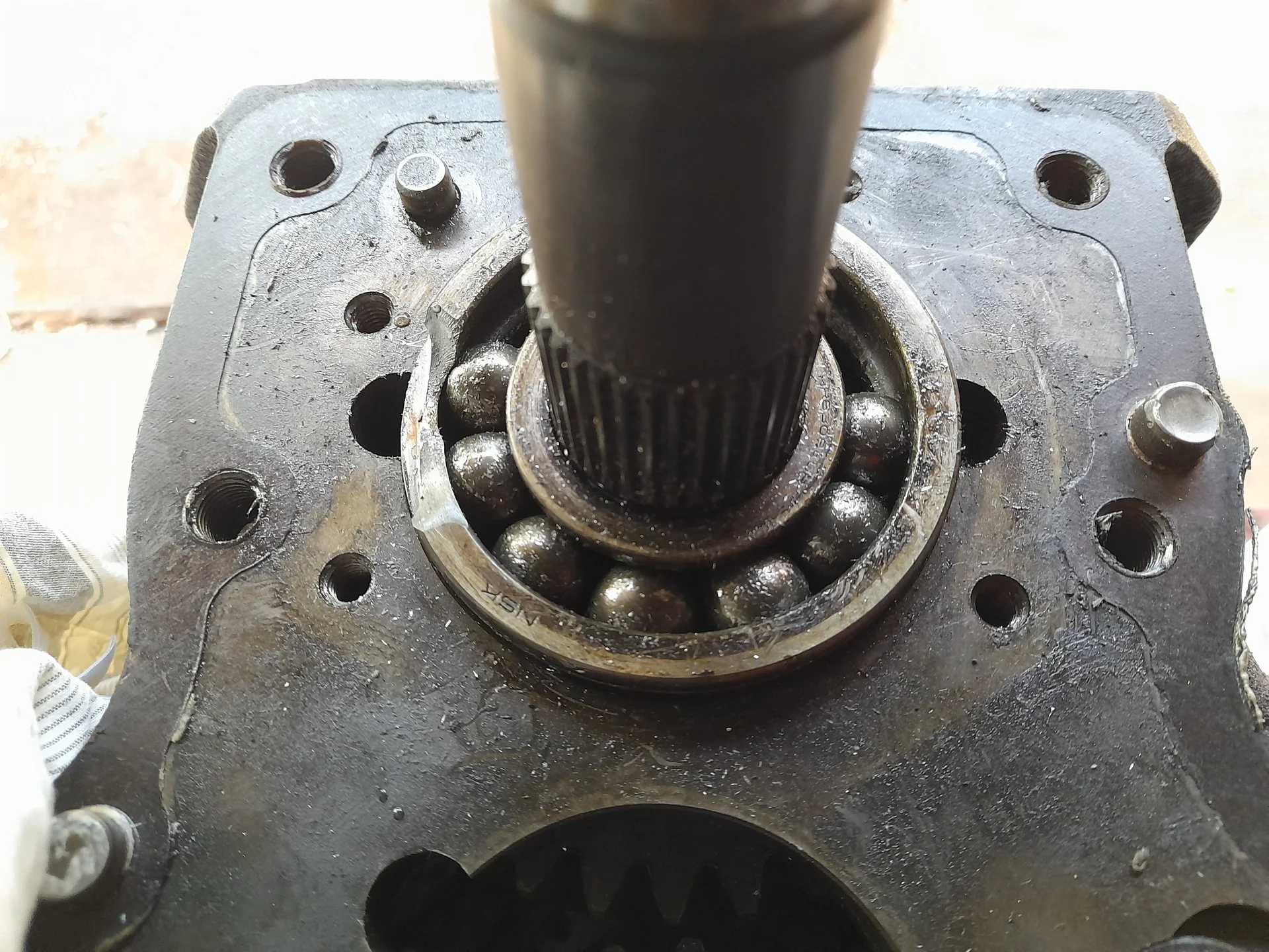

With the engine stand bracket removed, Off comes the front bearing retainer. Thankfully in good condition, as these are NLA. Note the hand-cut plastic gasket....

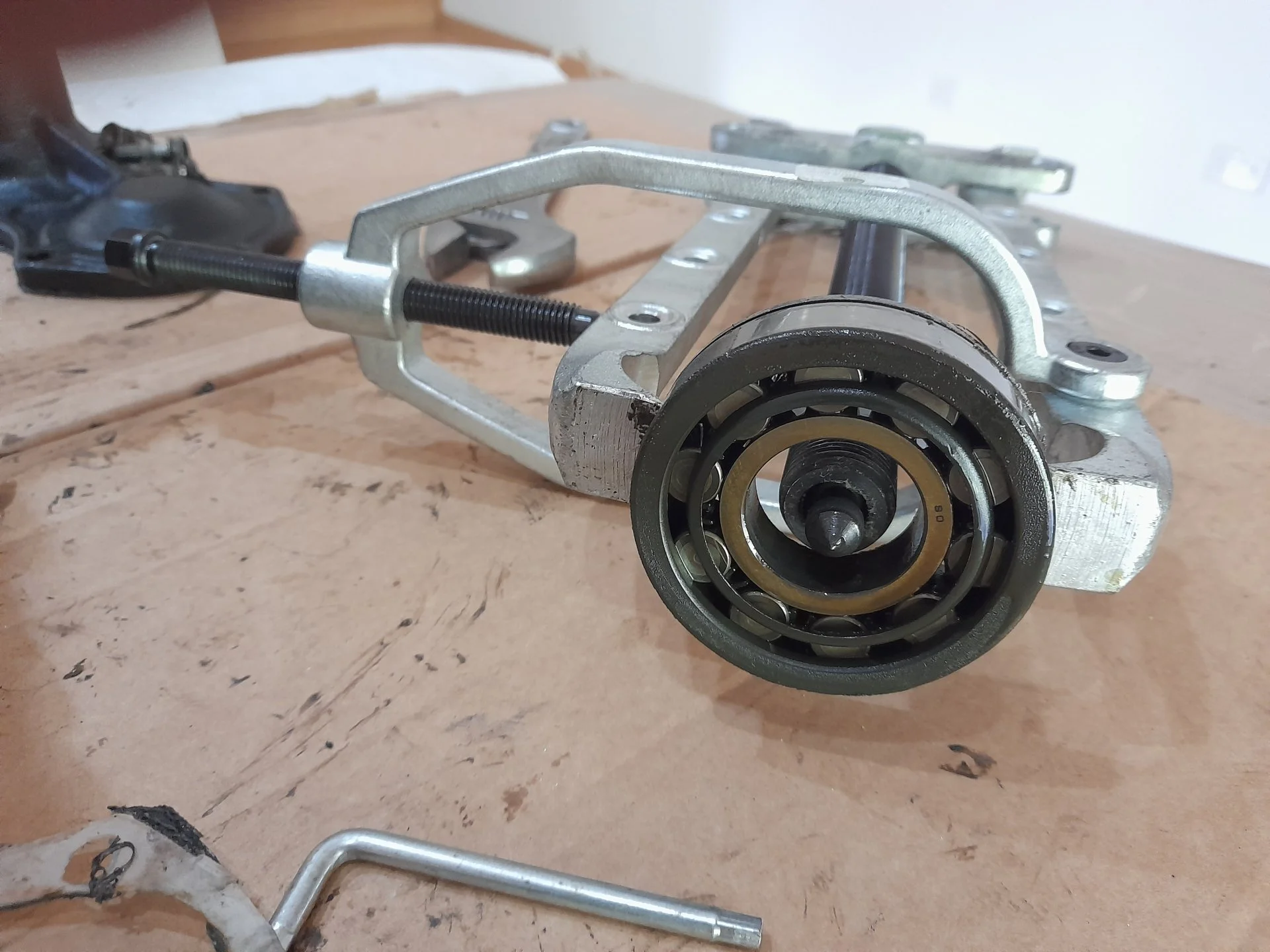

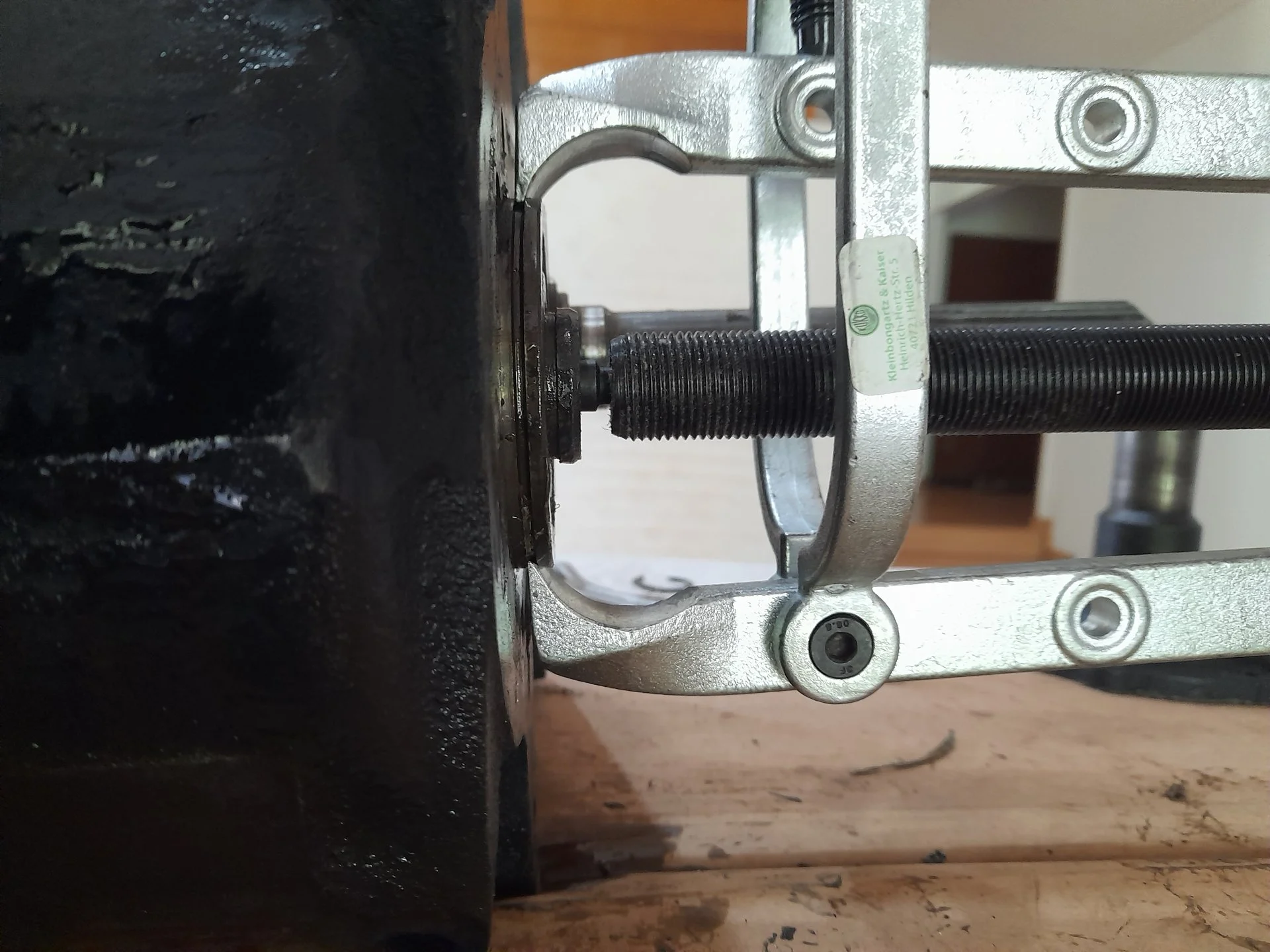

I flip the legs in the Kukko and put the sharp claws into the outer snap-ring groove of the front countershaft bearing...
...and out it comes, easily. For some reason, I find it very satisfying to pull bearings. NOTE: if you are stripping an H55F, take the thrust collar off the countershaft once the front bearing is off, as this allows the countershaft to drop lower in the case, which helps in following steps. I only realised that when it came to the rebuild.
The rear countershaft bearing comes off easily by the same method. With the countershaft loose and in the bottom of the case, I easily removed the input shaft and bearing by pulling with one hand while tapping the shaft with a soft hammer with the other hand. HINT: tape up the rear bearing and counter 5th gear journals on the countershaft to avoid damage while it rests on these in the case.
Flipping the legs back to right angle grips, 5th gear is pulled off the splines (I actually did the last three steps in a different order but post them here like this for consistency).

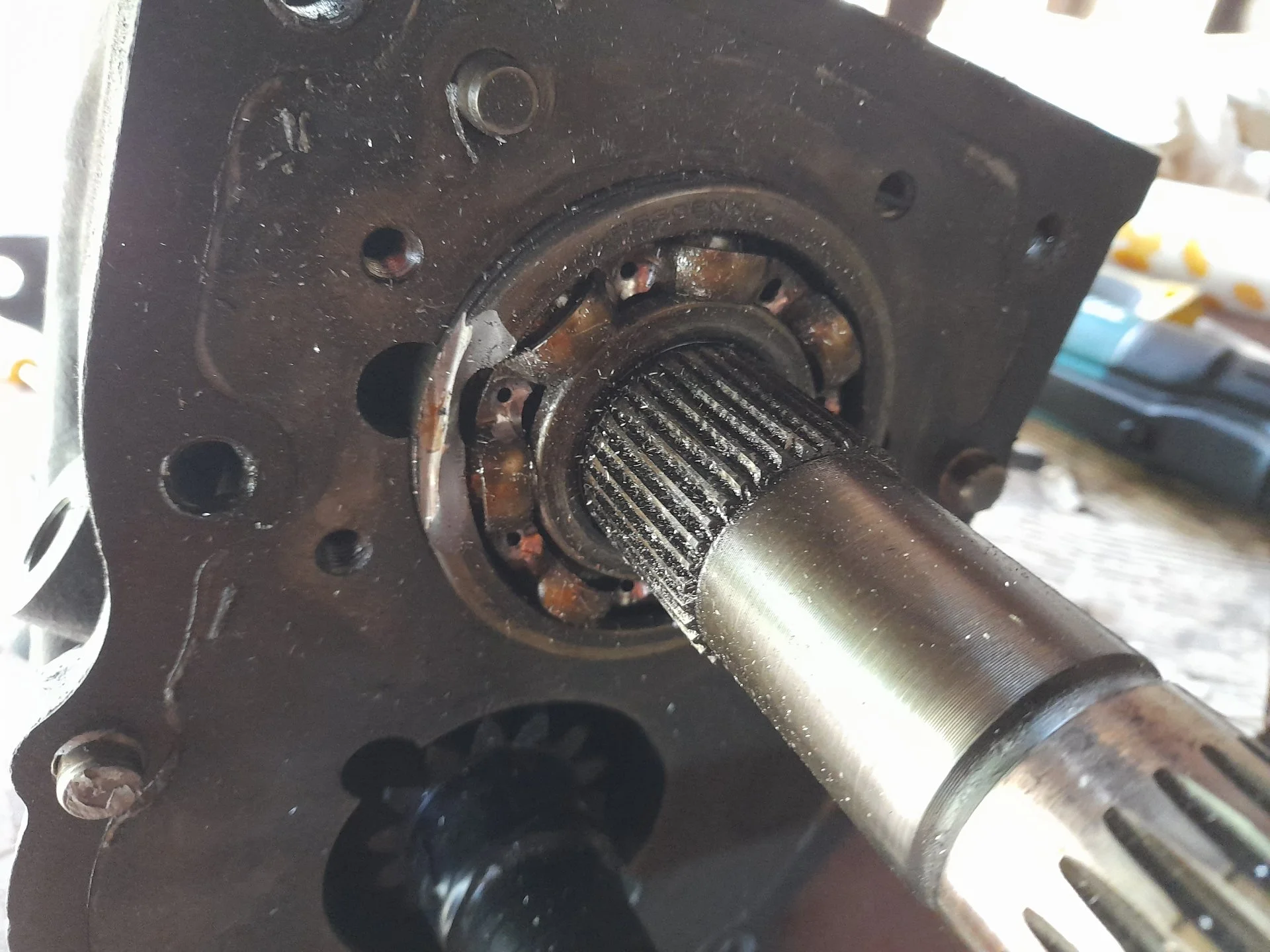

With the transmission relocated from my Javanese hardwood living room table to a workbench outside, I give the Kukko another shot in the snap ring groove, which I have now opened up with an angle grinder disc. I torque it more, and hammer with a punch on the inner race of the bearing. And then it goes bang. OSCB-1, Kukko-1.
I hate to remove things destructively, I think it's a sloppy way of working, but sometimes it is the only way. And besides, the outer race has already been broken by the Kukko. So out with the die grinder, I grind away the retaining cage on the balls and collapse the bearing. OSCB-1, Kukko-1, Die grinder-1.
Out with the output shaft cluster, and countershaft. Very happy to get these out without damage.

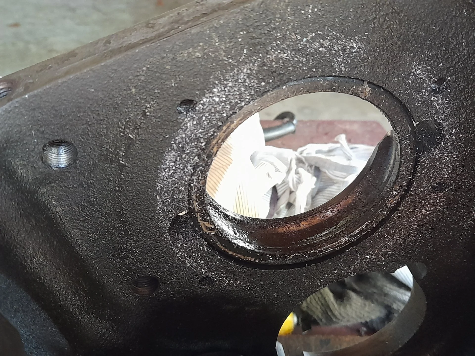

That leaves just the outer race in the transmission case, which is easily knocked out with a hammer and punch.
And the inner race needs taking off the output shaft in order to remove 1st gear. I ground some flats into the race so the Kukko could get a better grip. It's at pretty much full reach here, and even now the inner race is very stiff to remove. But the Kukko prevails, and the hardest part of the strip down is done. OSCB-1, Kukko-1½, Die grinder-1, Hammer/punch-½.

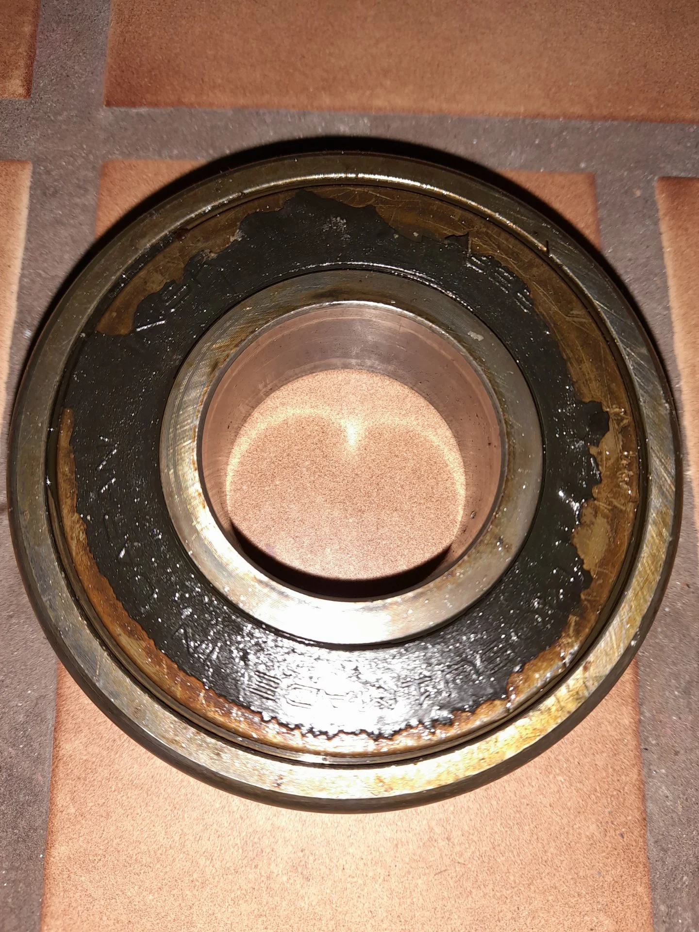

The Kukko back at work removing the inout shaft bearing. This bearing has been monkeyed, the front shield is missing...
...and the rear side of the bearing has a dented shield with the rubber coating falling off. I really have no idea what kind of botched work led to this. Of course, being a huge NSK bearing, it still ran fine.

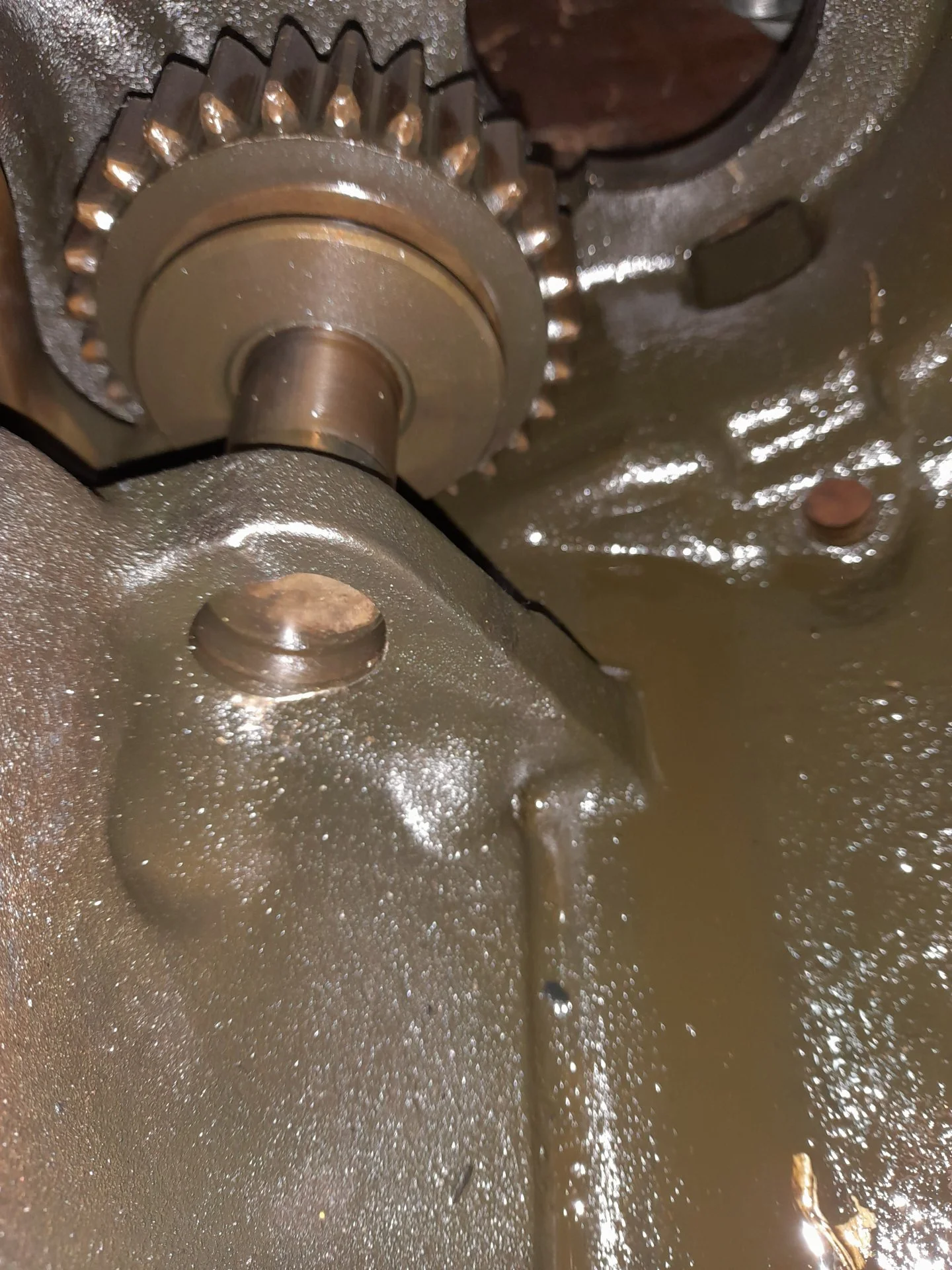

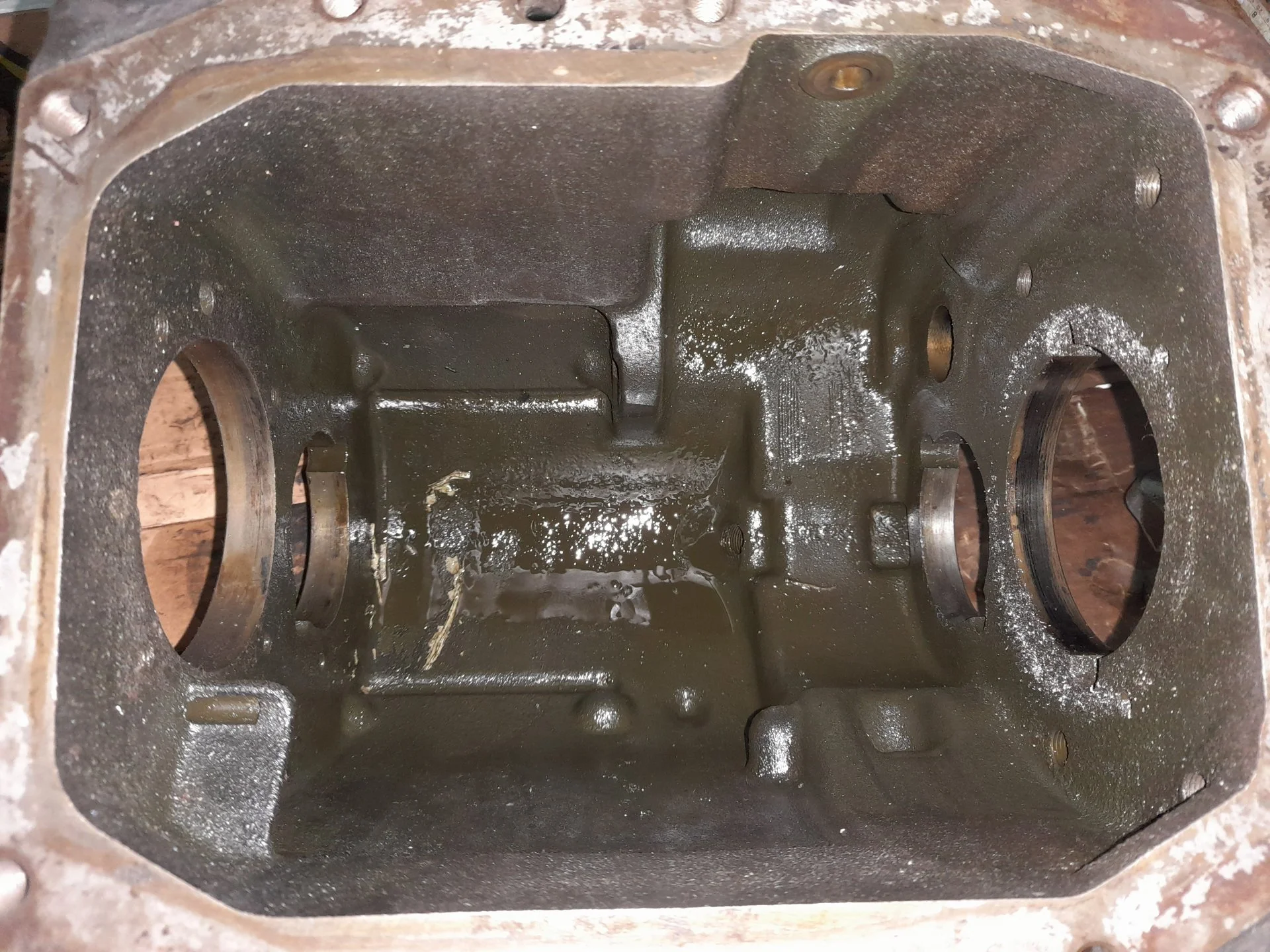

Reverse idler gear shaft knocked out with a hammer and drift.
Revealing one filthy case.

Just a FYI both the front bearing retainer and shift handle are available new. Loving the living room rebuild

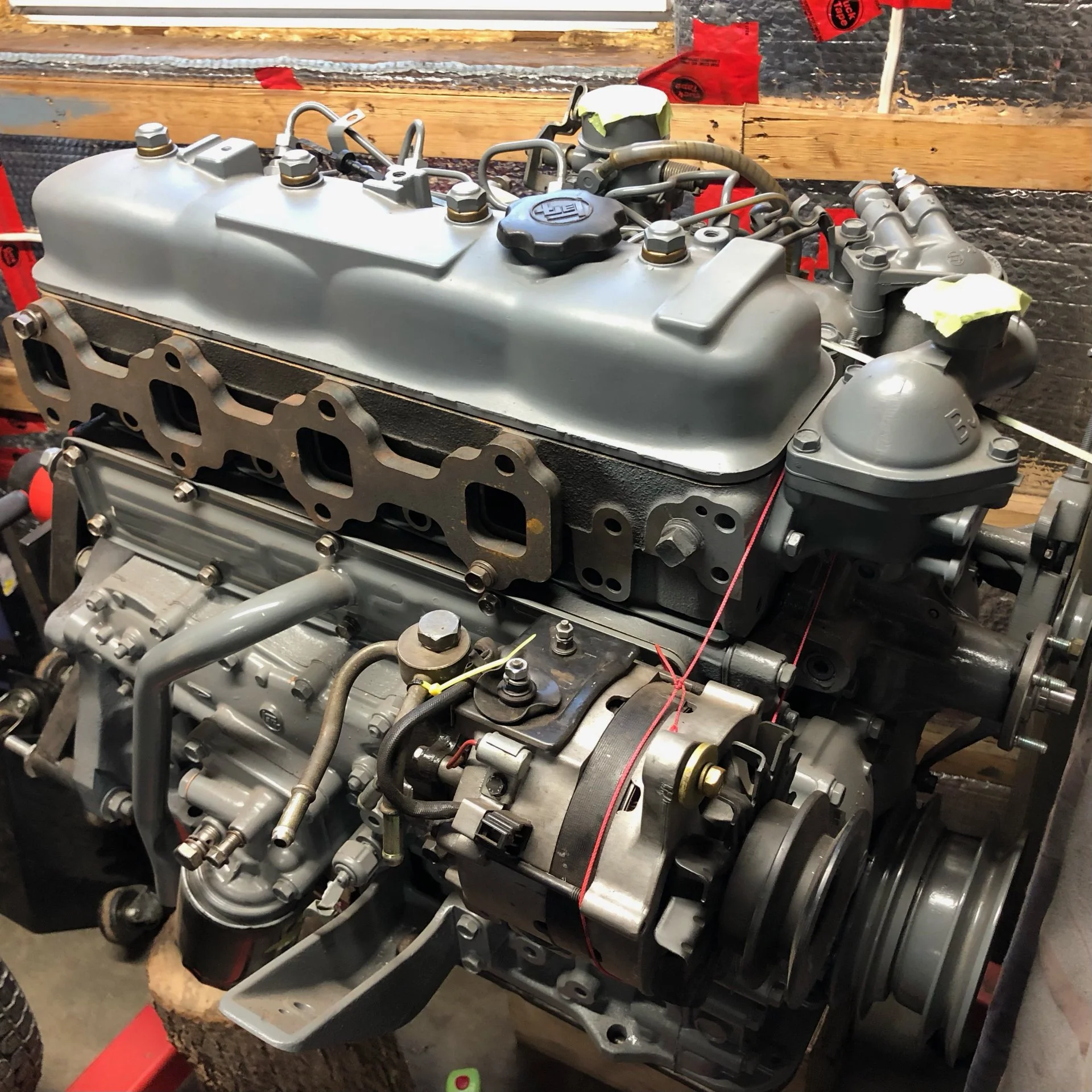

Nice looking engine, I see a power steering drive pulley but no pump. Is that a thick spacer on the exhaust ports to fit a turbo? Or do the old 3B heads look like that? I can imagine that the old stlye B engine parts are getting prety hard to find, 34 years after the engine updates.

It does have a steering pump…somewhere in the garage hum? Yes I plan on doing a homemade exhaust manifold for a turbo, like many did here before.

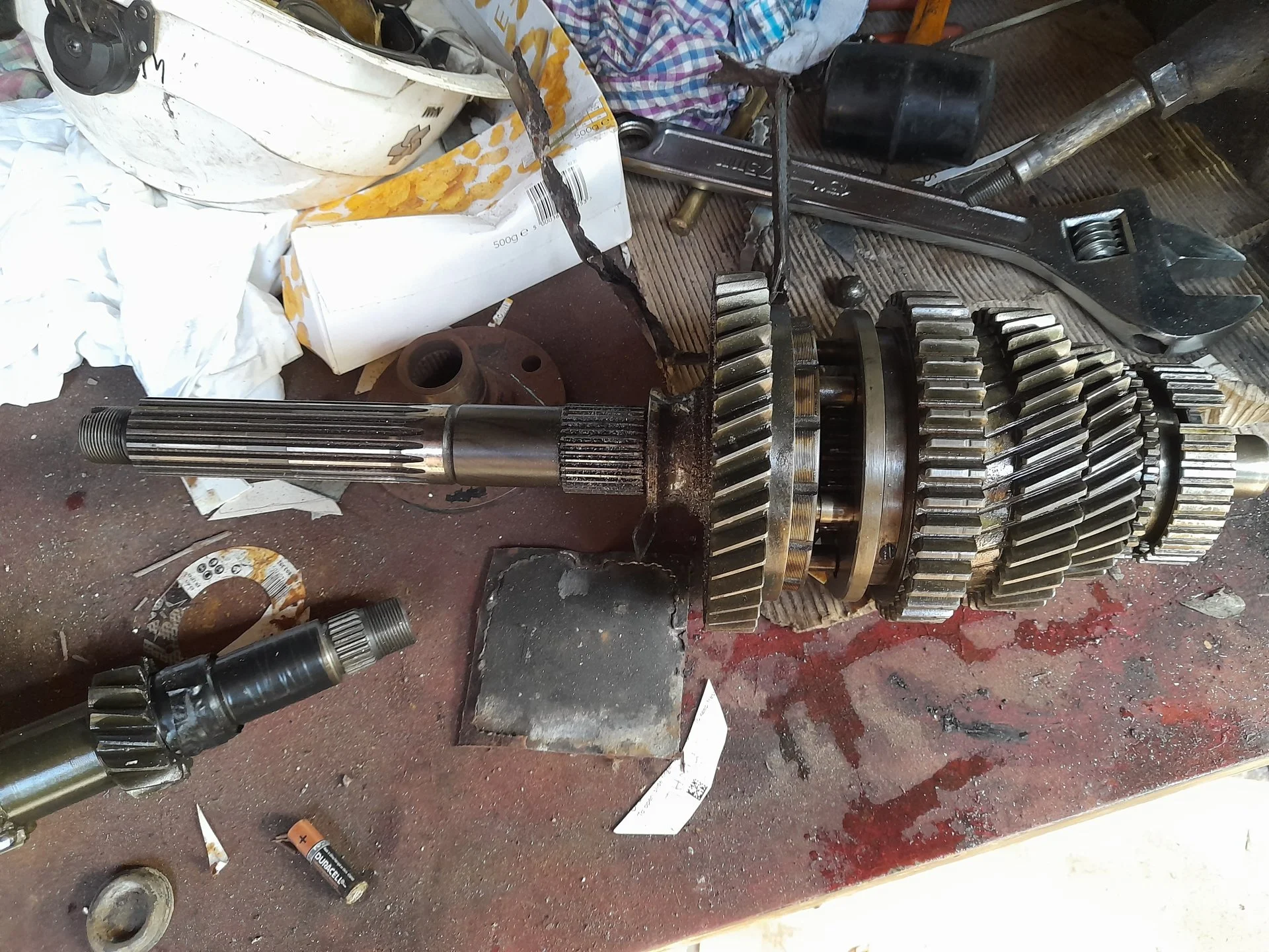

Transmission inspection 1 - gears
Replacing all bearings and individual syncro rings has always been on the agenda, but I hope to re-use the gears.
These are the (earlier measured) thrust clearances, taken with feeler gauges.
1st gear
Should be: 0.175 - 0.325 mm
Limit: 0.35 mm
Measurement: 0.20 mm
2nd gear
Limit: 0.35 mm
Measurement:
0.35 mm
3rd gear
Should be: 0.125 - 0.275 mm
Limit: 0.3 mm
Measurement:
0.35 mm
Counter 5th gear
Should be: 0.10 - 0.30 mm
Limit: 0.30 mm
Measurement:
0.20 mm
The 2nd and 3rd gear thrust clearance is measured against the 3rd gear bushing, so as a minimum, that bushing is going to be replaced. But...

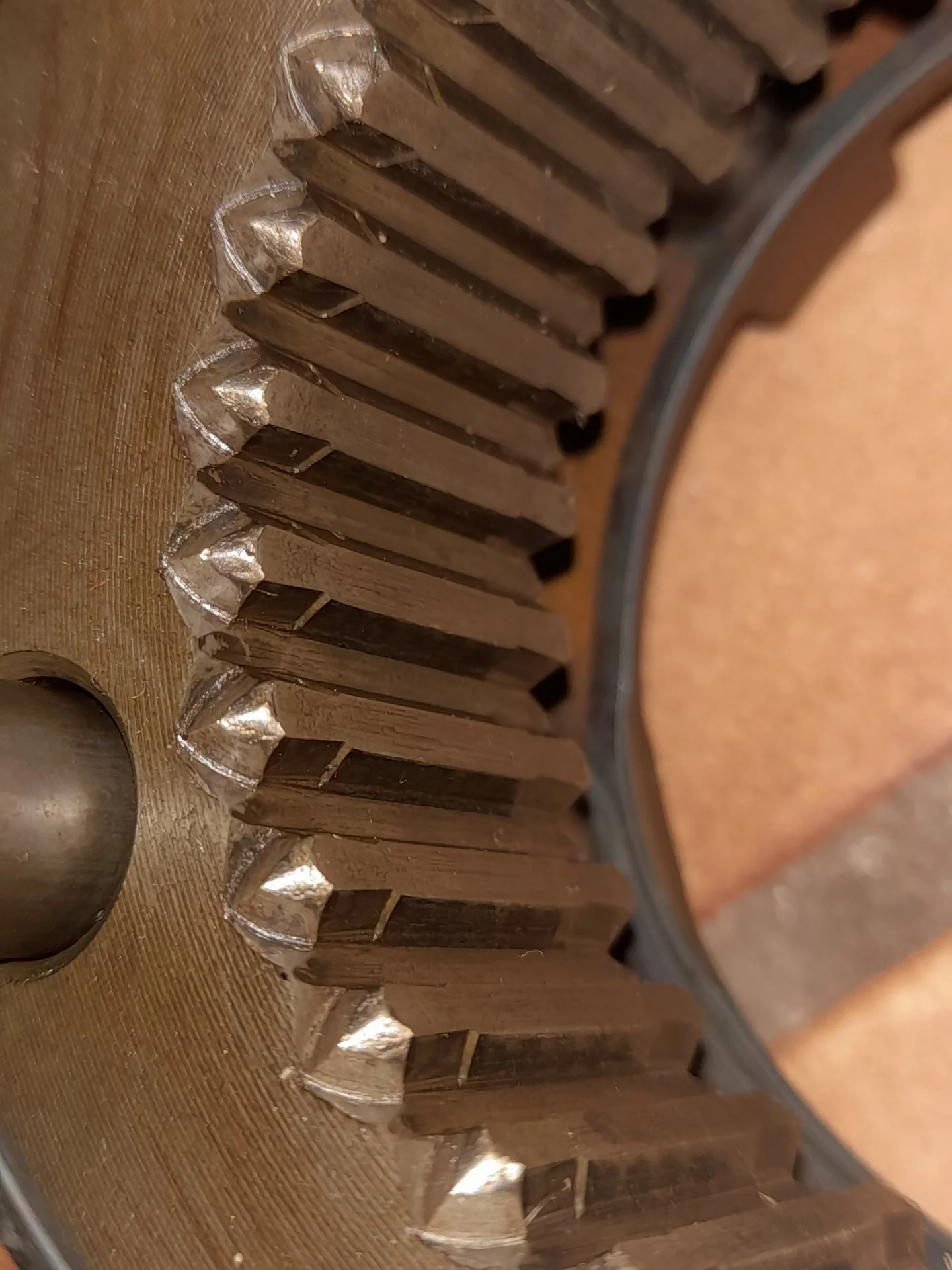

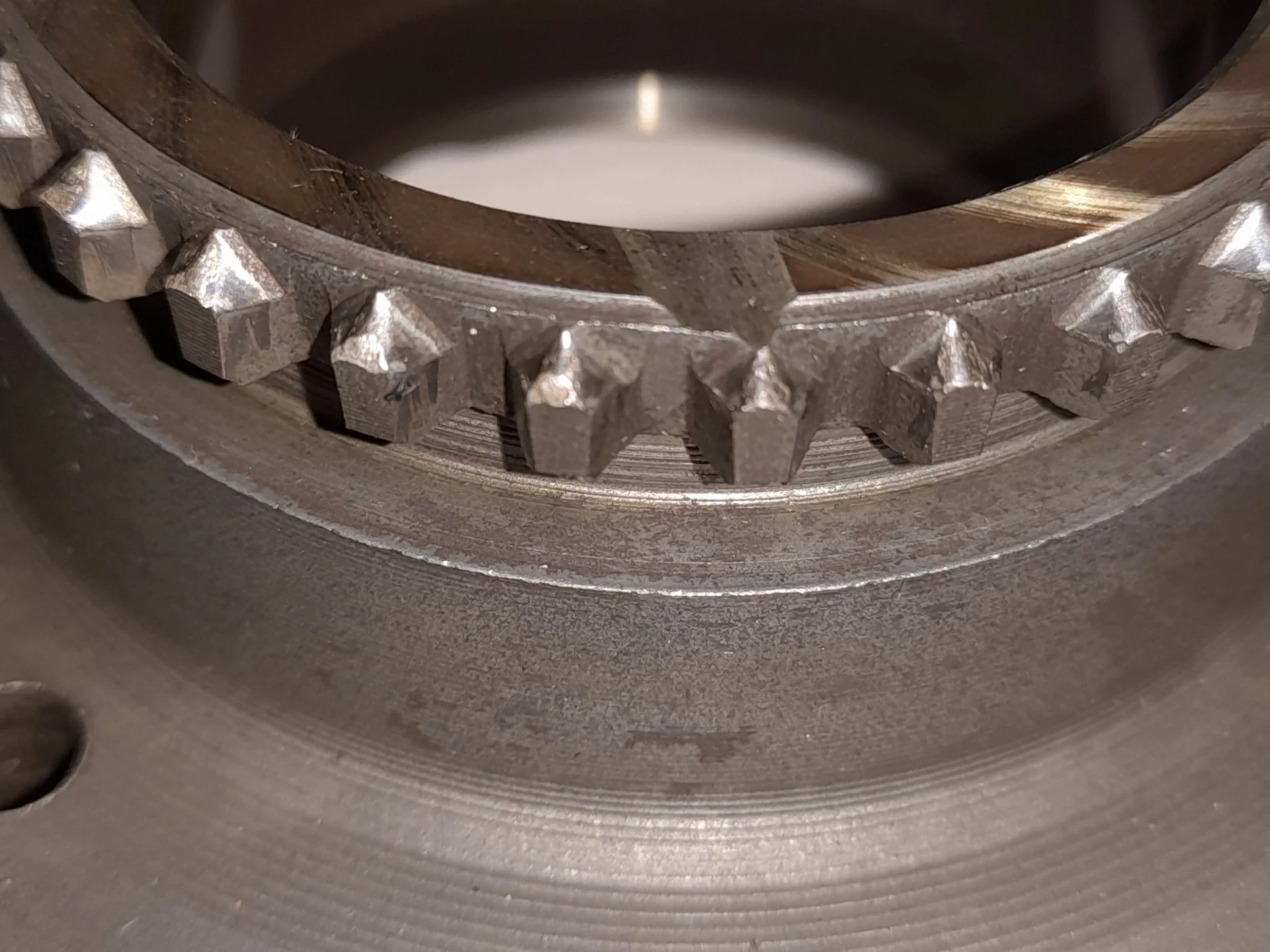

...I had noticed before disassembly that the third gear dog teeth were not looking good, but up close they are pretty bad, not just rounded with wear, but broken away, with a complete loss of profile. Given this and the excessive thrust clearance, I will replace 3rd gear, which is the cheapest of all the gears. What about 2nd...
Before disassembly, I found it hard to get a good look at the 2nd gear dog teeth as they are only visible in the middle of the reverse gear/1st/2nd syncro ring assembly. Now, up close, they have a bit of wear too. So probably best to replace 2nd gear, given also that the thrust clearance is right on the limit.

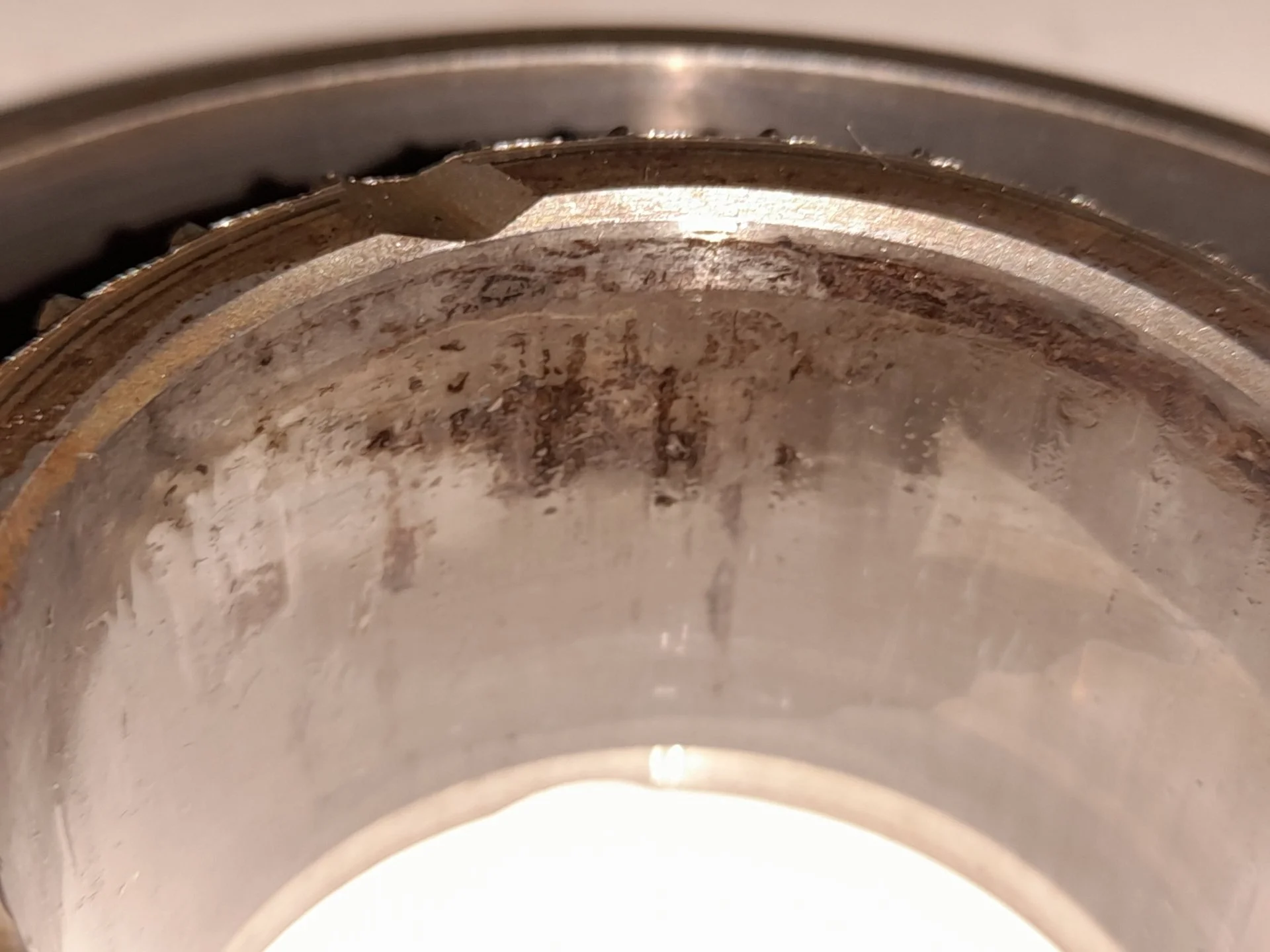

Some good news! The first gear dog teeth still look nicely sharp and intact. But wait, what is that mark on the bearing surface...?
Corrosion, of course. Looks like there must have been a tiny bit of water in the bearing. So I need a new 1st gear too.

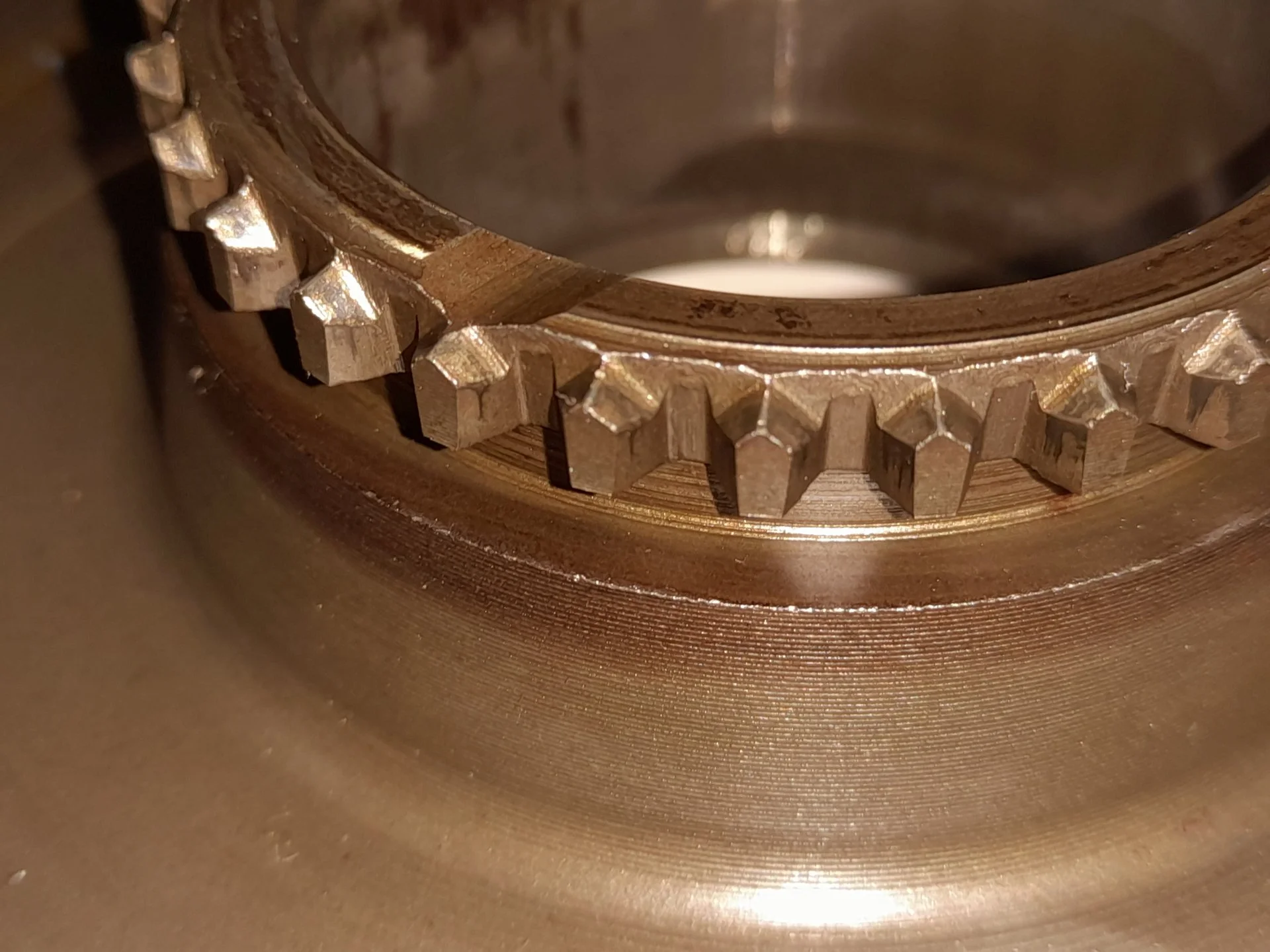

Finally, the reverse gear/1st/2nd syncro sub-assembly, let's have a close look:
Teeth rounded off on the 2nd gear side... added to the shopping list.
At least the shafts look OK...

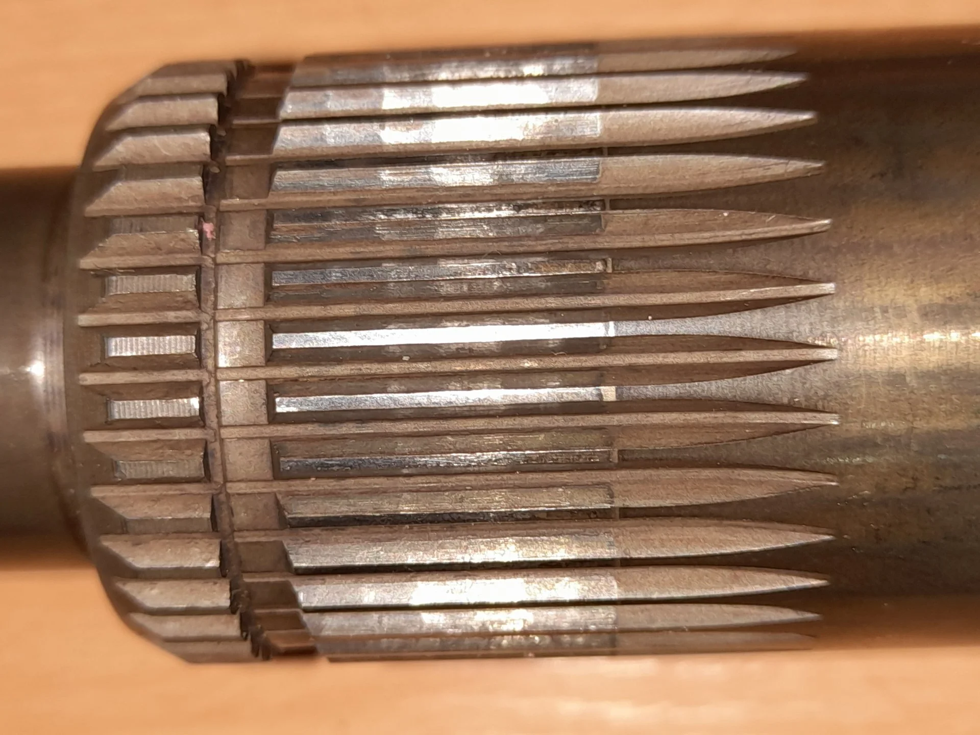

The 3rd/4th gear shift hub had some slop on the output shaft splines, obviously a sign of advanced wear. But the splines look and feel OK.
No significant wear visible on the splines, nothing I could catch with my nail. But I somehow doubt that all the wear would be in the splines of the shift hub.
One of the weak points of the H55F is wear on the output shaft splines where the transfer input gear sits. Given that my transmission probably has more than half a million kilometres on, and has been poorly maintained, it's surprising how little wear there is on these splines. They are not perfect, but probably re-useable.

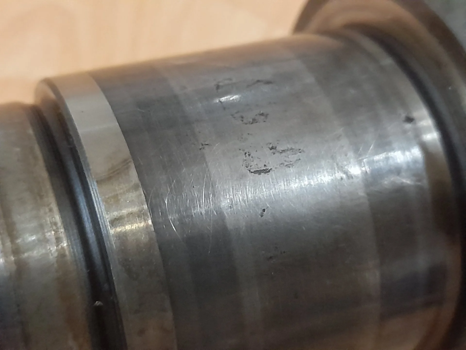

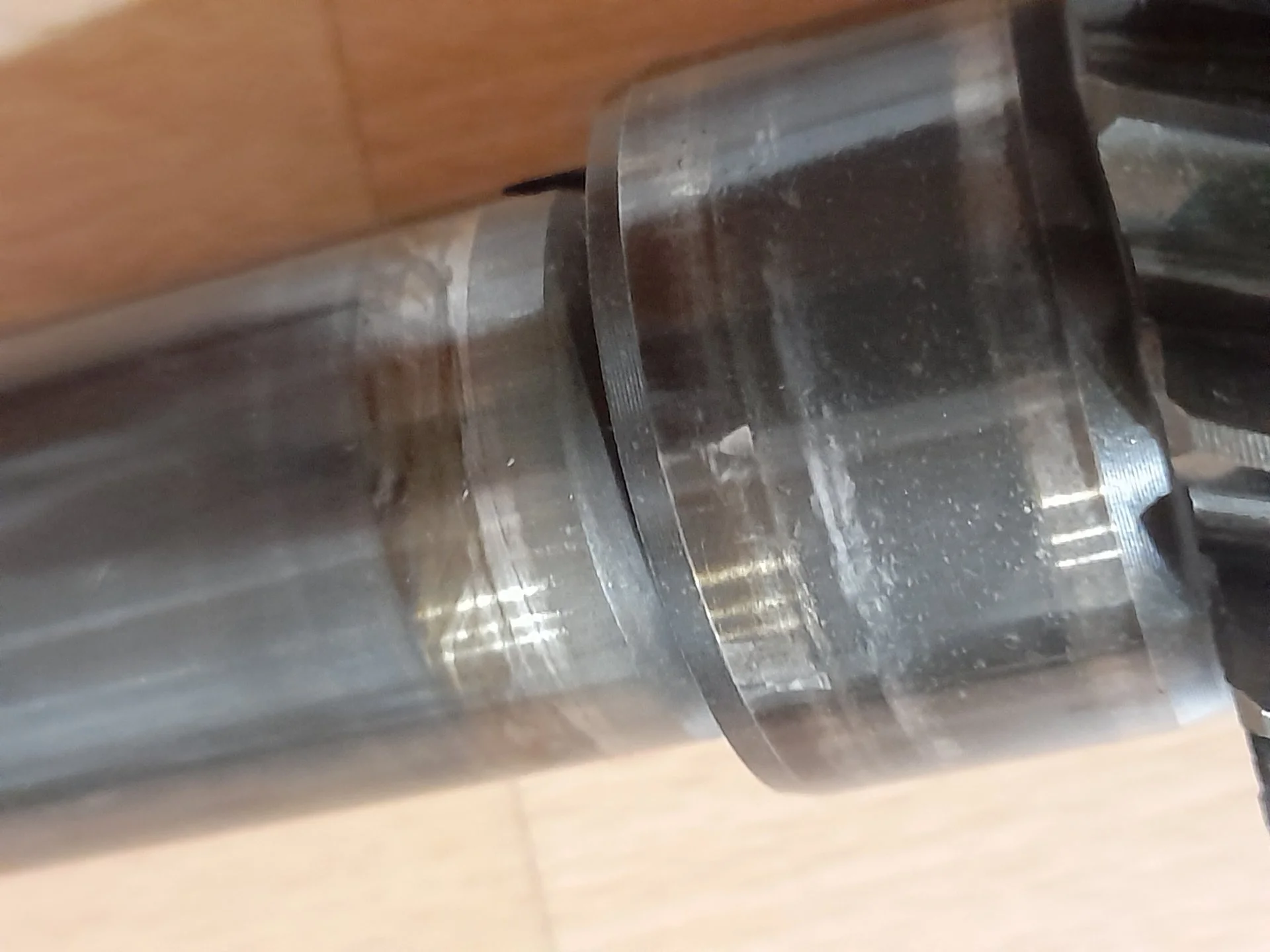

The worst part of the output shaft is the first gear needle roller bearing journal. Both 1st and 2nd gear journals are very smooth and glazed (which I assume is caused by excessive heat from poor lubrication?). But theat same water which sat in the 1st gear needle roller bearing and corroded the inner race of the gear, has also caused pitting in this shaft.
I think I could get away with running this shaft, but I really want this transmission to be perfect. After a lot of deliberation, I have decided to replace the output shaft.

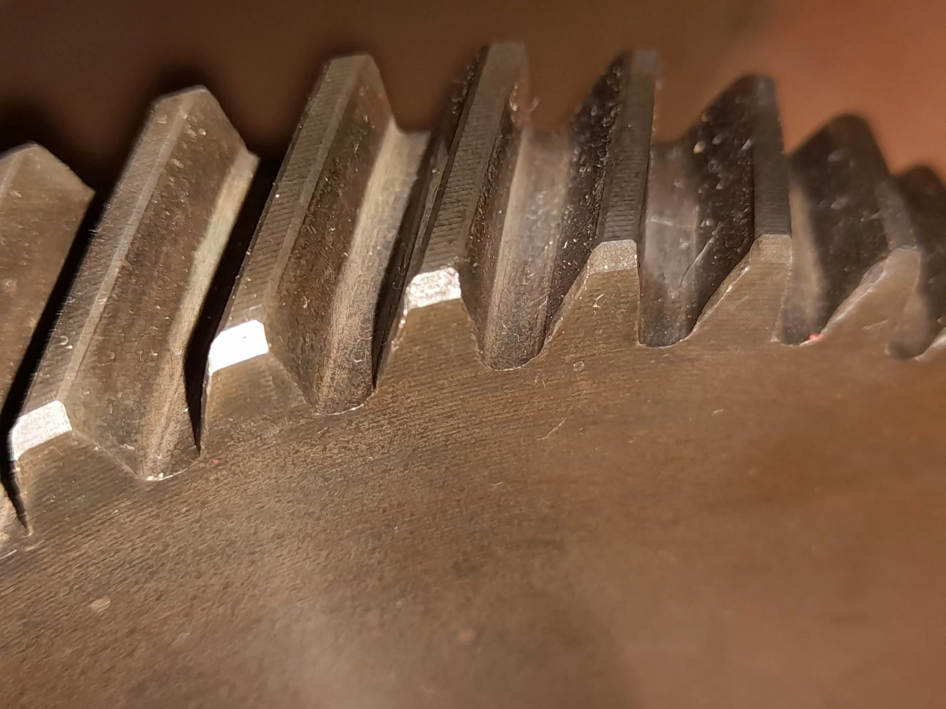

Also, not surprisingly, there is wear on the load flanks of the front gear of the countershaft (what do we call this gear? counter input gear? countershaft input gear? counter 4th gear??). It's hard to see in this picture, but the wear is pronounced.
So the countershaft will also be replaced.
