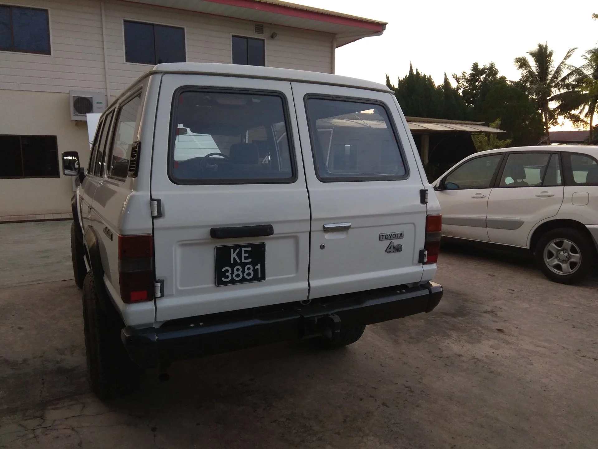

July 1989 built, General Market BJ60RG-KRC. Right-hand drive, delivered new to the owner in January 1990. The body was absolutely straight, no visible signs of structural rust, original bumpers. Lifted with oversized wheels, extended shackles, aftermarket wheel arch extensions and home-made side steps (all to be removed) but no signs of having been taken off-road (unlike 90% of Landcruisers here). Paint good from afar but far from good and showing a few rust bubbles - one scab on the left hand side of the roof, one on the front LH door, plus those graphics which need to be removed.
Swing-out rear doors (I'm not sure if I prefer these to a tailgate, both have pros and cons in my opinion), worn interior (not surprising given it had clocked up 567,000 kilometres as a family car). A very low-spec vehicle, though the previous owner had made a few upgrades. Front drum brakes had been changed for factory vented discs, and the H41 had been upgraded to an H55F for highway driving. No tacho, no heater, no rear seatbelts. I took it for a drive. It drove nicely aside from having brakes which were bad even for an old Toyota. The A/C did not work, which hardly surprised me given its jury-rigged appearance.

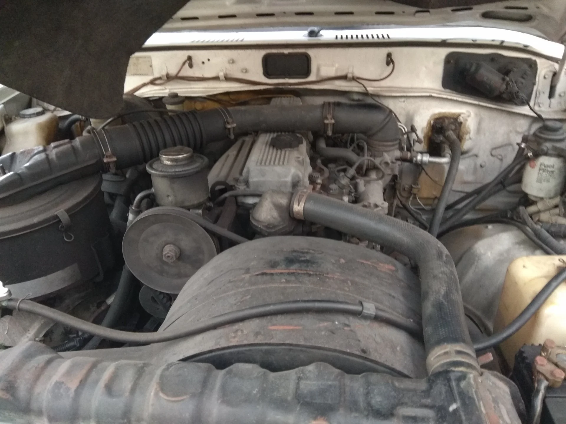

The engine. I was only vaguely familiar with the 3B engine from 40 Series 'Jeeps' in Pakistan - it seemed to be an ancient 4 cylinder tractor engine recognisable by its rounded valve cover. This sports a '3Bii', which was updated in 1988 when Toyota/Hino updated the design of the B series diesel. I've read a couple of accounts of people who have driven both and they remark that this 3Bii feels a good bit torquier, but it's still a 4 cylinder, 8 valve, indirect injection, naturally aspirated diesel. But, a 14B would be a straight swap; a 14B-T, 15B-F or 15B-FT would be a very easy swap. More on that later. Pretty much every point of the engine or transmission that could leak appeared to be slowly letting fluids past. A shoddily installed sound deadening sheet was peeling off the bonnet and the poorly painted engine bay showed at least two non-original paint jobs, with overspray. The A/C hoses, of questionable manufacture, were stuck through the bulkhead with a sheet of bitumen and ample silicone.
I waited a few days, then bought it. The owner gave me the original front bench seats (it had 70 Series 'Turbo' seats installed) and the original fold-down third-row jump seats.

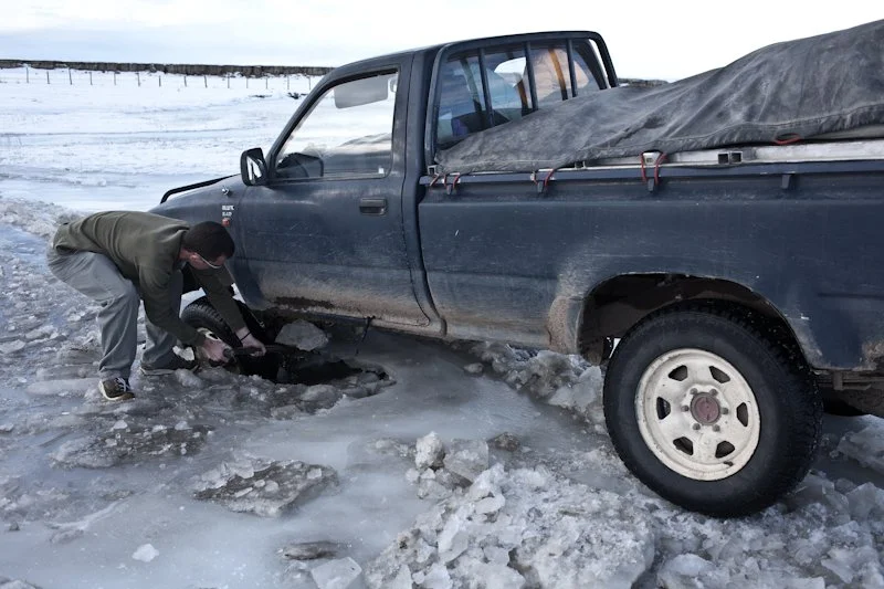

On the very start (deceptively nice, it soon became highly arduous) of the 1200 kilometre Lena River Ice Road.

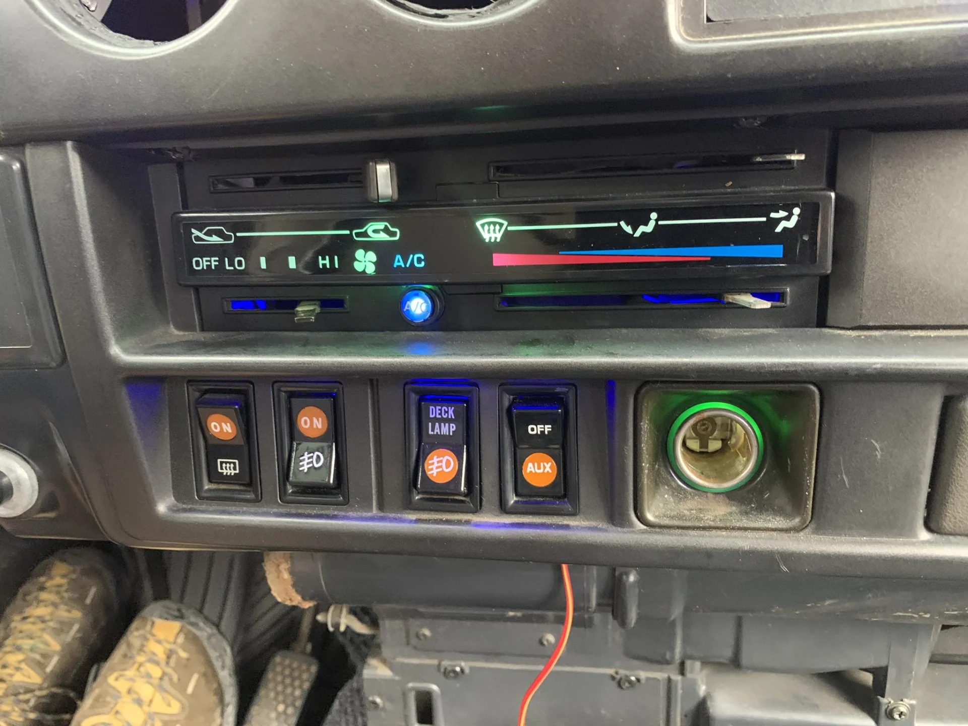

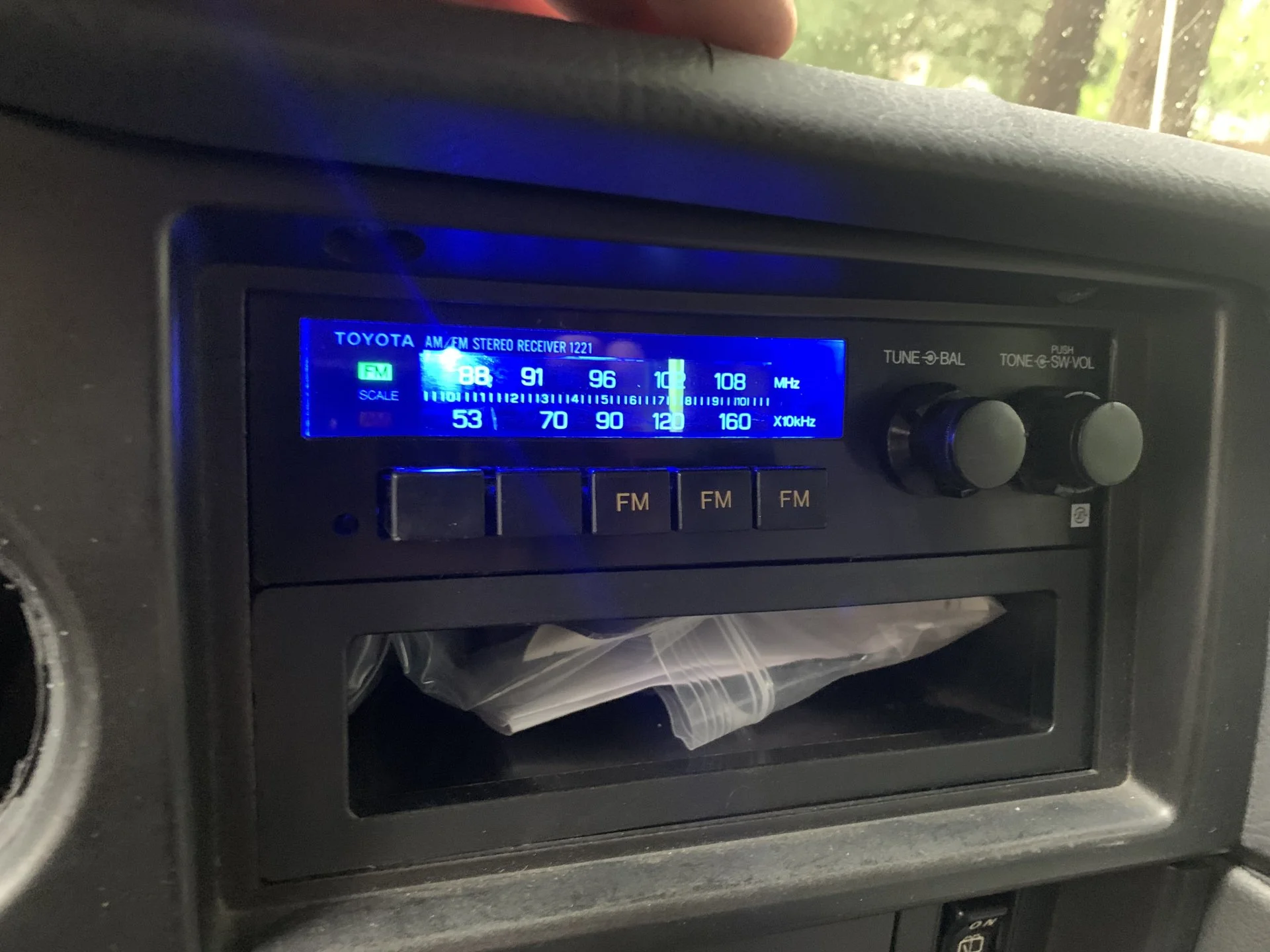

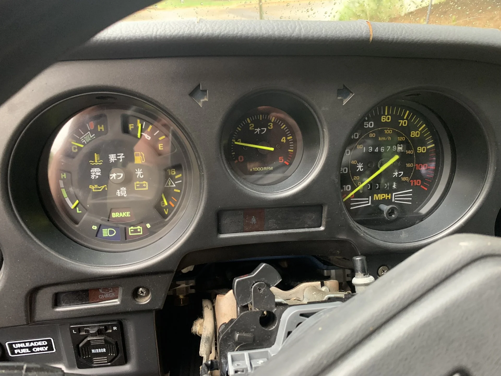

i am looking for some inspiration for my new to me 10/88 FJ62LG-PNEK w/ MTM conversion and a 86 FJ60 Front end conversion to ramble 2 main reasons it became mine less then month ago or so ........
would you be so kind as to post a few good general photos of your complete dash area and maybe some close ups of anything NON-USA kool , like indicator lights , or
anything un-common or un-0known to me potentially ...
i recently installed a FJ60 steering wheel and ditched the 10/88 AIR-BAG looking one ,
so if its a period correct sorta era JAD market feature i would love to see it please
here is a sample of where i am going , with the total end game theme , i did all the finite detail scroll work by hand with a traditional Quill and some SUMMIT racing speed-o needle paint they offer
thanks for sharing and thanks in advance for any kool rare options dash and interior photos

Hi Matt
Thanks for your reply - I admire your passion and craft!
But I'm afraid that regarding my BJ, you may be disappointed. Whilst the Japanese market seems to expect a lot of (in my opinion often useless) accessories and features, this General Market model was aimed at the exact opposite. This was a work truck, aimed I think at mines and oil companies and it would be fair to say that if Toyota could leave it off this model, they did. I will post pics of the dashboard in the near future, but the only thing unusual about it will be what it does not have; blanked-off tacho port in the instrument binnacle, blanked-off cigar lighter socket, no headlamp adjustment, no heater or A/C controls (so no red bar on the fan control unit), no passenger grab bar. This thing is basic!
The one interior feature unique to this model is a buzzer (in addition to the usual light) to indicate that the water trap in the fuel filter housing needs draining. It comes with this nice sticker (P/N 23923-56010) on the driver's side window and a buzzer (P/N 86650-90A00) mounted on one of the dashboard braces, right next to the wiper control relay. No other Toyota model had these! I guess this tells you about the quality of diesel storage in SE Asia :D
I can't think of anything else really, though no doubt you'll spot things which were not US market supplied as we go along.

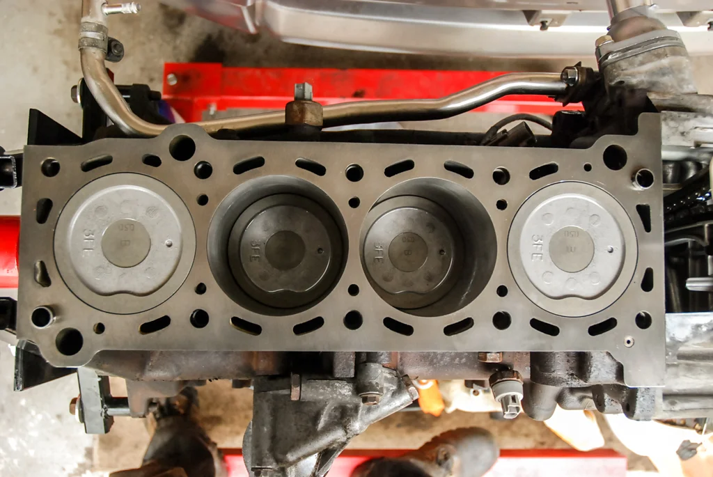

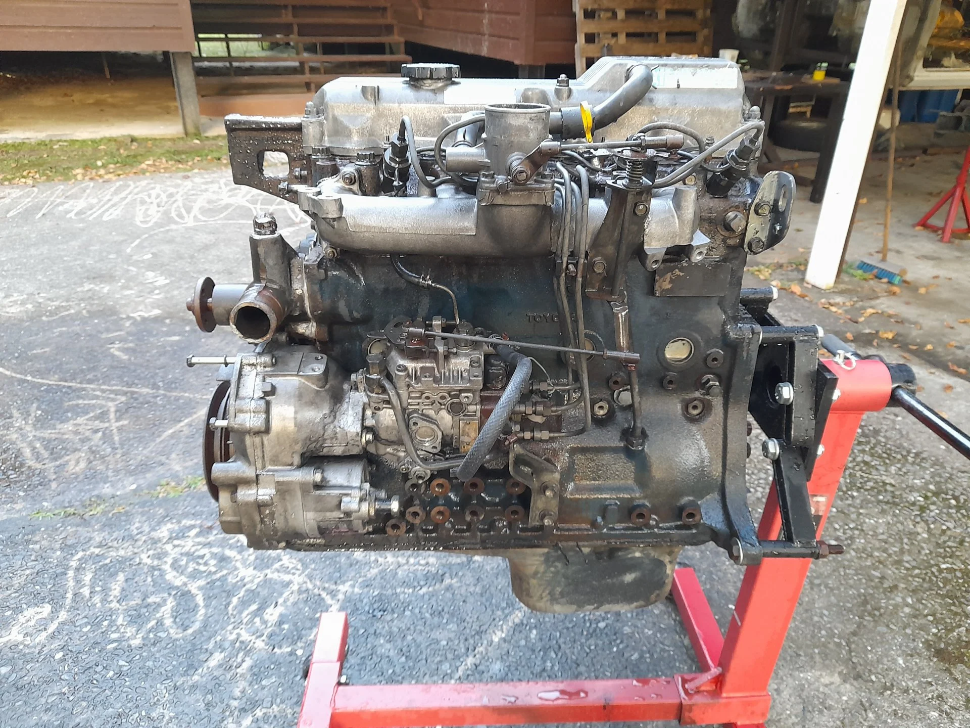

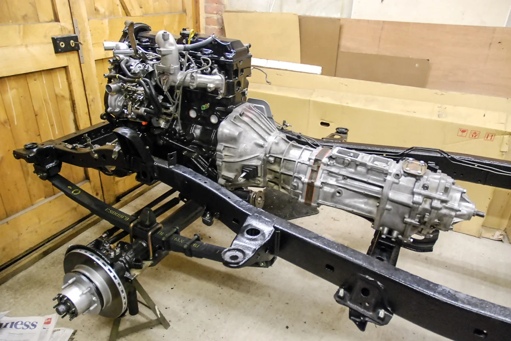

Here is my venerable 3B, unofficially known as a 3Bii, or blue-block 3B. Not bad given her 567,000 kilometre service (original engine, matching numbers).
The block of this engine is identical to the block of a 14B (same for the valve cover). You can see in the first photo where '14B' has been machined off. '3B' is cast into the block but obscured by the diesel delivery lines.

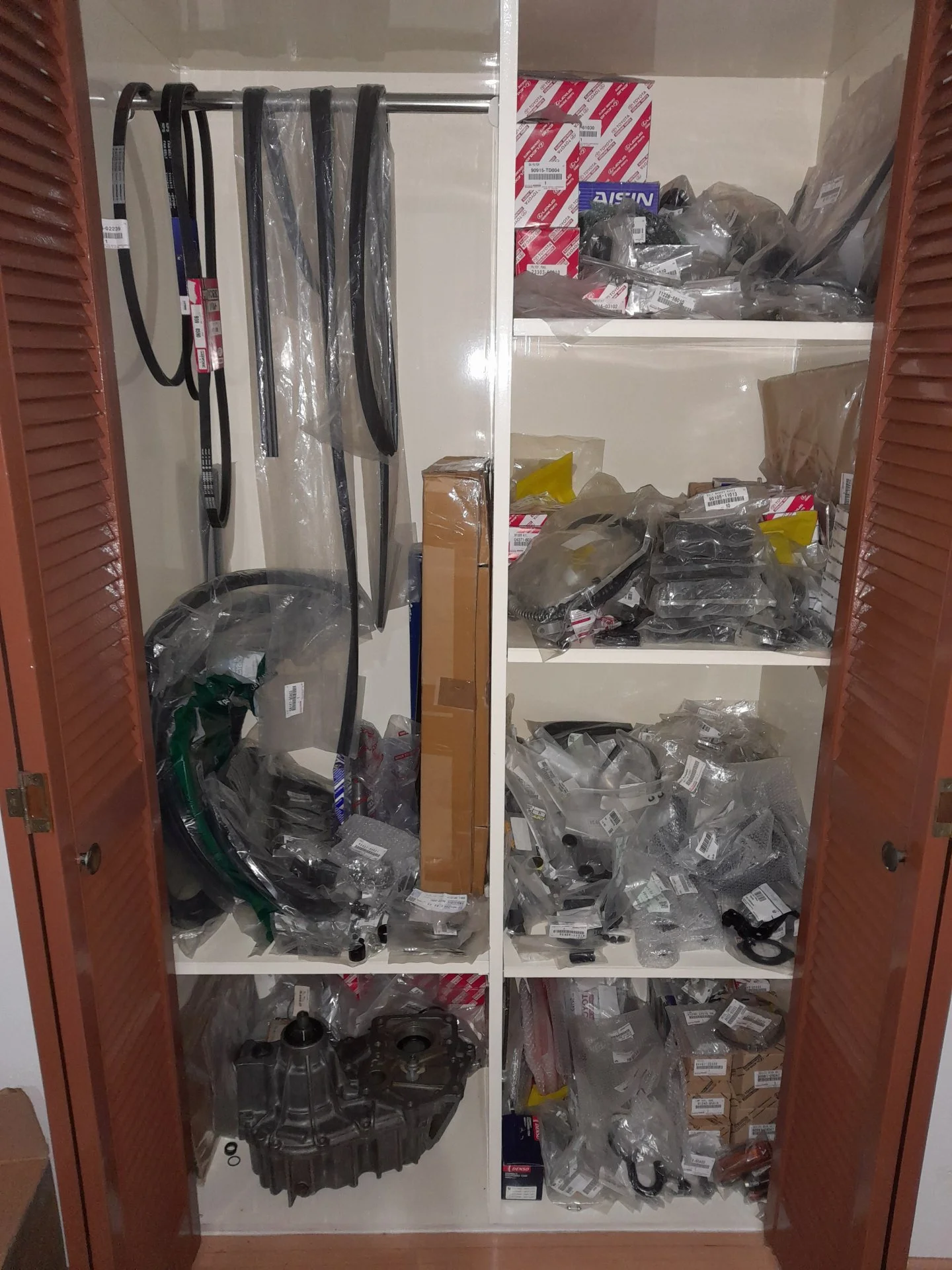

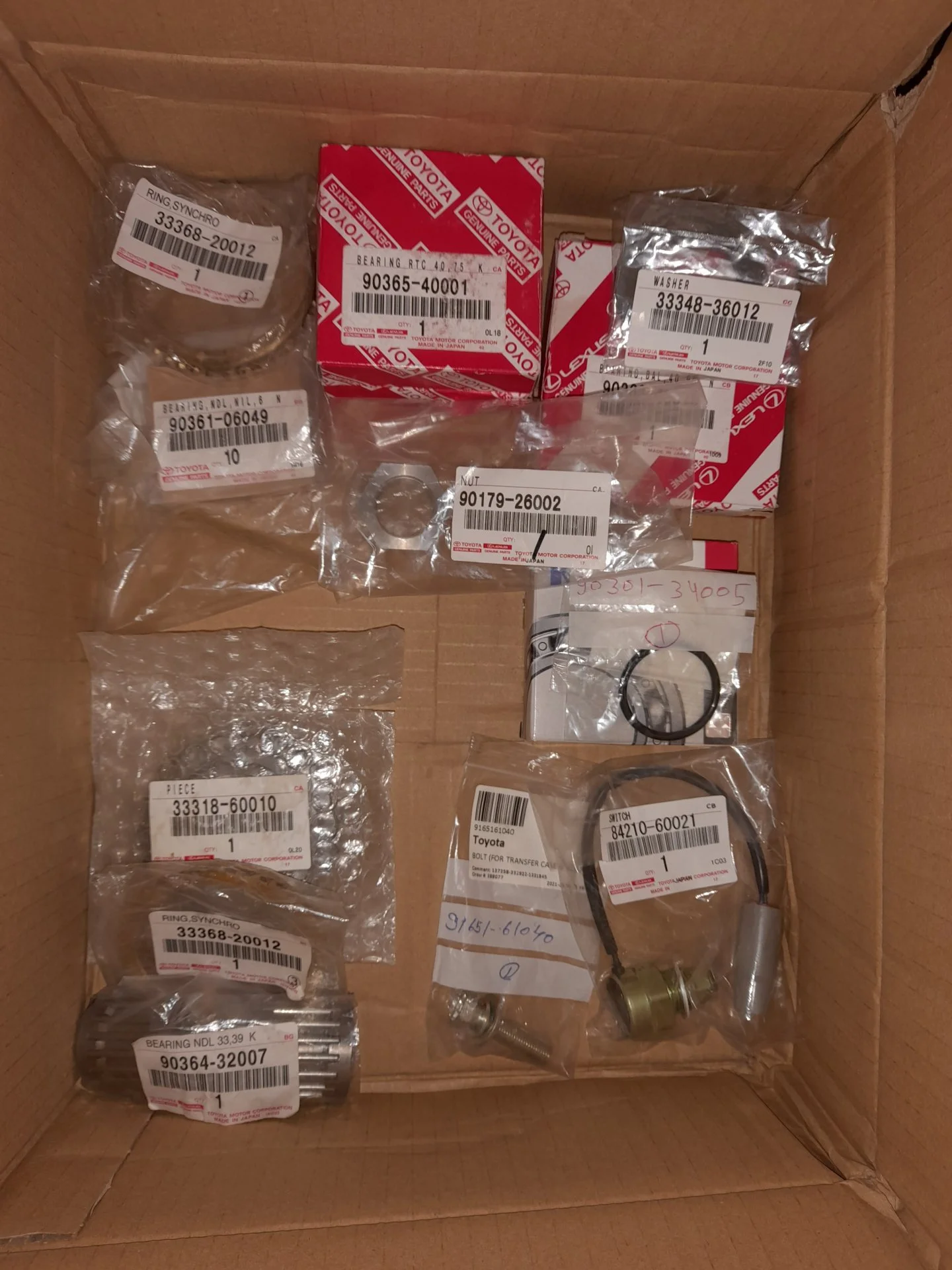

Genuine / OEM parts
We all love genuine parts! Toyota's are great not just because of their design, but because of the quality of components used. A Land Rover is quite a well deisgned vehicle (let's face it, better suspension than a 60), but the dreadful compnent quality means they are turds. It's just not worth using anything other than genuine parts in my opinion. I probably take this a little too far (even genuine fuses), but frankly why take the risk with something probably made in China?

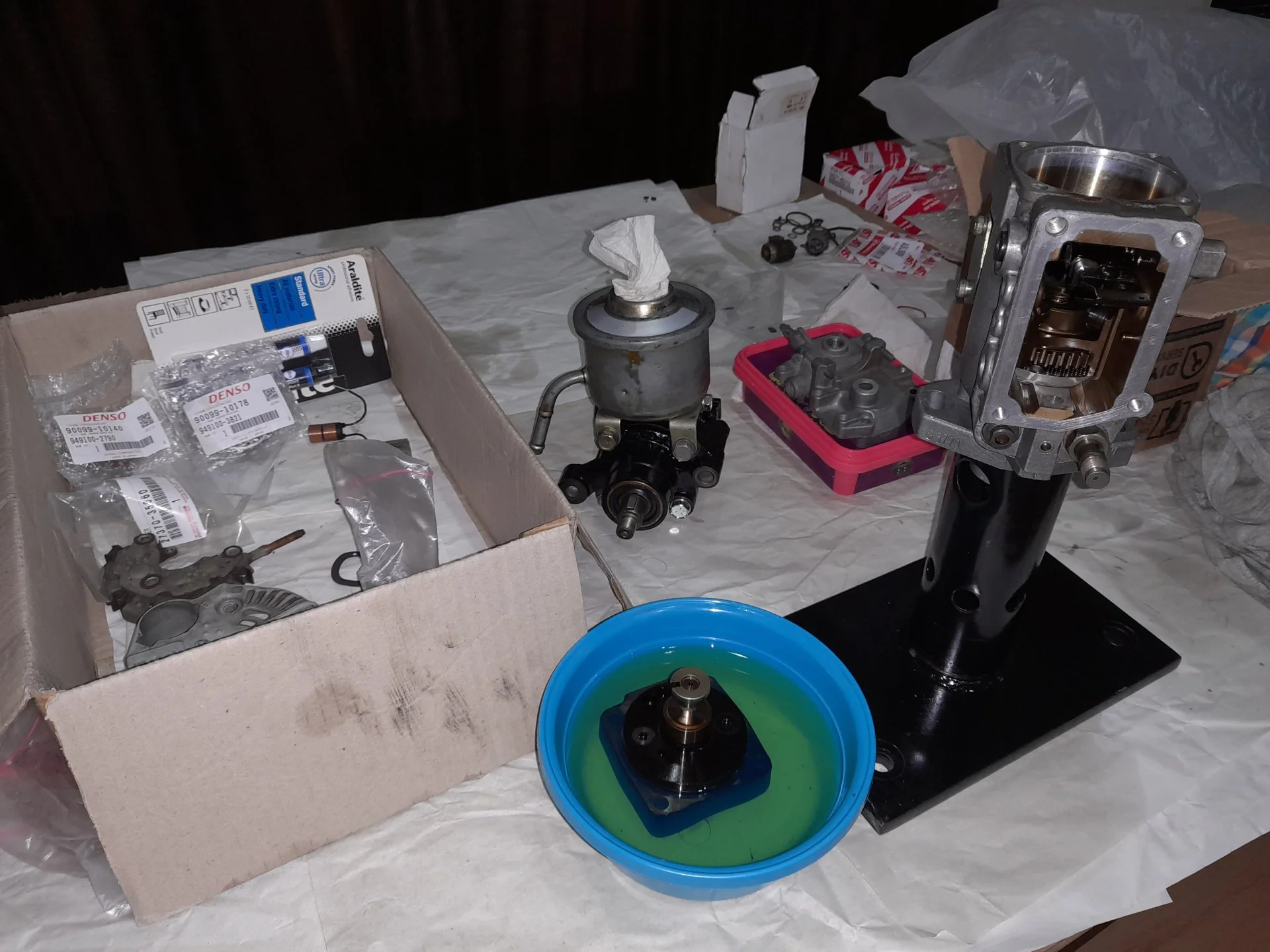

Here is my genuine part horde. On the right, the four compartments are ordered according to sections of the EPC.
-Engine/fuel - new water pump, cooling system hoses and reservoir, bits for the starter, vacuum pump, alternator, diesel injection pump etc
-Powertrain/chassis - everything for the H55F, bearings for diffs and wheel hubs, suspension shackles and bolts, all brake hoses, brake master cylinder, handbrake cable, cluch master and slave cylinder etc
-Body - new bumper ends, door handles, body mounts, grab handles, door knobs, driver's window winder etc
-Electrical - remanufactured A/C compressor and other parts of the system, speedo cable, new H1 headlights, interior lights, rear view mirror, various sensors and clips and clamps for the wiring loom.
On the left are larger items - A/C condenser, steering damper, weatherstrips, belts (one Pitwork Nissan OEM). A few parts here are non-OEM I must say (CityRacer windscreen surround and rear opening weatherstrip, Joint Fuji propeller shaft parts). Bottom left is the transfer case ready to go onto the transmission, once I complete that.
Midway through an H55F build, these are the parts which are still to go on (I need to make a tool... more later)

Here is my living room table (can you tell I live alone??). I'm waiting on a part for the injection pump (ironically for a diesel, I could only find this part in the US), steering pump rebuild done, alternator still in parts as I made a 'discovery' as I was about to reassemble it...

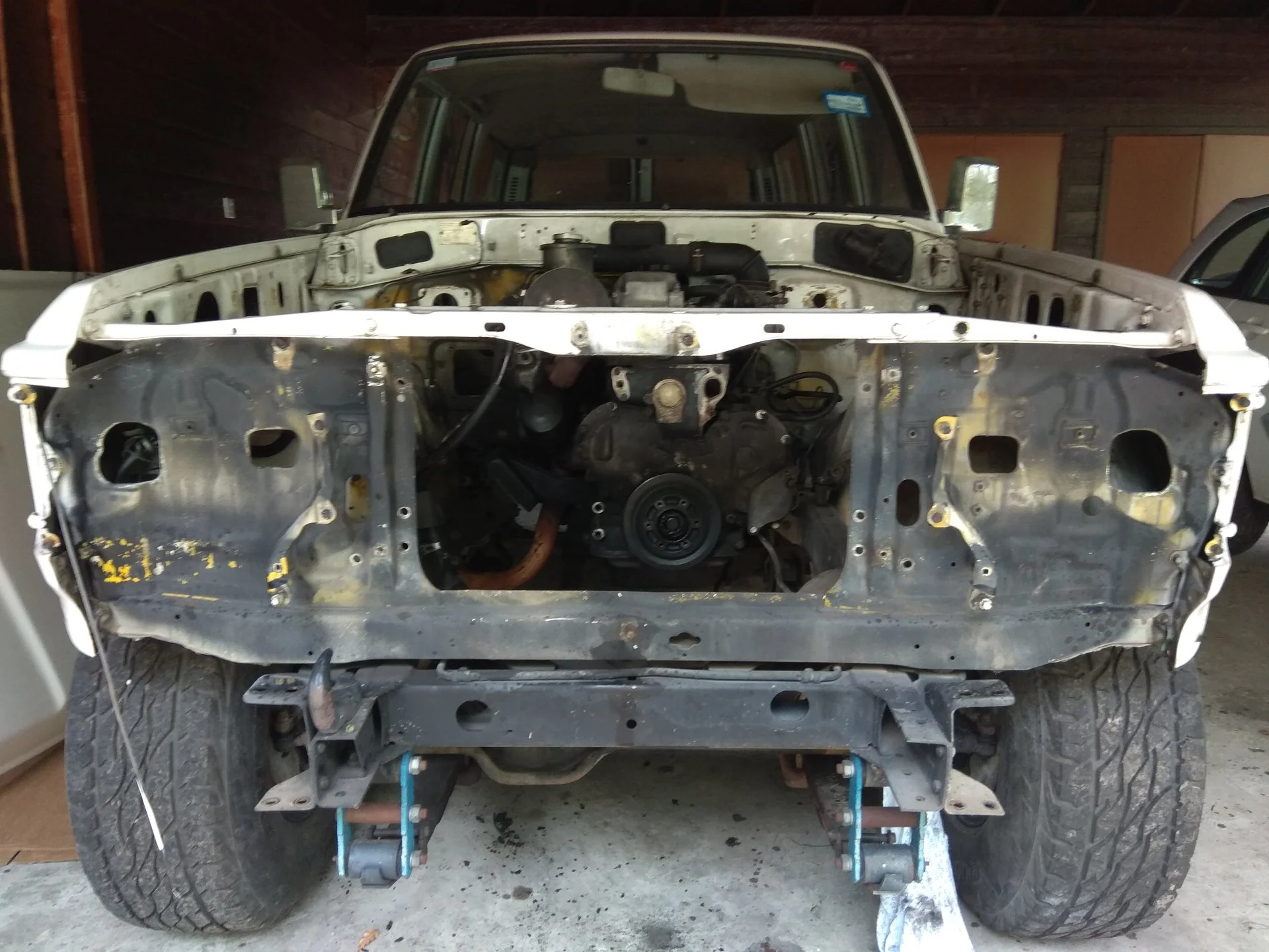

The dismantling begins

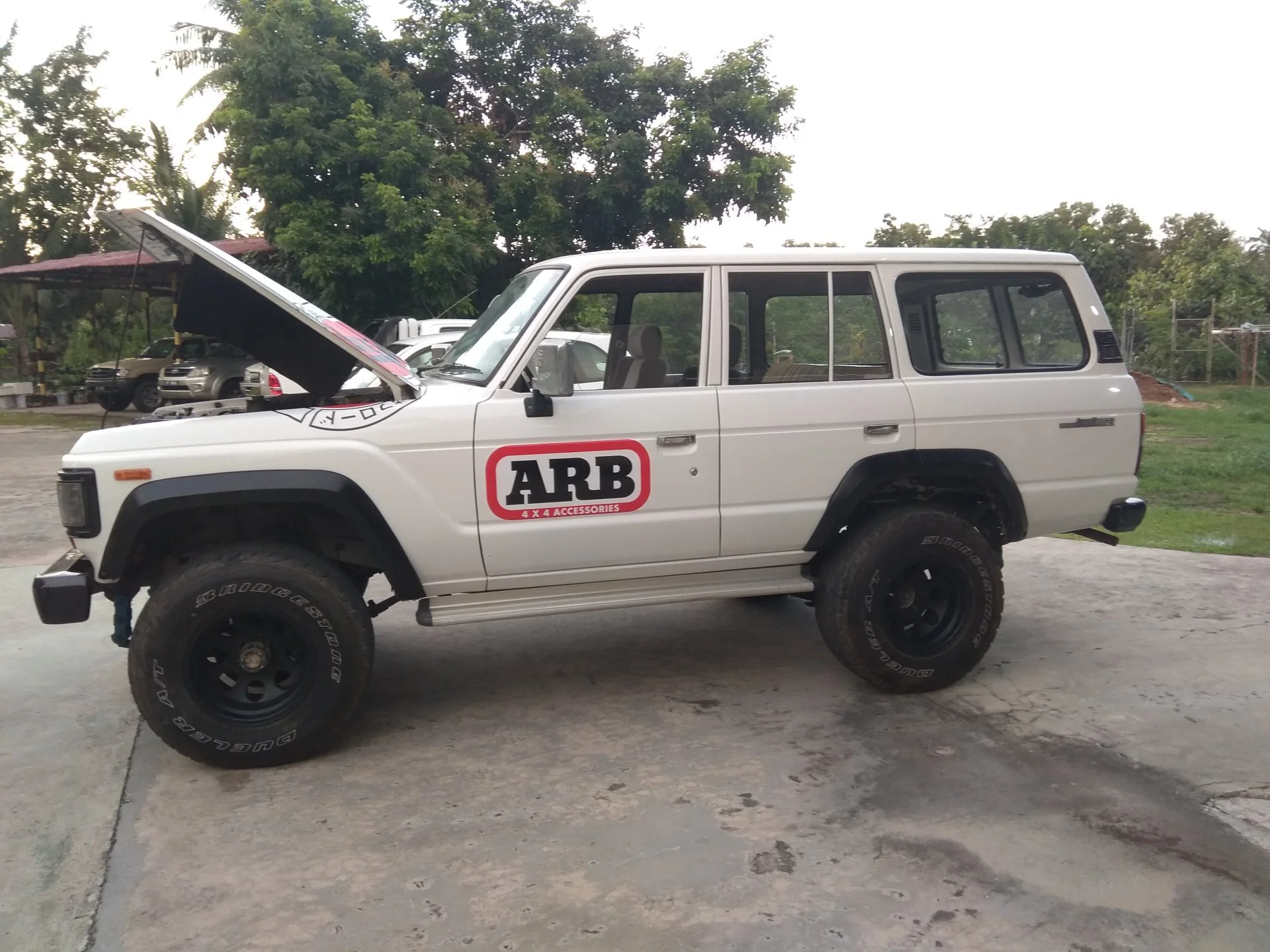

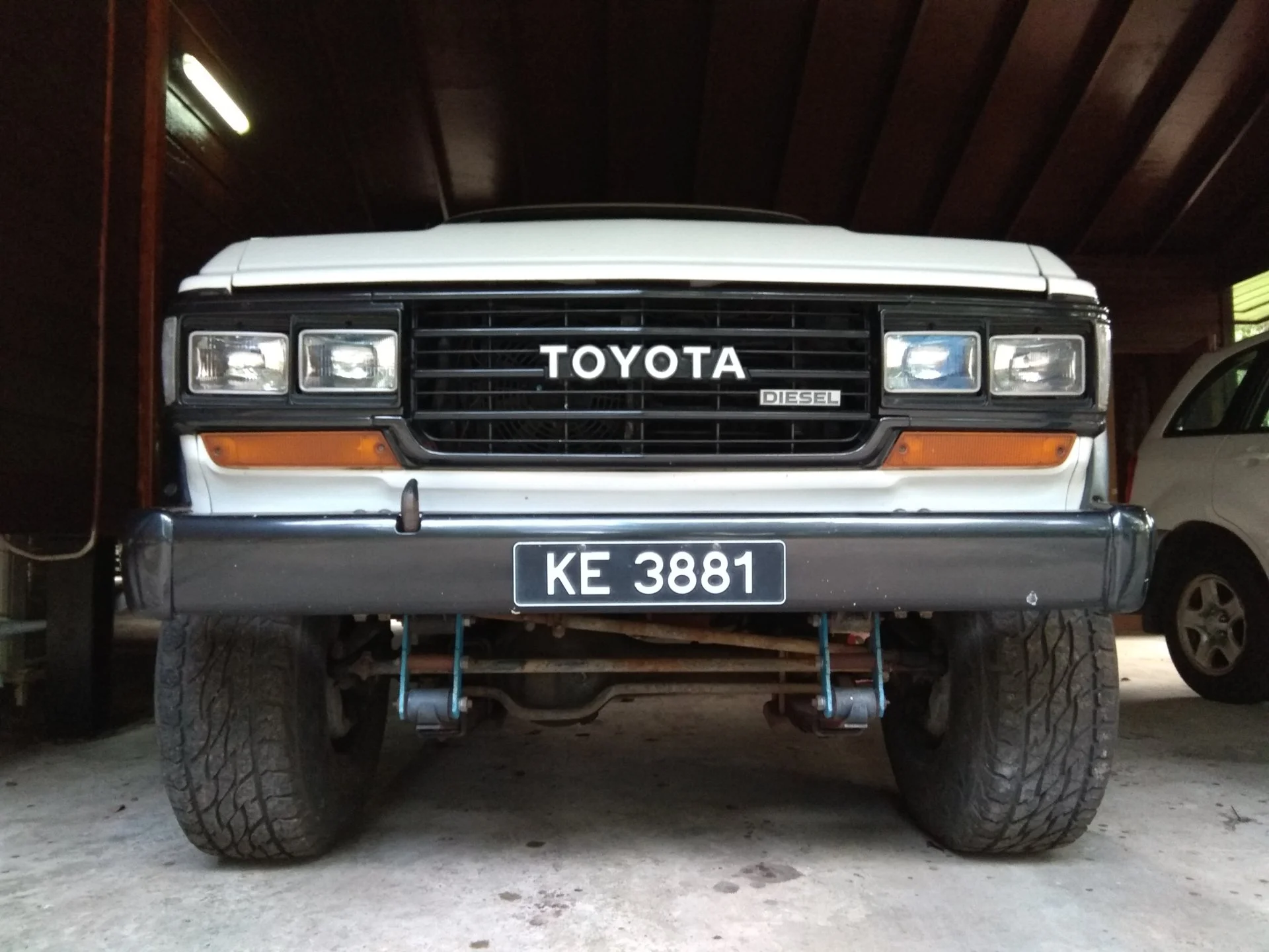

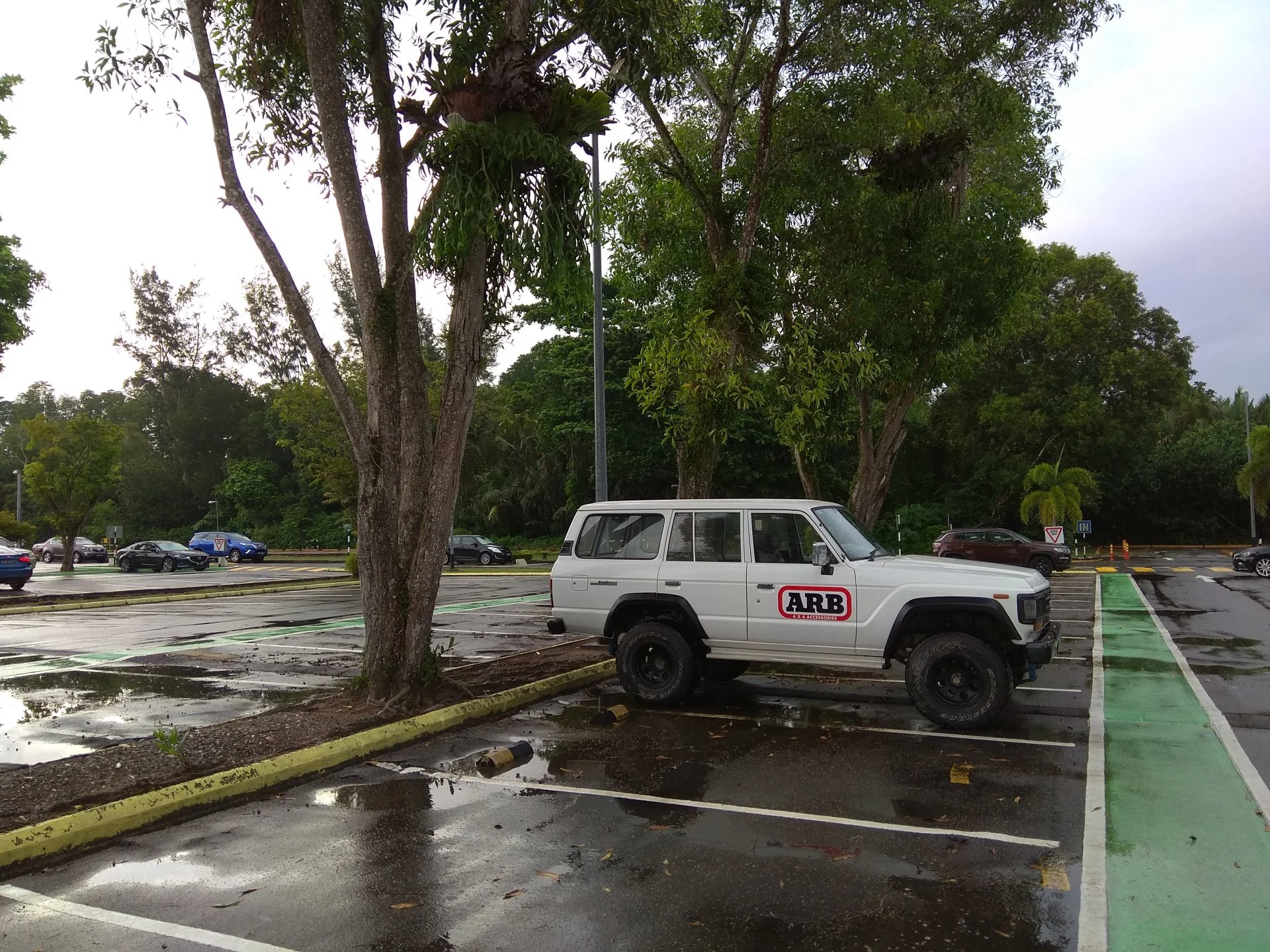

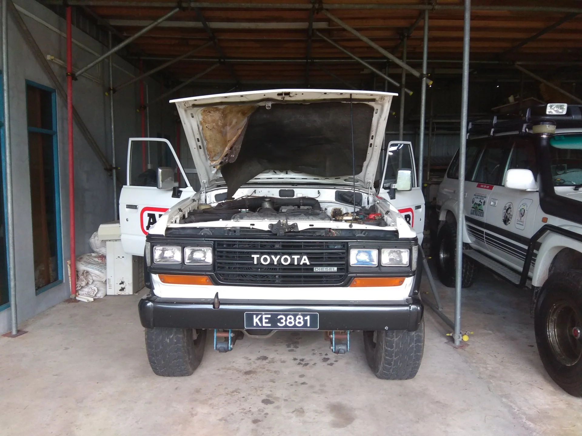

I think this is the only picture I have of the car 'out and about' - in the office car park.

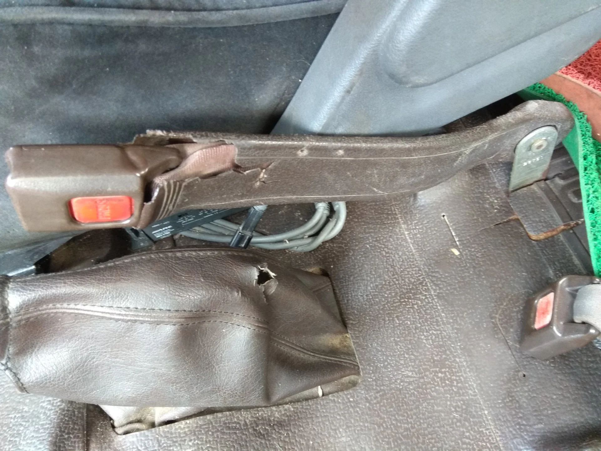

The car is too high (extended shackles), the wheels are too large and wide, rims require spacers on the wheels. Those are fibreglass arch extensions bolted onto the originally non-flared arch body. All this has to go! I love the lines of the non-flared arch 60 and think the later factory wheel arch extensions look awful. These aftermarket ones are just as bad!
Interior is worn and looks horrible.

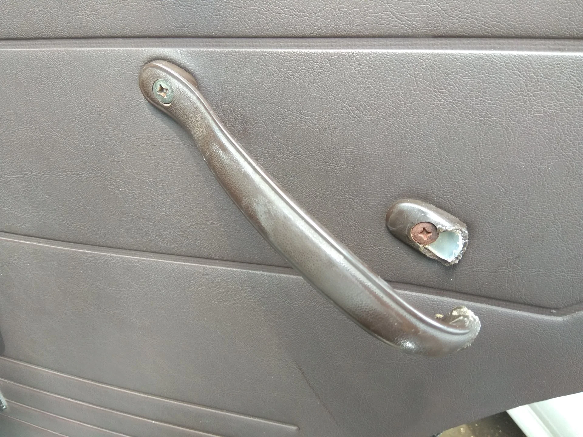

This driver's grab handle is nasty and starting to disintegrate.
This absolutely basic scpec of BJ60 comes with 40 Series style grab handles, though this one has expired. Sadly only black ones are available now, brown are NLA :(
These bits have seen better days...

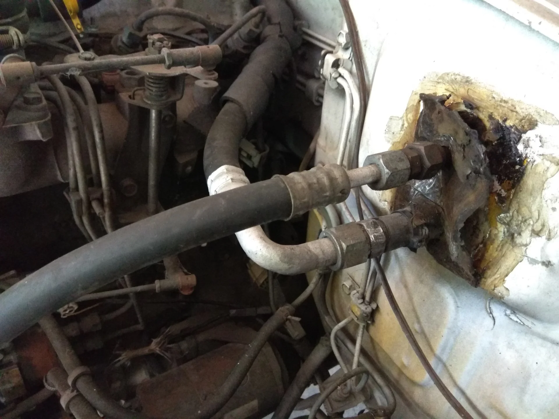

The previous owner (in good faith) told me that the car had A/C from factory and I did not look too closely at it. For all I know, it might indeed have been fitted by the dealer.
The first sign that something is not right, aside from the system not working (ignore my glowing hand) are the controls. There is no A/C button on the HVAC controls, only a rotary switch similar to that found on some 70 Series Cruisers that I have seen. This however is clearly aftermarket. OK, so I need the correct A/C switch. Maybe it had burned out... Notice the lack of a red bar on the heater controls (no heater from factory). The very sharp-eyed will notice that there is no lower foot-level vent on the heater box, and no asociated foot-level position on the directional selector slider. The cigar lighter is also blanked off. Curiously, it does still have rear window heaters! Unknown push button switch in the hole where a choke would be on an FJ60/(3F) 62. Previous owner's son thought it might have been a horn. Not a glowplug switch.

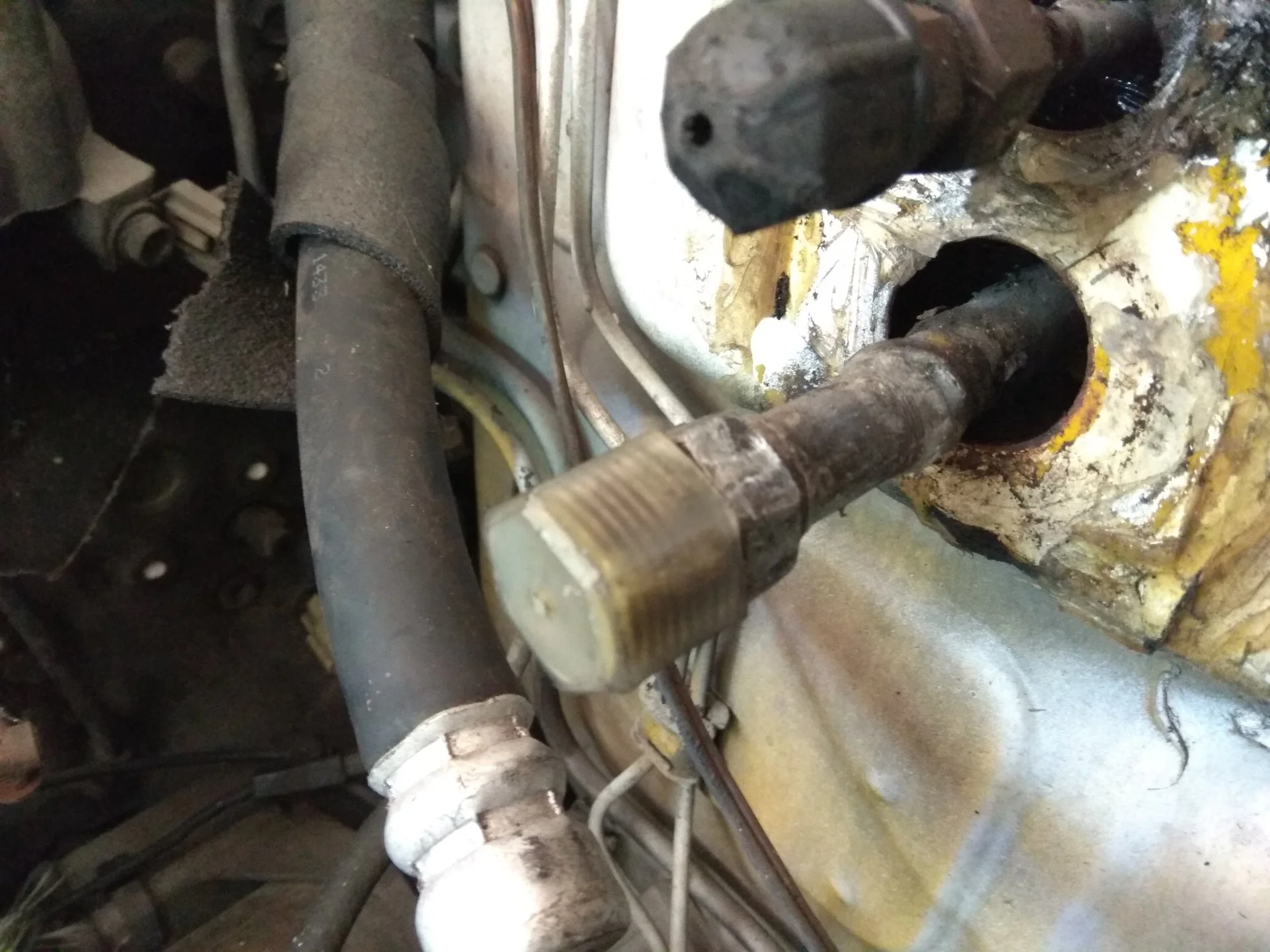

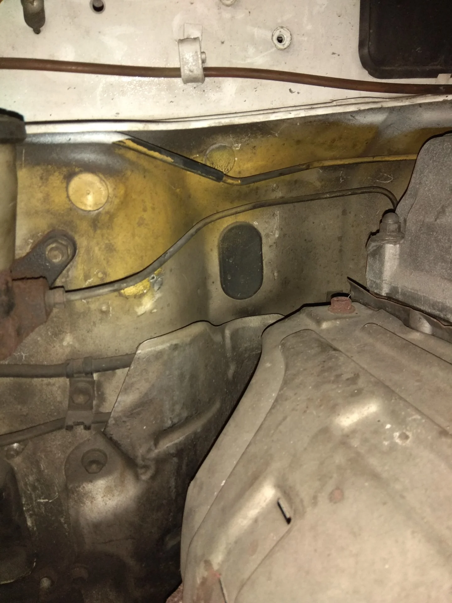

Let's take a look at the bulkhead...
They love adapters here! The 'seal' here is made up from a piece of sticky bitumen, stuck down with the favourite product of local mechanics: clear silicone bathroom sealant. OK, I need a new rubber gaiter.

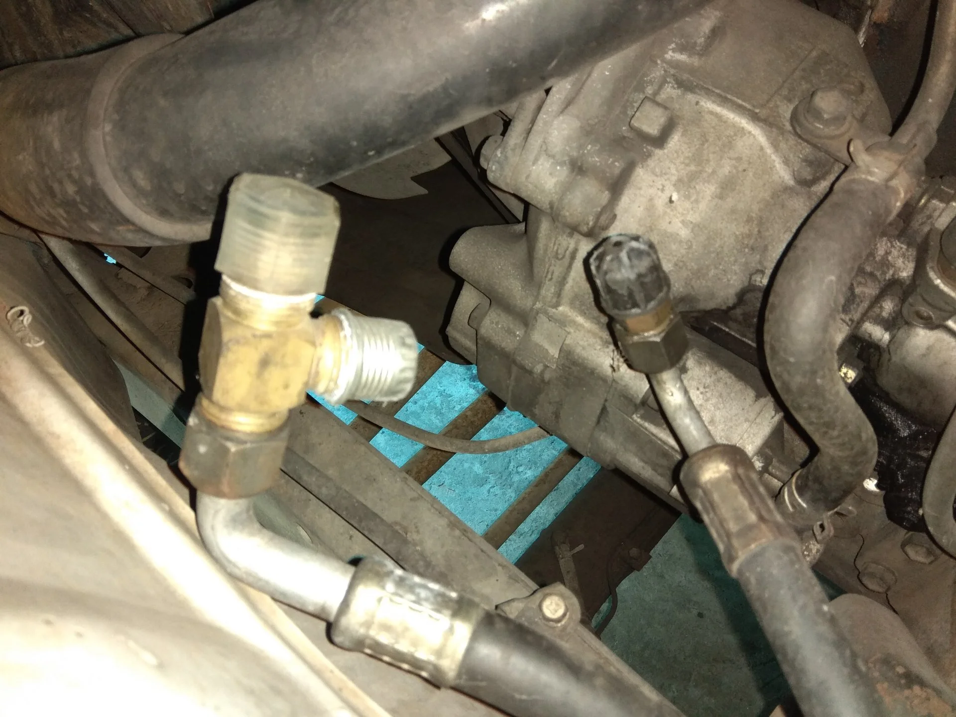

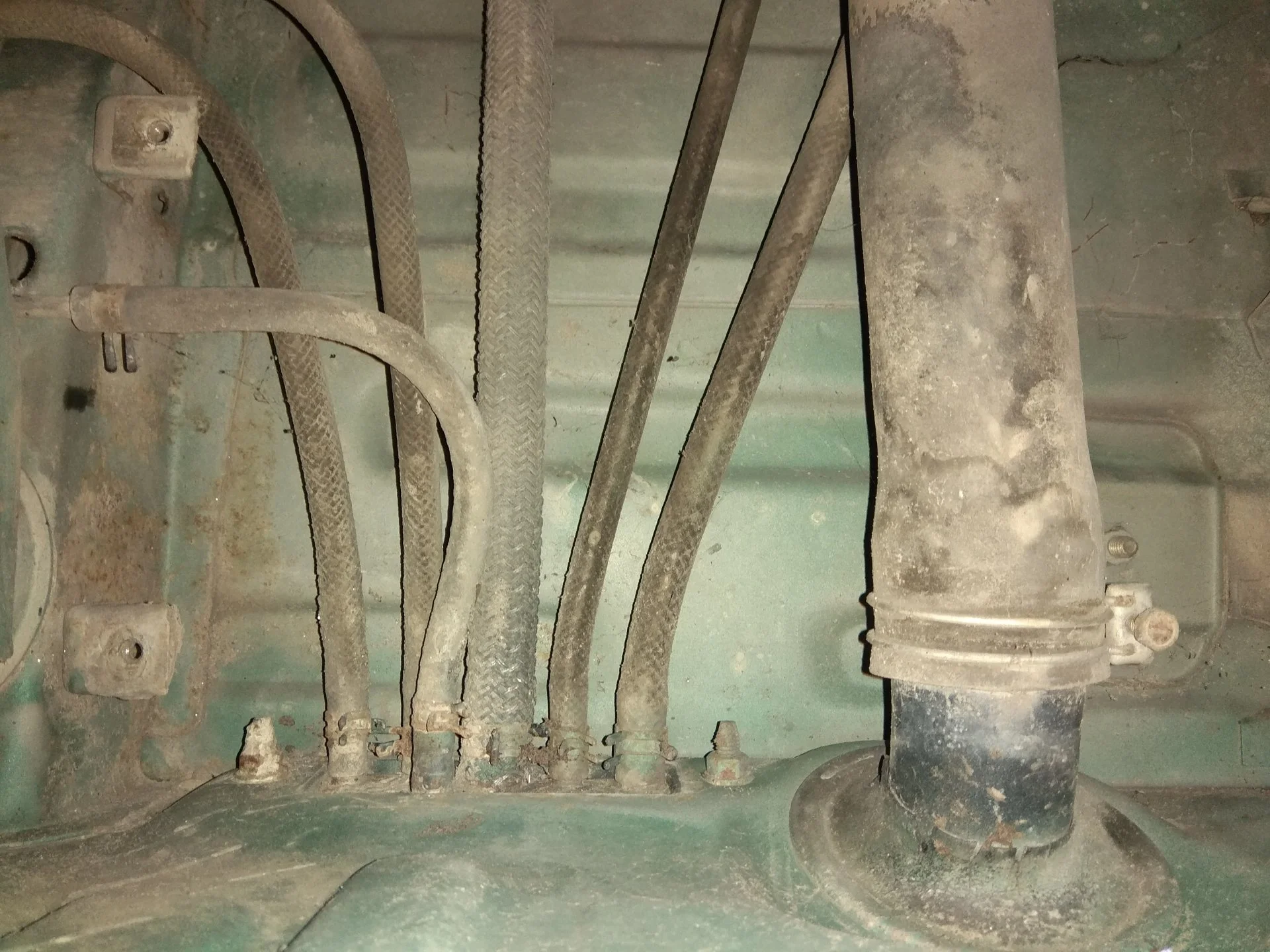

But what are these blanked-off A/C hoses on the left-hand side of the engine..?
Actually several metres of hose, carefully routed to the back of the car....

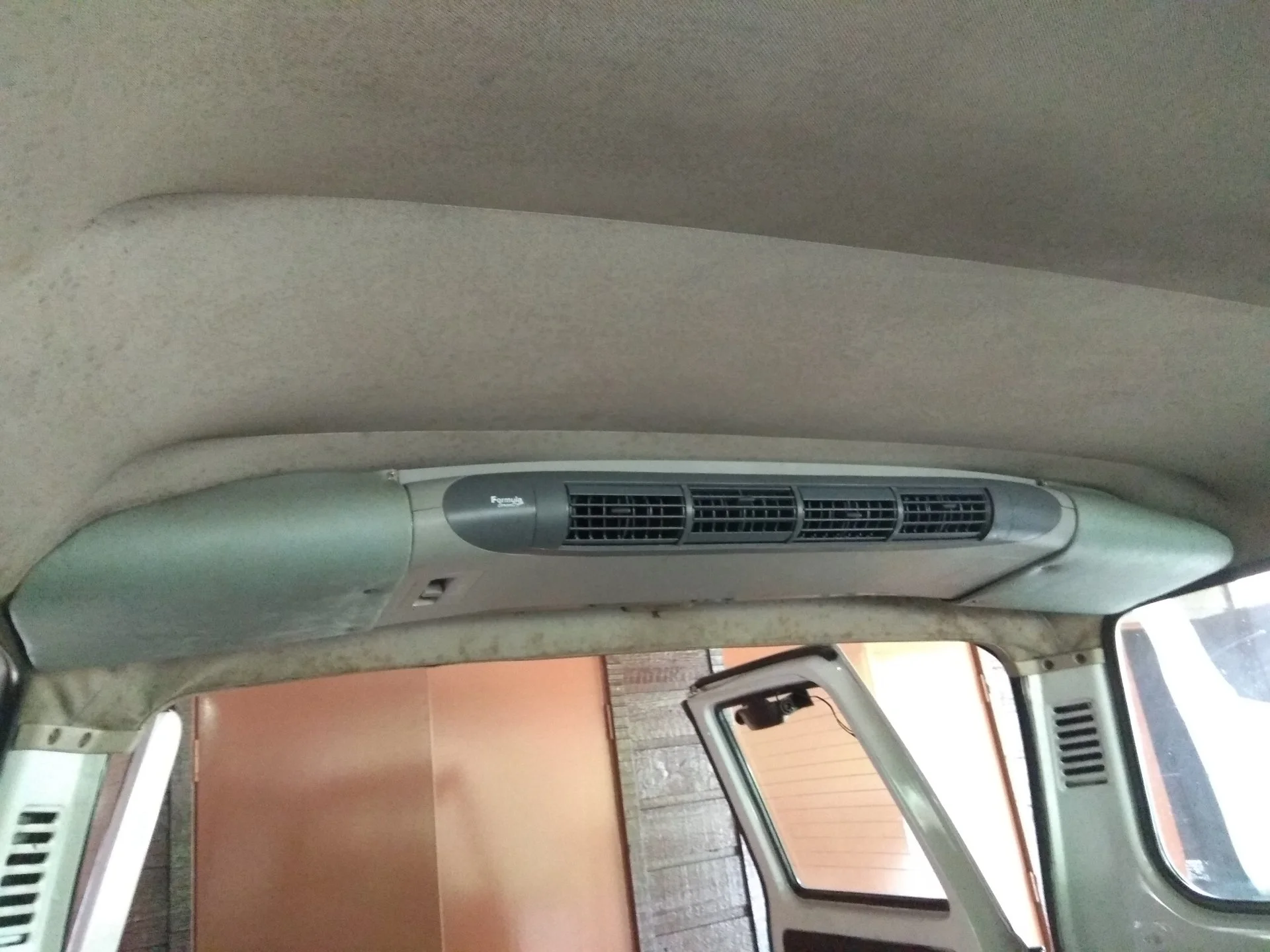

To this aftermarket rear A/C unit, which looks OK but has of course caused the head lining to be ruined (it's stained and nasty anyway) during installation. So I need a new head lining. Note that this ultra-basic spec has no plastic trim on the rear pillars and window surrounds, a bonus in my view.
Here you can start to see where this build is going. Literally anything that local mechanics have touched is a mess and needs relocating to a dumpster!

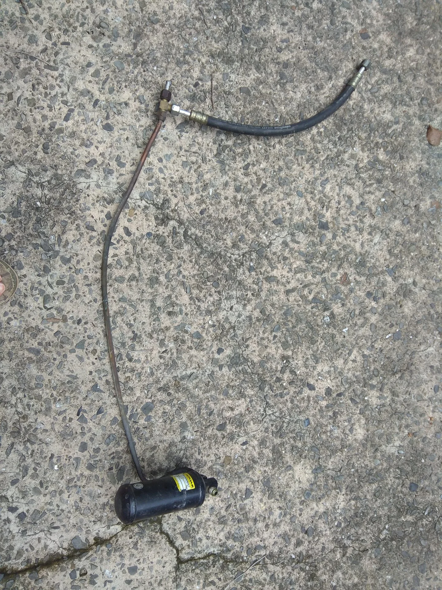

Air conditioning 2

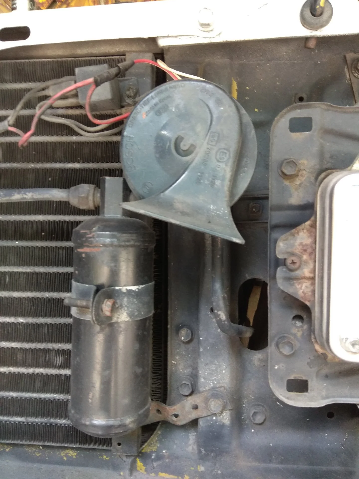

The A/C dryer on my Hilux Surf is mounted just here (though not with a twisted shelf-bracket), but in a 60 it should be above the front left wheel arch. So I need an original dryer bracket...
Dryer and high-pressure line. More nice pipework...

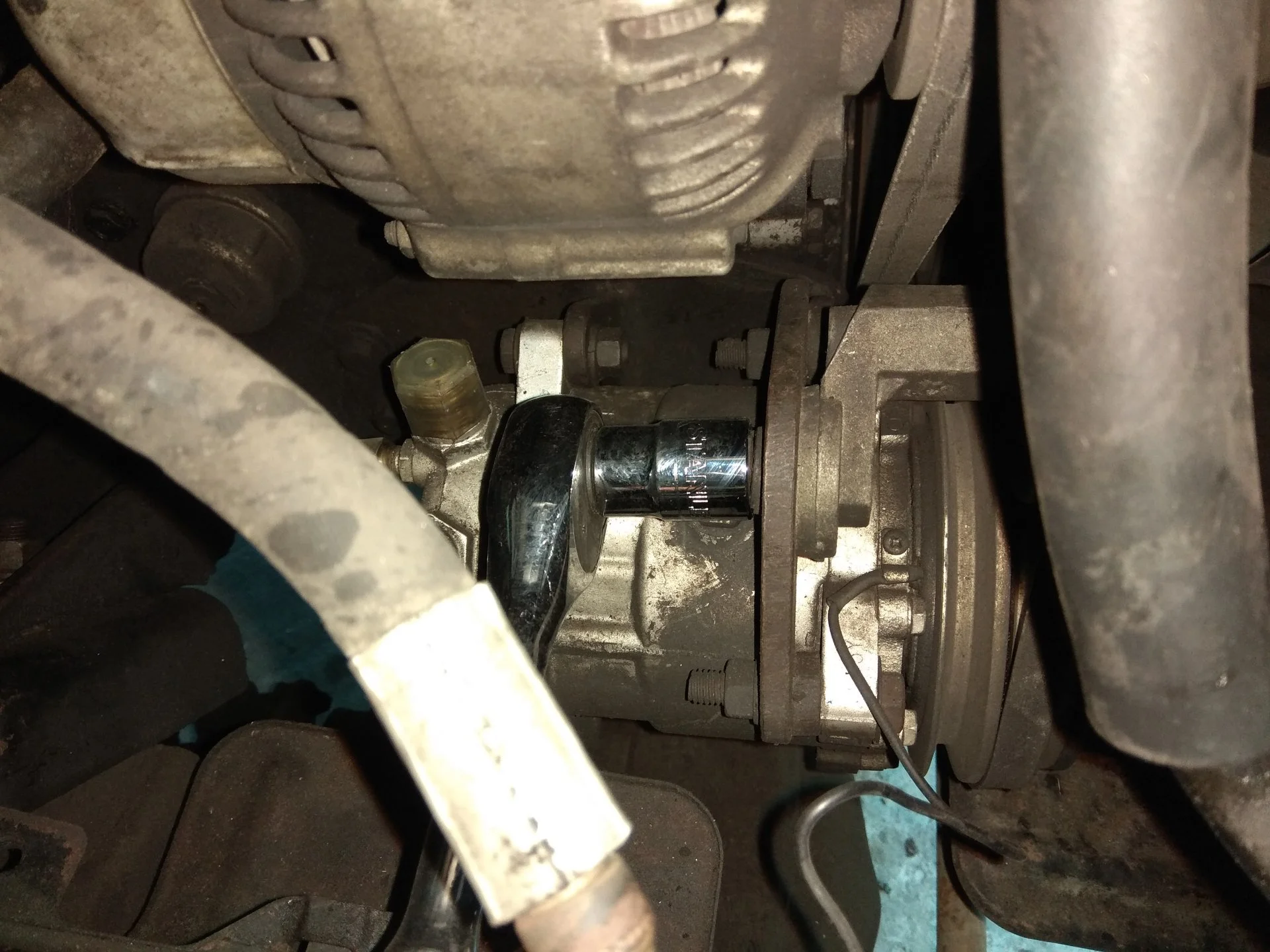

Taking the low pressure return hose off (note the additional hose on its way to the back of the car), I see the evaporator lines have been soldered. So I need new evaporator lines...

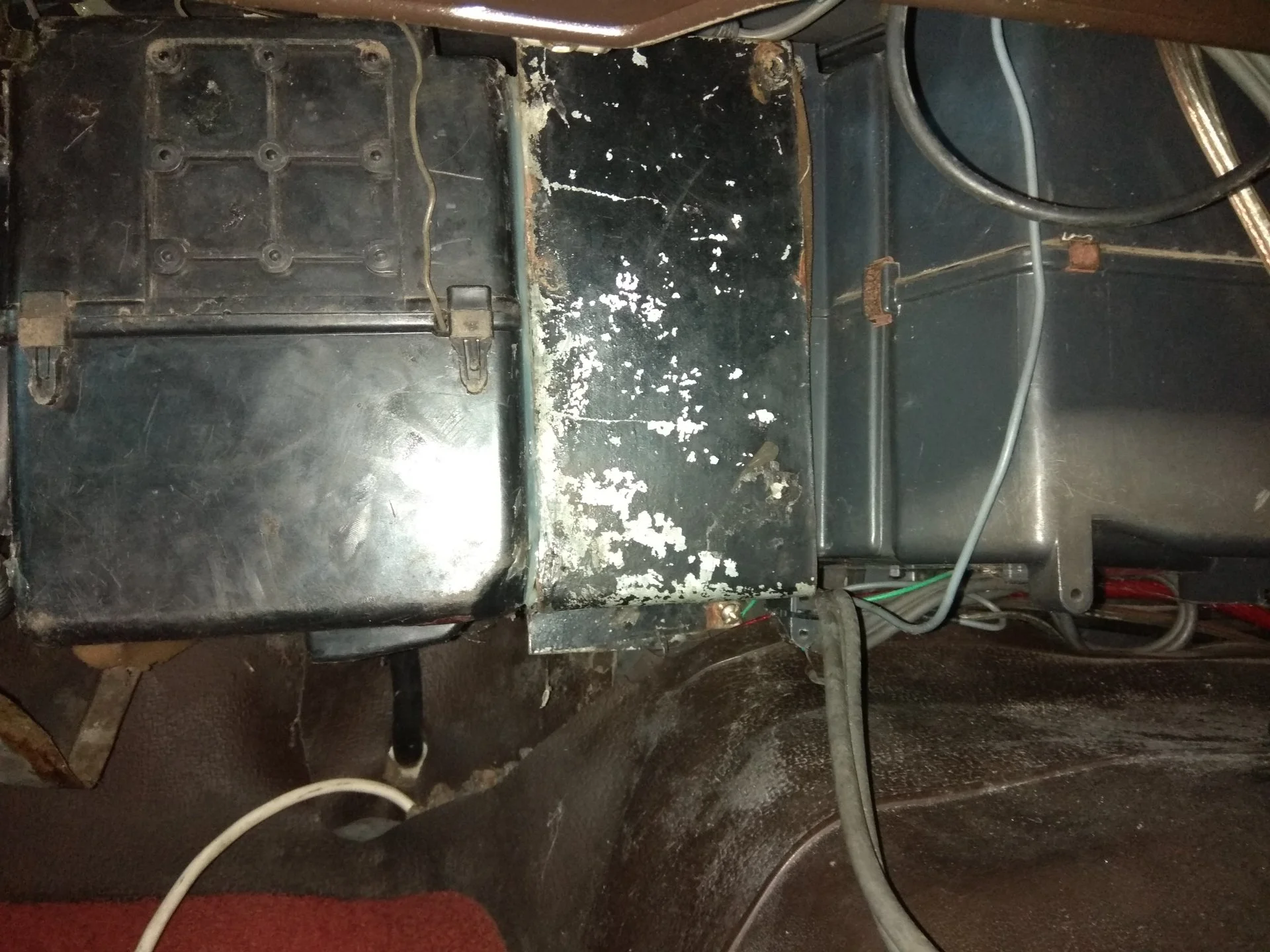

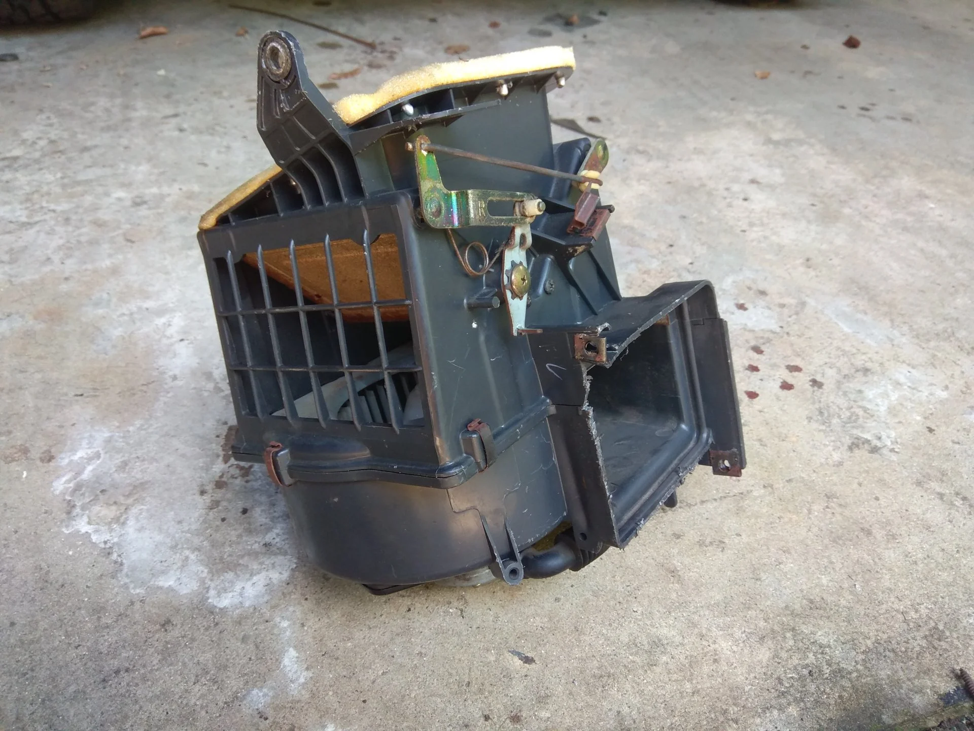

Speaking of evaporator, let's take a look down there... Oh dear. So I need a new evaporator box.
Well there's something! Whoever installed this mess at least put in a thermal cut out! (but no low-pressure cut-out switch). I guess that rules out the chance of having a hard-to-find A/C control board. Add that to the long list.
Peeling off the silicone and stuck-down sheet, a clean evaporator coil, but not original.
Just to make my life harder, these bodgers have jammed the vent shut in the blower motor housing, covered it with a tin and foam sheet, and sawn part of it off to fit their Frankenstein evaporator unit. The logic being that you always have the A/C running, so don't ever want fresh air. Nice. So I need a new blower motor unit.
I'm still foolishly hoping that the A/C compressor and virtually impossible-to-find compressor bracket are original. But no, there's some Sanden unit on there with a home-made A/C compressor bracket. And to add insult to injury it's held on by some stupid bolt size, 15 mm or similar, meaning I have to go and borrow a socket from someone with a full set. So I need a new compressor, a bracket, and a tensioner bracket and pulley.
Conclusion: this car did not come with A/C.

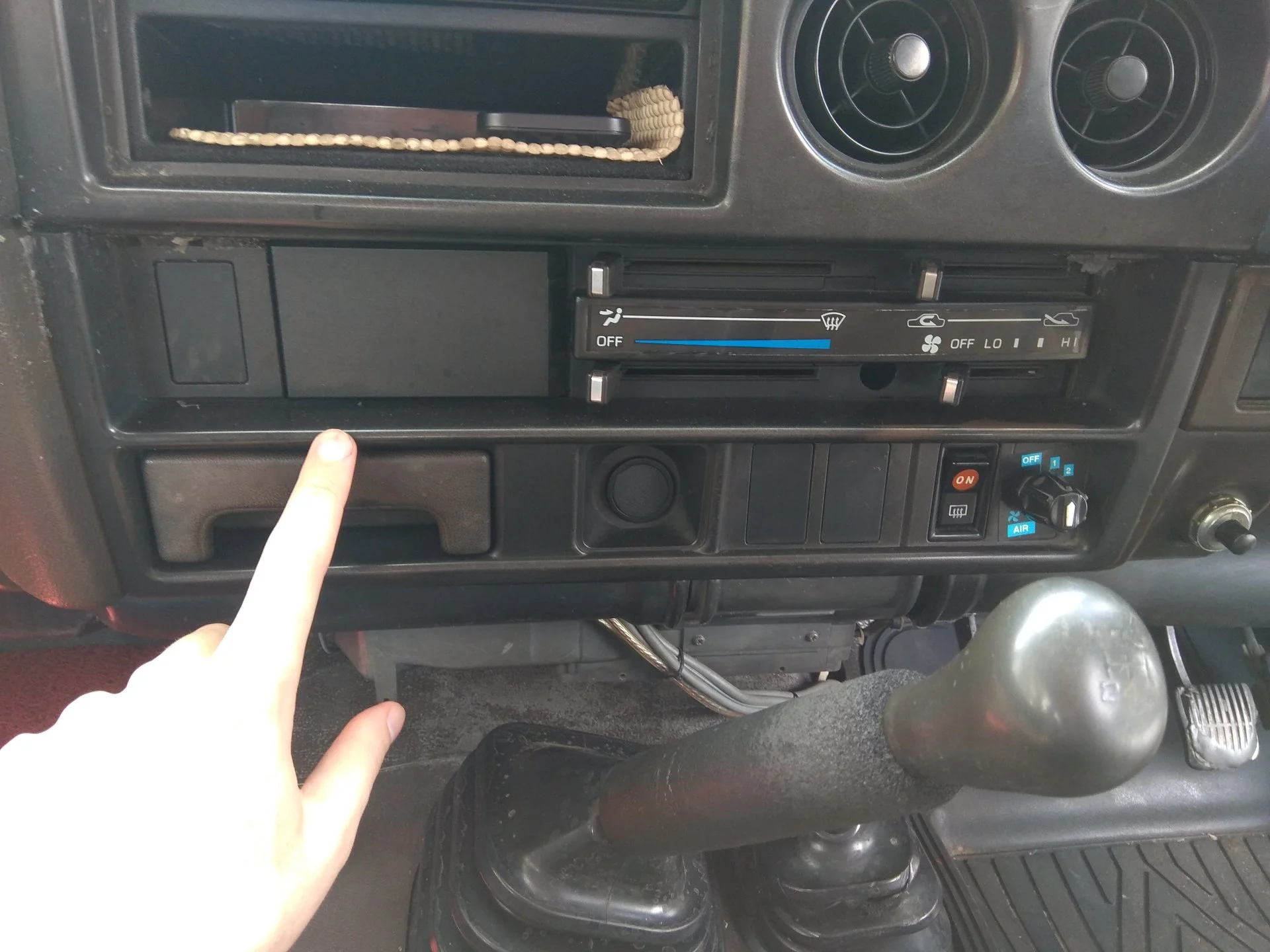

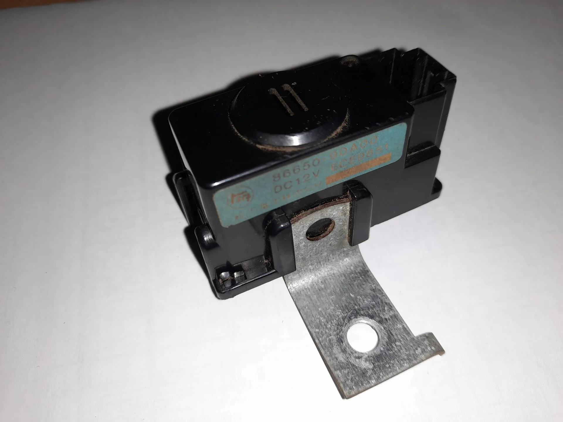

Where is my 'Boost Ventilator'?

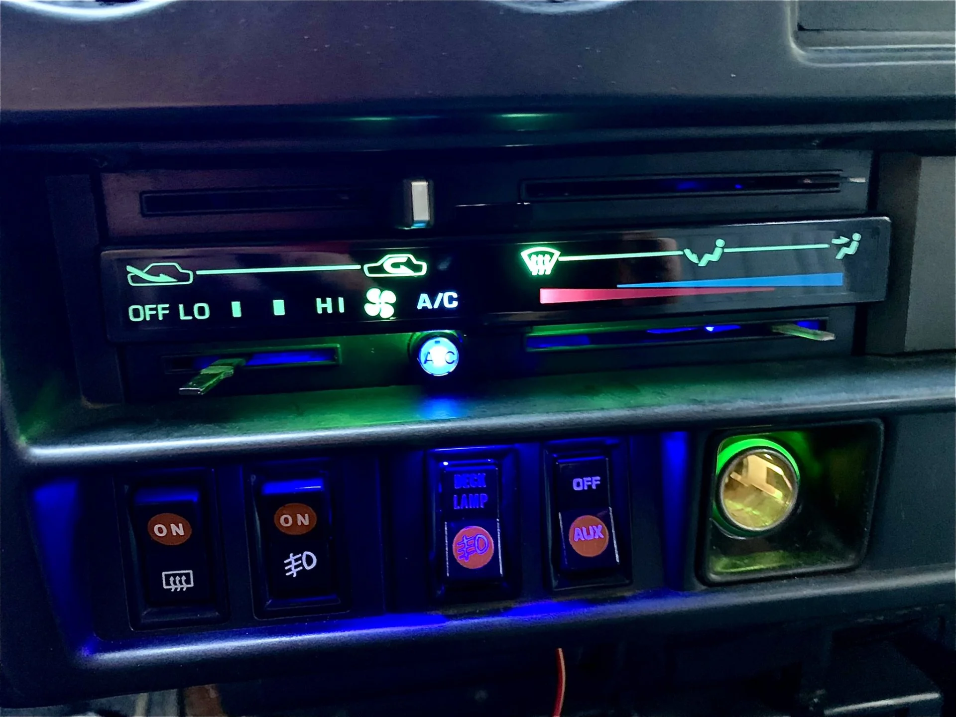

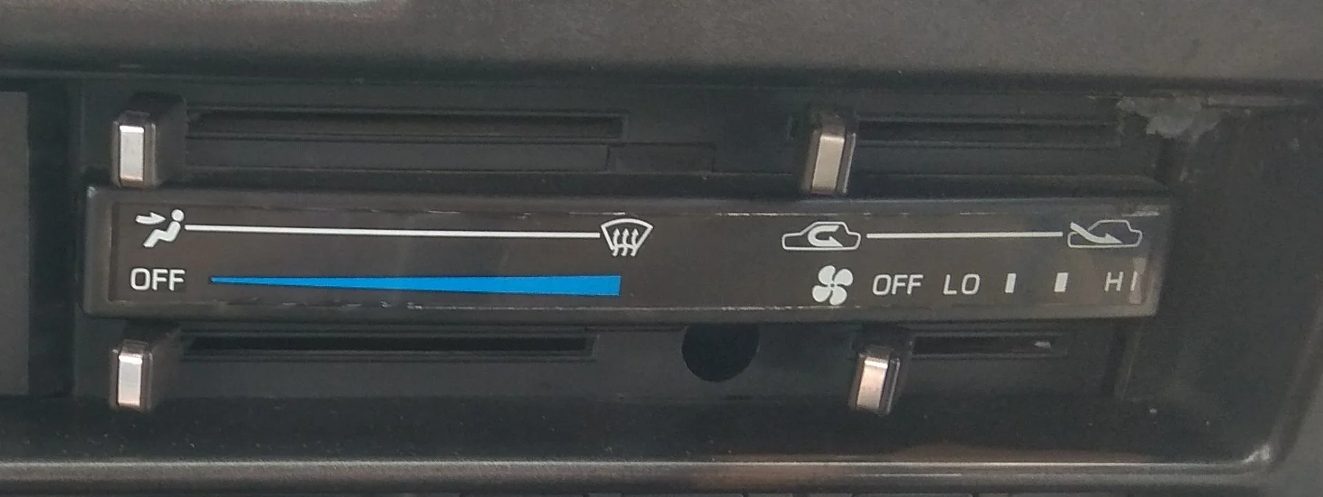

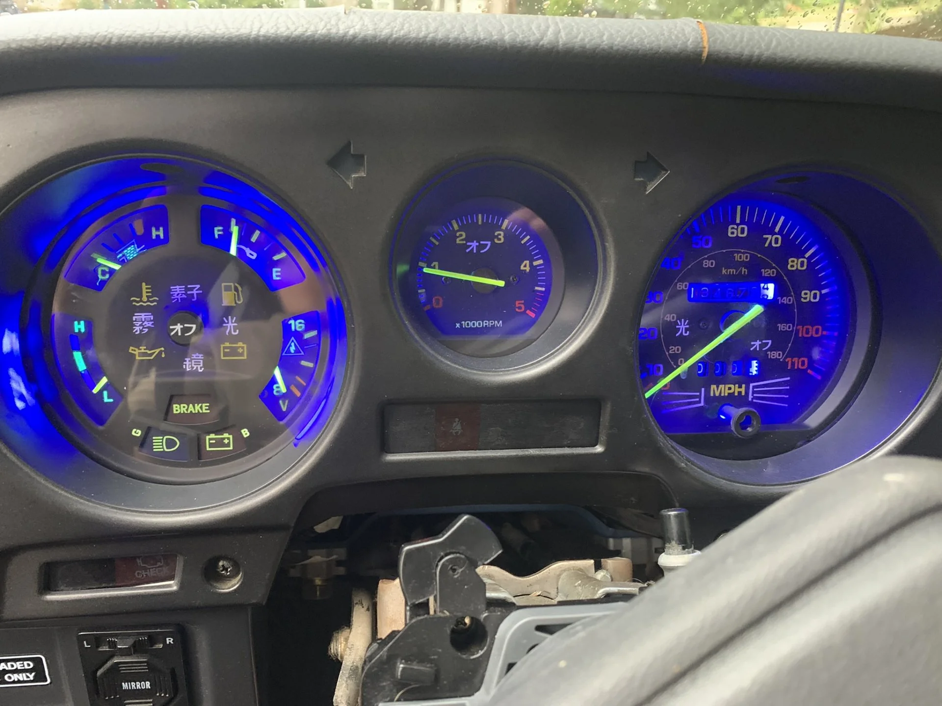

Take a look at this fan control fascia:
Pretty simple. No heater, no airflow to the feet, no AC. I guess it's a good thing that the windows wind down!
It took me quite a lot of time and thought to imagine what a 'Boost Ventilator' might be, where it is shown in the pictures, and where I might find it. After far too long it dawned on me that 'Boost Ventilator' is Toyota-speak for the fan, when not combined with a heater! What the 'Boost Ventilator variant does come with is a variable resistor on the temperature slider which I think must modulate the thermal cut-off temperature of the A/C system. Models with a heater do not have this.
'Resistance'. Does anyone know for sure what this does?
There's the factory blanking grommet in the bulkhead. There is of course no heater piping or heater valve, though interestingly (you can see them in the engine picture in my first post), the two M6 bolts in the cowl were there...
Now, I'm all for keeping this original, but I need it to be usable. A/C is pretty essential here in the tropics, and if, as I plan to, I export this vehicle to Europe, it will certainly need a heater for demisting. So, I need heater controls and cable, heater cable grommet, a heater matrix, heater hoses and pipe, heater valve, pipe grommet and the unions which screw into the water pump and cylinder head. More stuff to find in Autralian 60 forums and ebay.com.au

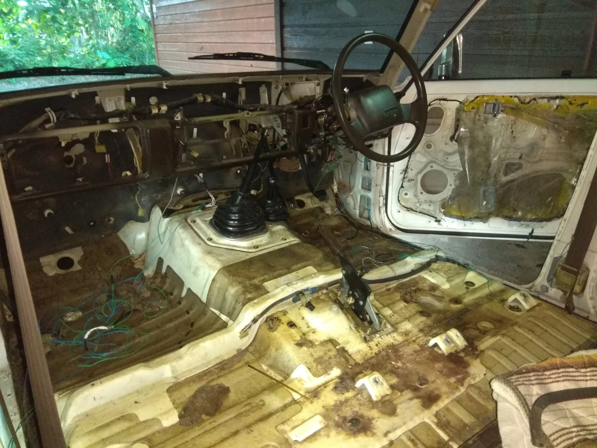

With the HVAC stuff out, time to go deeper into stripping the interior.
Out with this really nasty Made In China LED light. Thankfully, whoever fitted it spliced into the original wiring rather than chop off the factory plug. Toyota still sells the original light units, so that goes on the list.

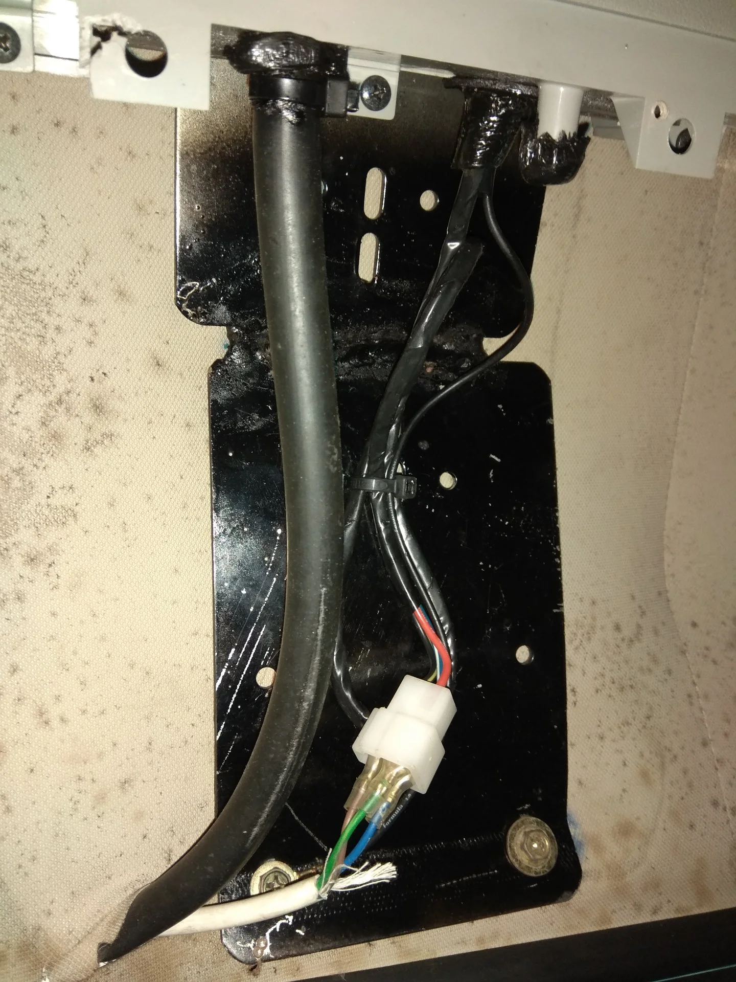

Out with the aftermarket rear AC unit. Yes, that is household three-core cable.

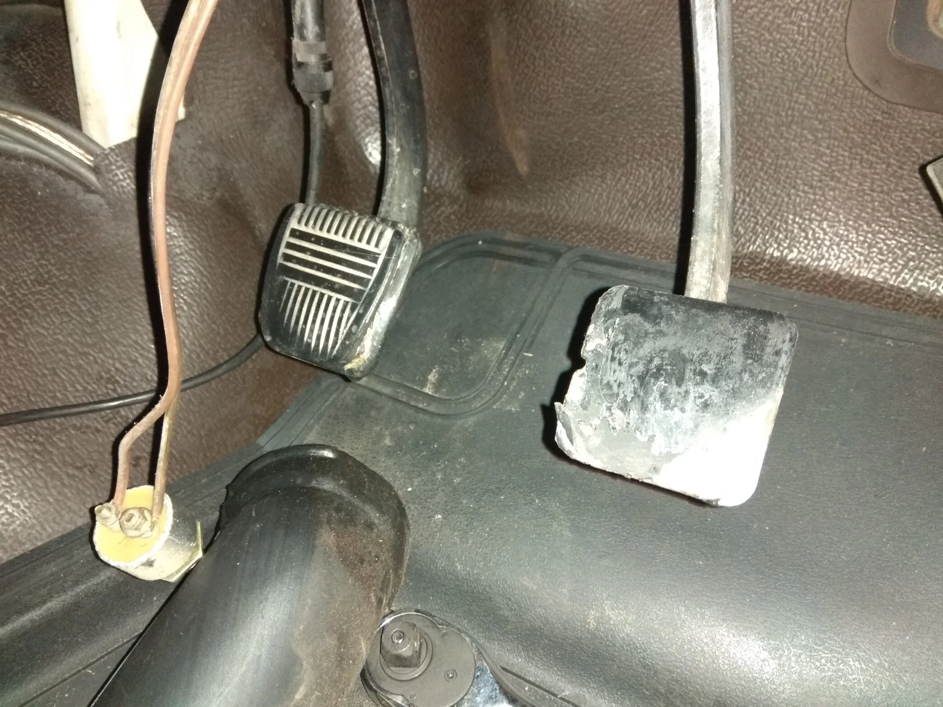

Brake pedal is bare, the clutch pedal has a wrong-shaped Hilux pedal rubber glued on top of the worn out original...

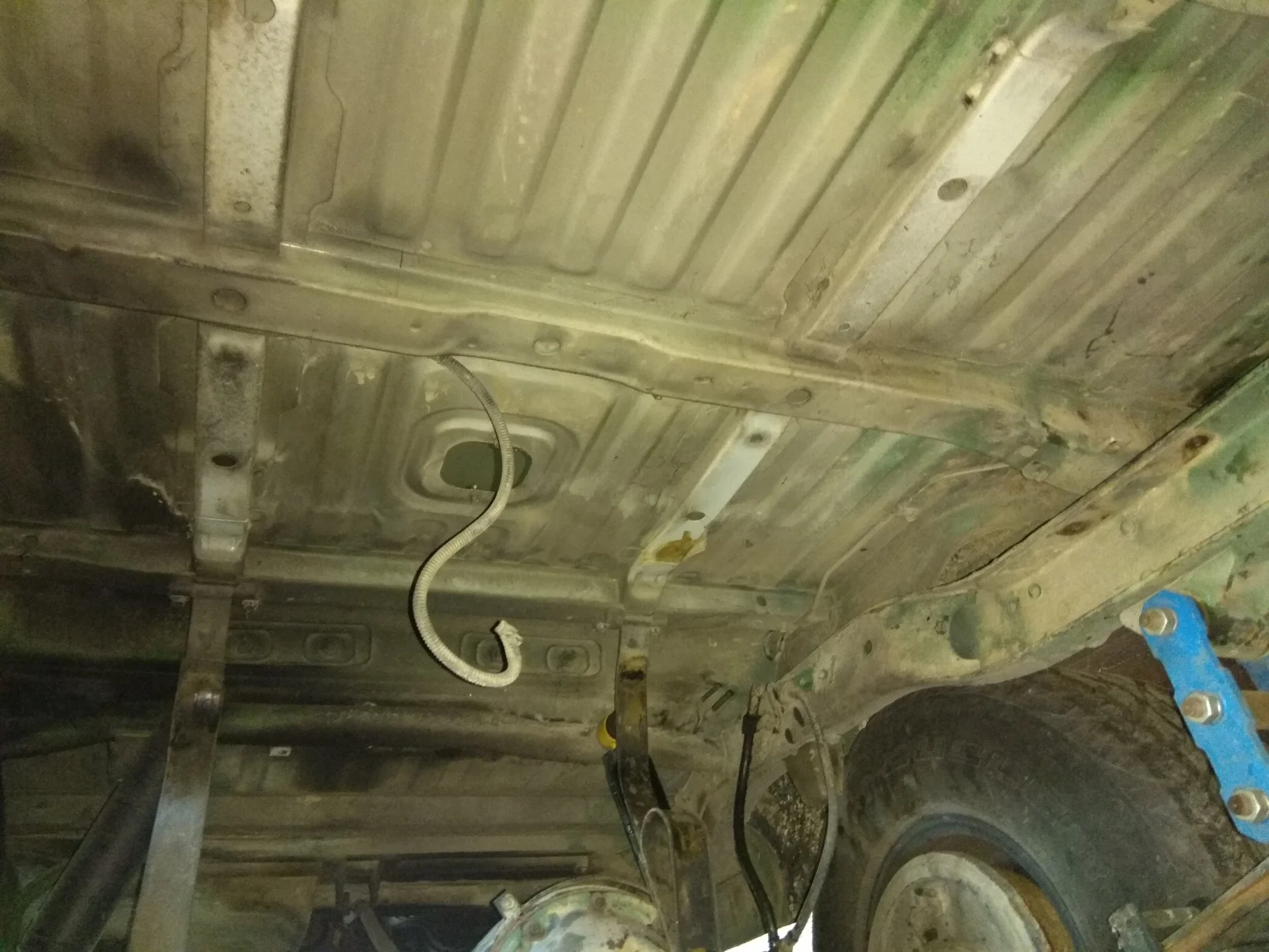

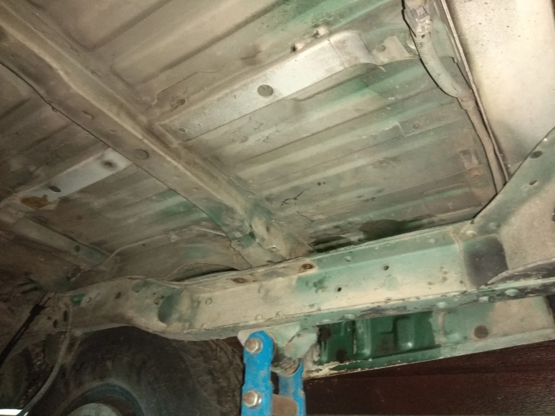

Front floor pan - in this climate at least, cars rust from the inside out. It's not visible here in the pictures but both front corners of the floor pan are rusted . The left side has a plate repair, the right is ready to go through. Not huge areas, but will need welding. Also a patch of surface rust behind the transmission hump which should be easy to correct. In the left hand foot well is some of the metres and metres of superfluous wiring I pulled out of the car from various bodges speaker installs and an old aftermarket central locking system for which there is no obvious key or button. Not to mention that nice household cable running to the rear AC unit.

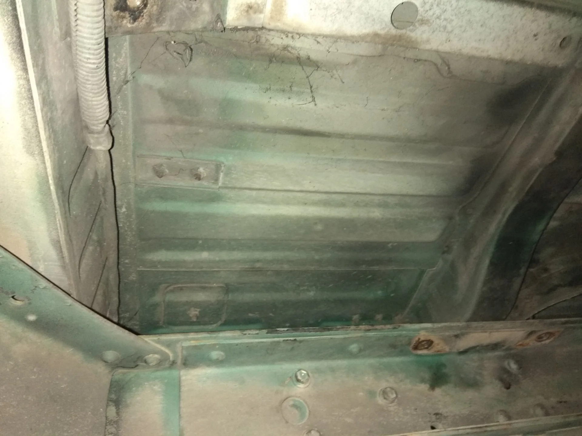

Rear floor looks great, here we can see parts of the original white colour, the yellow respray which was done quite well, and the bodged appliance-white respray which is more recent. Signs of rust deformation around the fifth body mounts (behind the arches).

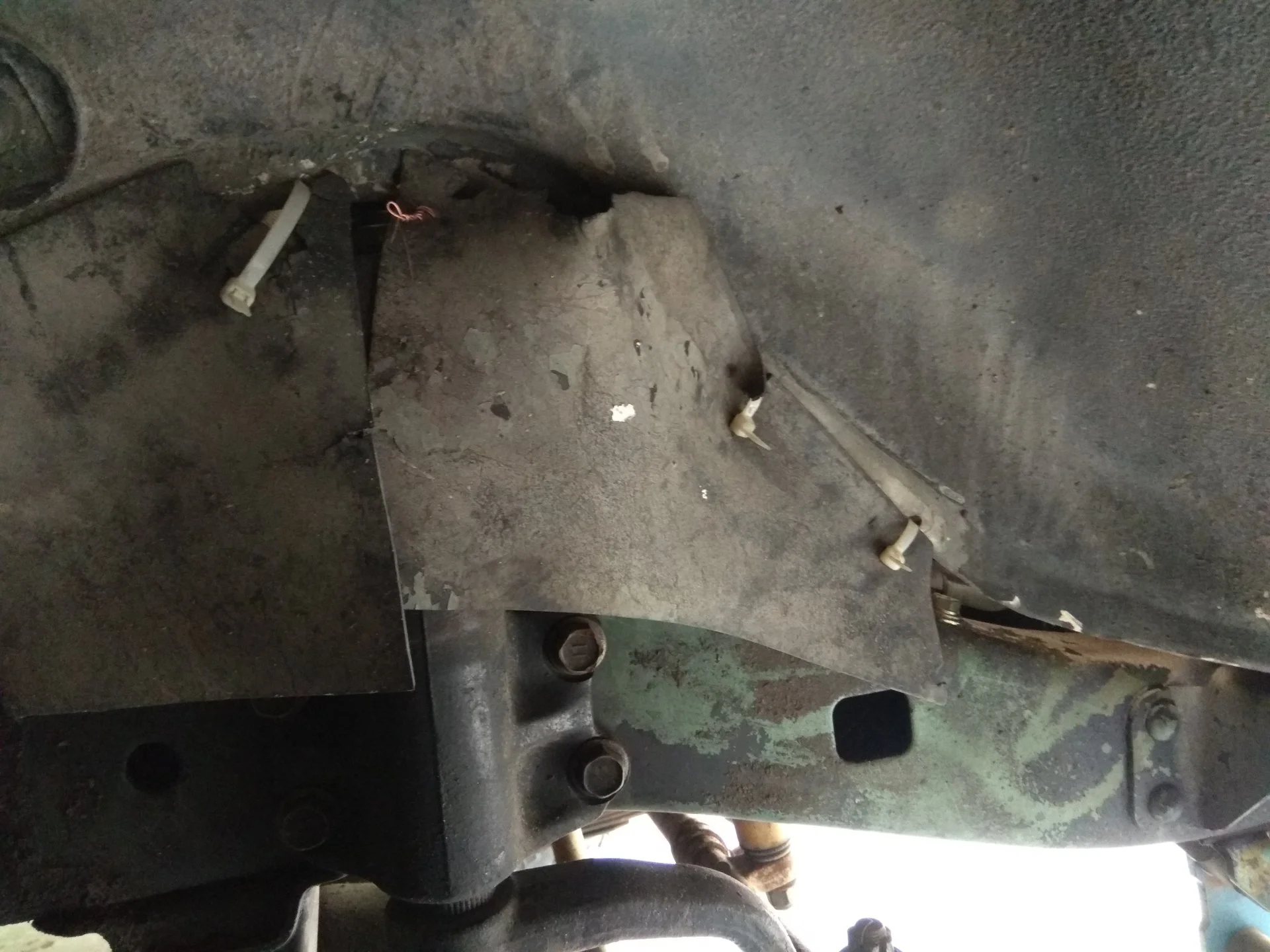

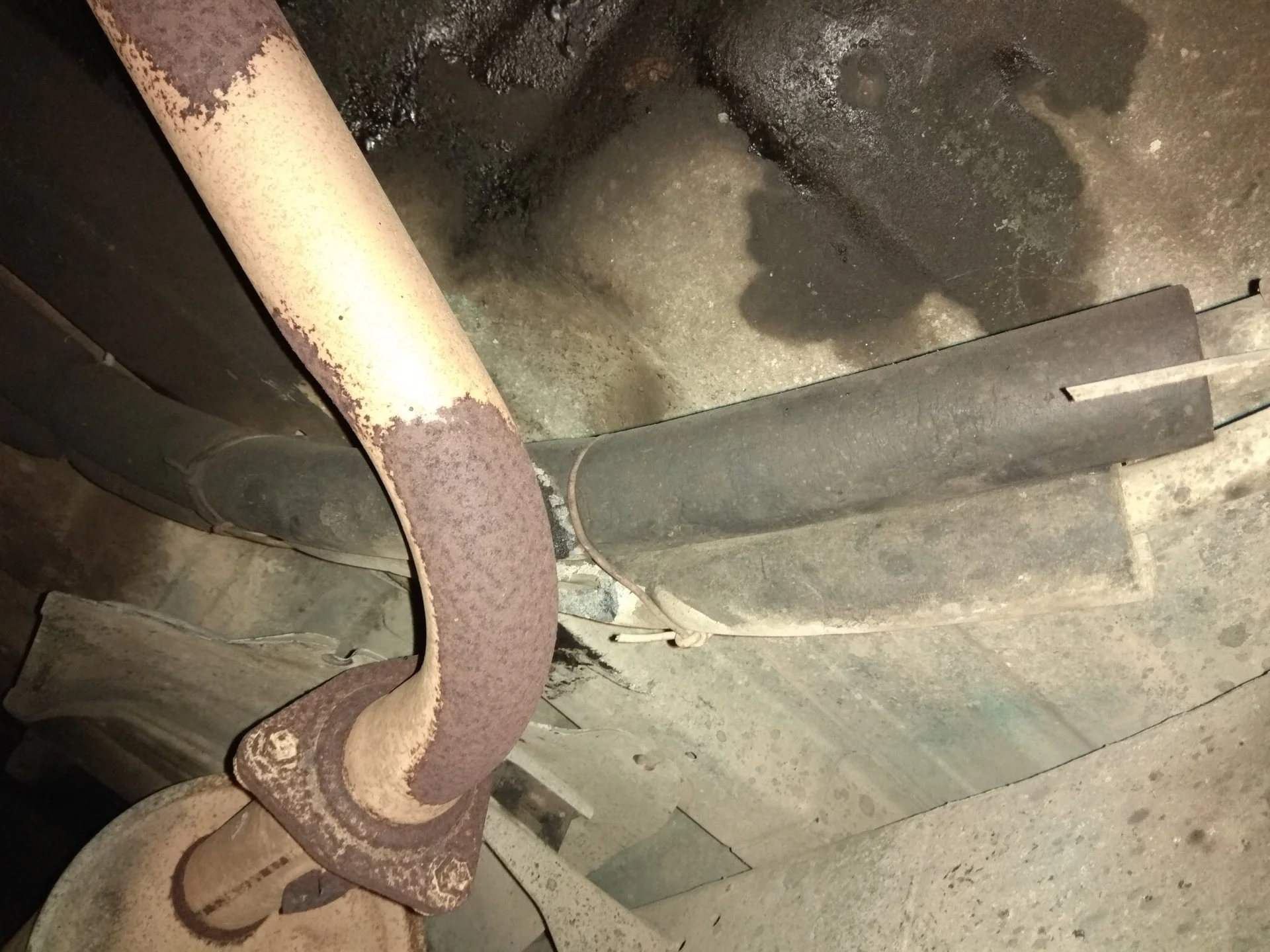

Underside of body
Even more than the 3Bii engine, it was the preserved bodywork on the underside of this car - straight and very near perfect, which attracted me to it. I would subsequently find a few rust issues (around the 5th body mounts in a terribly designed rust trap by Totota, corners of floor pans and rear wheel arches, but overall for a 33 year old car in a humid climate, this thing is very, very good.
Inner sill
Behind the fuel tank pipes.
Three shots of the rear underside. The chassis is perfect. The green paint was put on by the owner very early in the vehicle's life when he lived right at the beach. It's some marine protective paint and it has done an amazing job. The car has also clearly been well looked after, aside from the bodged modifications. This thing definitely deserves saving.

  • Add original heater, original air conditioning.

  • Upgrade some of the ultra-basic factory spec equipment - add original tachometer, cigar lighter, clock.

Dismantling body
The front end of a 60 handily comes off with undoing a few bolts. No welds to cut through, just seam sealer.
Some lovely work here - the original sound insulation is long gone, and a piece of felt material had been stuck on with some brush-on adhesive with some silicone snot for good measure. That's over the yellow paint job but under the latest white one. This hideous mess will take quite some effort to get right I fear. Toyota still sell the original sound deadening sheet, so add that to the list.
The rubber aprons are amazingly still mostly present, but hard and brittle and held on with zip ties and wire. Add those to the list. Note to self - the steering box is not leaking... don't rebuild it...

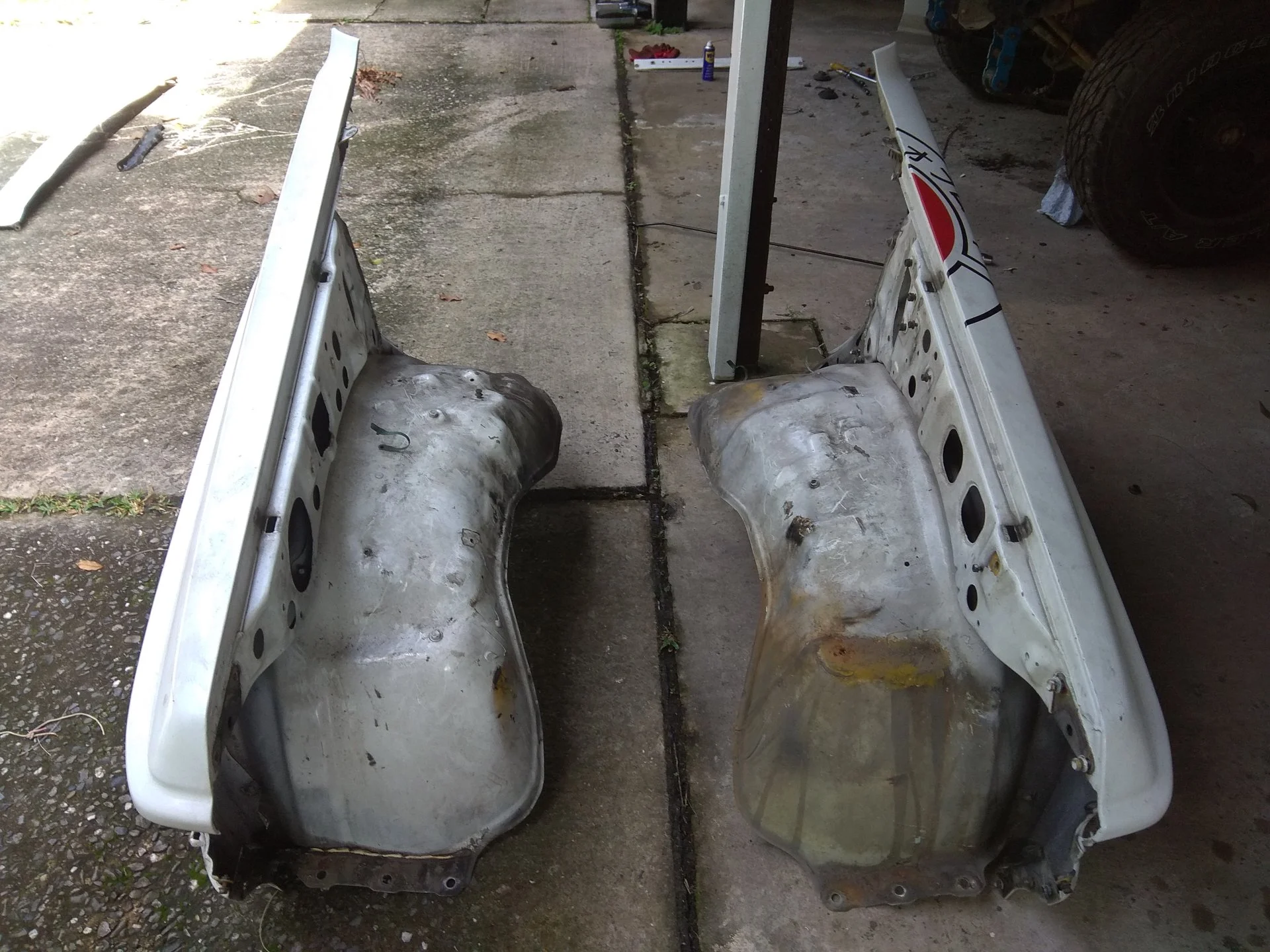

Off with everything at the front end. The radiator support panel is like the Berlin wall - we have original factory primer, original white paint, overspray from both the yello and white resprays, and some matt black, most likely from a rattle can. What workmanship. Chassis and body are perfectly straight.
Off with the inner and outer wings. A touch of surface rust under the battery but otherwise all good, even in the top of the outer wing where they are very prone to rusting.
I love how far back the engine sits, completely behind the front axle, something Ferrari, AMG etc go to great lengths to achieve!
