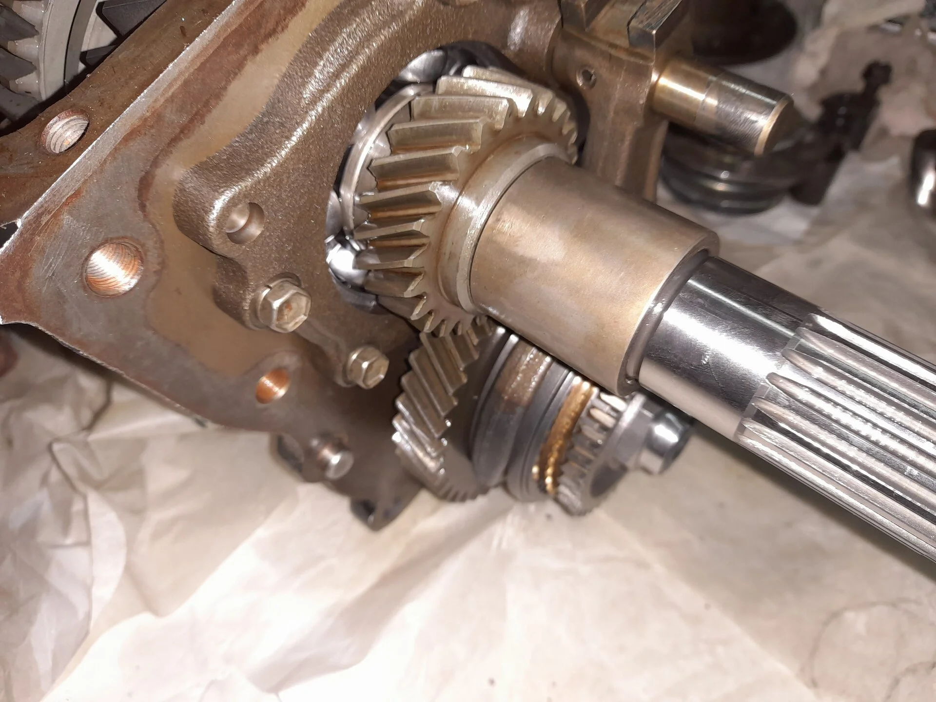

Going in. I'm using the old bearing race to space out the tube and also protect the fifth gear splines from the edge of the tube:
Done!
Very, very happy to complete this step. It's all downhill from here.

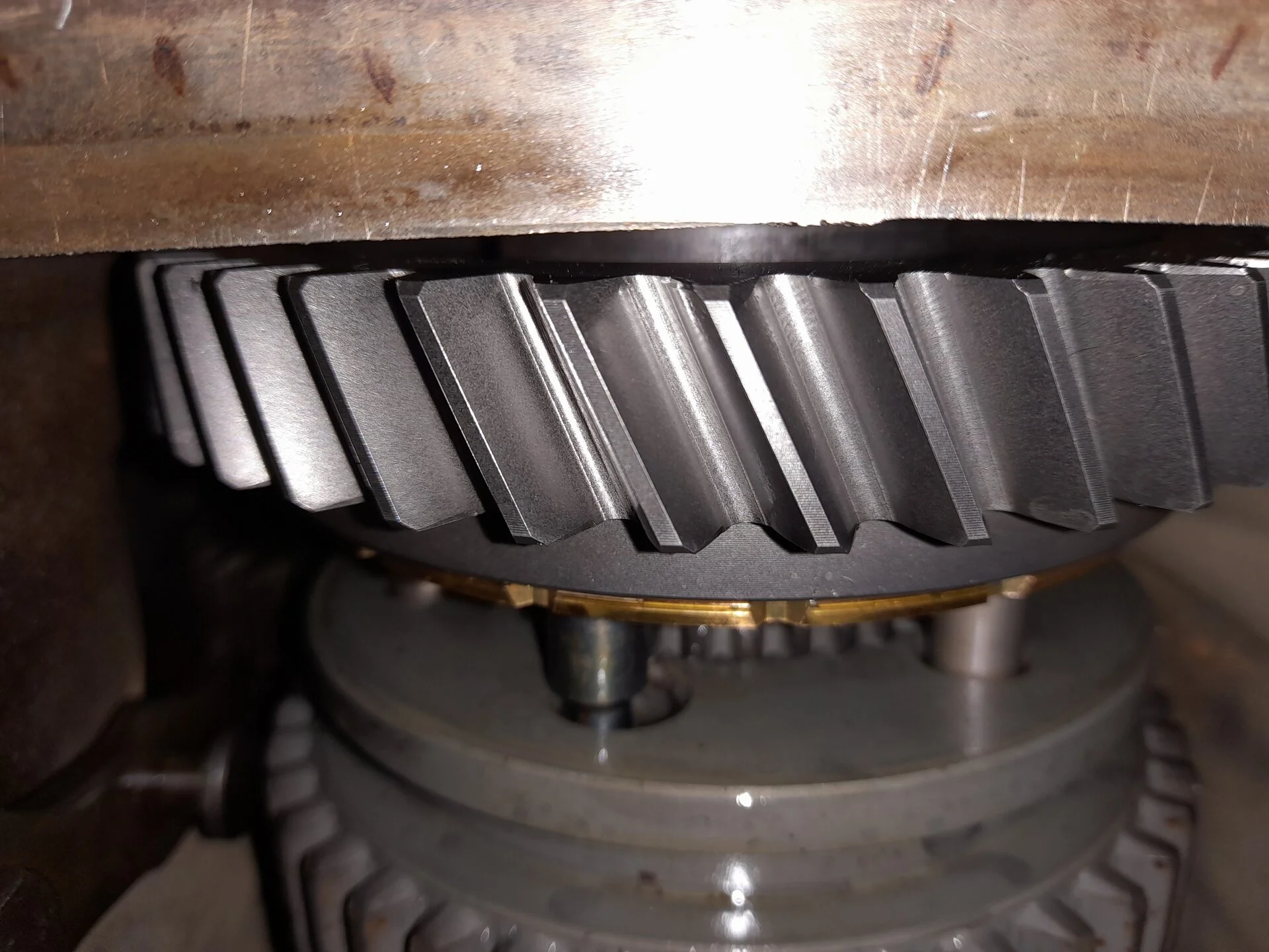

Hard to see in this picture but the bearing is hard against the first gear thrust washer, as it should be:
All looking good in there:

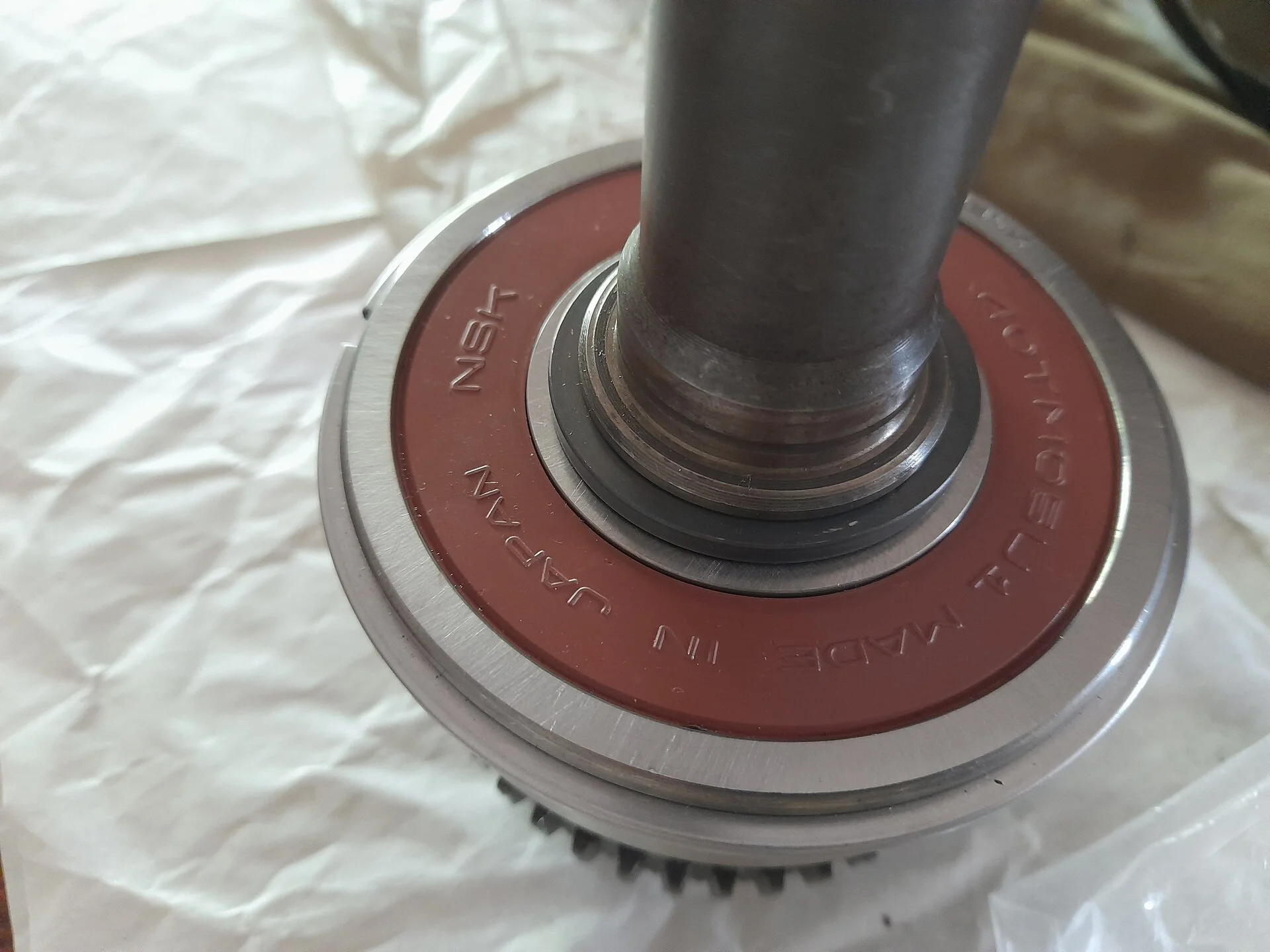

I drew the new input shaft bearing on with the Kukko puller and my old transfer output shaft gear which conveniently presses on the centre rase of the bearing. I then put on a new snap ring with the snap ring pliers.

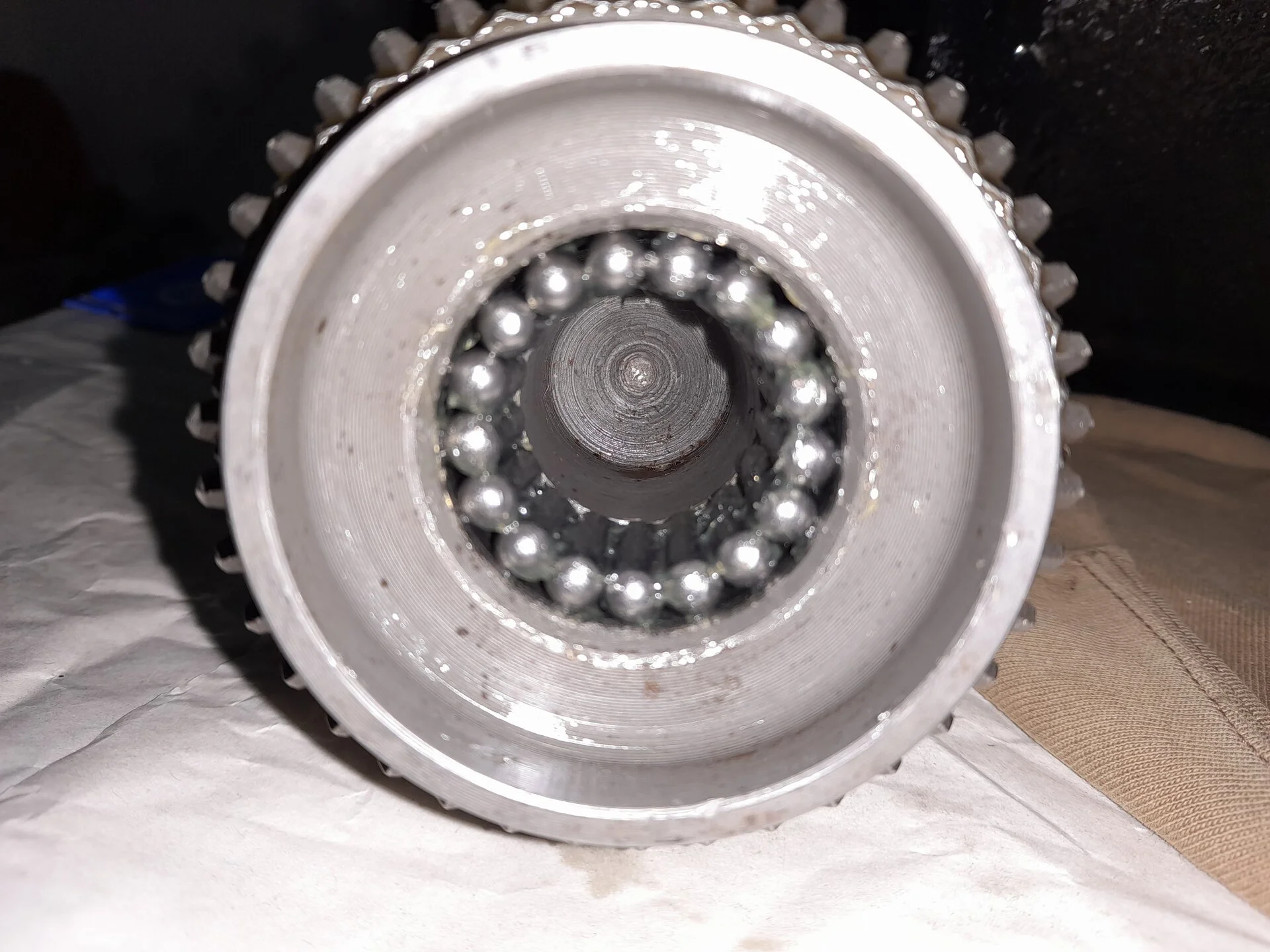

Grease the 17 rollers and add them into the output shaft recess in the input shaft. I love how they make a semi free-standing arch in there.

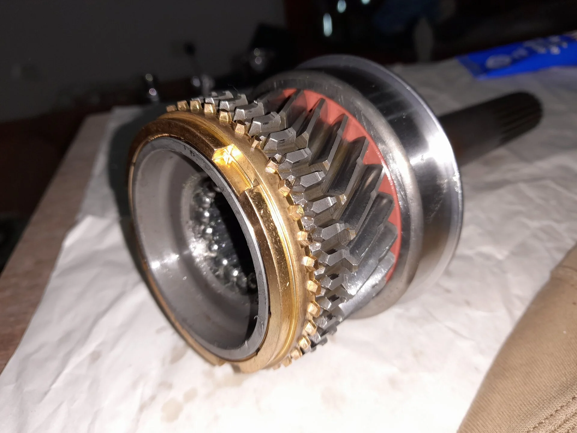

Add the synchroniser ring:
Then tap the input shaft into the transmission case. This should not require much force. Make sure the cutouts on the synchroniser ring align with the keys onthe shift hub:

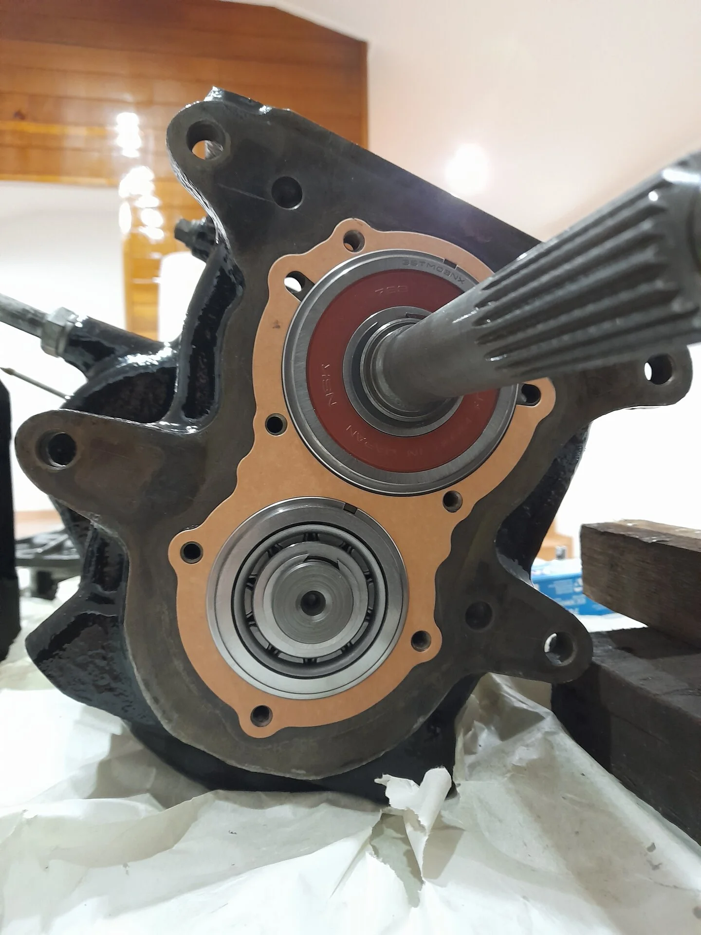

Next, the countershaft bearings:

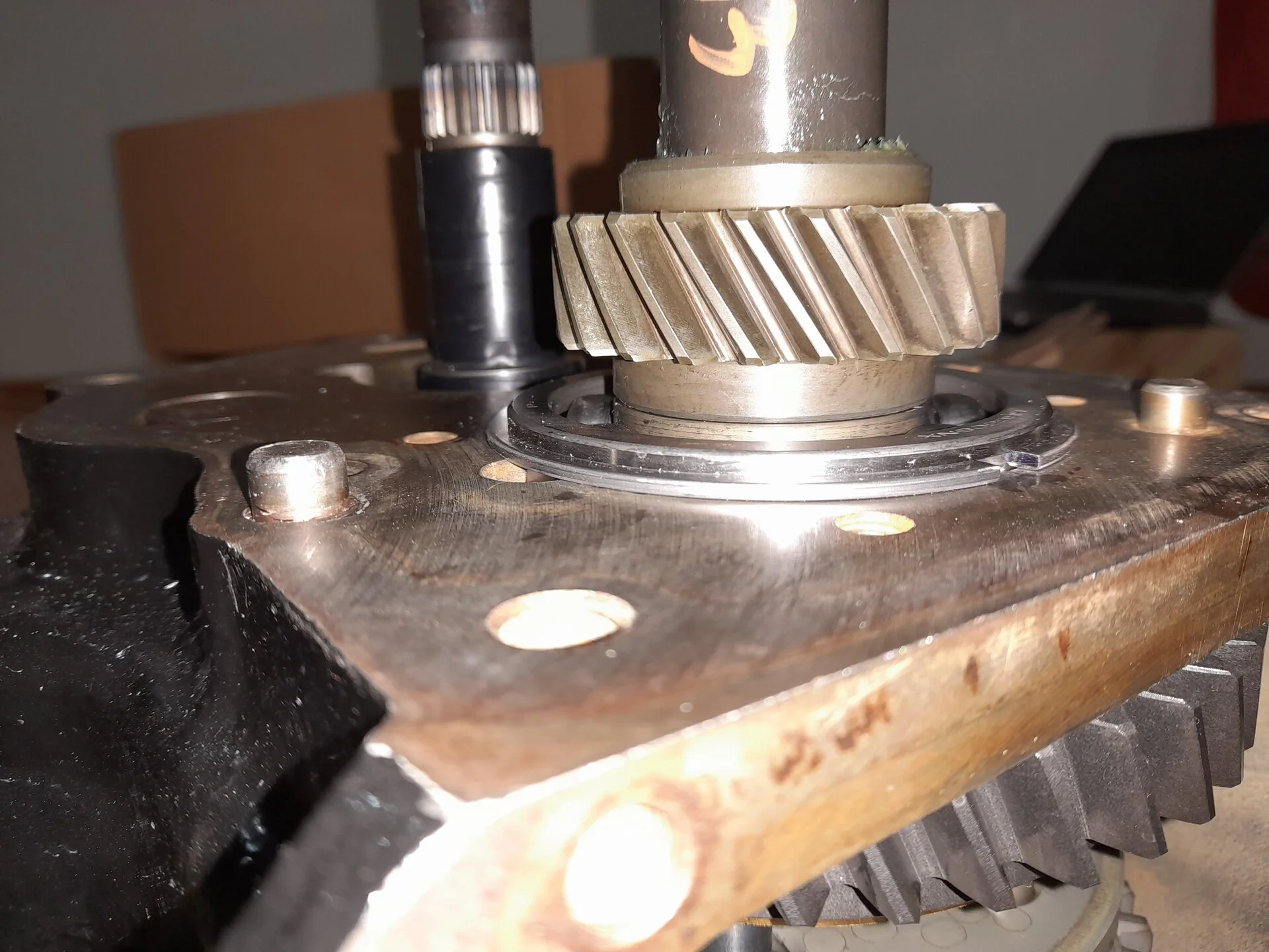

Invert the transmission case and with an assistant holding a lump hammer against the other end of the shaft, drive in the front countershaft bearing with a socket:

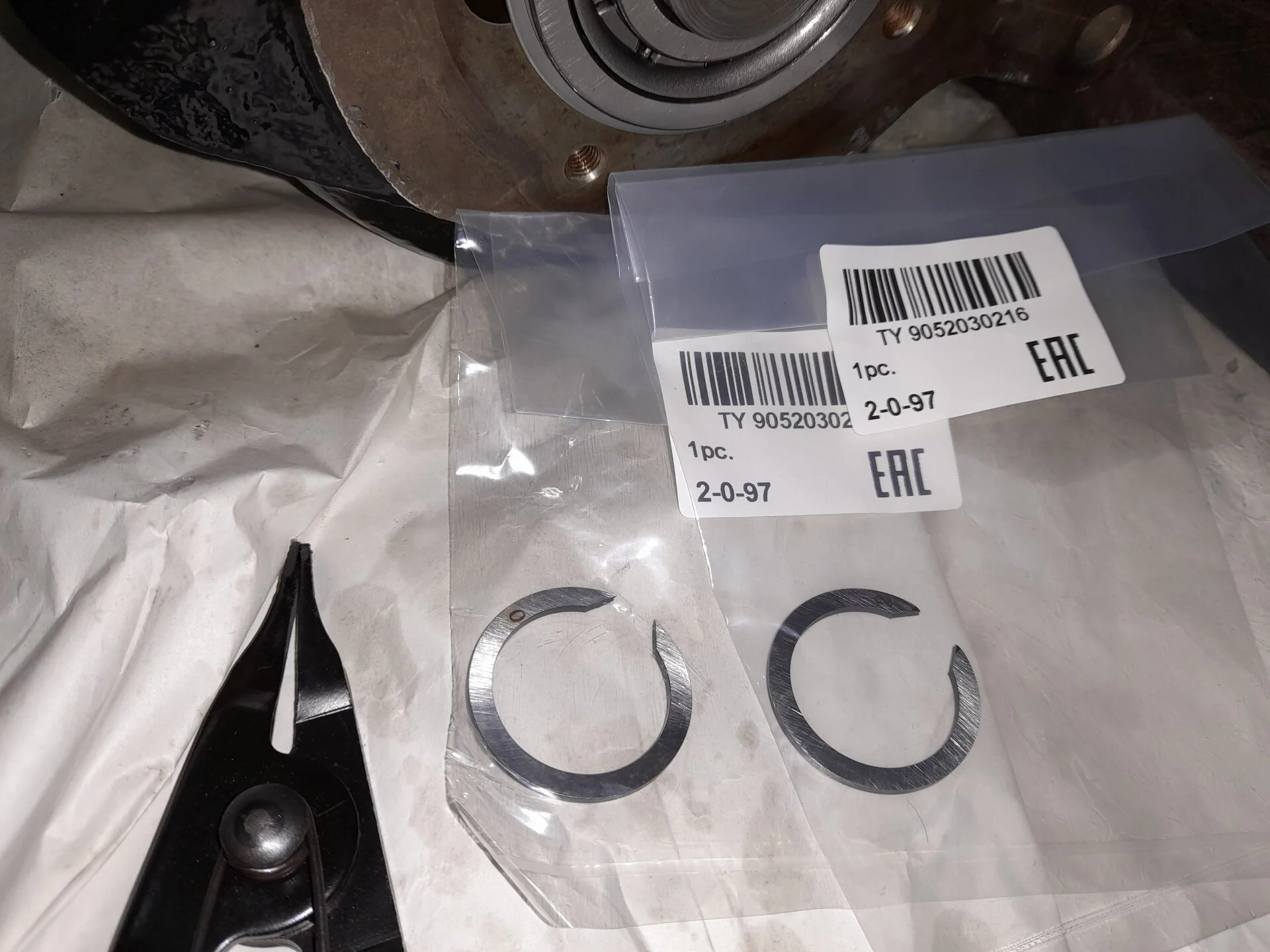

And the rear in the same manner (taking off the protective tape!). I then tried a couple of snap ring sizes on the front bearing. The standard -30214 (marked '0') still had some clearance with a feller gague, so I went up to -30216 (marked '2') which went on perfectly.

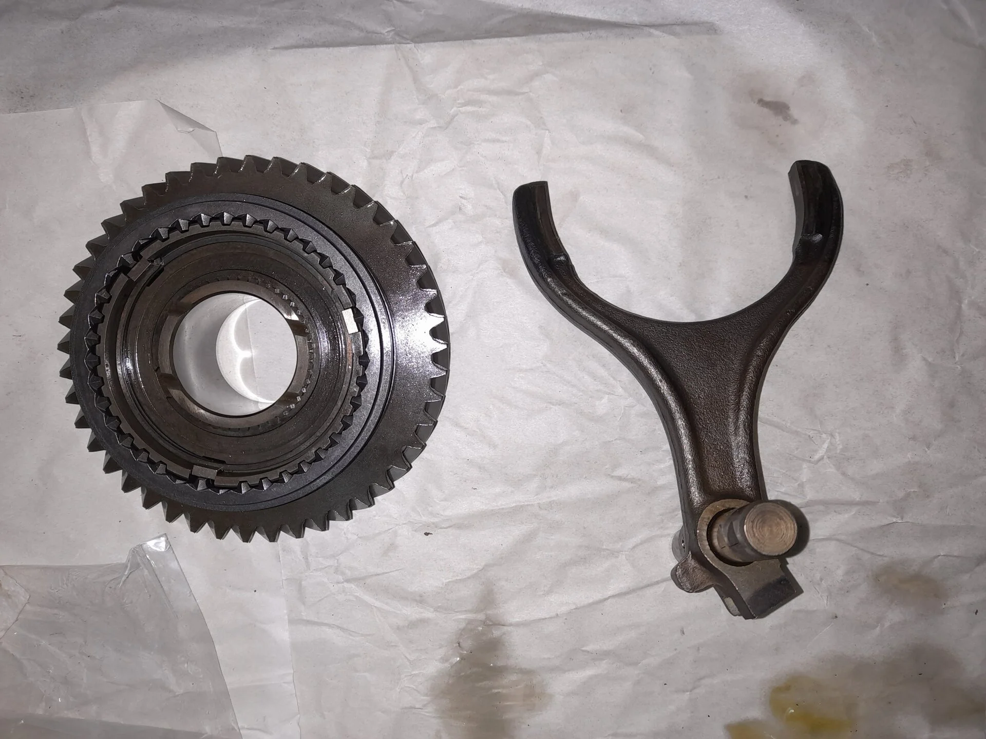

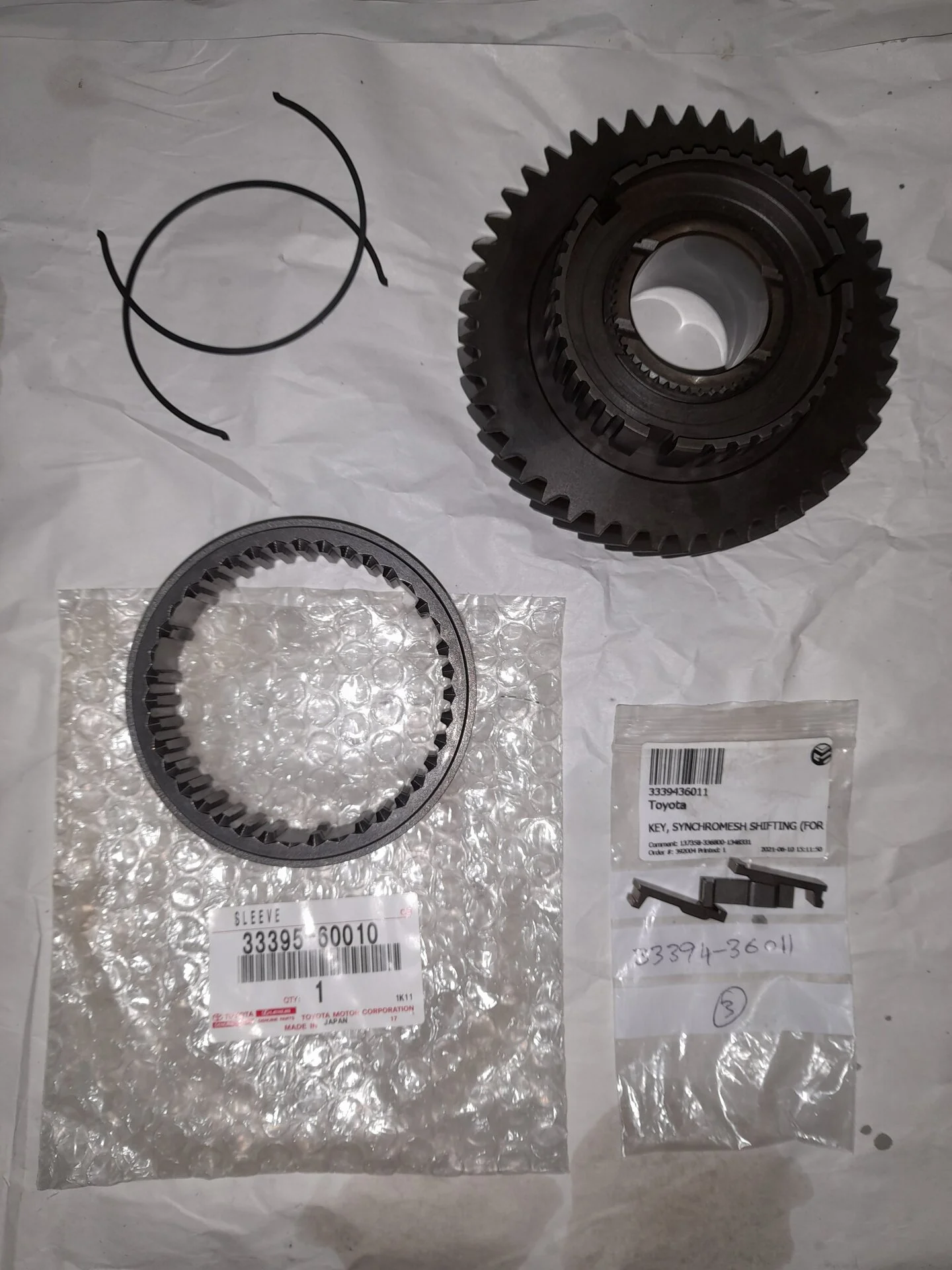

Now for counter fifth gear. I'm adding a new shift sleeve and keys to the original gear.
Install the output shaft centre bearing retainer, add the counter fifth gear thrust washer retaining pin and counter fifth gear thrust washer:
Add a new counter fifth gear needle roller bearing, stick the two halves to the shaft with MP grease:

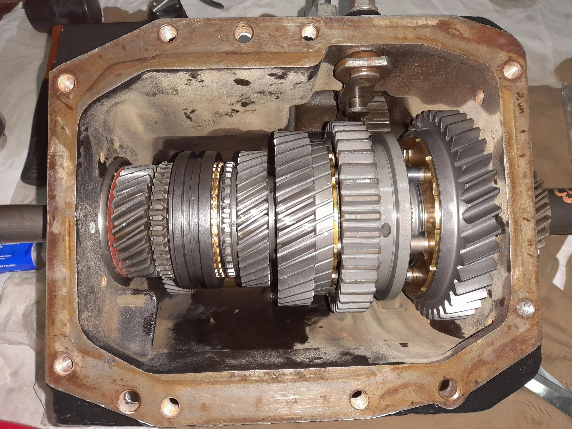

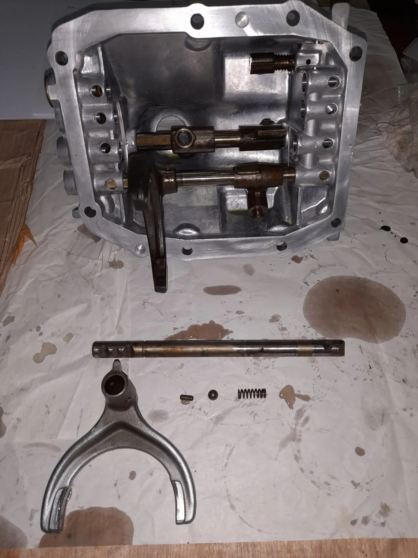

Take your assembled counter fifth gear cluster and the assembled shift fork and shaft...:
...and install:

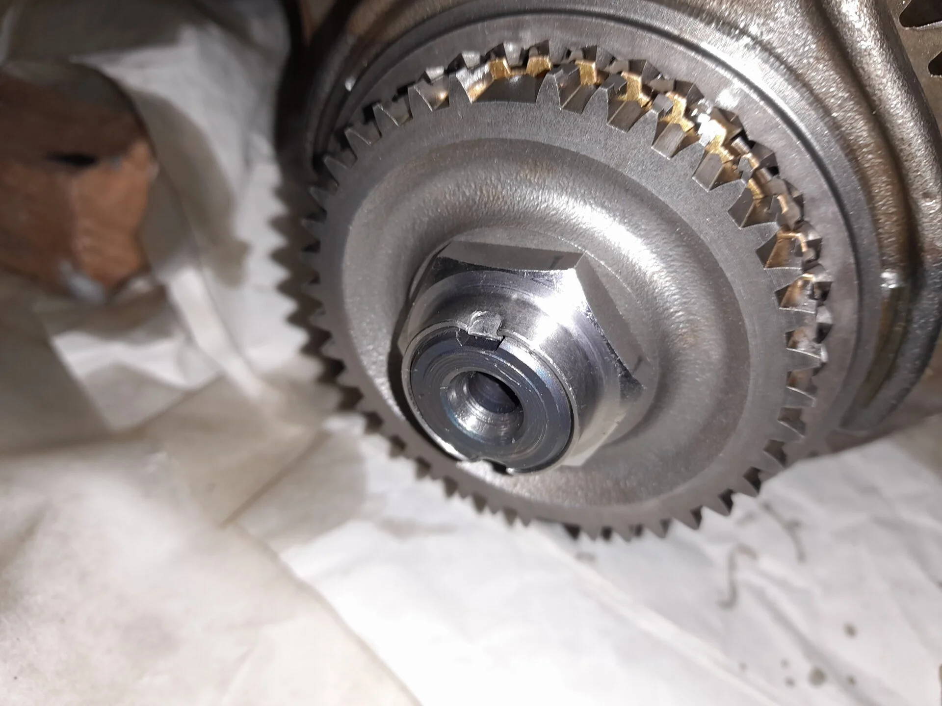

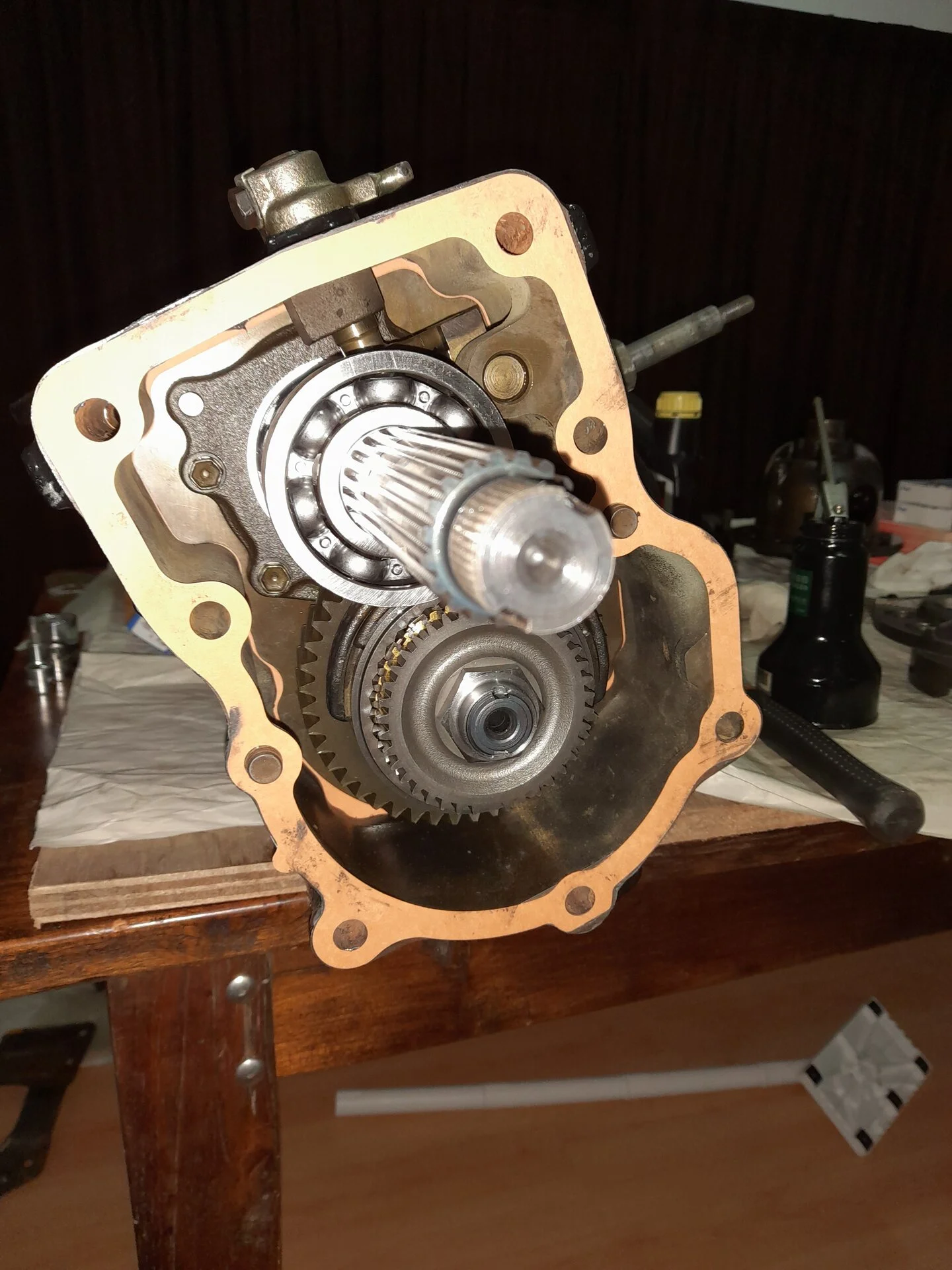

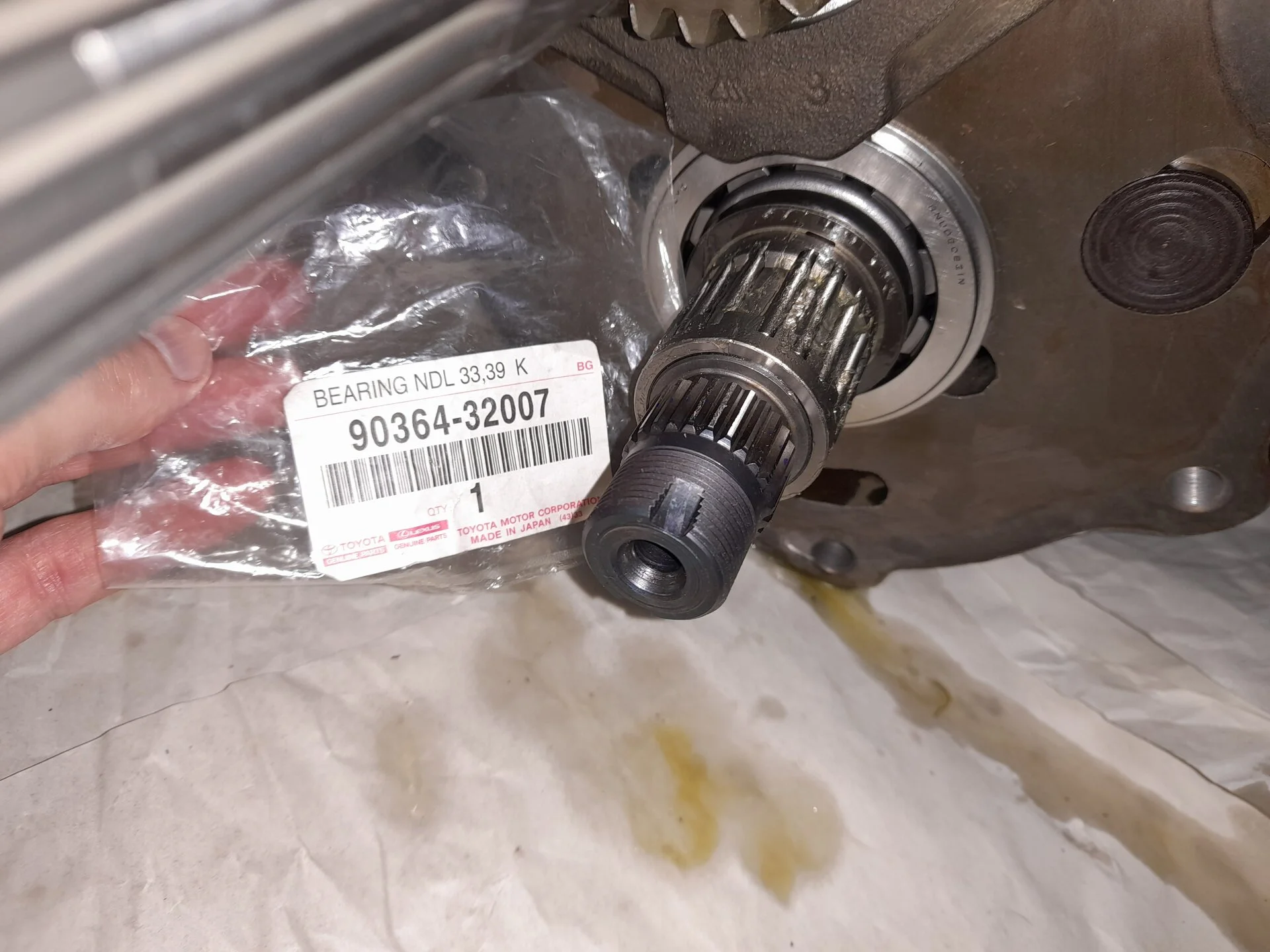

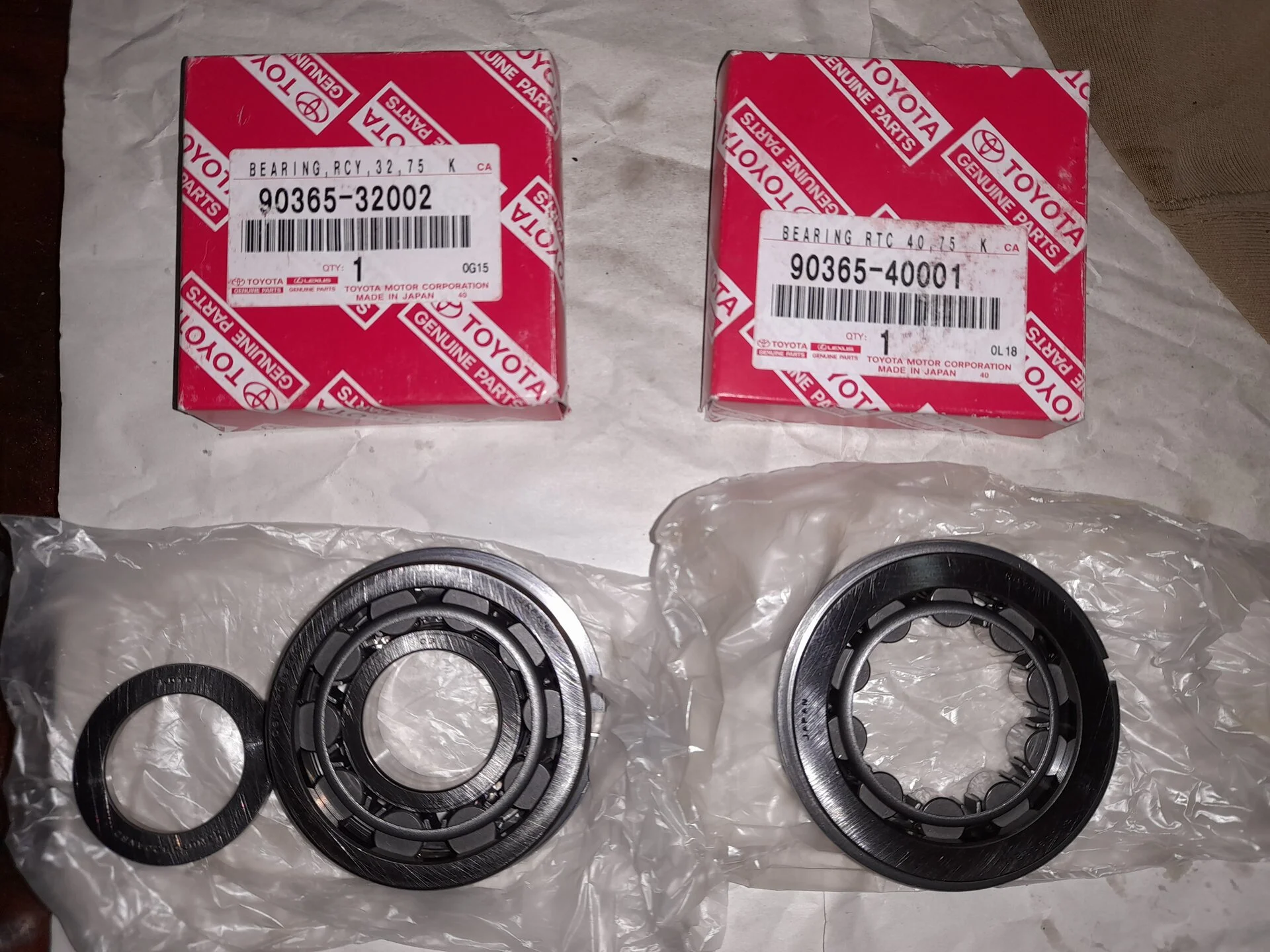

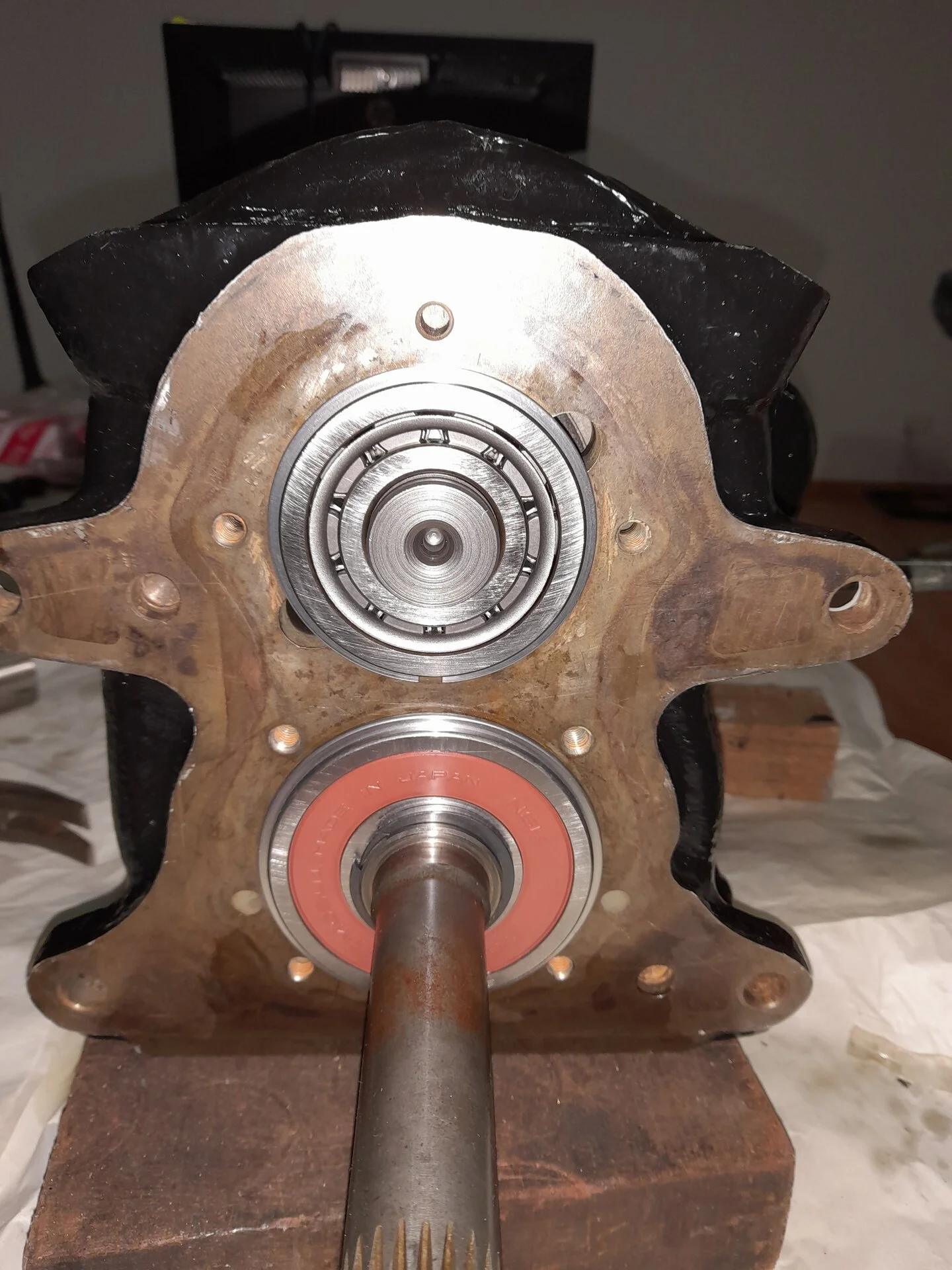

If I thought it was going to be a downhill coast from doing the output shaft centre bearing, here was a minor uphill to deal with - installing the fifth gear shift hub.
The new pieces:
The FSM tells you to hammer on the fifth gear shift hub while an assistant hold the lump hammer against the front of the countershaft. Unfortunately, the force required to drive on a new hub was more than my assistant could hold up against, which required a lot of hammering. Had I been a bit more patient I would have rigged up some sort of brace for the front of the shaft, but I persisted with the hammer.
If you are re-using the counter fifth gear and counter fifth gear thrust washer, you can use a feeler gague to check when the hub is fully seated (by comparing with your pre-disaassembly value, which of course you measured...). Mine was not fully home until I torqued up the rear countershaft lock nut to 127 Nm.
Once the nut is torqued (make sure to torque it one final time after the hub is fully seated), stake it with a small flat punch (not a chisel or screwdriver) to make a neat job.
Then add a front bearing retainer gasket. I put a light smear of silicone on the face which goes against the transmission as some idiot had previously marked it with their shoddy work trying to remove the front countershaft bearing.
Remember to put threadlock on the bolts, then bolt down the retainer with a new oil seal in.

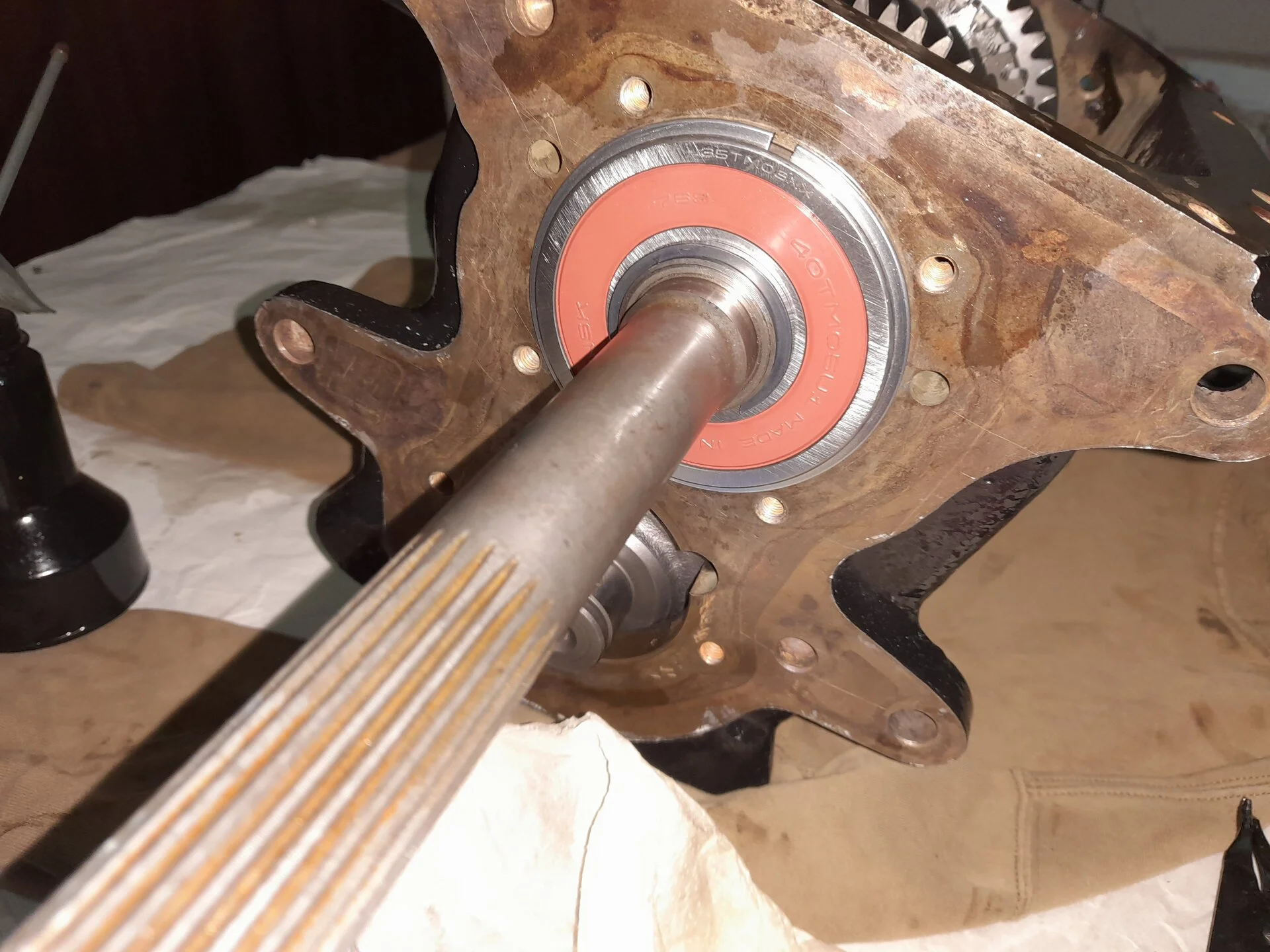

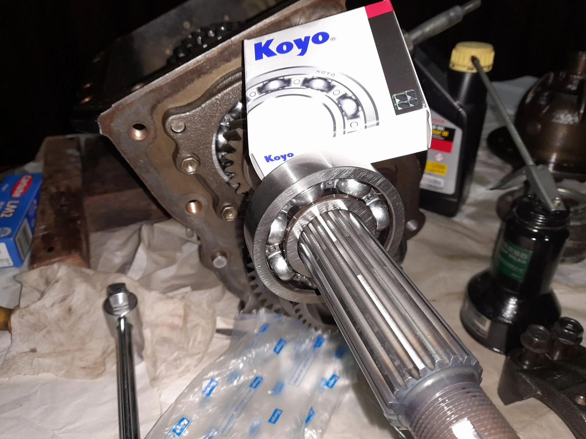

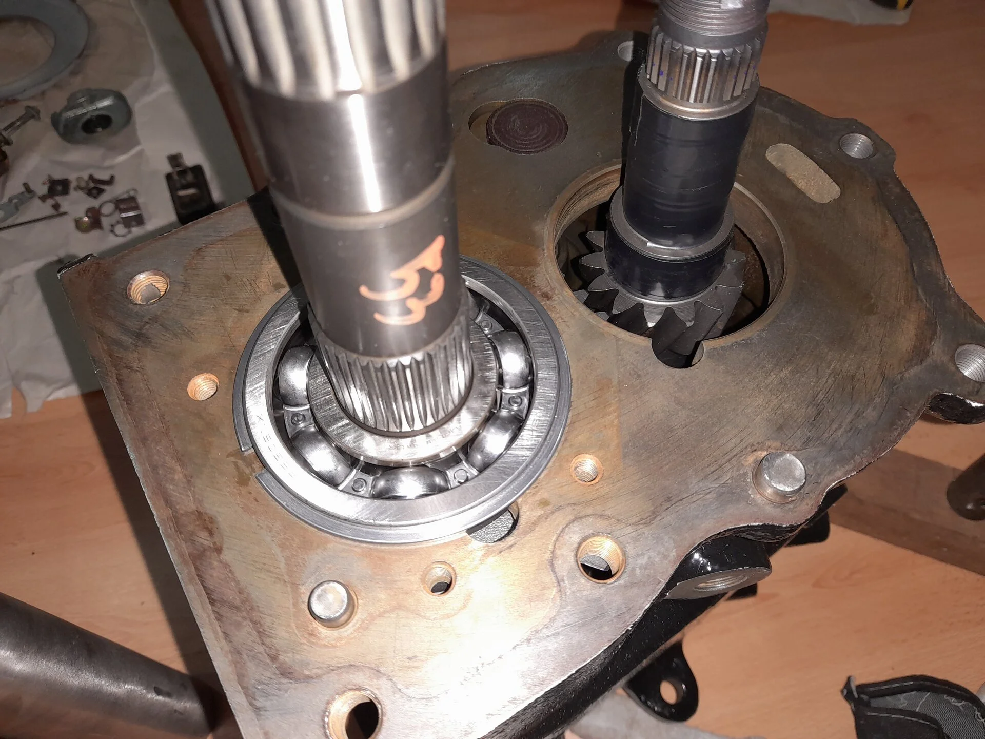

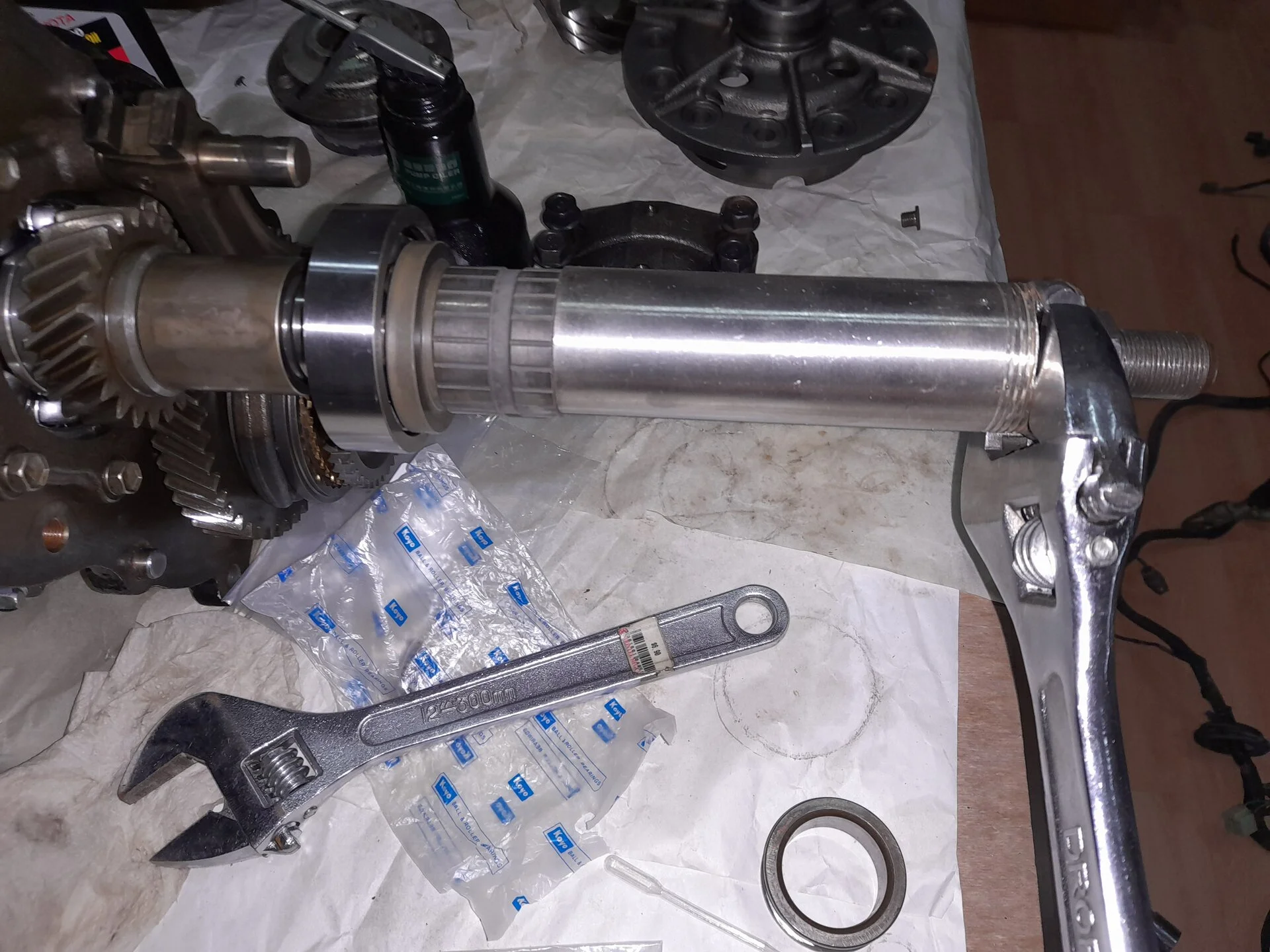

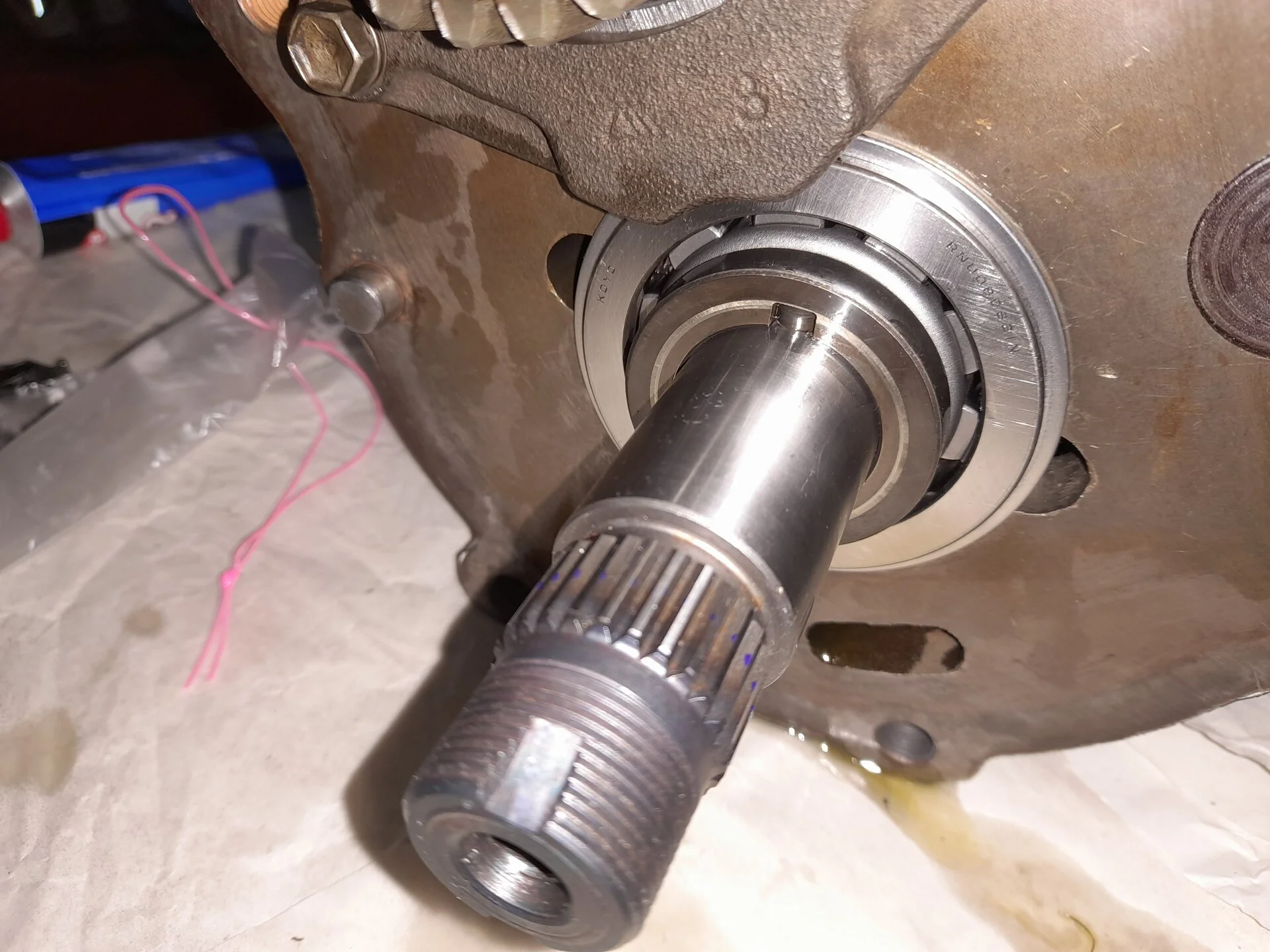

Next, slide on the output shaft rear bearing spacer:
Put on a new output shaft rear bearing:

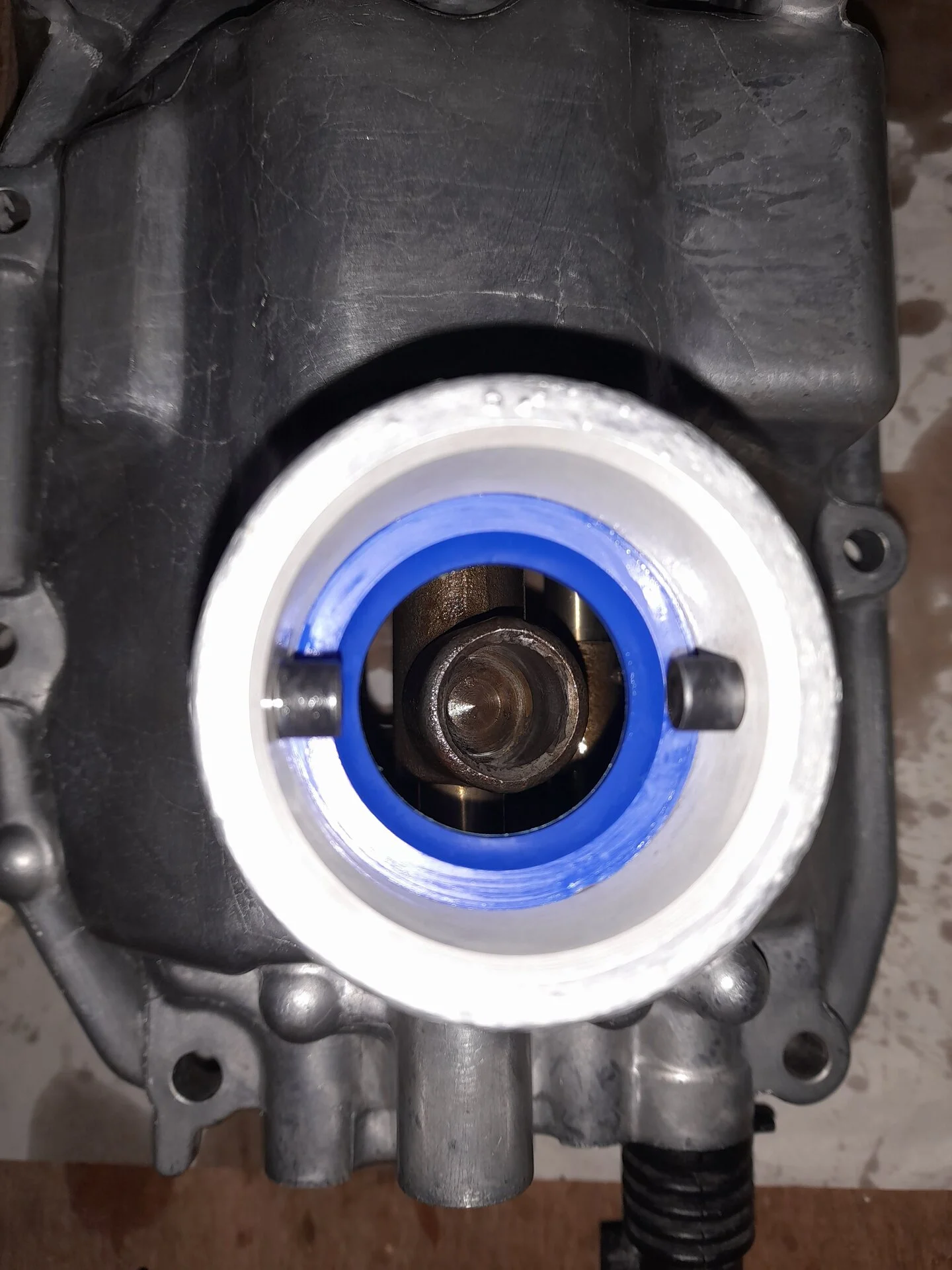

I made a shorter tube in the same style as the output shaft centre bearing tool, only without a lock pin as I figured if the output shaft turned, I could just double mesh the gears (put it in e.g. third and first at the same time). In the end, the shaft did not turn much.
This bearing is tight, and it was hard work to get it on. The main problem was in fact my tool. I had not got the pressing end of the pipe perfectly flush, so it tended to move off-centre and I realised too late that the resistance I was feeling was the washer at the rear of the pipe scraping down the threads of the drag link end. Oh for a lathe! Still, we got there in the end, using a variety of bits to space the tool out. I could have made a longer pipe but I will need this tool again to press on the trandfer input gear later on.
Almost there! It might seem like the bearing could just be hammered on, but I would be concerned that the blows might work the output shaft centre bearing and fifth gear unknowingly down the shaft. The FSM stipulates a thrust clearance check of first gear after this stage to be sure this has not happened. With a tool like this of course (prescribed by the FSM), there is no chance of this happening.
Done:
Here it can be seen that the shorter splines of the output shaft leave a smooth section of shaft immediately behind the output shaft rear bearing where an O-ring seals the nose of the transfer input gear.

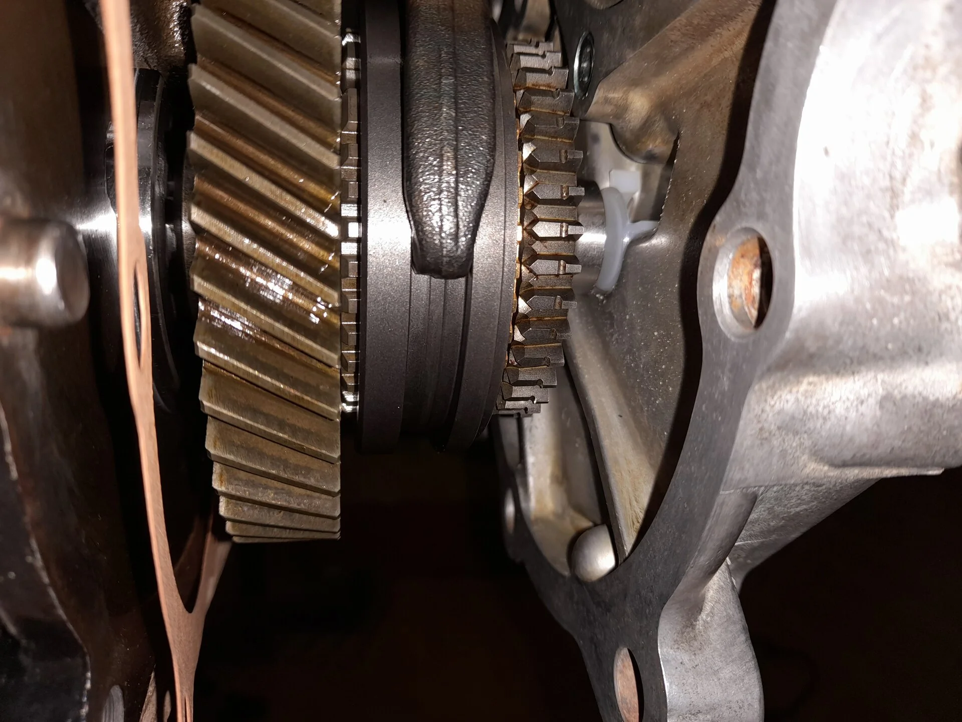

Slide on the extension housing, making sure to catch the fifth gear shift fork shaft:

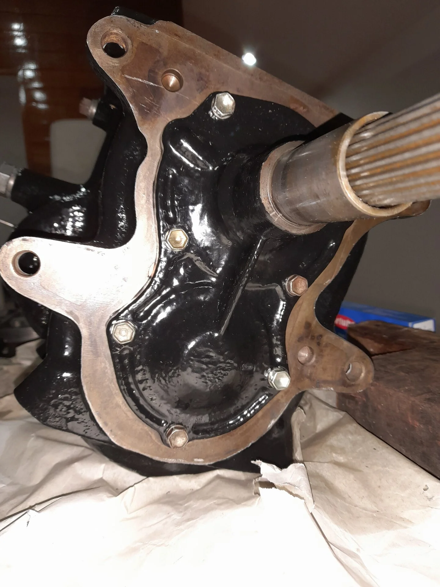

Then bolt on the front transfer case housing and torque the bolts to press the three sections together. The FSM is wrong here in which bolt needs threadlock - it's the one next to the transfer idler shaft bore which starts inside the transfer case and ends on the outside of the transmission. The others either start and end internally or start and end externally. If you were very fussy about oil transfer you might put threadlock on the top two bolts, but the creeping oil leak would in my mind be trivial, so I did not bother:

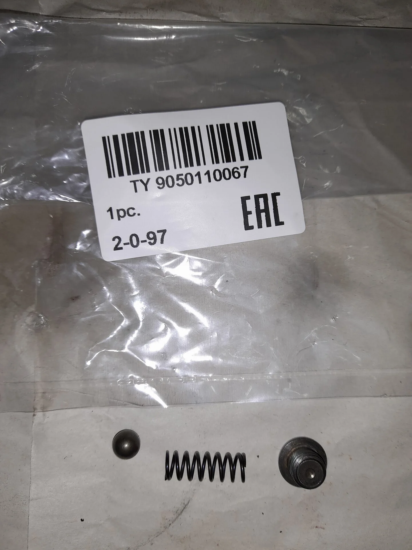

Add the fifth gear detent ball, spring and plug. Some idiot had previously chewed up the plug and those f***er accountants at Toyota decided to stop producing it, so I had to re-use it. Luckily it torqued up OK. One common issue with high mileage H55Fs is popping out of fifth gear, so I put in a new spring, even though the old one was probably OK.

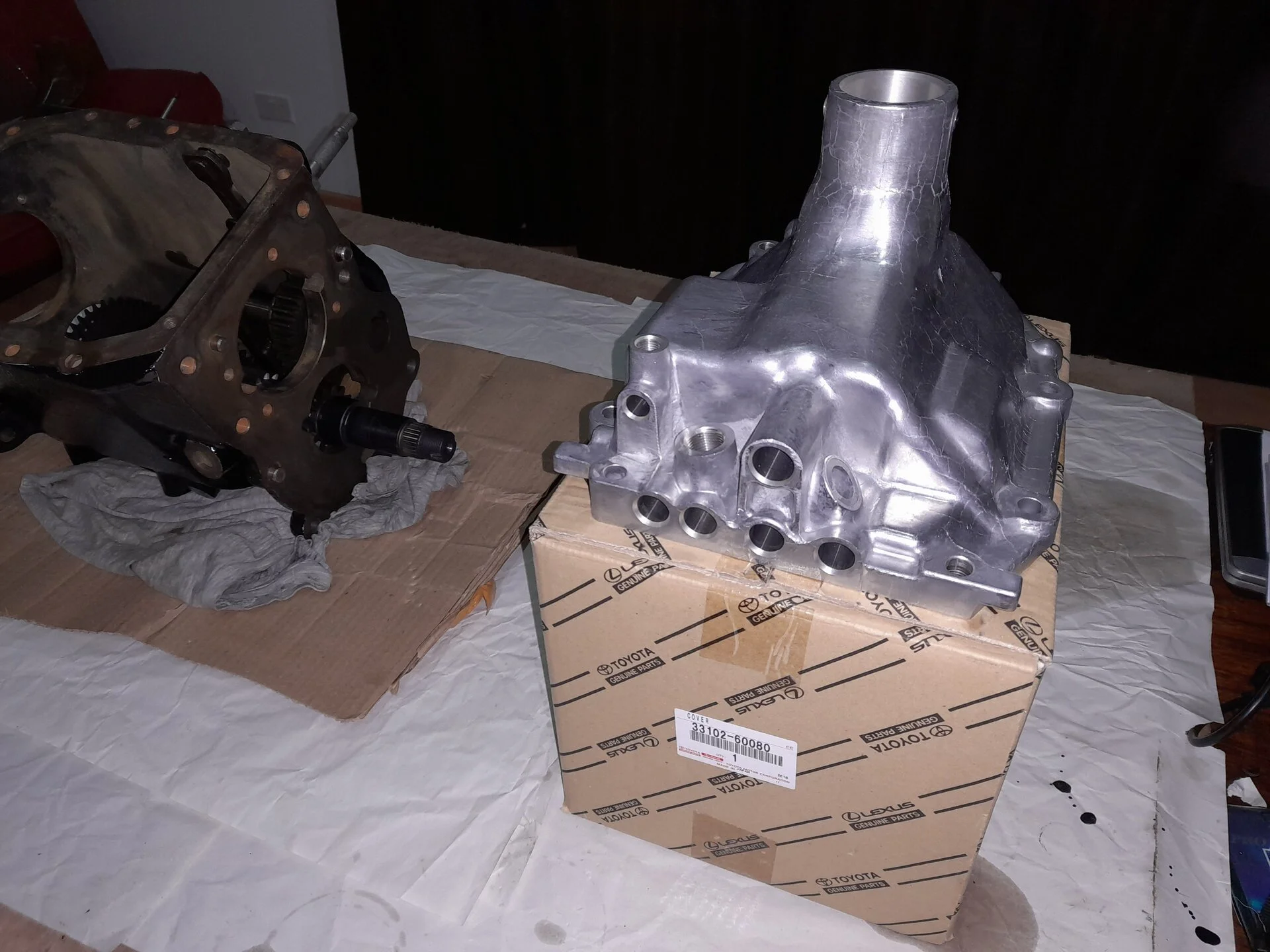

Transmission cover assembly 1

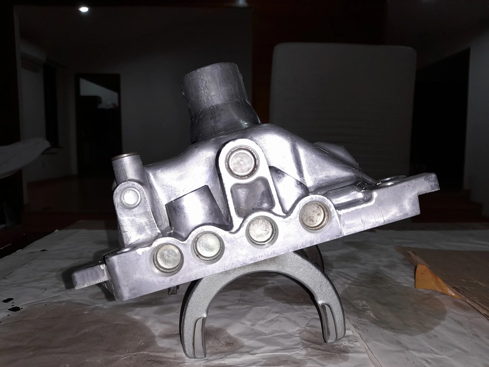

I forgot to add this before the transmission assembly, so will add it here as an aside to the step where the FSM add the top cover to the transmission. No pictures of the disassembly as this was done a long time ago.

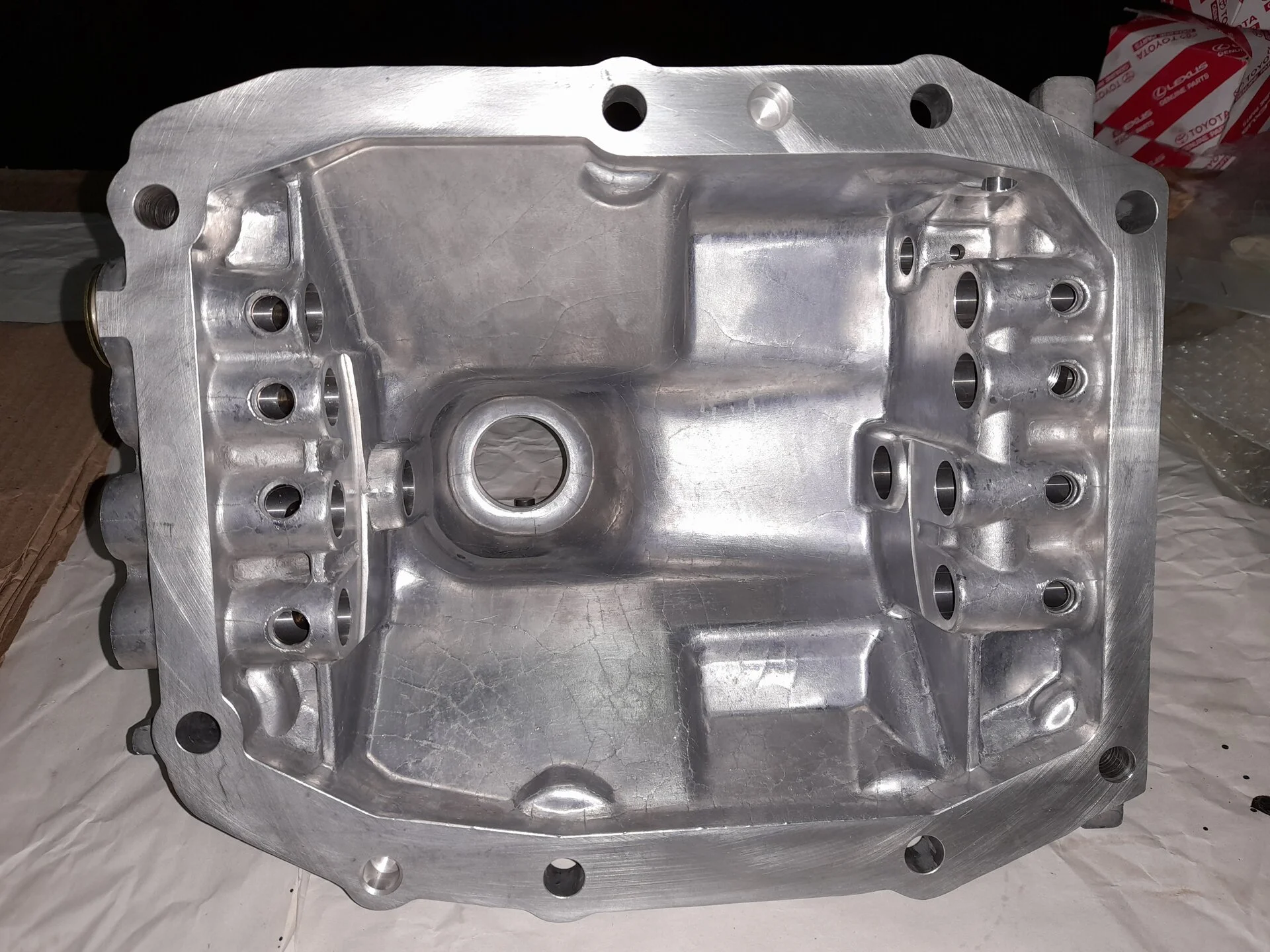

The metal pins in my original top cover were slightly loose, so I decided to replace the whole cover, while it is still available. Note that it comes as a completely plain cover with none of the blanking plugs:
The quality of the casting is horrible. You can see what look like cracks in the mould and these were very high and pronounced with crumbly alloy, maybe even sand. I went over it with an abrasive pad and even fine emery paper around the shifter turret. My original was far better quality. I really despair the degradation in quality of things these days.

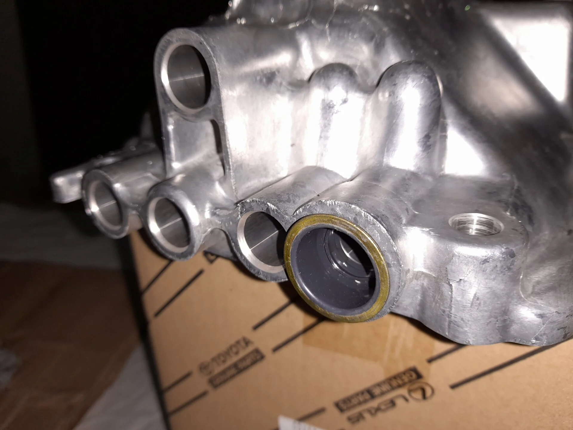

Add a new fifth gear shift shaft oil seal:
Look at the quality of finish around the edges of the casting (that was not me!):
Now turn the cover over to start assembly:

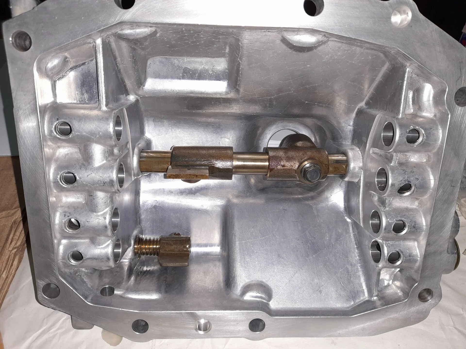

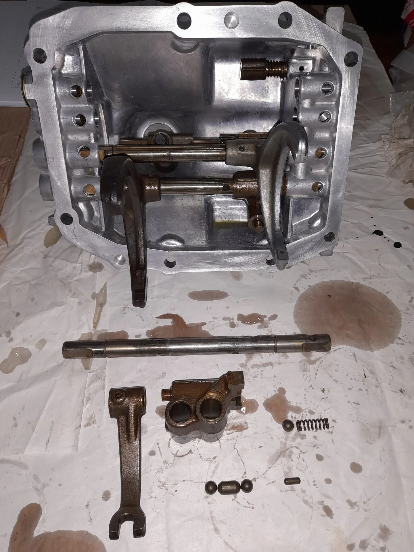

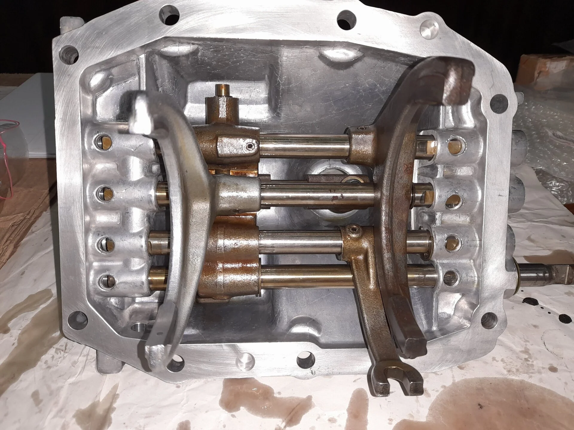

Take the transmission shifter socket, head and shaft and install them, using threadlock on the lock bolts:

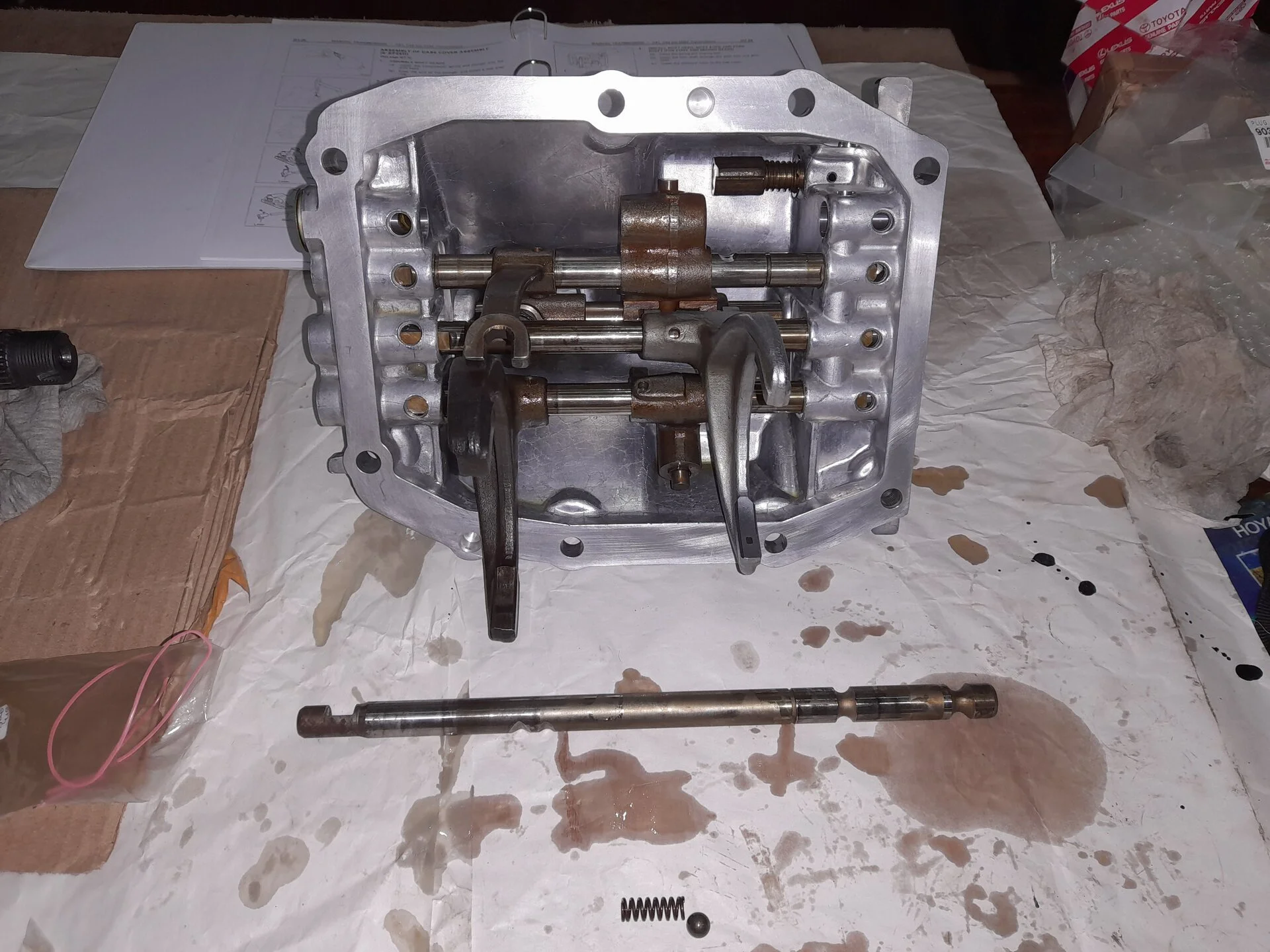

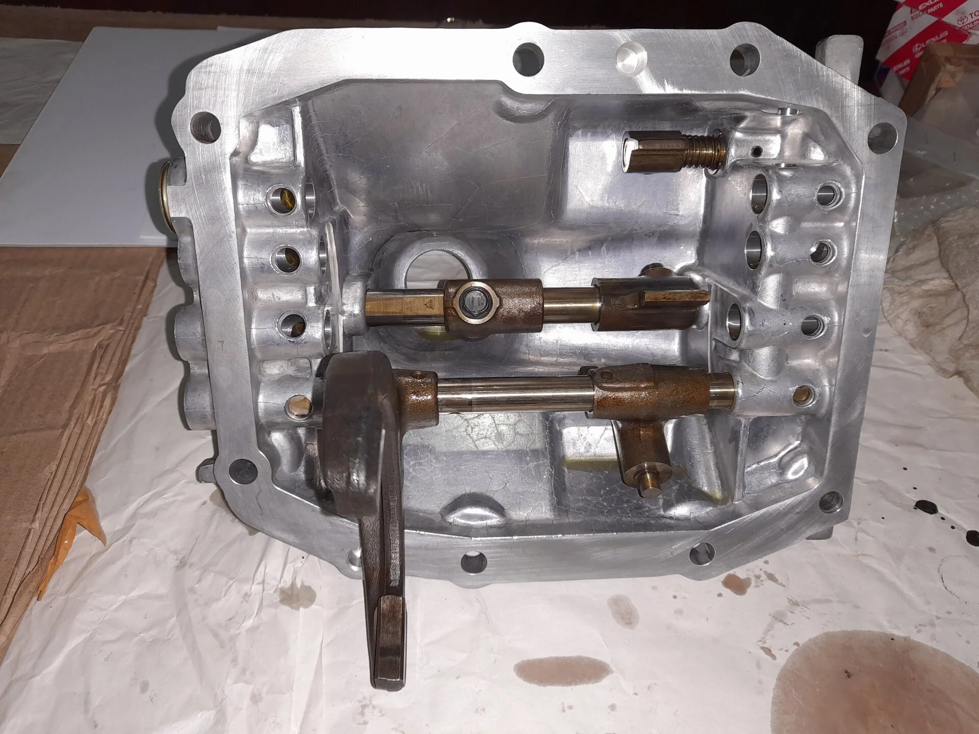

Now take the first-second shift shaft, shift head and shift fork. Add the spring and detent ball to the housing, slide in the shaft through the head and fork, then lock the head and fork with spring pins. Finally, the interlock roller (which stops multiple gears being selected simultaneously) into the housing:
Now for the third-fourth shift assembly:
Add the detent spring, ball, then shaft and fork. Secure the fork with the spring pin, and add the interlock roller to the case.
Then take the reverse shift fork shaft and arm, detent ball and spring, and the fifth-reverse shift head with interlock detent balls, interlock roller and interlock pin. Note that my copy of the FSM forgets to tell you to add the interlock roller.
Once those are installed, take the fifth shift shaft, detent ball and spring. The fifth shift shaft goes through the fifth-reverse shift head installed in the previous step.

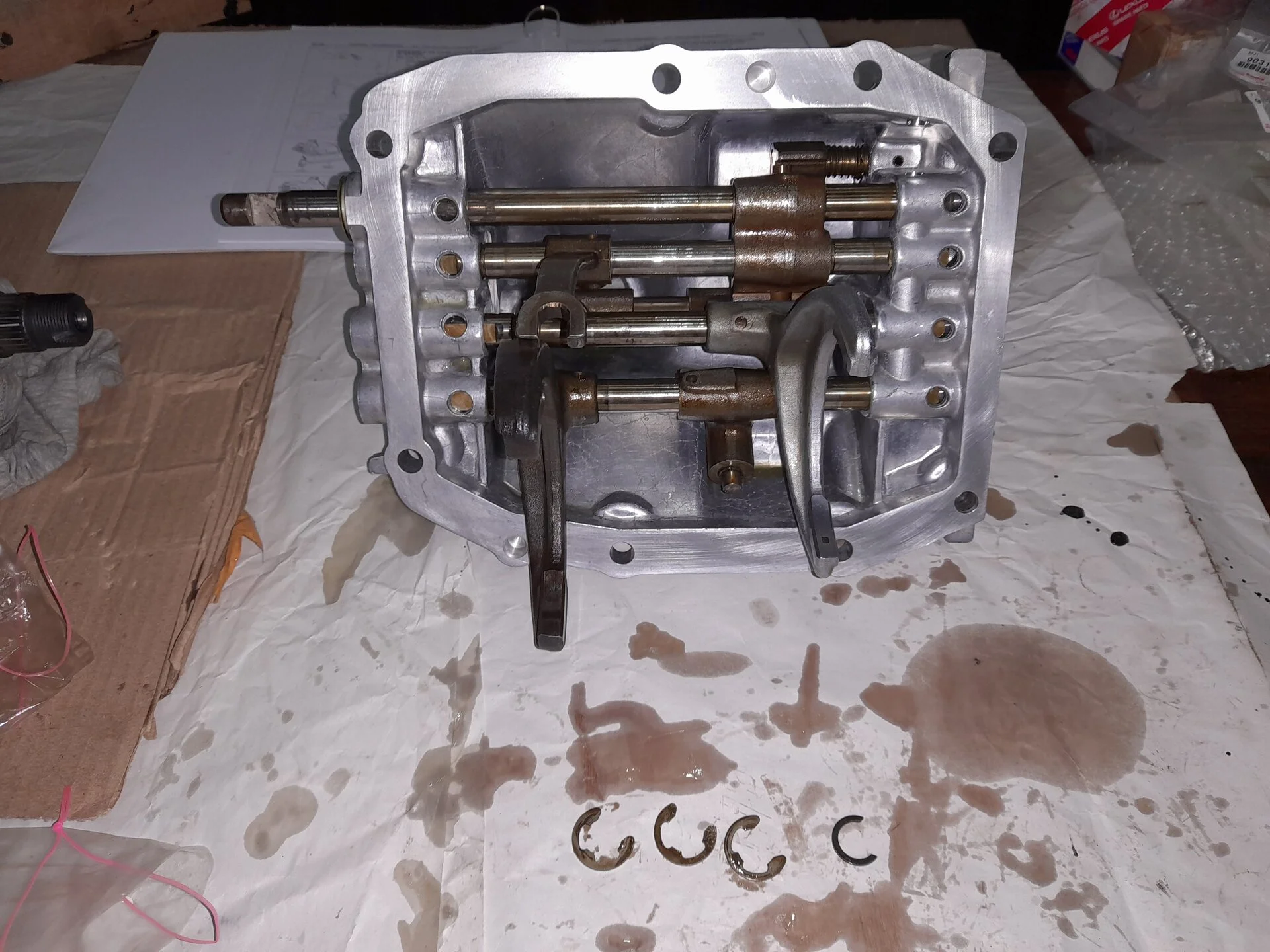

All the shafts and associated paraphernalia are now in place, time for the finishing touches.
Add the three E rings and one snap ring to the shafts. I must admit I reused my E-rings... make sure they are tight as all sorts of nastiness would ensue of one were to fly off during a spritied gear shift!
That's everything inside the cover:

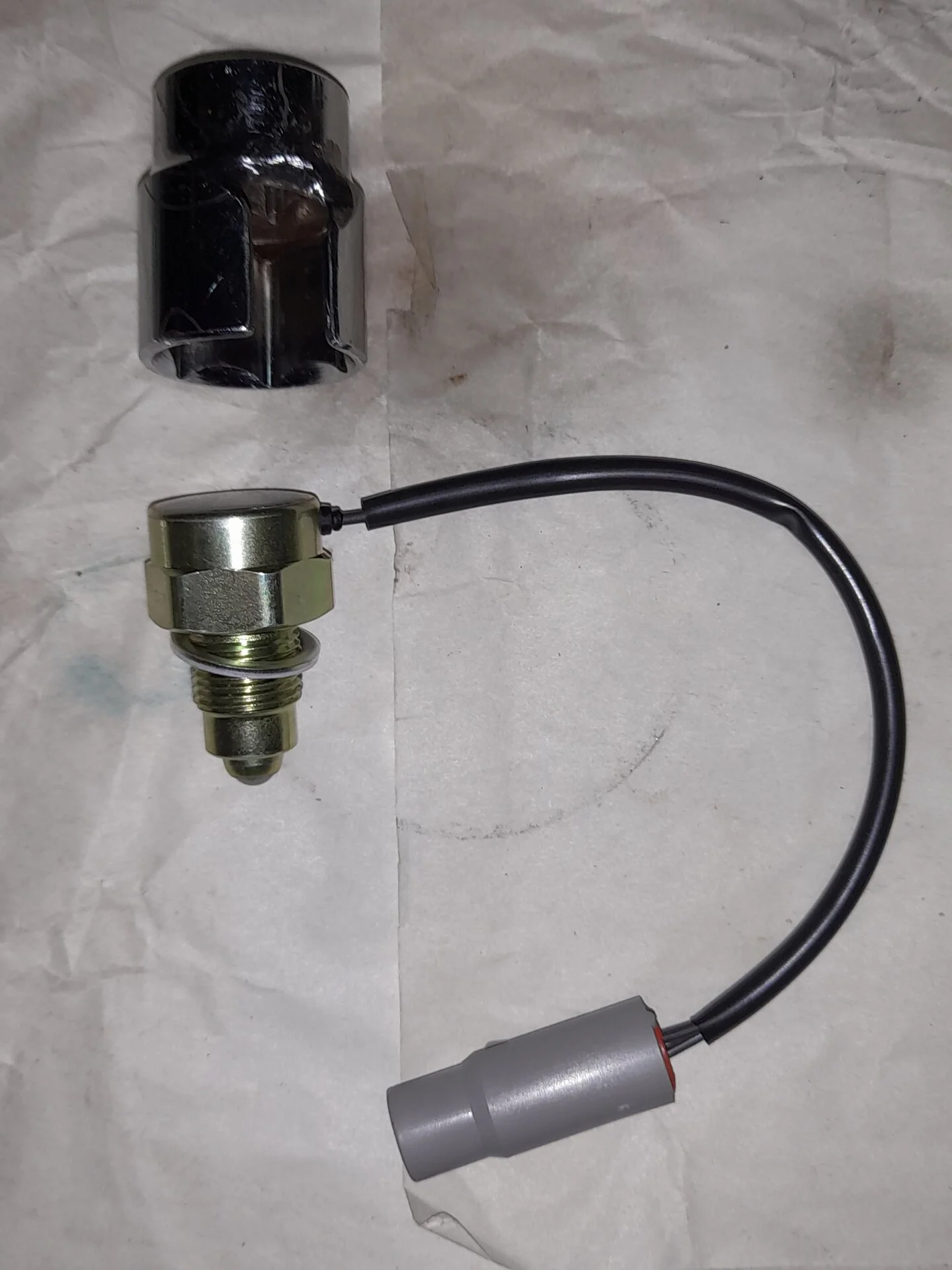

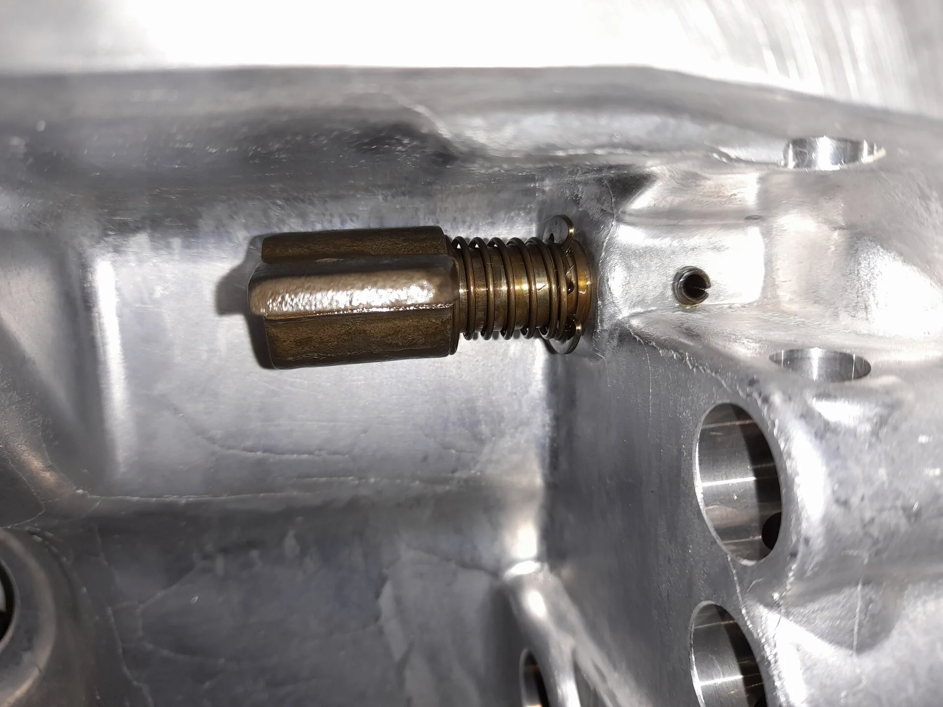

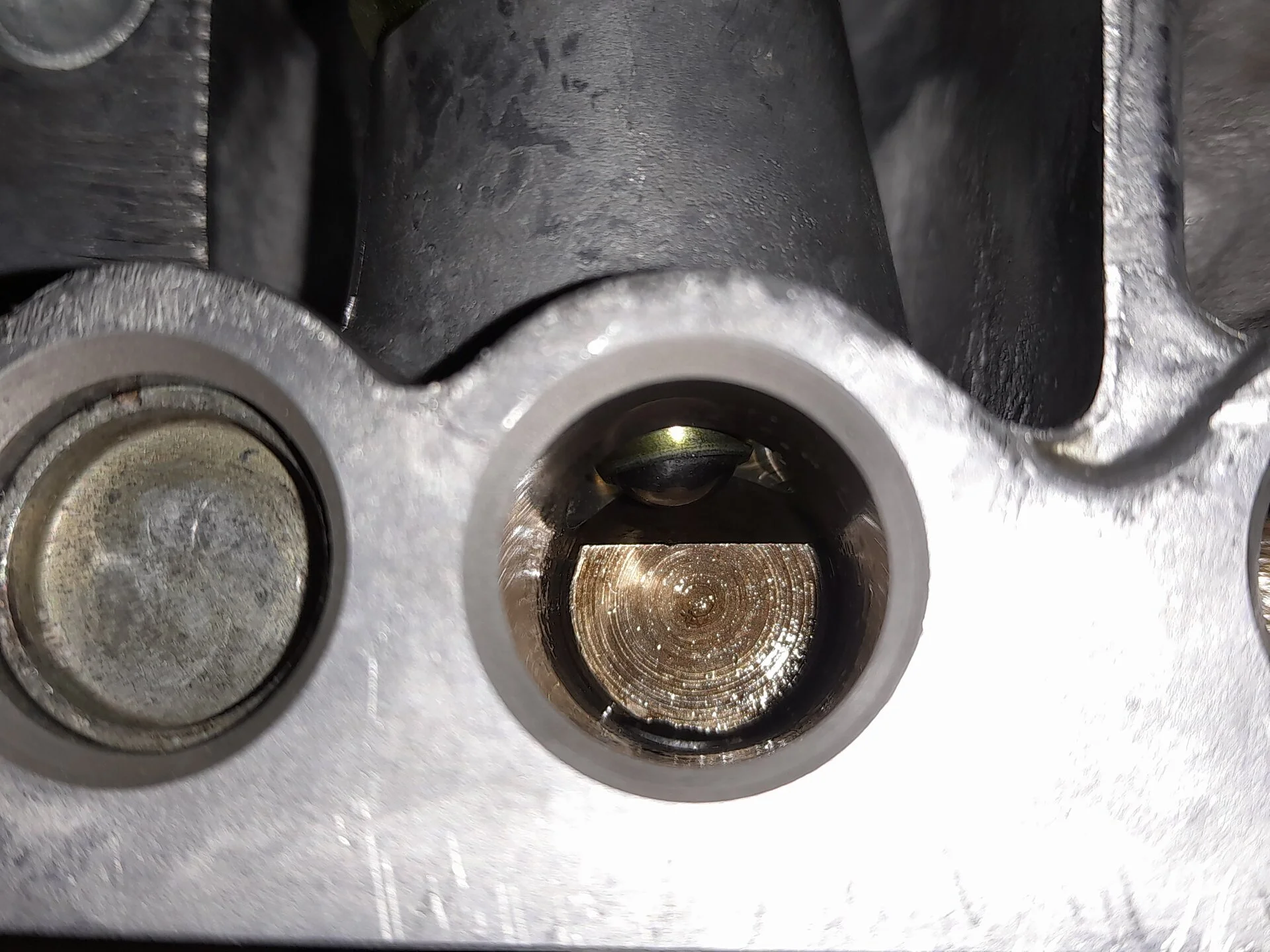

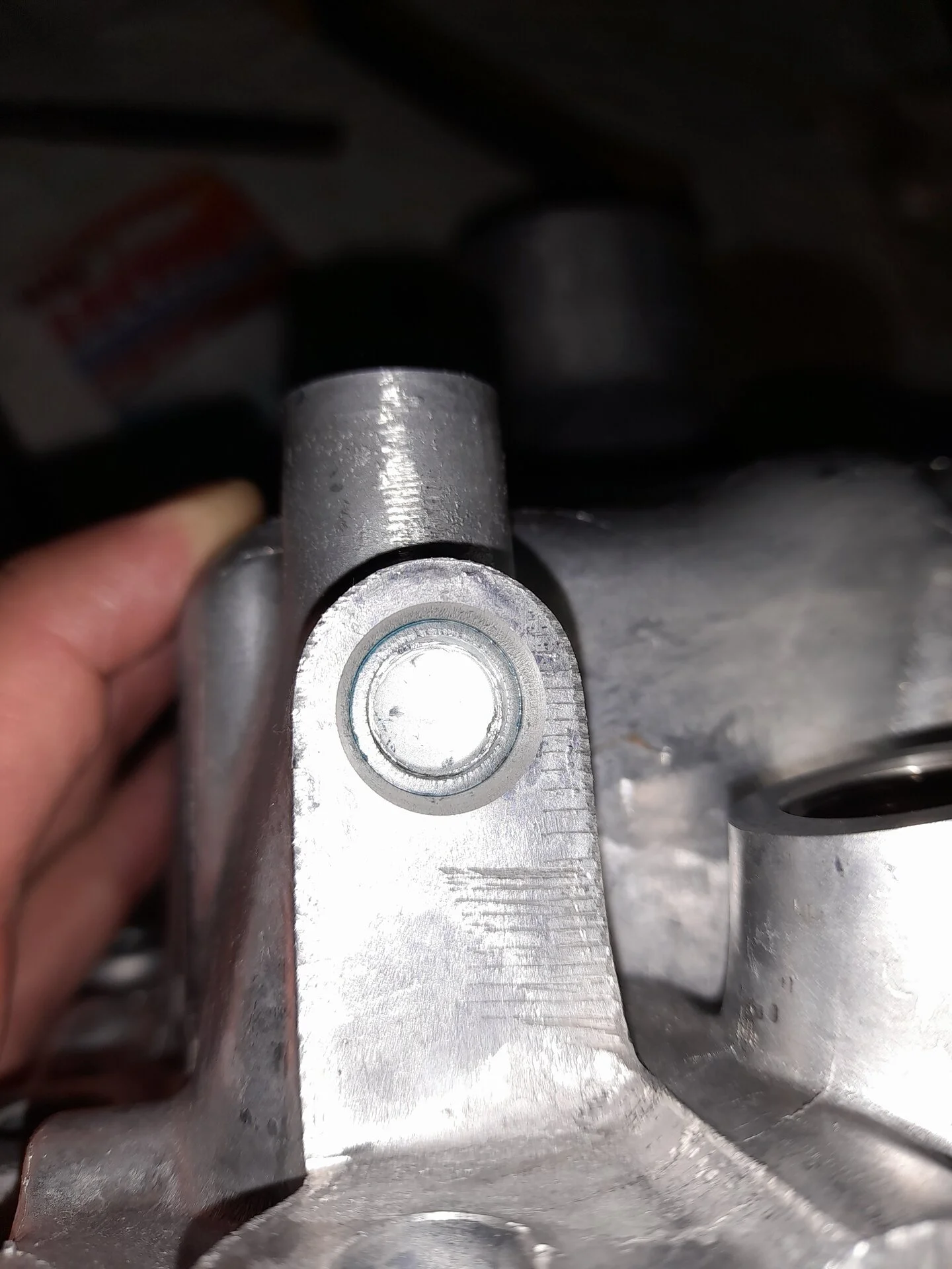

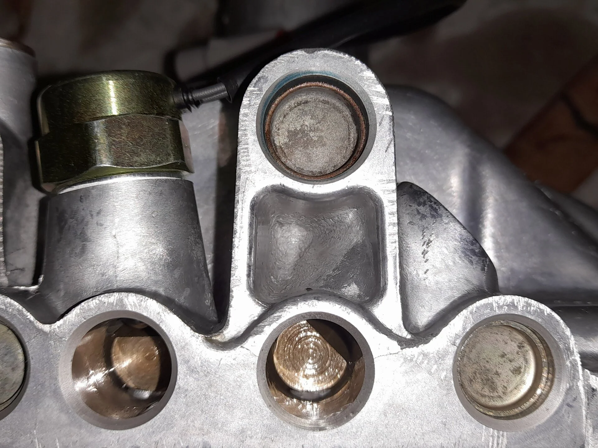

Now for the Welch plugs. Before adding them all, I took a look at how the reverse light sensor works:
Just along there is the casting provision for another sensor, which is not drilled or tapped on this cover. Some Japanese 60s came with something called a 'shift point indicator' sensor, which was activated by the third-fourth shift shaft, presumable when the transmission is in 4th gear. I can't think what use this would possible be.
Time to finish the Welch plugs. Front:
...and rear:
Now time to use my home-made SST to torque the reverse light sensor into the case cover and it's ready to install later on.

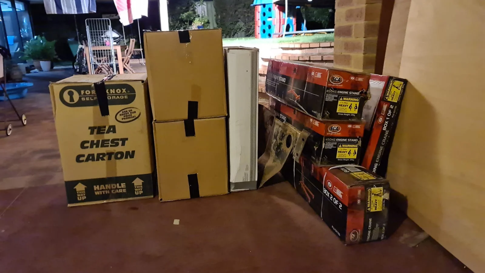

Anyway, now living in Perth, Western Australia, I got back in touch with Andrew and asked if he could hold some parcels for me. Foolishly, he said yes, and then his garage started to fill up. When a colleague was moving from Perth to Brunei with an almost empty shipping container, it was an opportunity too good to miss.

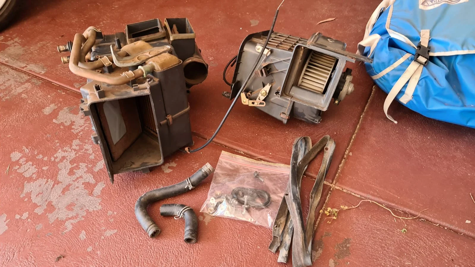

Amongst the bits that arrived were all the HVAC parts - here factory heater unit complete with heater core and pipes, and a factory blower unit.
Australia is a treasure trove of used Landcruiser parts. So eventually my parcels became boxes and boxes of used Landcruiser 60 parts, two engine stands and an engine crane...
...packed in Andrew's Subaru.

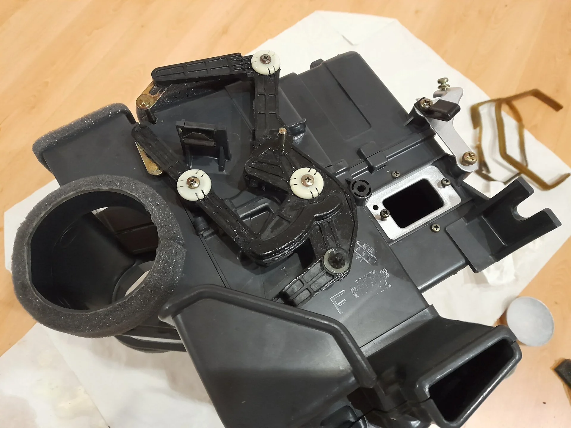

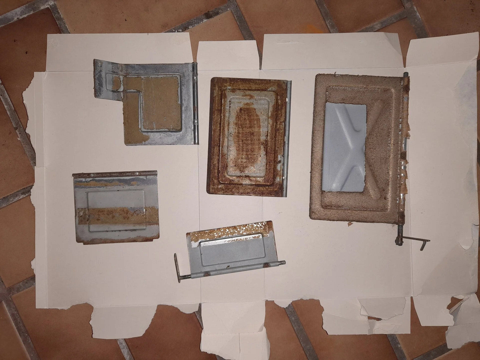

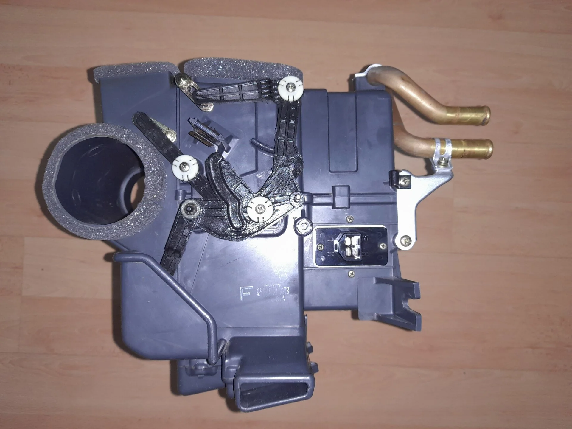

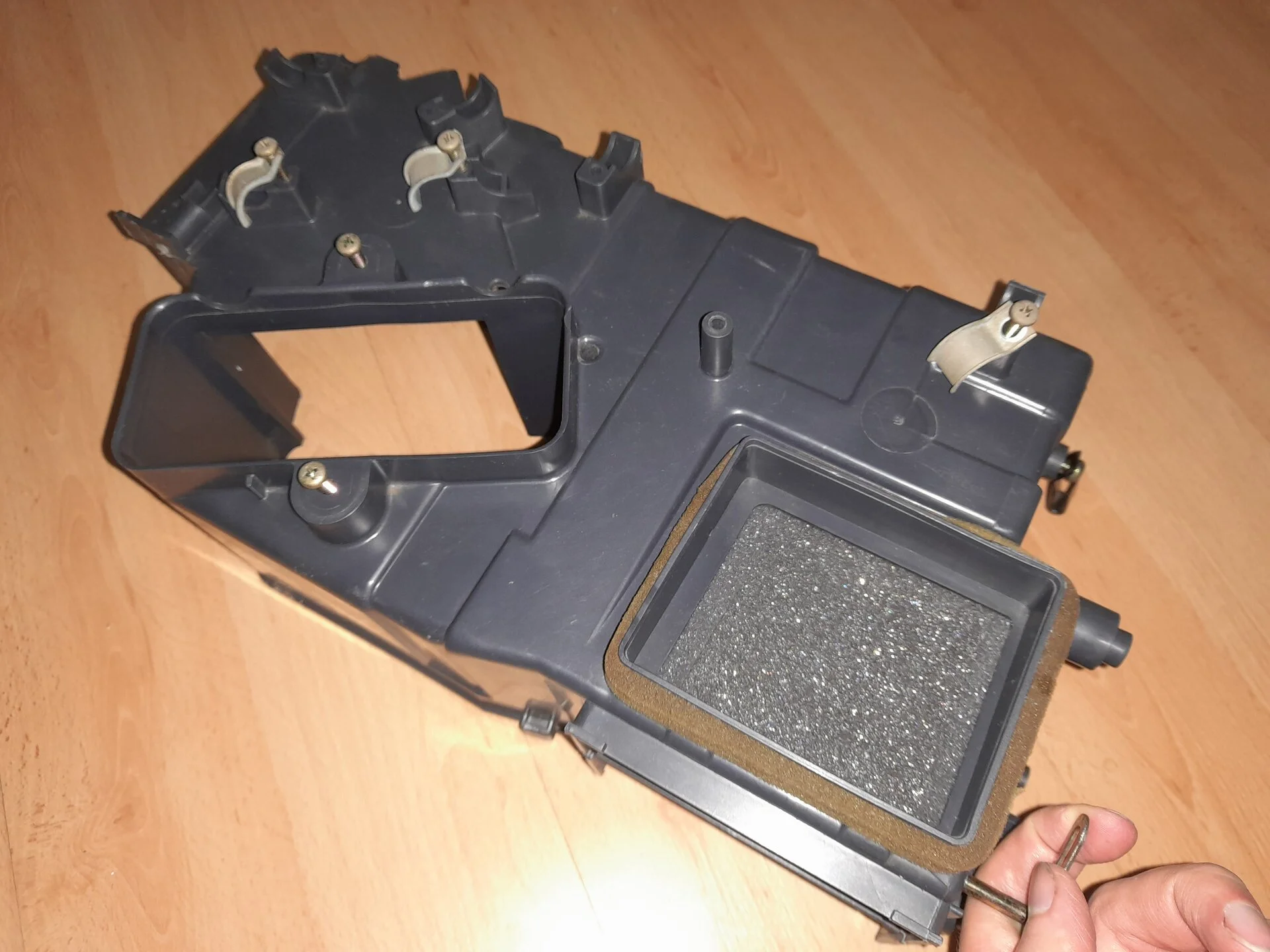

Unlike the blower motor and A/C evaporator units, in the case of the heater unit I was able to re-use my original. All it needed were the heater core, pipes and any associated clamps or brackets from the Australian donor.
First thing was to dismantle the heater box, clean the plastic and renew all the flaking foam on the paddle doors. The foam can be scraped off, but the glue would not budge with anything weaker than dichloromethane (methylene chloride).
After cleaning:
Cleaned plastic cam arms:
Assembled linkages:

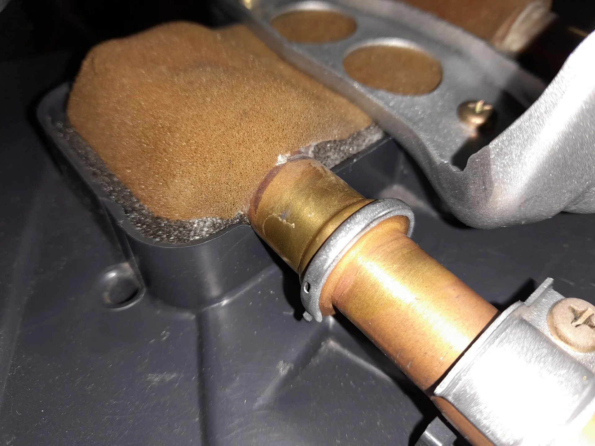

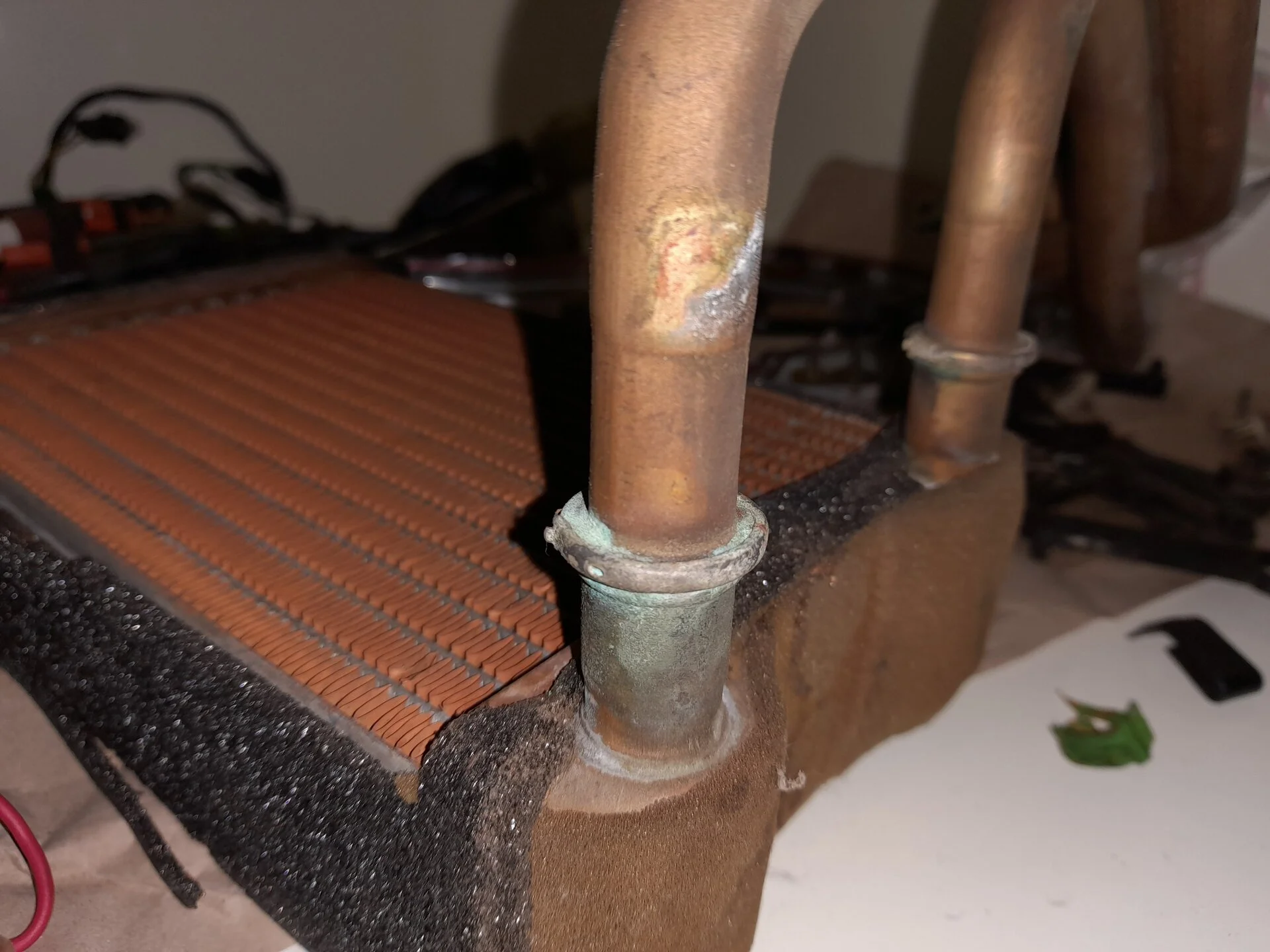

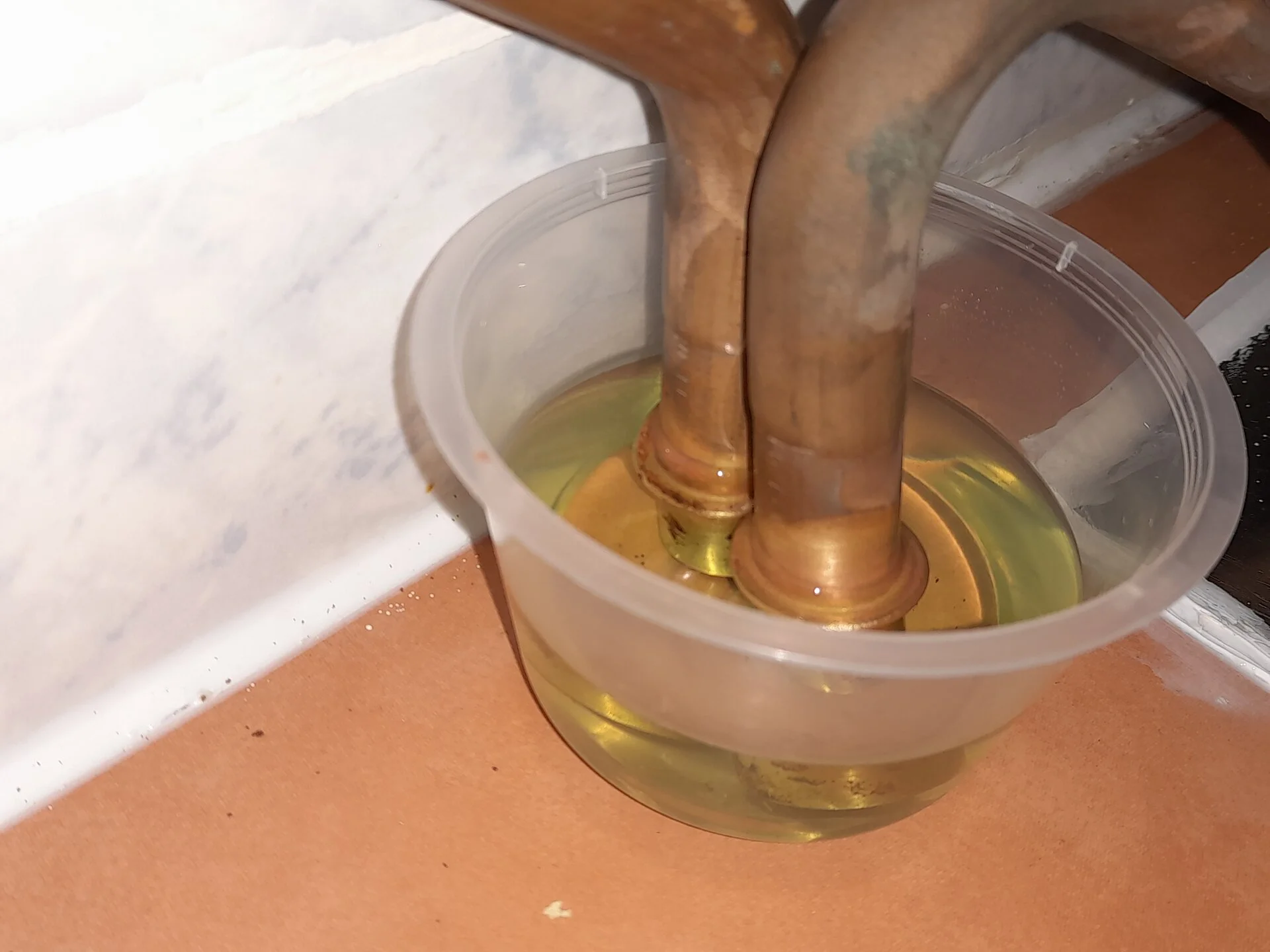

The all-important heater core seemed to have some possible leaks around the joints with the pipes that go through the bulkhead. They look like the kind of connections which don't like being touched, but I'm going to try anyway. Leaks from the heater core once the car is assembled would be infuriating.
A touch of corrosion on the ports, but otherwise the heater core appears to be almost perfect.

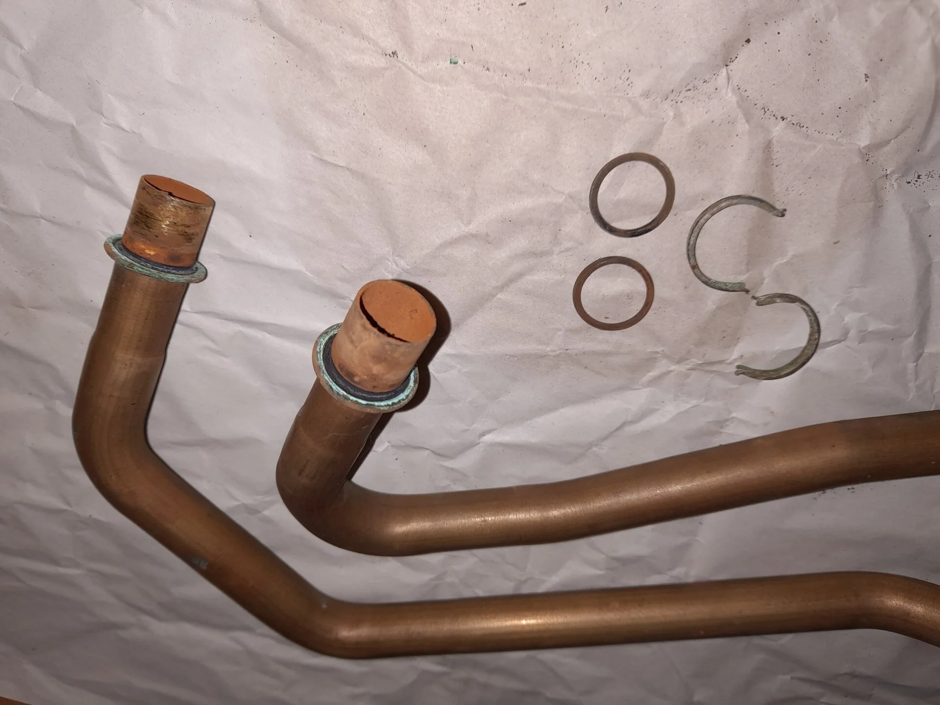

Pipes look pretty fine too. The all-important C-clips, which cannot be purchased, survived removal with no damage or distortion that I can see. The corrosion on the joints is quite clear though, and I can well imagine they would have leaked. The O-rings are fine and still feel surprisingly supple, but will of course be replaced.

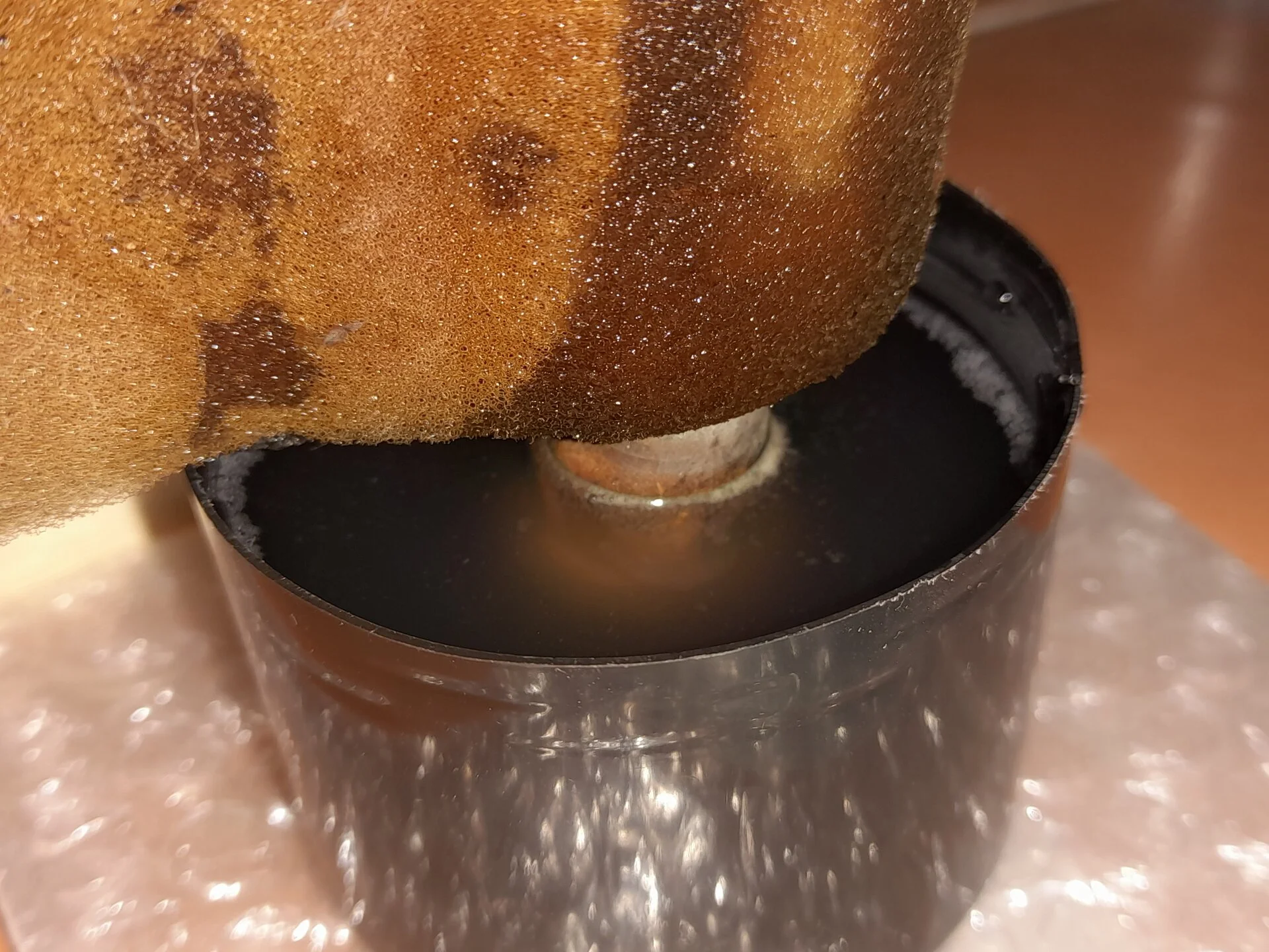

Time for some citric acid cleaning.

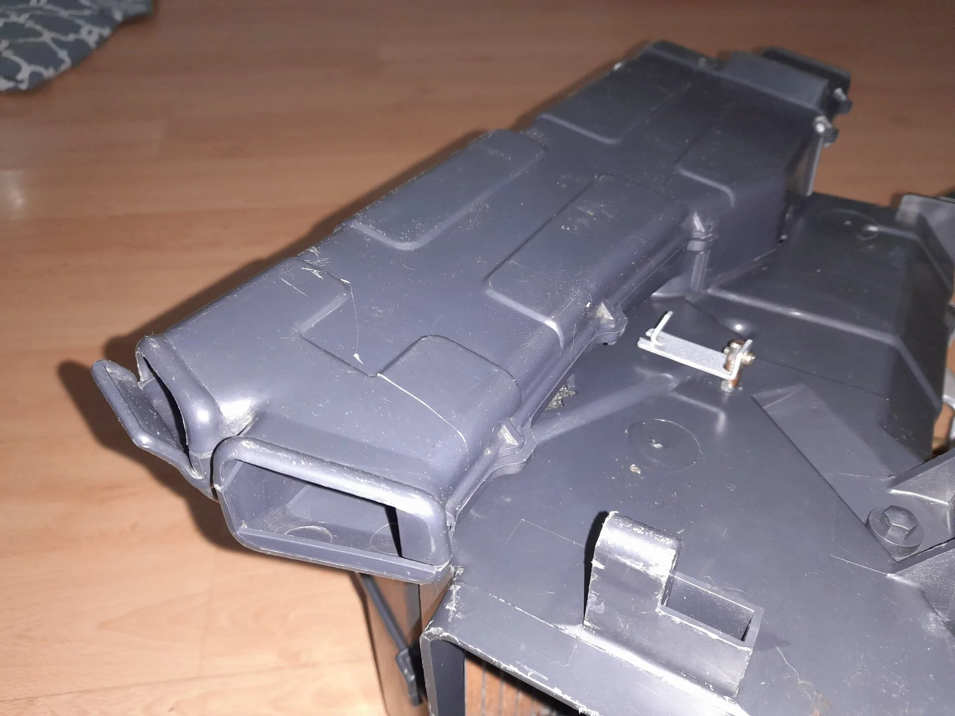

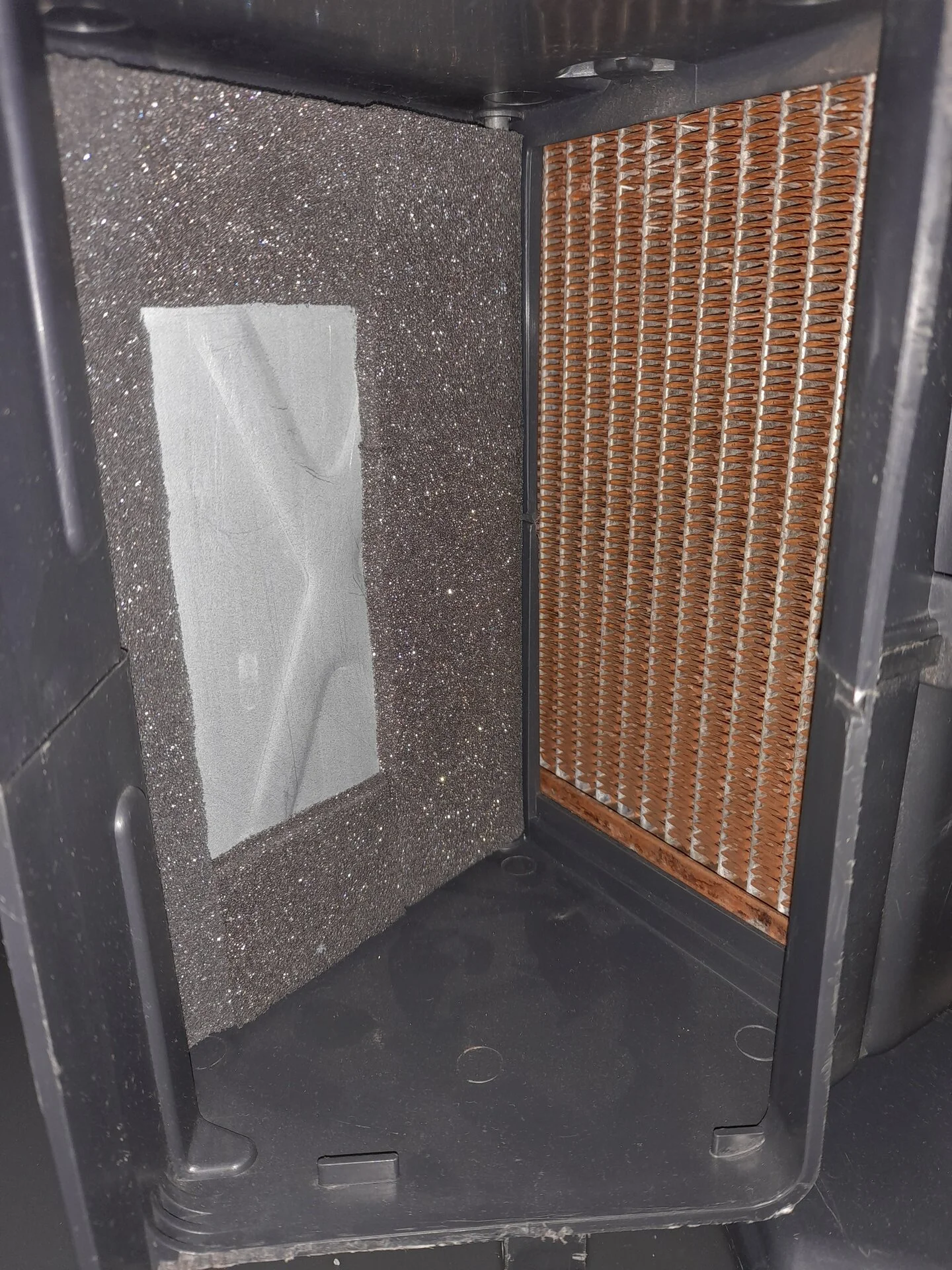

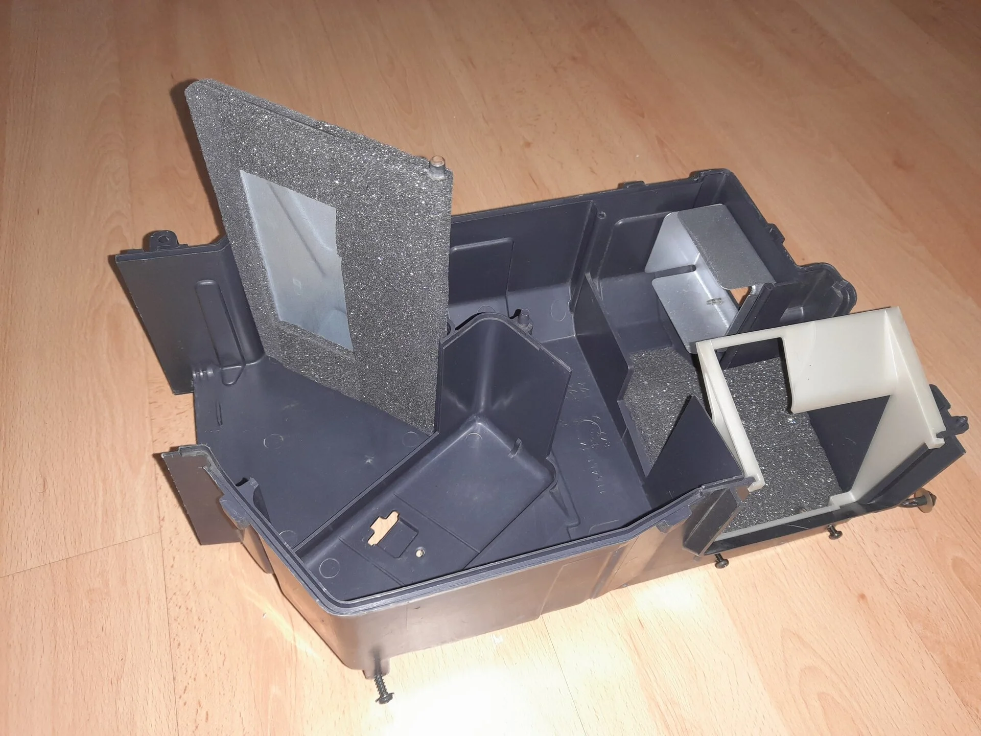

Assembling the halves of the box with the recovered directional air doors. Since there was no heater in the original heater box, this big bypass door which switches air flow to/around the heater core came from the Australian box. The original box even had a rubber piece to plug up the hinge hole for the door. Same for the white plastic insert which is involved in directing air to the foot-level register.
Top half
Originally, the box had a blanking piece over the aperture for the heater core, which I have removed. Feels odd to screw those pipe clamp screws into previously unused holes.

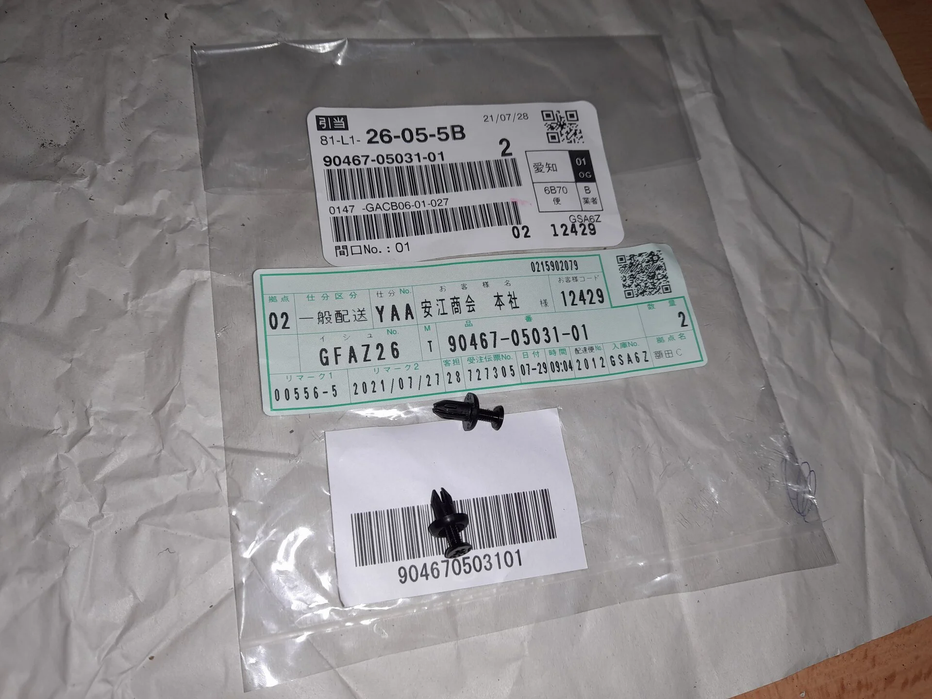

The original box had no foot-level register, so new plastic rivets are on hand:

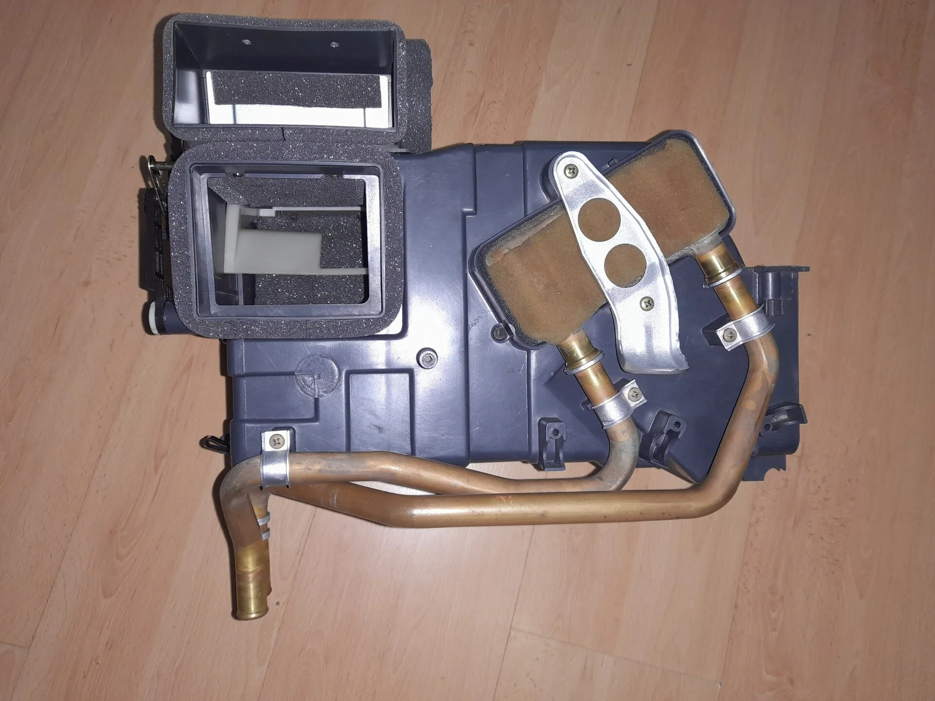

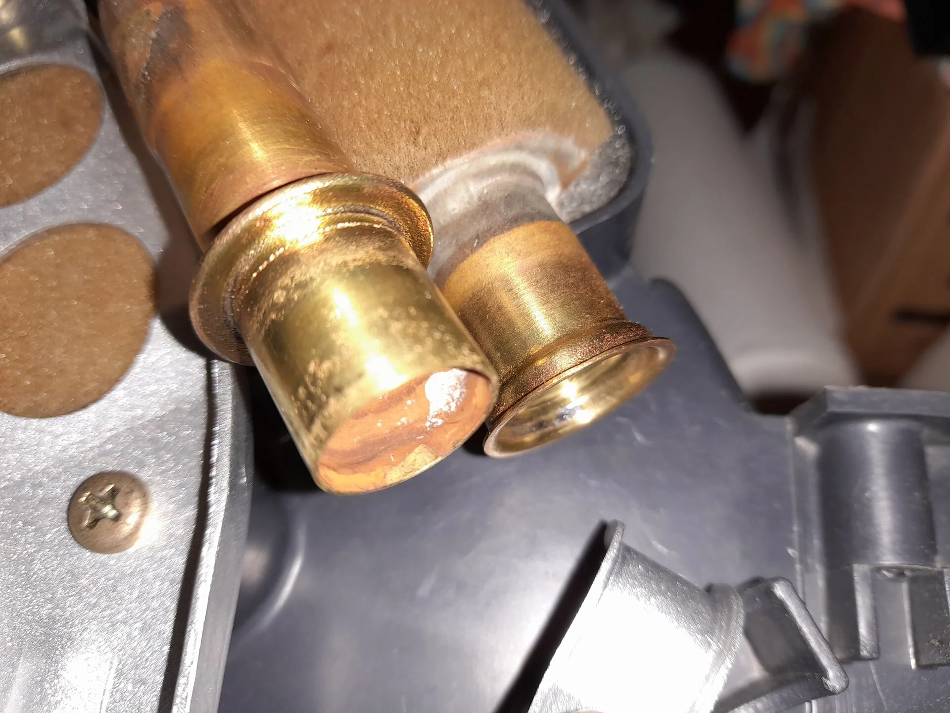

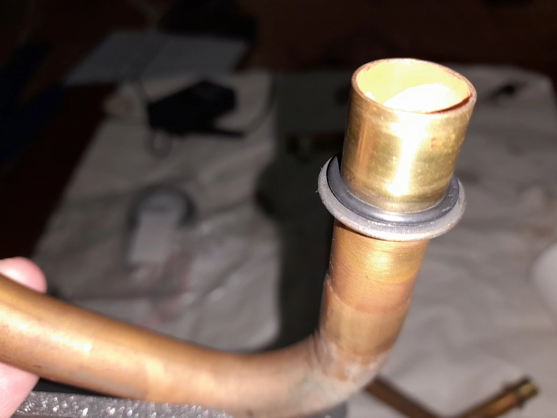

The brasswork cleaned up nicely, the metal has a nice shine but is pitted from corrosion:
New O-rings are on hand:
I put the tiniest smear of Permatex Ultra Black RTV where the O-ring seats, but not on the O-ring. Just enough to make the surface sticky:
Pushing the pipes into the ports of the core, the C clips push on and make a satisfying snap as the seat:
Very happy with that.

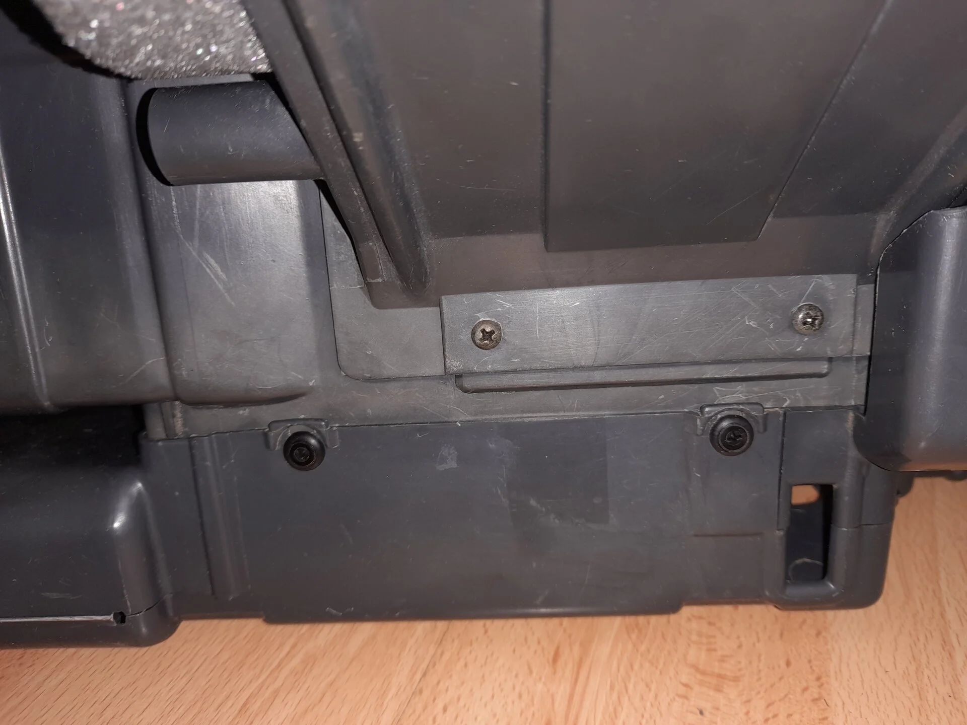

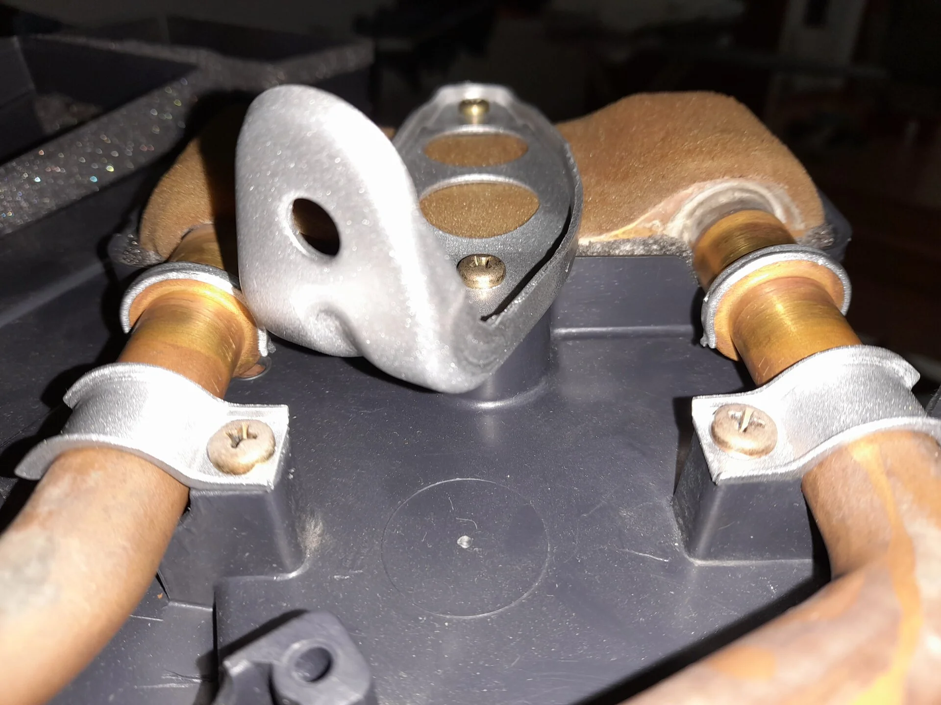

Finished. (Actually sharp-eyed watchers will notice that some of the spring steel clips which hold the box together and clamp the cables in position are missing - I am still overthinking whether to clean them in acid or by electrolysis....).
I'm not so keen on the silver spray paint approach, bubt Toyota left these pieces in bare steel, so I need to improve on that. Zinc plating would be great, but it's not available here in Brunei and well, maybe a bit OTT for something that will rarely be seen.
I've used silicone grease on the plastic moving parts. Not sure if that is a good long-term idea... any opinions? I wanted to avoid spray white grease for fear of making the plastic brittle over time, but the original factory grease was white and probably lithium/oil based...

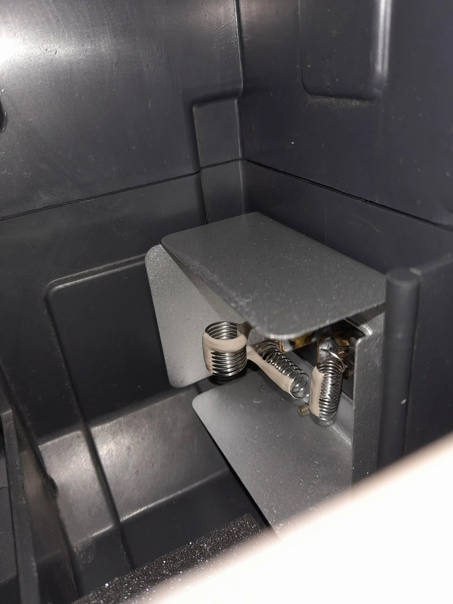

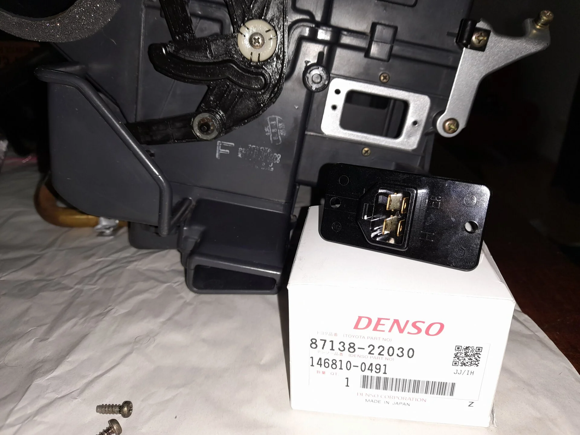

New resistor:
