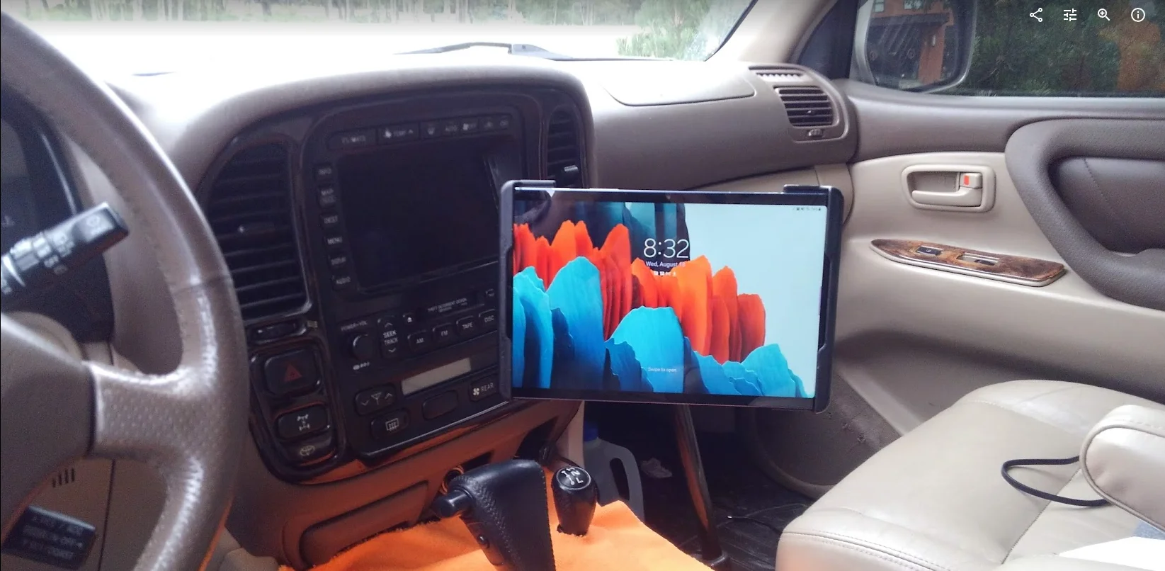

Mount to floor with RAM seat mount or to the dashboard with BenCC creation
Using the Owl media mount in my 06 with a iPad mini. The mount with RAM parts works perfectly

Ram mount is the universal floor mount Jerry rigged to fit to our seat rails. You loose a little bit of front slide on the seat. I can take some pics and report back if interested.
Then dash mount is bencc creation and works great but wiggles a bit when off road using full size tablet , floor mount is rock solid and allows the passenger to run the tablet as well

Agreed, the dash mount and a full size tablet don't mix well. On washboard road it will pull the dash off a bit and shake . It's meant for smaller payloads
I'll get you a pic of that universal ram floor mount tomorrow. I think you can even secure other ram mounts to the bar with their clamp style mounts .Like tablet mounted up top on the ball head and phone or gps popping out from below.

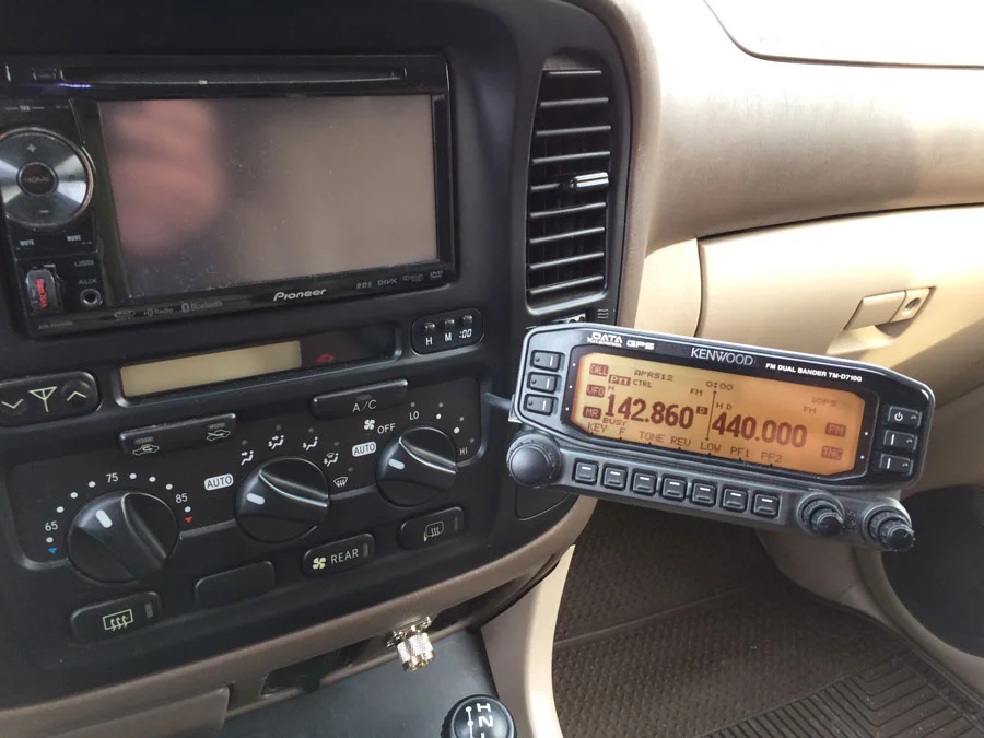

Installed a Kenwood ham radio using one of @BenCC's mounts and moved the tablet down to the center console using his change holder mount. Very stable.
kenwood-tm-d710g-jpeg.2932116
