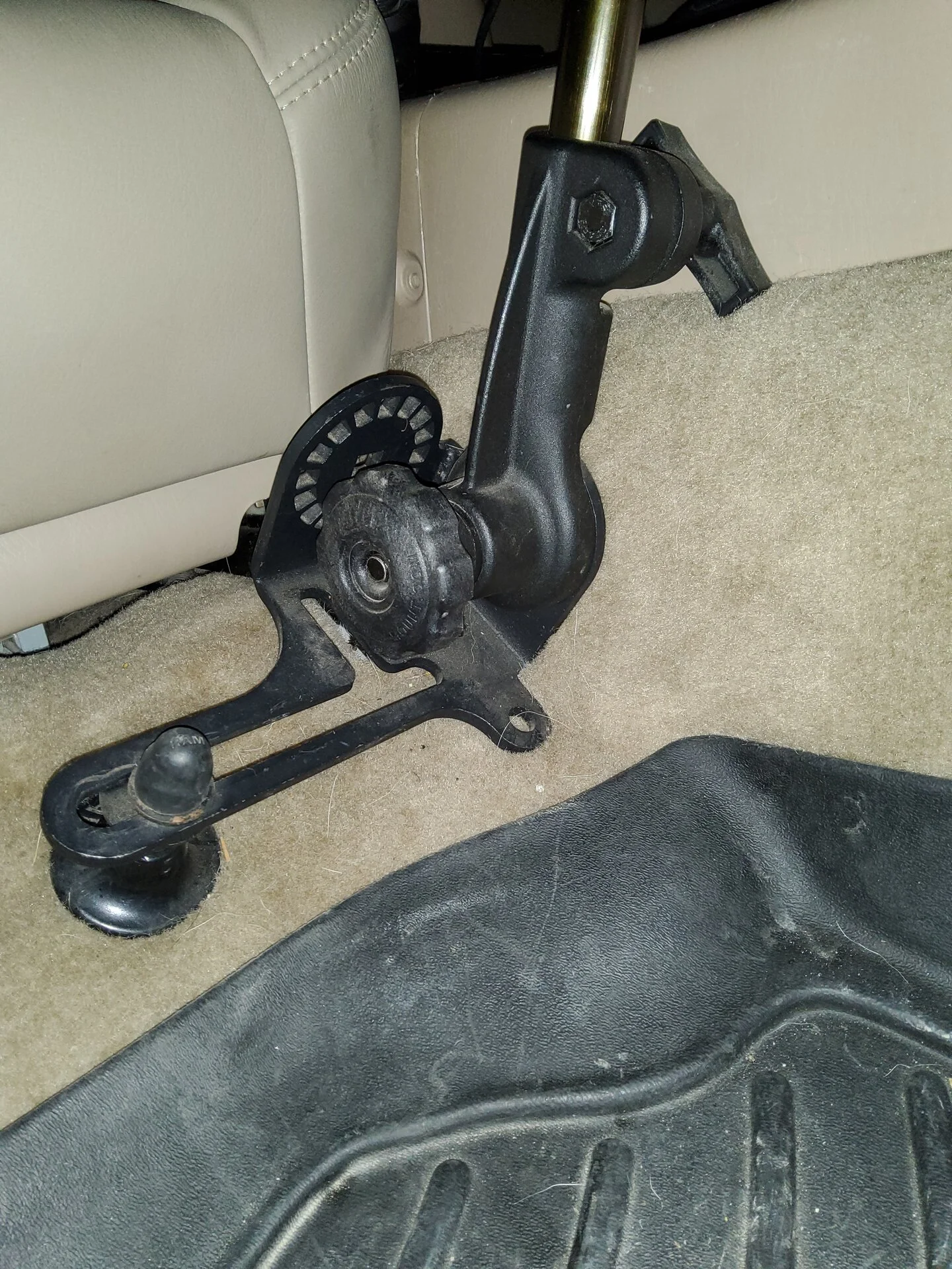

I think it's intended to be installed differently, I'll share more details / get more pics when I'm at my computer. The seat bolt is hidden back there but that's what it's mounted too....But this has held up for many years. When not in use , you can unscrew the knob by hand and remove the pole. It fits in the side door pocket and comes out for the bumpy roads .
Seat can still go fully back but can't go fully forward, I have the SS1 sleeper with mattress and it still has plenty of space

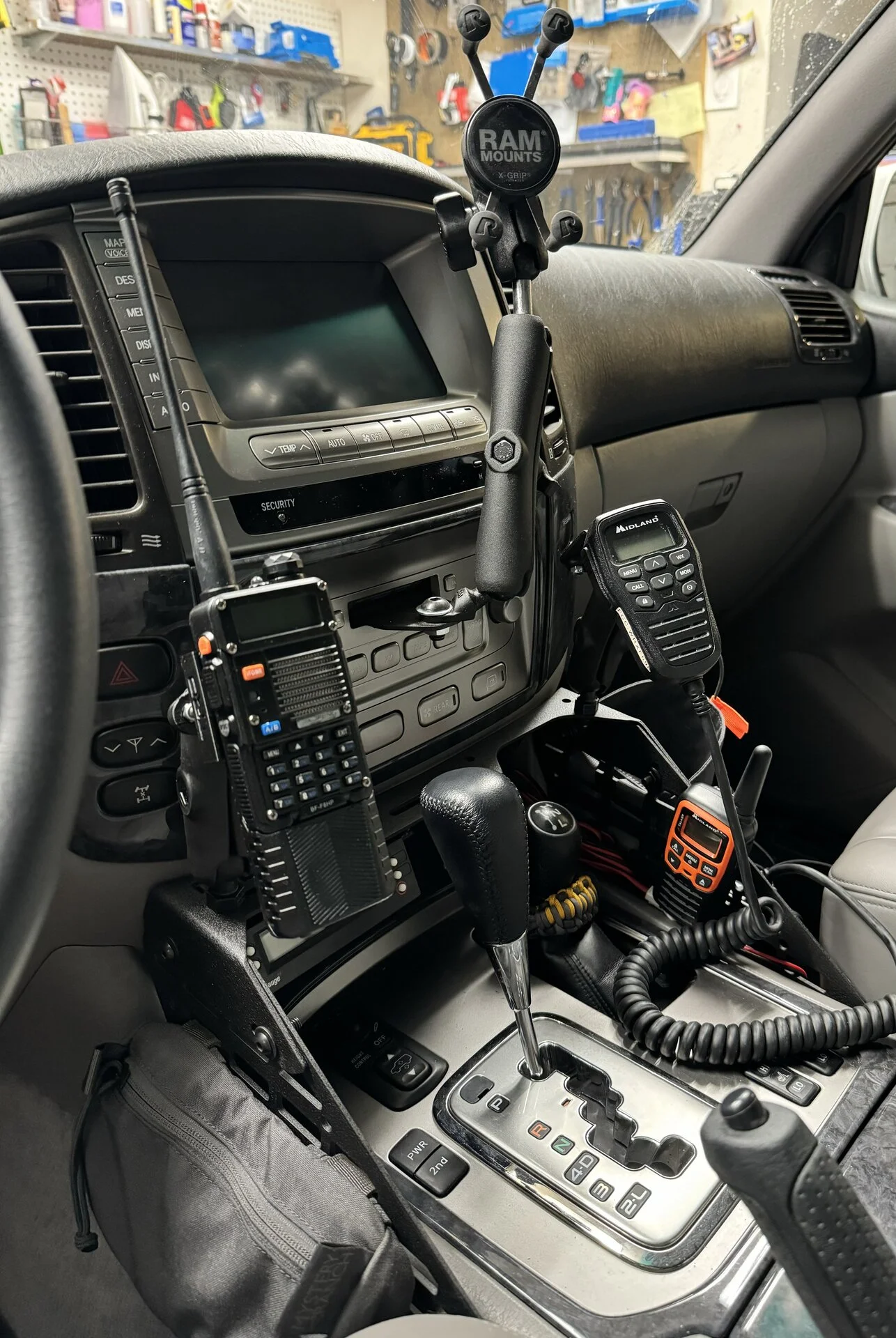

Installed the ohana stealth panel last week, minus the center adhesive bracket, tested on some fairly rugged trails and washboard Saturday with no noticeable wiggles or squeaks- seems pretty solid.
Still working on my ideal device layout- also have owl expedition media mount (with iPhone mount beanstalk).
iPad mini will probably trade places with OE media/iphone mount when the new model comes out later this year.

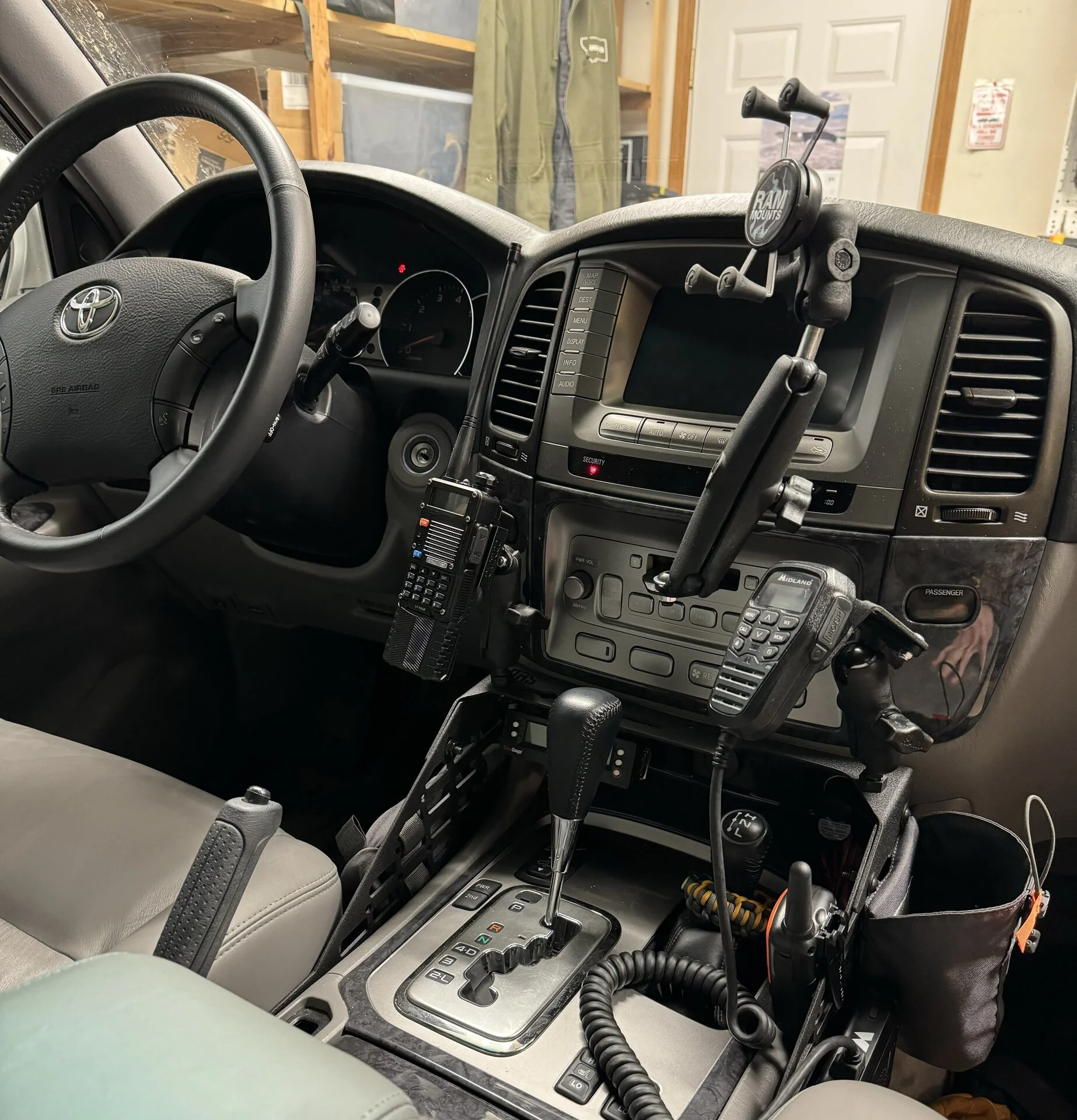

Here's a photo. I used the Make 6 V6 Change Pocket RAM Ball Base Mount and then added a couple extensions and attached the tablet with a tab-tite holder.
It's been really solid off-road - no complaints about movement, etc. I just set the HVAC controls to auto, so no need to adjust. Plus, I have a small remote for the head unit so don't have to use the touch screen or buttons.

land-cruiser-center-console-tablet-and-ham-radio-jpg.2182149
