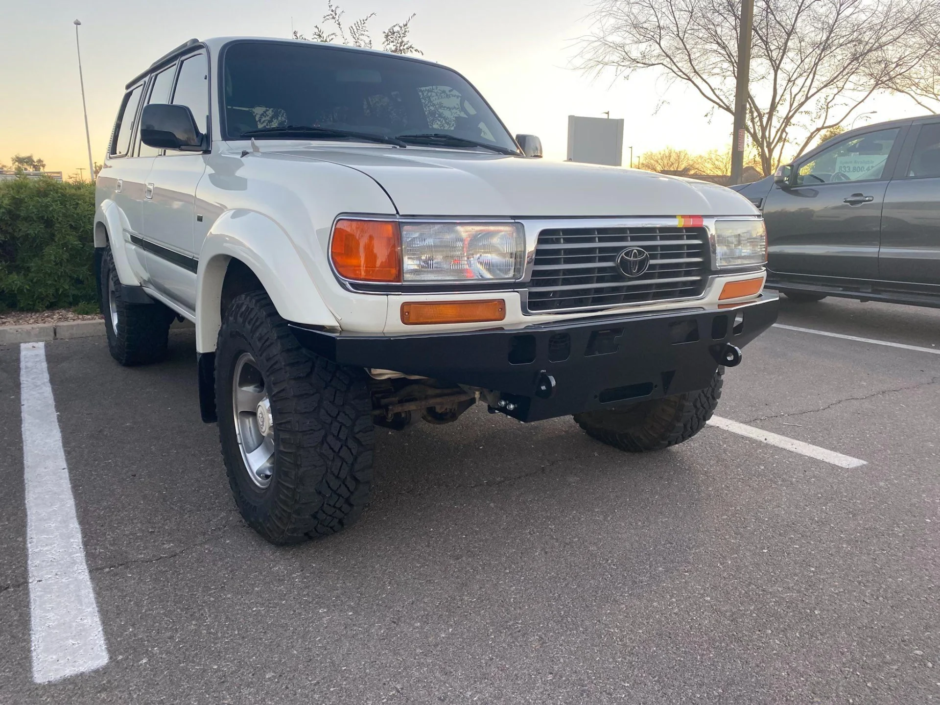

Bumper installed:

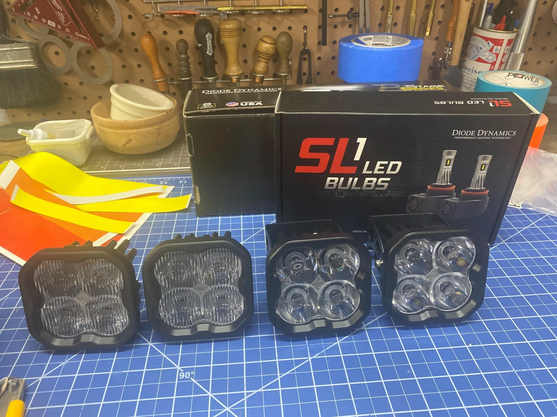

Diode Dynamics SS3's with amber back light are here, need to decide how to do the electrical distribution and then these will be installed:
Also managed to get the Diode Dynamics SL1's installed in the low beams. I had these on my 100 and they are great, high quality LED replacements that don't blind anyone. The trick is that they approximate a halogen filament (thin) and send the light in a specific pattern (to the sides, you have to orient the LED relative to your housing so that it sends the correct pattern). Much cheaper than a full projector retrofit and much simpler. I ordered 9006's for the low beams, left the high beams alone.

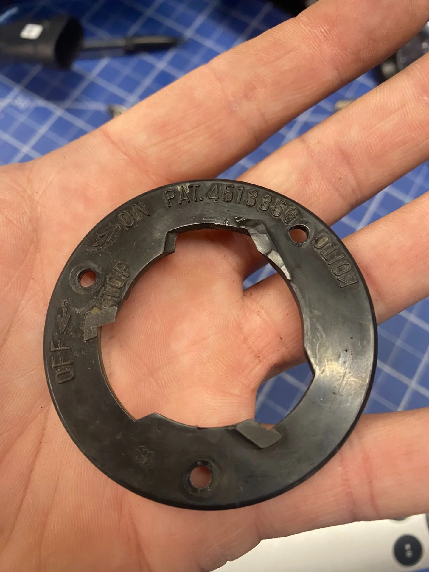

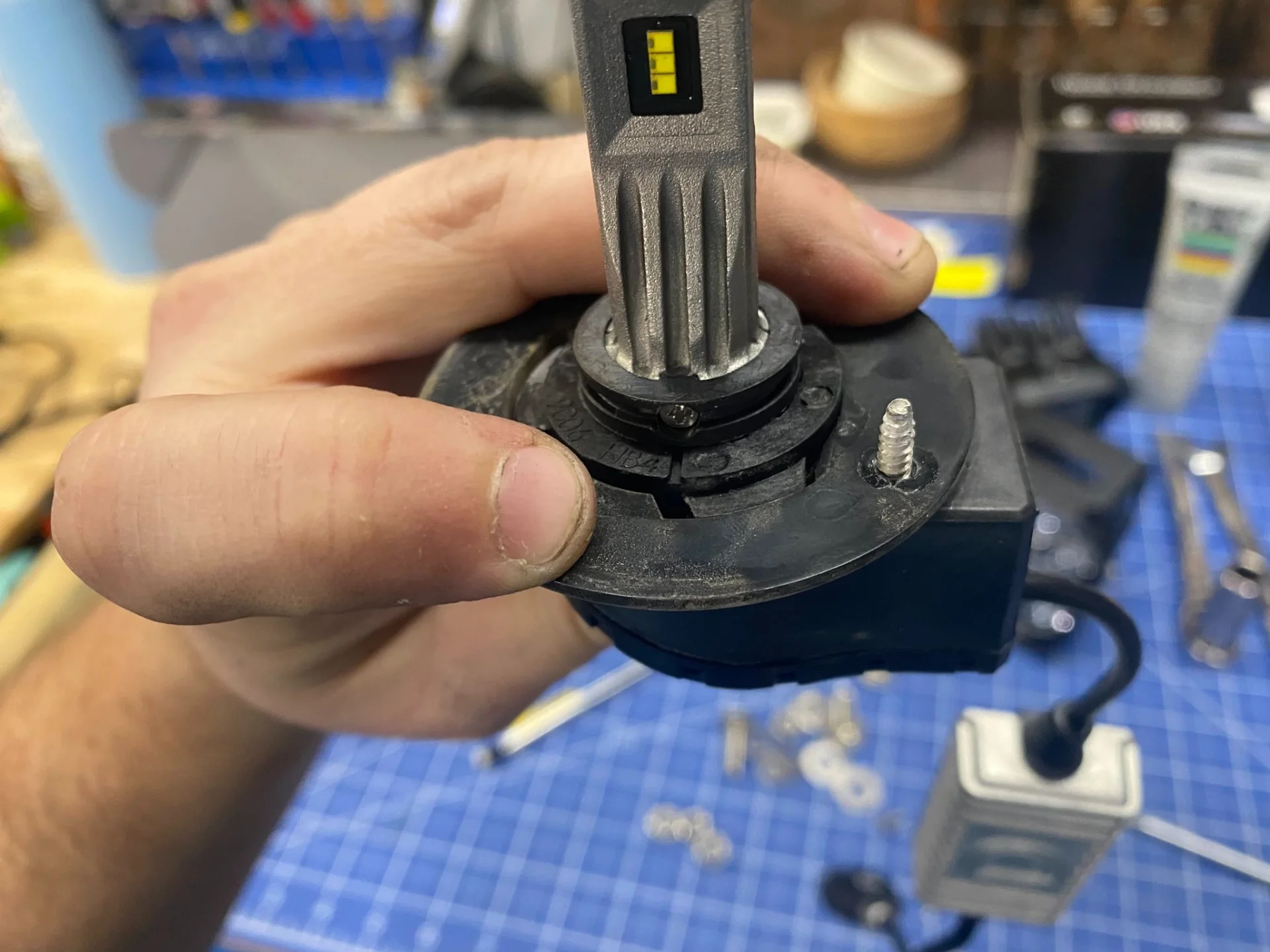

  • There are three humps that interfere with the SL1's body and prevent the tabs from inserting into the headlight housing enough to engage the tabs. With a razor blade, or sand paper on a flat surface, you want to remove some material. Don't go crazy as you need a little bit to help retain the bulb. I took them down about half way. Attempt to fit the removed rings onto the bulbs and it will all make sense, see pictures below:
Ring on headlight showing why they wont fit without modification. Note that the screw seems to be far enough away to allow the body to flex and be installed:
The three humps make the tabs on the bulb run right into the ring, preventing the tabls from riding up the ramp.
Ring with material removed:
Lights stacked, SL1 below in black (look close). More space on the normal halogen bulbs:
  • Orient the bulbs so the LED's face as horizontal as possible (there are instructions on how to do this from DD), I use some dielectric grease inside the connectors and on the red orings to help install. Tip, it's best to have the back of the bulb face down (fan facing down, so that it wont collect water). Zip tie the ballast on each side as you see fit.

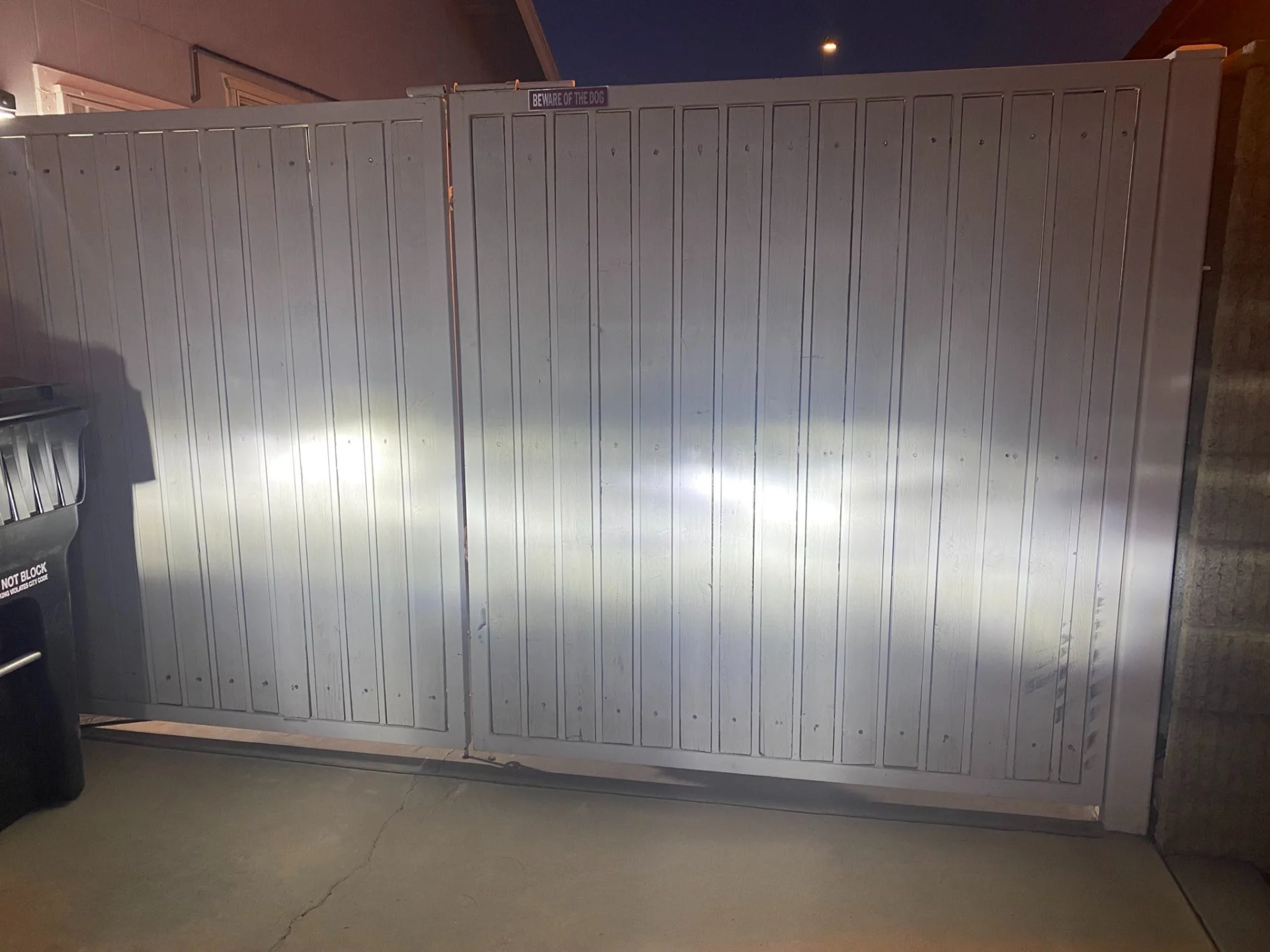

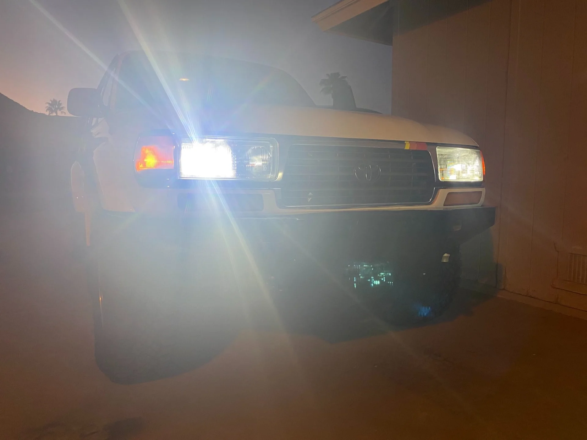

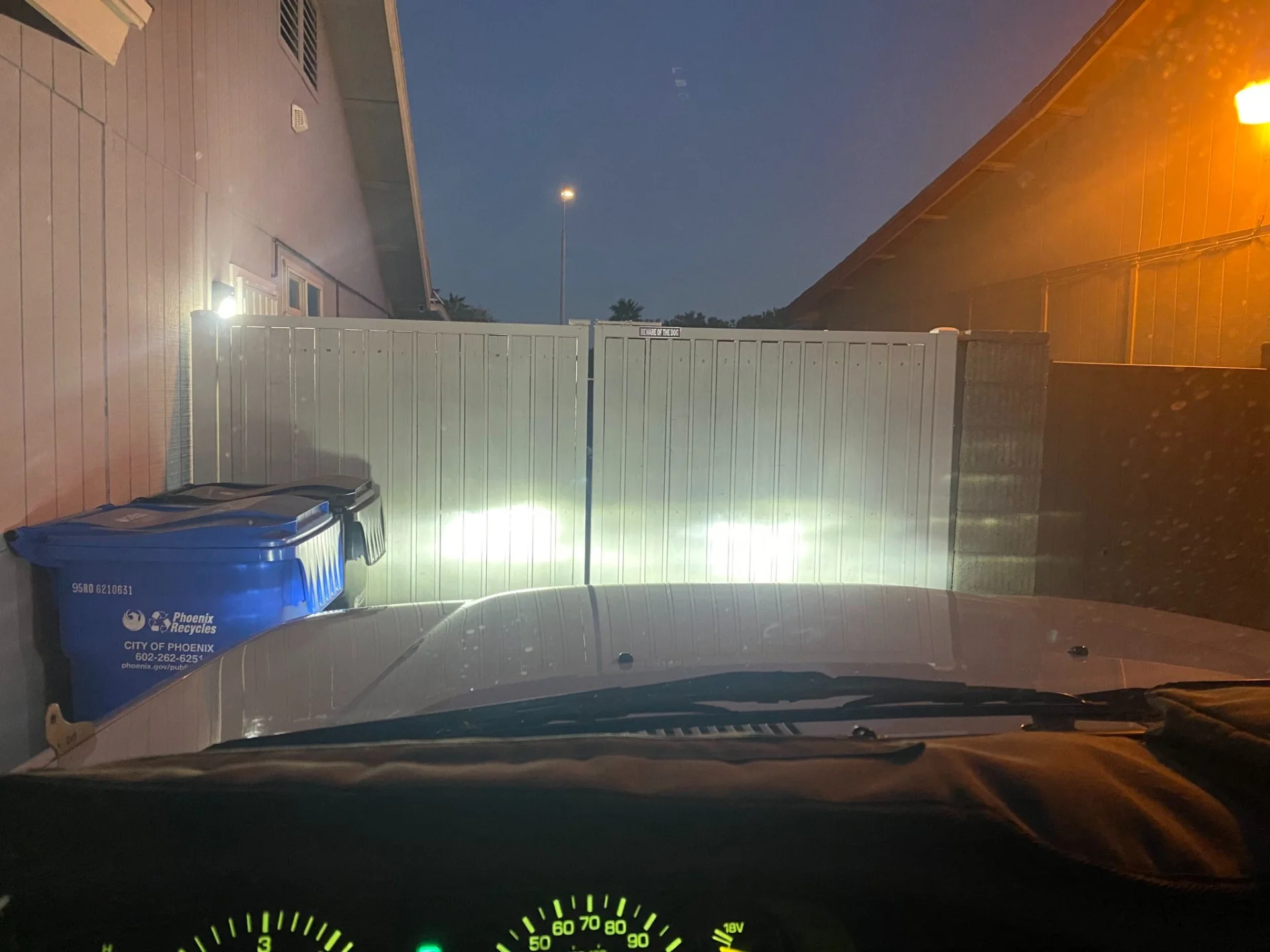

pretty decent cutoff considering 90's lenses and focusing.

Ok, have you run the ubiquitous Wagner 9006 in your low beams before? Comparison?
I like the idea here, but getting flashed by angry semis and blinding other drivers makes me leery. I’m not familiar with the 100 series lamp housing adjustments but as you say our’s are pretty simple. Is the output a massive gain or more moderate?
I have not run the Wagner 9006, so I can't give you a comparison, unfortunately.
I did a bunch of night driving on the free way and around town last night and no angry flashers. I was watching where my lights lit up signs and where they sat on the back of cars in front of me. Anecdotal, but, so far so good.
I am going to fiddle with some stuff today, If I get time when it gets dark I will put the original sylvania bulb in one side and get some comparison.
If you can buy these onsale (they do a 15% occasionally).... I would definitely do it:

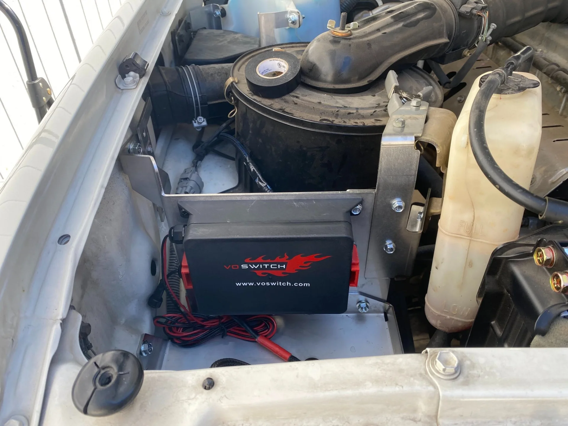

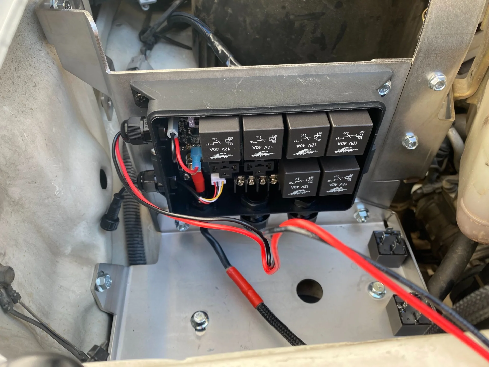

Using the Slee 2nd battery tray to mount the VO switch relay block:
Had to drill two new holes, picked up two existing at on the top.
This has 8 relays:

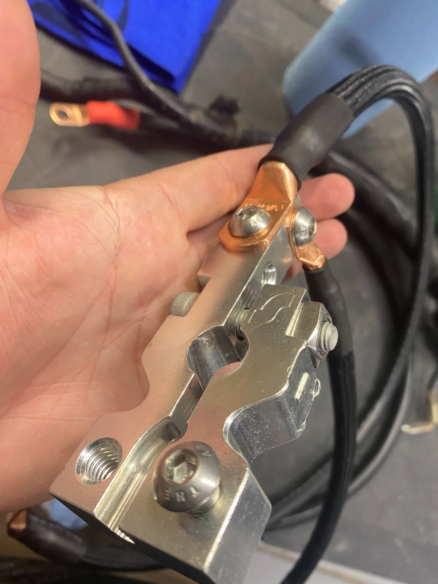

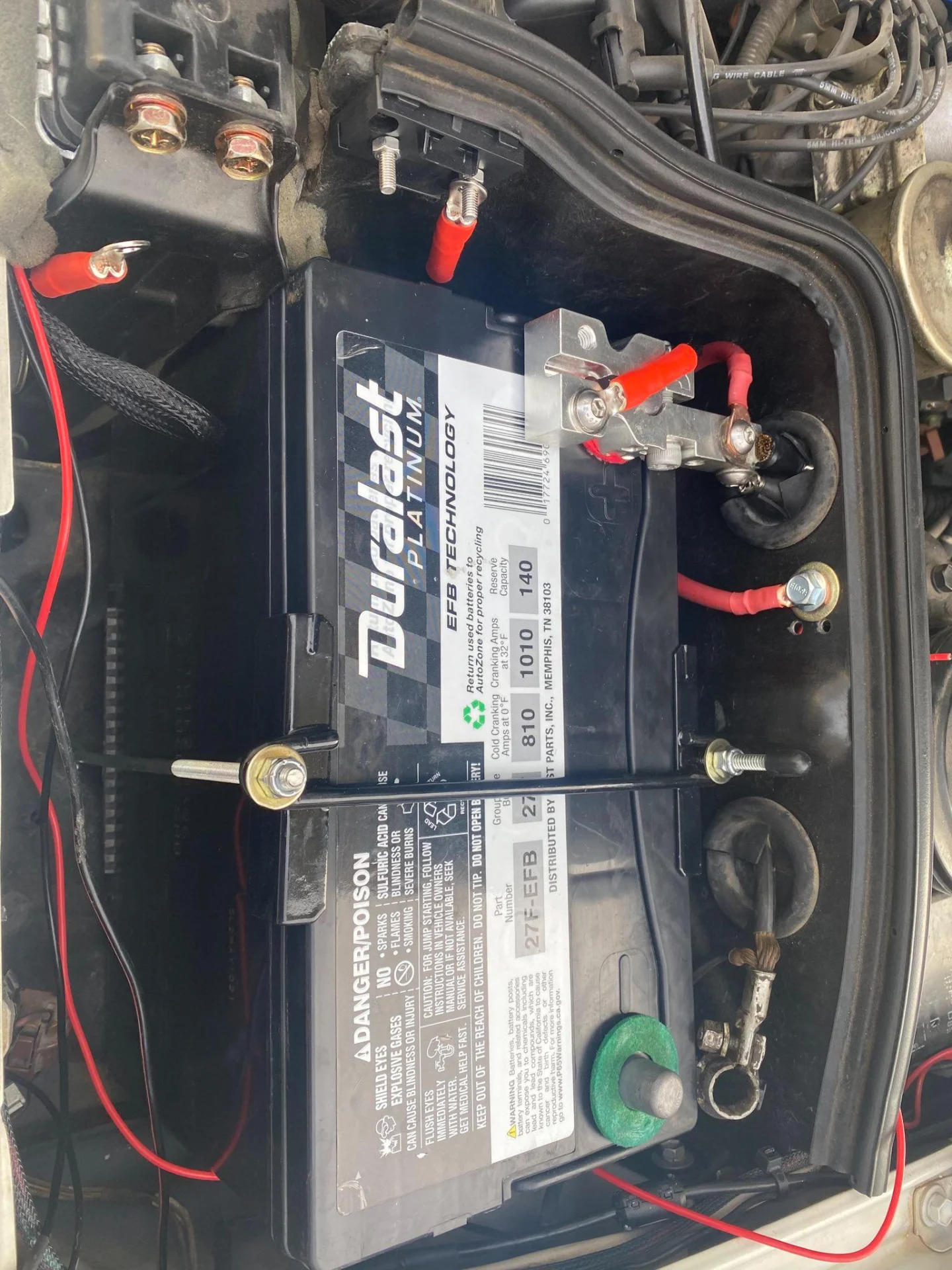

Installing the LCP battery hold down today, moving the fusible link to the bulkhead, and also installing Slee billet terminals :)

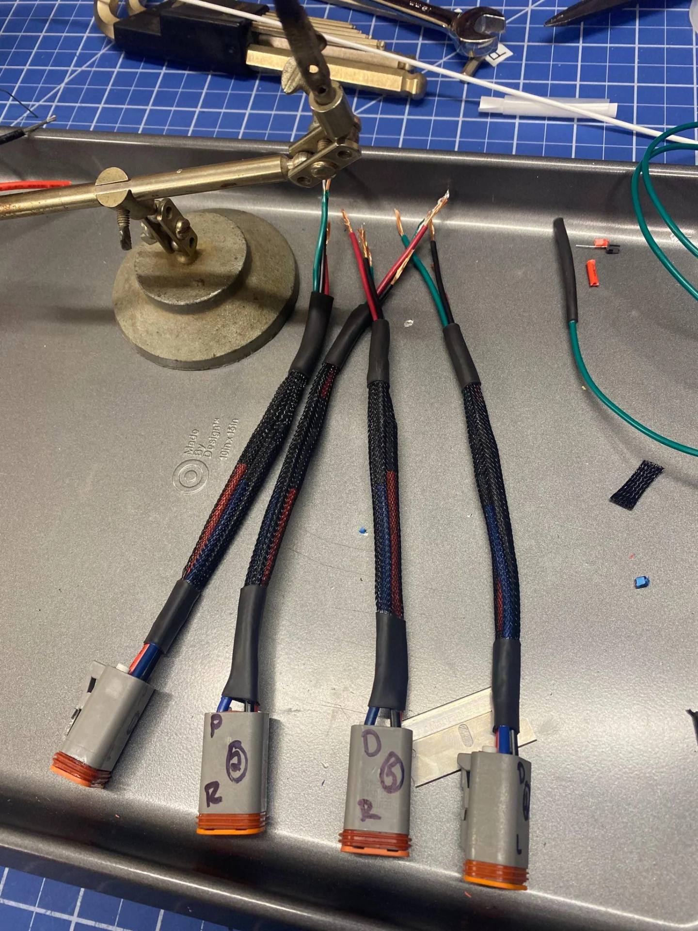

Jumping in to making a wire harness once I get the battery remounted with the new terminals. Plan is to tap into the corner markers to pull power for the amber back lights for all 8 lights (they pull in the mA range, so shouldn't be a problem). They also come with nice DT connectors :)

Wiring is moving along, didn't get it finished but I have most of the harness for the bumper done. Just need to terminate a few of the connections:

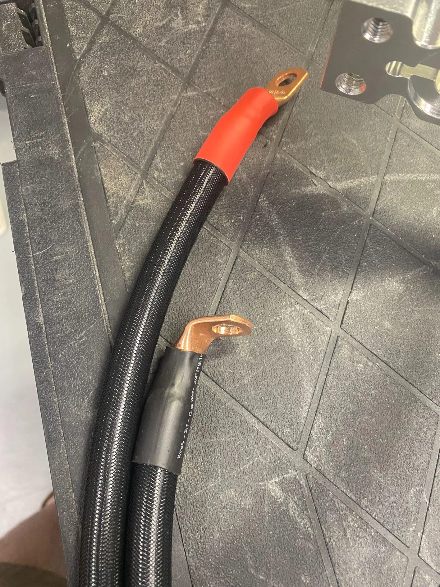

These slee terminals are sweet. Seen here with the LCP battery hold down and fusible link relocation (red 4awg(i think) wire going to the back of the battery box):
I am waiting for my hydraulic crimper and fancy terminals to finish up the install for the negative terminal.... and make some new ground straps :)

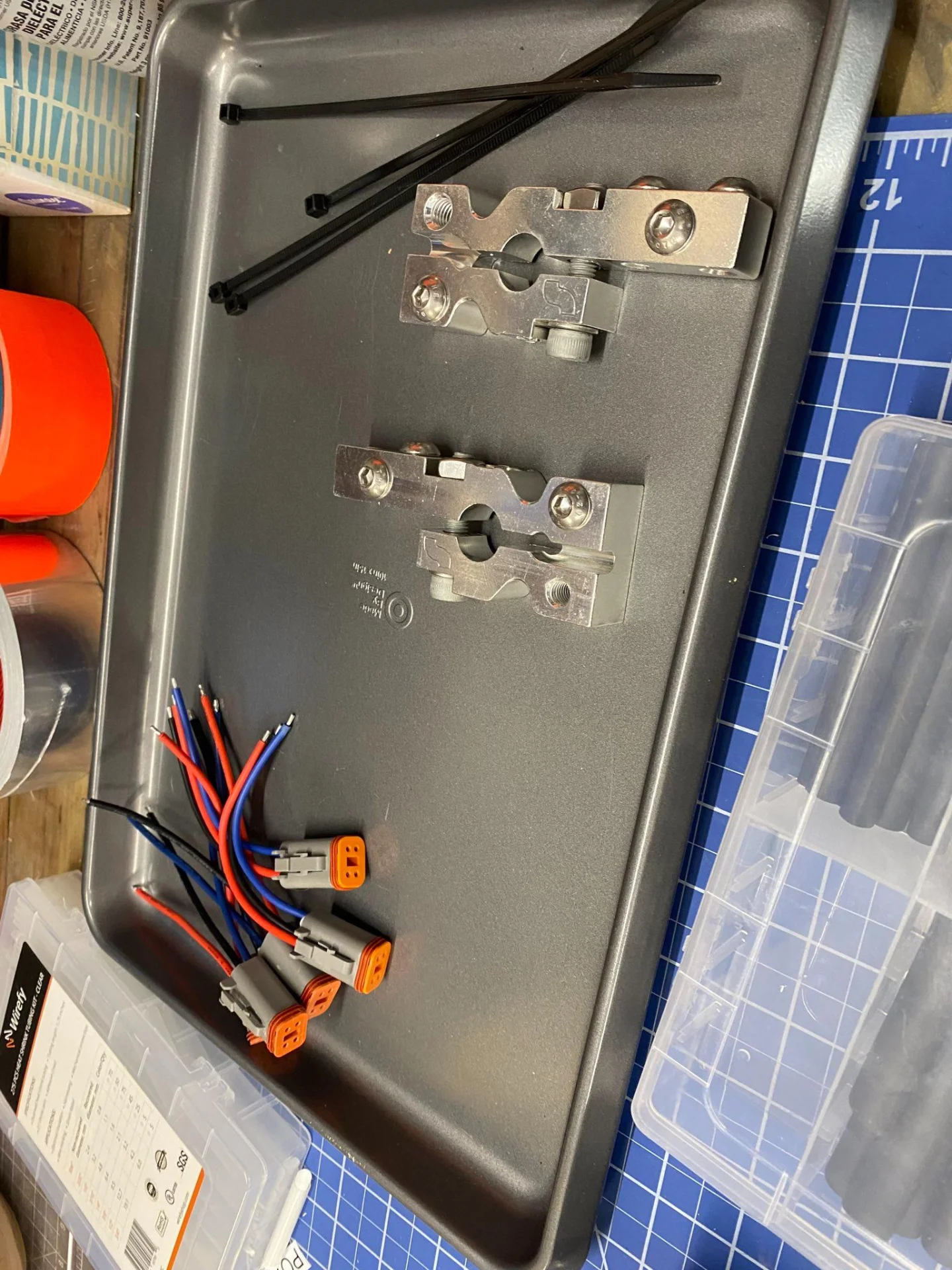

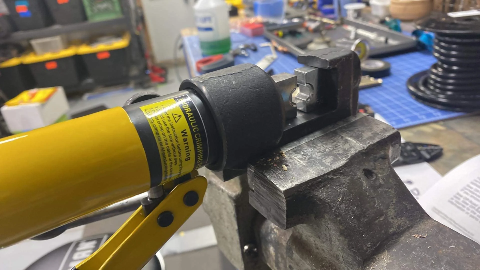

electrical stuff is coming together. Crimping some big wires for all the ground locations and the starter cable:
I will post all of the lengths one I get them installed and fit up.
