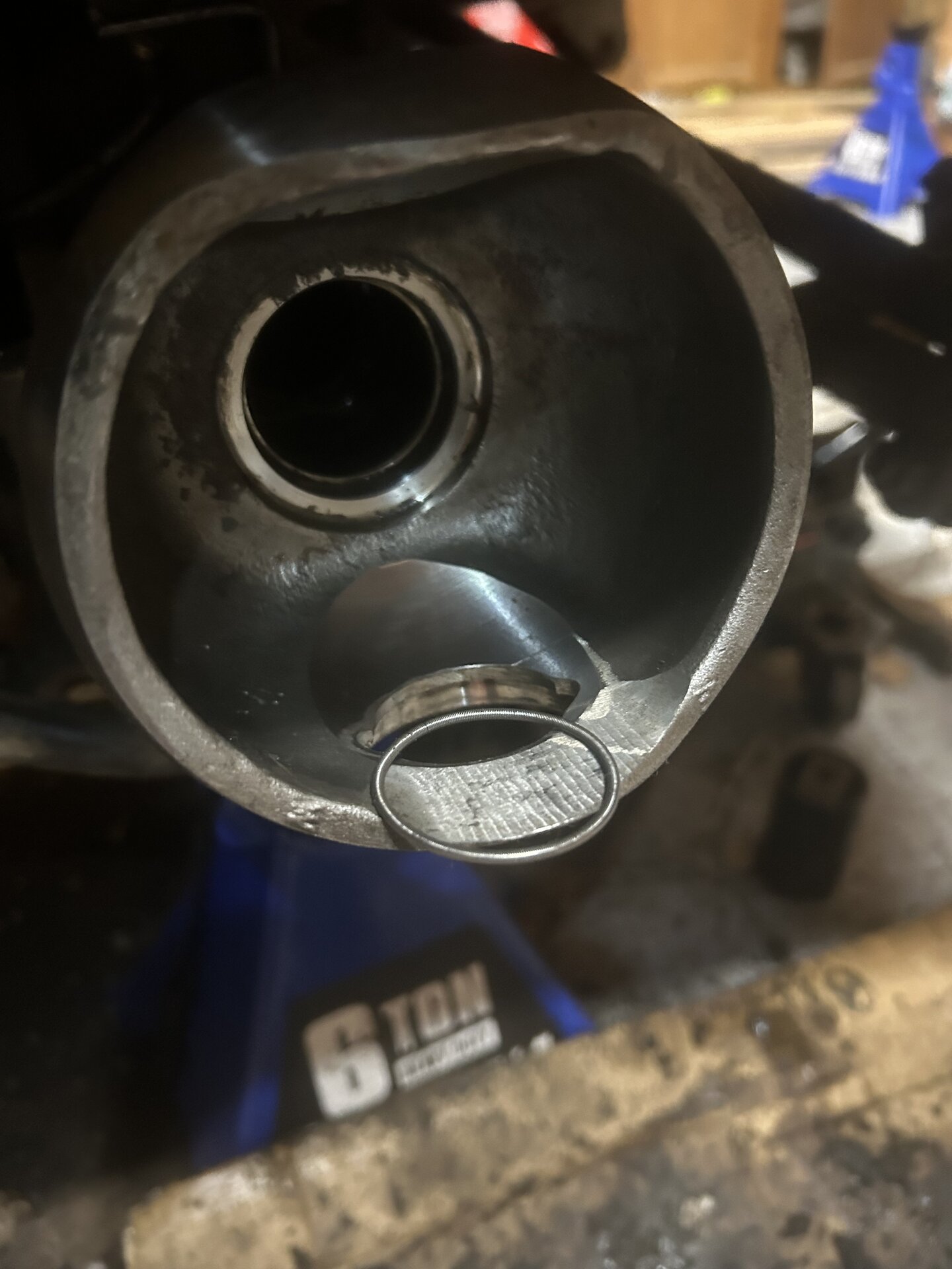

I just got my front right knuckle cleaned up to rebuild it. Took longer than inspected due to rock hard gaskets that needed to be scraped and stubborn brake lines. I also still can’t hammer out my wheel studs so I can replace the rotors, but that’s another story and I may have to find a buddy with a press to get them out.
Onto what I’m really here for tonight… During the cleaning, I looked inside the axle just to check it out, and found this sitting just inside the knuckle… what did I find and how much should I be concerned?? It is some sort of spring, but I have no clue what is to be found inside a differential and to be honest am hoping not to have to find out right now as the knuckle rebuild has turned into new tie rod ends as well since the rubber was all torn up.

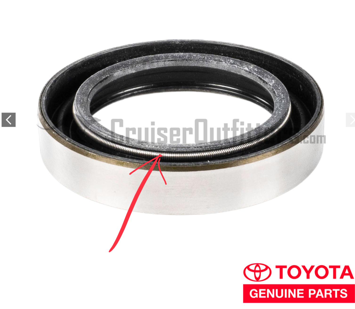

I pack the back side of the new seal with grease to keep that spring from popping out during installation. And I check to make sure the new seal has one in I have gotten one once with no spring in it
It’s the spring on the back side (inner) face of the inner axle oil seal. Fortunately you found it while you had it apart, not after you got it all together.
