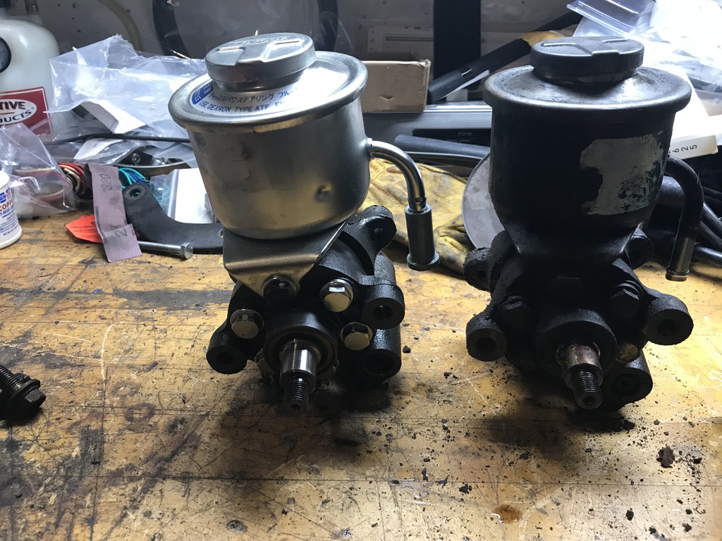

So i removed the PS pump tonight. As I could not get the pulley off I had to remove the whole bracket. Ok since I am removing the smog pump
So I discovered 4 things.
1. I was missing the front most bolt of the 4 holding the bracket on. Have to fix that
2. the adjuster bolt for the smog pump, the head was stripped and was a vice-grip removal.
3. Once I got it out what a mess and I will have to clean and paint the bracket now. That is for tomorrow night.

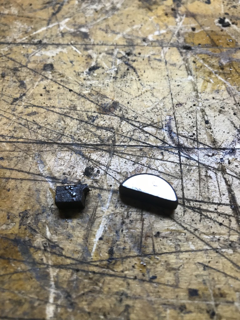

4. Once I got the pulley off and the woodruff key out of the old pulley, I was shocked. From the picture below the new one is on the right, and the OEM or what every the hell that is, is on the left.
And some nice shots of the fancy new pump (I even got a new pulley not in the picture yet) next to the old leaking mess.
Once the bracket is cleaned up, it will go back on the engine.
