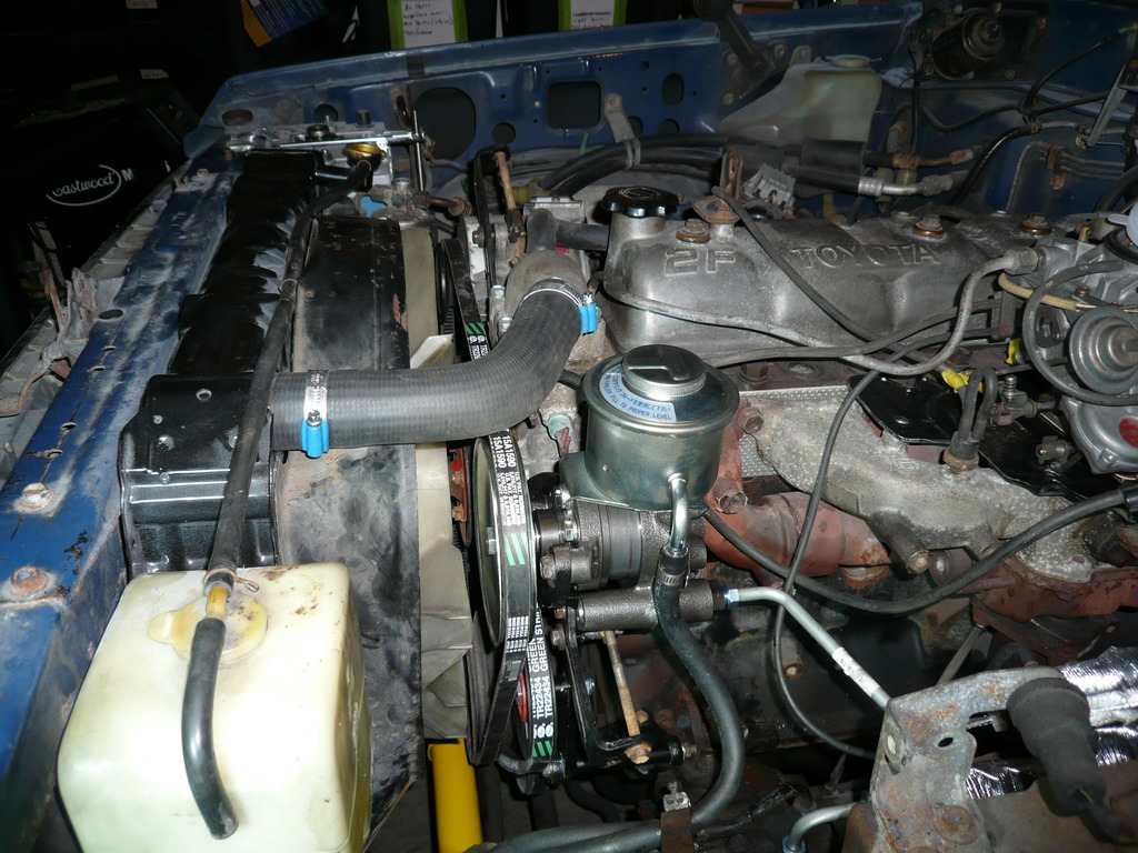

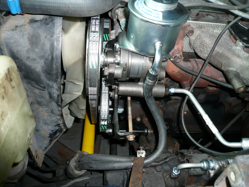

Power Steering pump in.

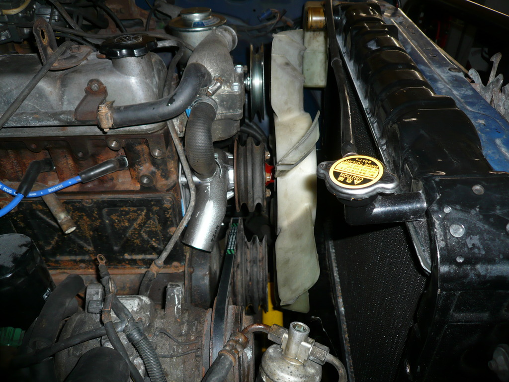

Smog delete in (belt is loose right now)

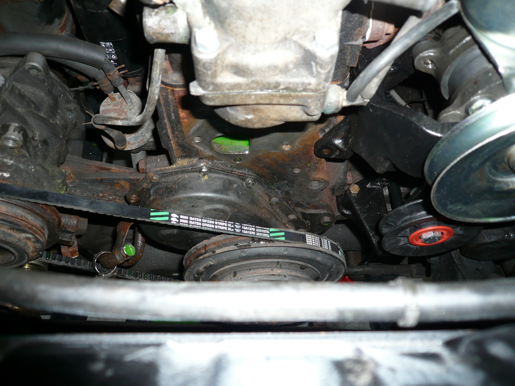

New belts check
Discovered the idler bearing for the AC was missing. Replaced with one I from a Mud member months ago. Check
Question for those that did the Smog delete from @FJ40Jim did it include a new log bolt and nut? Mine had a little slack and I may change it out (why the belt is loose), IF no one knows I will call him tomorrow.
Mine came w/ no extra hardware. I used what I had already existing.
Looks like your L bracket is bent slightly to your disadvantage.
Nice catch Ian, Yes it is and that is also part of the reason the belt is loose. I noticed it once I took the picture and will have to pull it out and straighten it.
I also need to trim the PS return hose a bit as it is about 1/2 inch to long.

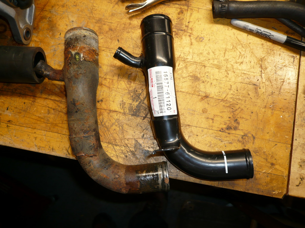

I have the alternator out to get some new hoses put back on (thanks @beno) where they are hidden behind the alt. and will also change the oil cooler hoses and the crappy looking radiator union pipe.

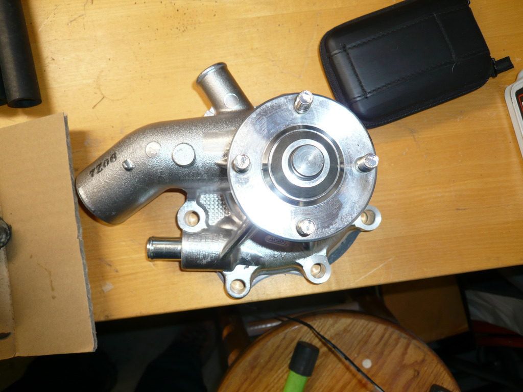

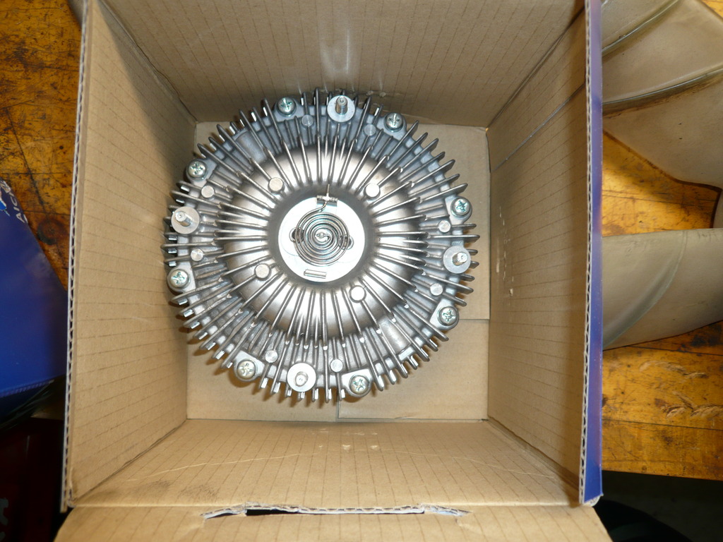

I was looking at my water pump and went back to the bills from the PO to see when it was done. It was 7 years ago or 38K ago. from what I am seeing it was replaced with a duralast pump. I have a new Asin pump in the box and debating if I should just go ahead and install it.
The current pump is not leaking at all. Thoughts?
That is tomorrow job either way.
You said it, now it’ll start... and it will weigh on you knowing how old it is and not being Aisin.
You are not wrong that is for sure, and as I plan to drive this to Colorado and back this summer, it will be on my mind the whole way.
Hence why I am replacing so much to begin with.
Looks like it is tomorrow job and I will be taking as many pictures as I can.

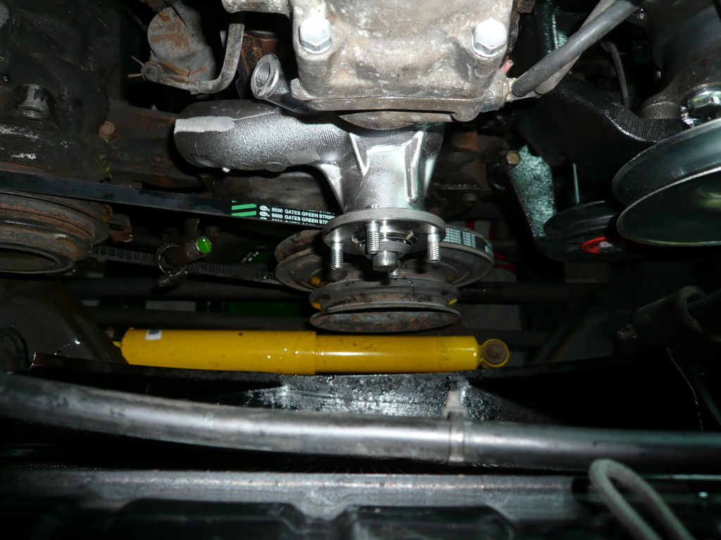

Well water pump is in.

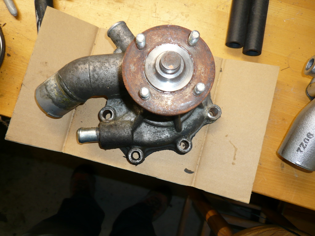

Crusty

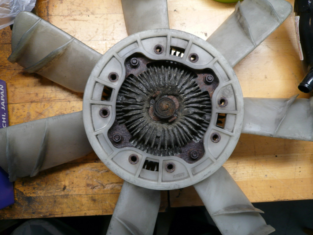

Old pump off, turned out it was made in Japan by NPW. So it will now make a good trail spare.
Fancy
Nasty
Nice and new
All ready to be remounted
ON
Hoses going back on That hose looks bulged but it is far from it.

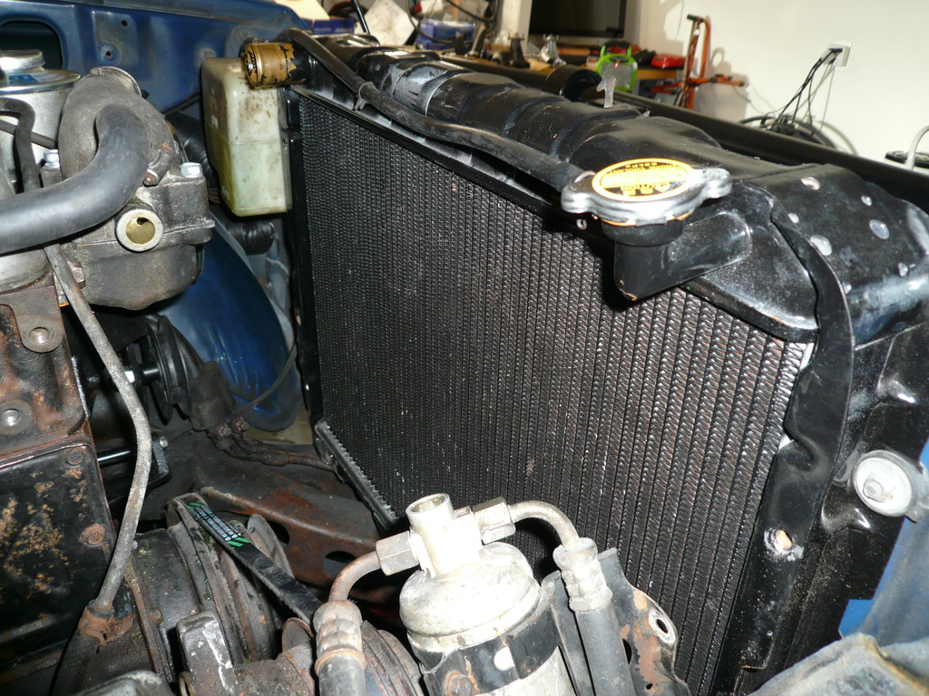

Oh and the PO was nice enough to put a new Rad in it for me.
So I did split the fan shroud. I was not planning on it. After taking off the fan and then the shroud, I decided this is stupid and split it.
I still have to mate it back up but I Split it at the center bolt so I can rebolt back together easier.
One other thing I realized is that i really hate the way they designed this cooling system. The oil cooler and the horrible patch work to get to the lower rad hose is a nightmare.
Anyways that was it for today. Between scrape, paint, fight the hoses, have to order a new hose (one factory oil cooler hose was to short?!?). It is back together with the exception of the upper shroud as It seems when they replaced the Rad they forgot 2 lower shroud bolts and now I need to get some replacements.
